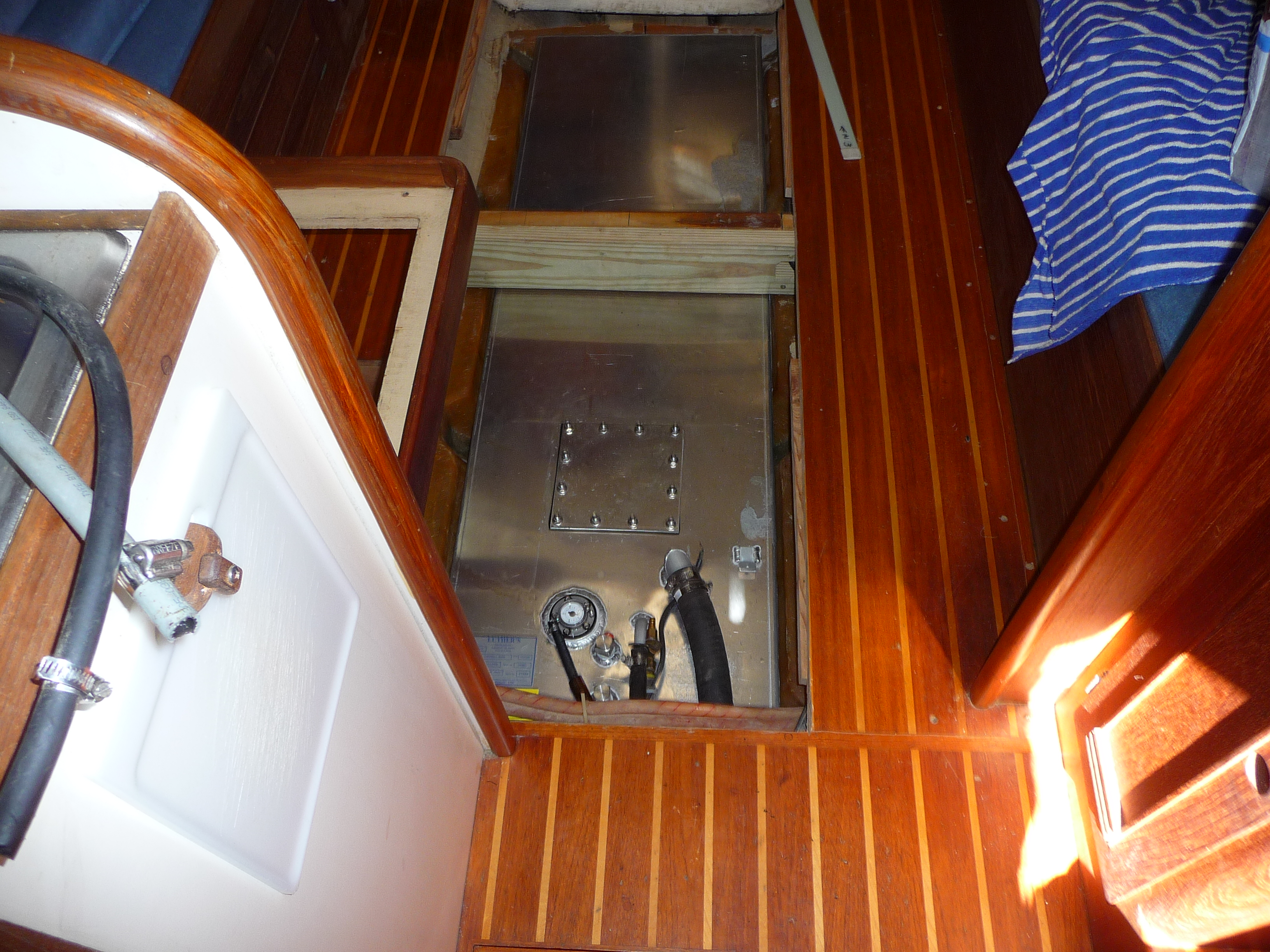

Here is the finally installed fuel tank
https://www.blogger.com/blog/post/edit/ ... 5584714632

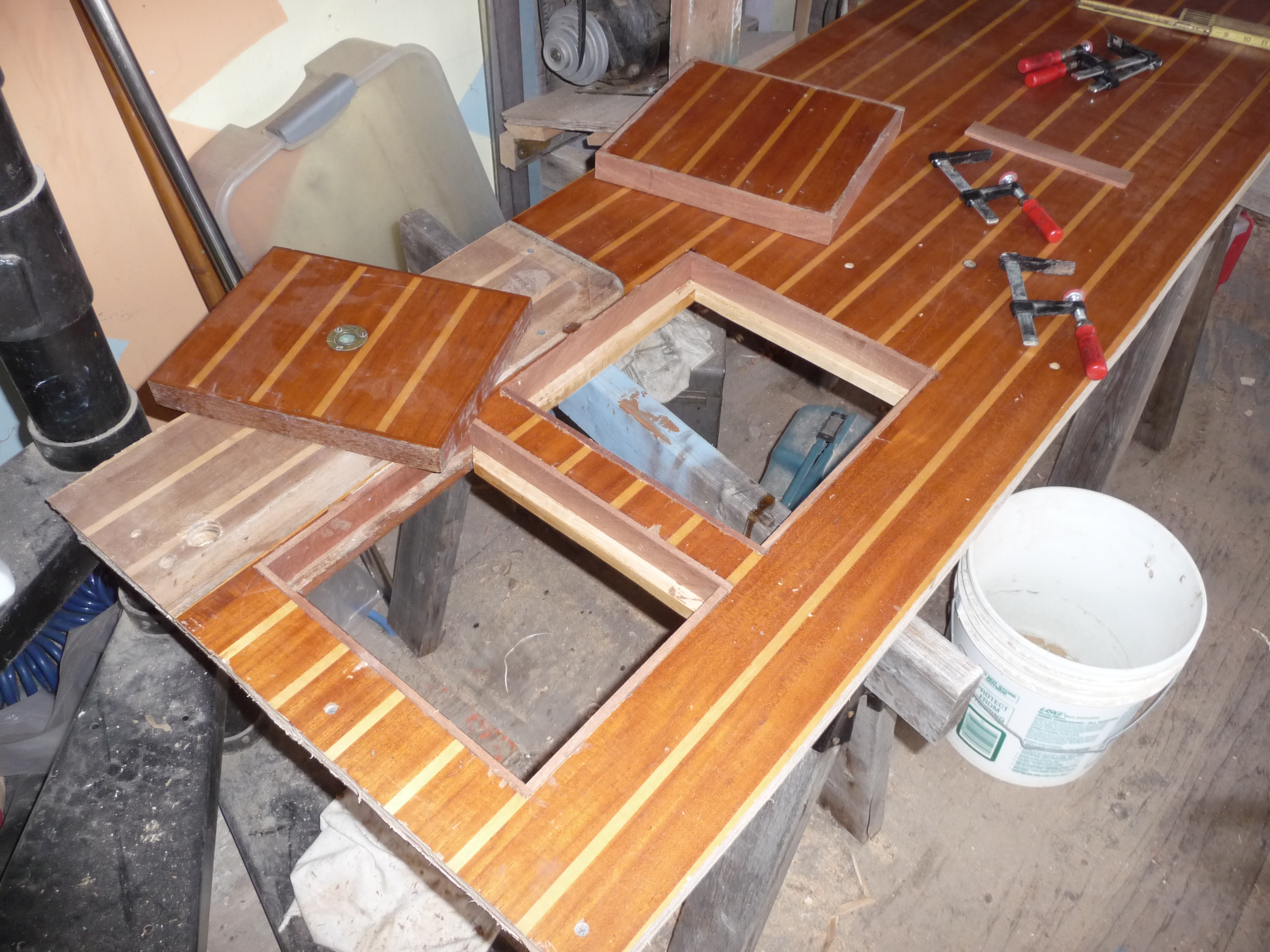

I put in a new floor joist as I had to cut the old one in order to get the tank out. I brought the floor home with me and cut a new access hatch in order to be able to access the tank cleanout.
I will install the floor the next time over. I also had installed a new fuel fill hose which turned out to be the hardest part. I had to cut the old hose into 4 pieces in order to get it out. In order to get the new one in required moving a lot of hoses and wires and much gymnastics.

Hopefully here are some pictures of the fuel tank and floor
fuel tank replacement (1).JPG (3.77 MiB) Viewed 2597 times
Floor modification (2).JPG (3.23 MiB) Viewed 2597 times
Russ

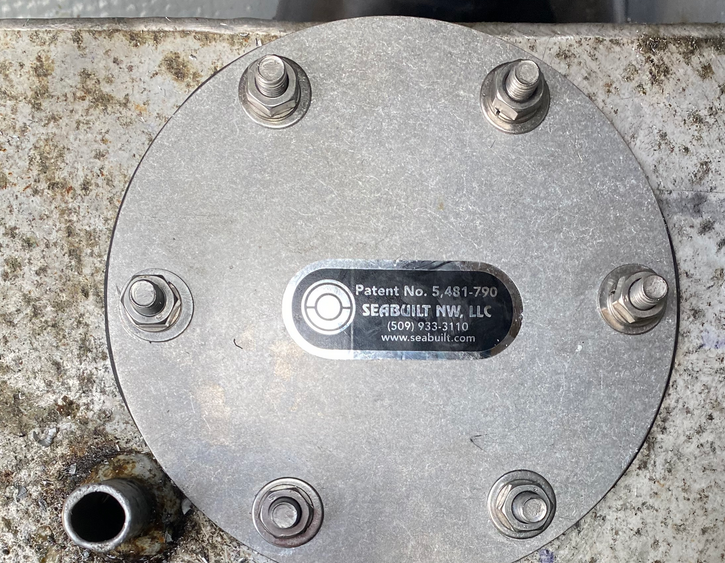

Screenshot 2022-08-18 at 08-48-32 The Cape Dory Board • Search.png (787.08 KiB) Viewed 2440 times
I had the same problem trying to get my tank out.. I got one of these access . Since you have baffles you might need to put a couple of them.. At least you can clean the tank out once in a while..These things are kinda expensive I thought) $200, but worth it and easy to install

JD-MDR wrote:I had the same problem trying to get my tank out.. I got one of these access . Since you have baffles you might need to put a couple of them.. At least you can clean the tank out once in a while..These things are kinda expensive I thought) $200, but worth it and easy to install
agree the seabuilt inspection ports are the best. as you said .. easy to install and worth the money.
