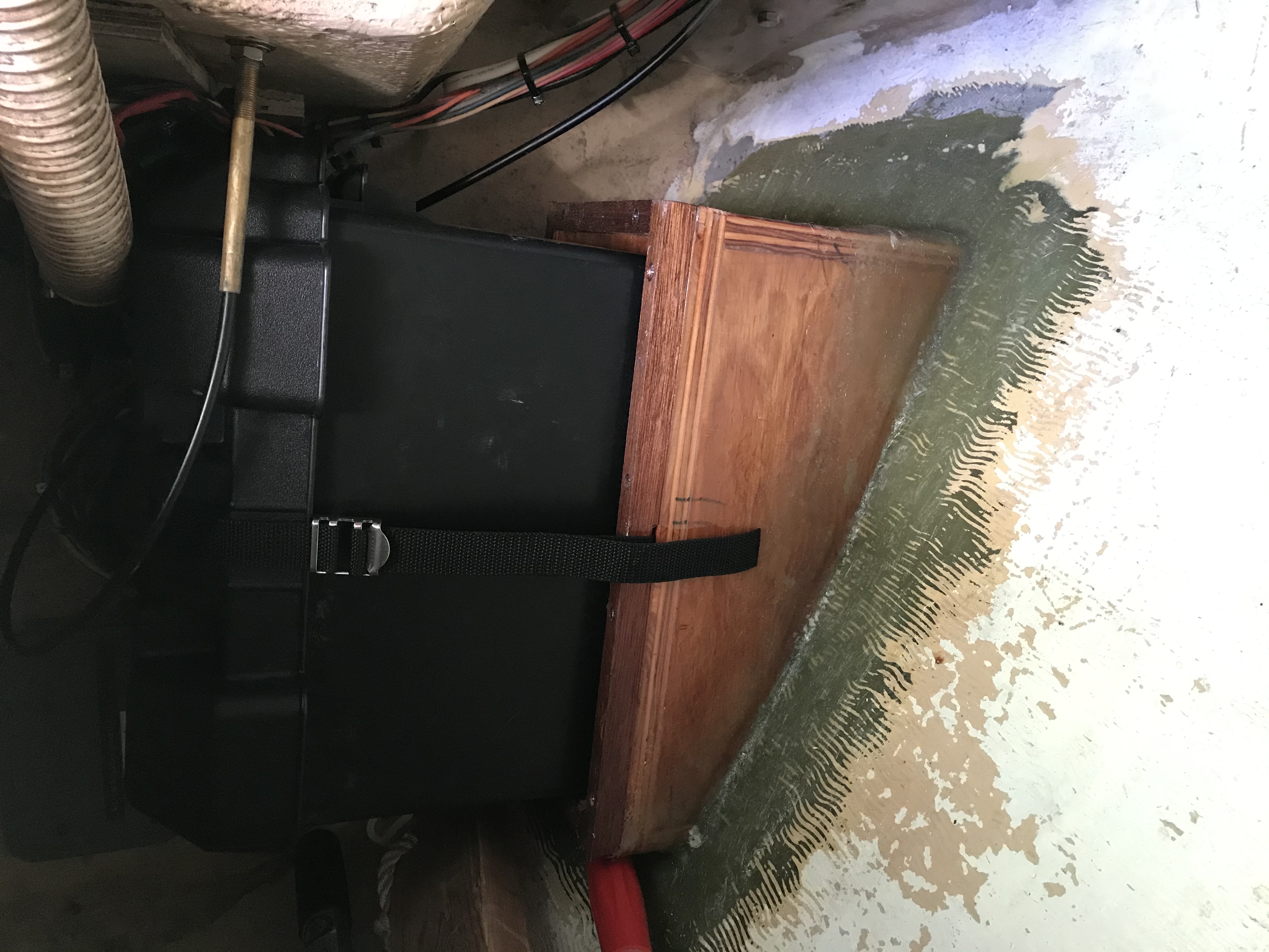

I’ve added a battery shelf and a standard battery box is held on it with a strap. The shelf is glassed to the aft starboard cockpit locker in what was essentially unused space. The orientation is athwartships as is preferred with flooded batteries. The shelf is constructed of 3/4 inch ply (with essential help from a skilled carpenter). The fiddles are an exterior decking hardwood with slots for the strap. The entire box was fastened with stainless screws and coated with epoxy before bedding in place and fiberglassing to the hull. I haven’t run new battery cables yet, I’ll do that in the spring. I’ll also add a coat of bilge paint for appearances sake.
Orion has always had two batteries, a group 27 and a group 31. I’ll now have a second group 31, doubling my house bank capacity.
Battery shelf added November 2019

I also put my replacement water heater under the cockpit sole. This freed up the shelf for batteries. Before making accommodations for the batteries, I trimmed (cut away a big chunk of) the shelf to allow much better access to the cockpit drain, seacock. Raven has two group 27 AGM batteries that are treated as one as far as charging and use are concerned. I mounted a Group 24 start battery down low to the hull, just behind the seacock and close to the access panel to the engine. This keeps some of the weight a bit lower and closer to the center line while staying as far forward as possible. I simply added cleats and a heavy tie down for plastic battery boxes. It is hard enough to get the batteries out as it is. Mine are right up against the cabin bulkhead and I could not lift them out of a box,
This situation seems to rest firmly in the don't make it harder than it has to be category, Steve.
