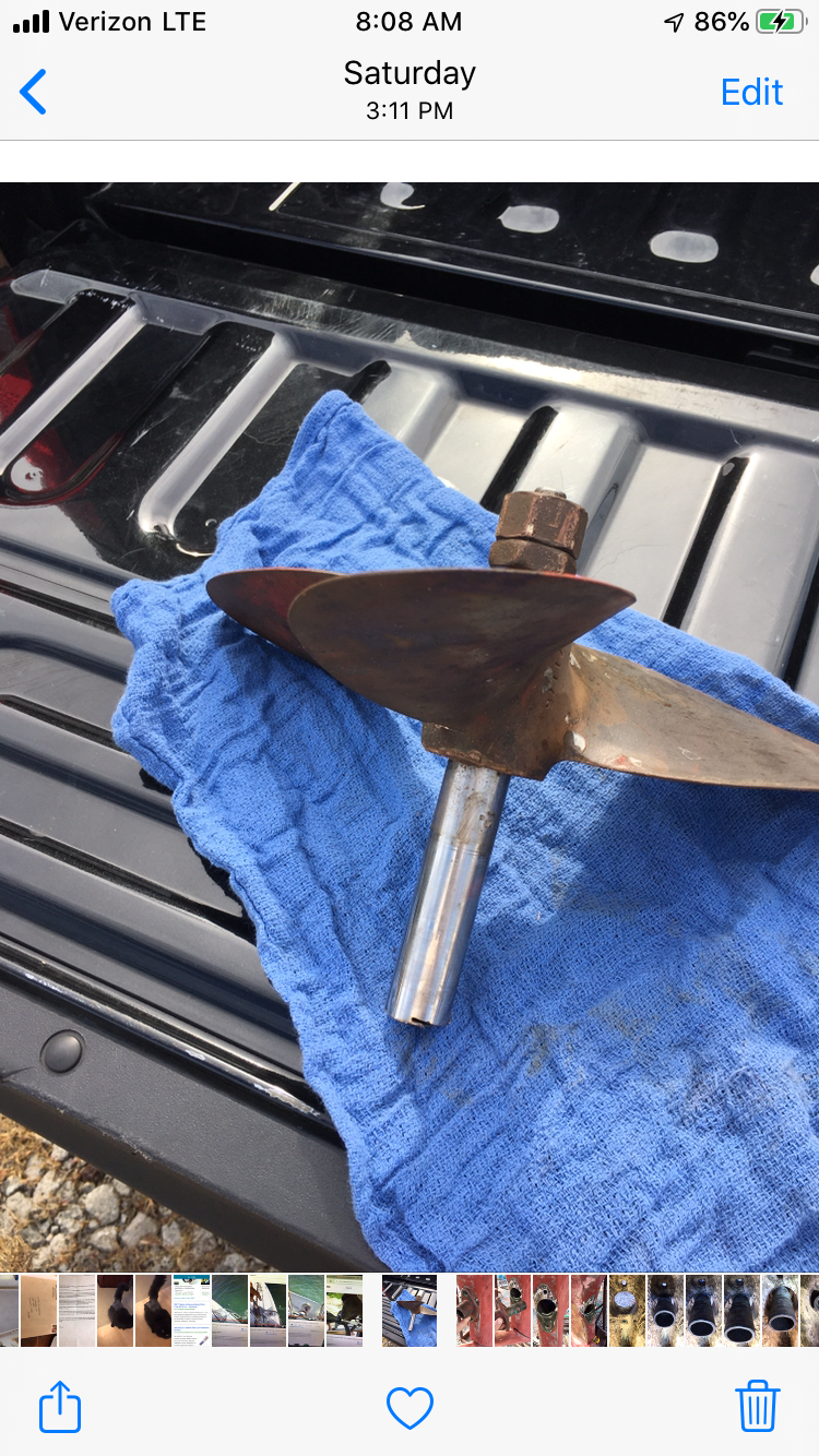

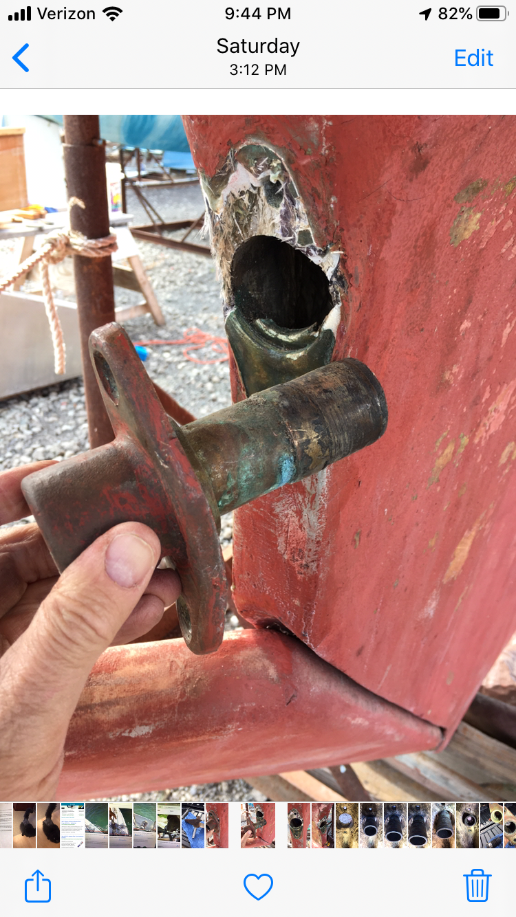

Back on the hard,a buddy and I worked for several hours to get the prop off to no avail. I finally used a grinder and cut the shaft. During this process the bronze cutlass fitting was removed as well and some glass tore out. I had planned to do a quick filler repair and replace it, but the yard owner took a look and was shocked the whole thing had not leaked sooner.. I will download some pictures to show what I have, but there was very little surface area for bedding the bronze fitting.

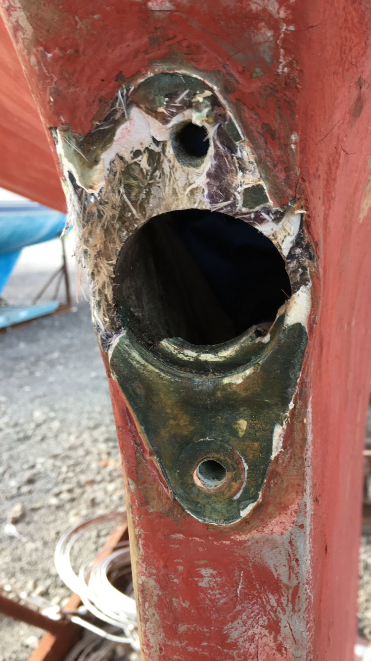

My plan at this point is to grind the exterior and add 5 or 6 layers of epoxy and glass over the hole and then redrill the two machine screw holes, and use a hole saw to drill the larger hole for the bronze fitting. I am going to install shorter machine screws, I had to find a 5 inch 9/16 socket to remove the bottom nuts.
I thought about injecting thickened epoxy around the bronze on the inside. You can see doom the pictures there was not much supporting that fitting. But Brian, the yard owner disabused me of that notion. He said if it ever needed to be removed I woul be cutting out the back of the boat and hating life, and probably in some third world boatyard at that. I am not sure if I need to stabilize that bronze tube or how I would do it. Possibly a piece of g10 tube. I have a lot more room than most because I cut a hatch in my cockpit sole and got the fuel tank out of the way. Still not an easy place to work, but before it was impossible for me, at 6ft 5in.
- 49D127A2-F2AB-4F37-B5CE-9F7260F3BF44.png (2.34 MiB) Viewed 734 times
- B7ED214B-2AEF-4EA6-9776-7DDF0639328D.png (1.81 MiB) Viewed 734 times

I might also be in for a new prop, apparently the guys who clean and balance the props can only do so much. I didn’t notice any dings but on second look there was a good sized hack out of one of the blades.
- 5A7BFA3D-9E0A-498A-9335-13890F7E49F1.png (1.78 MiB) Viewed 732 times

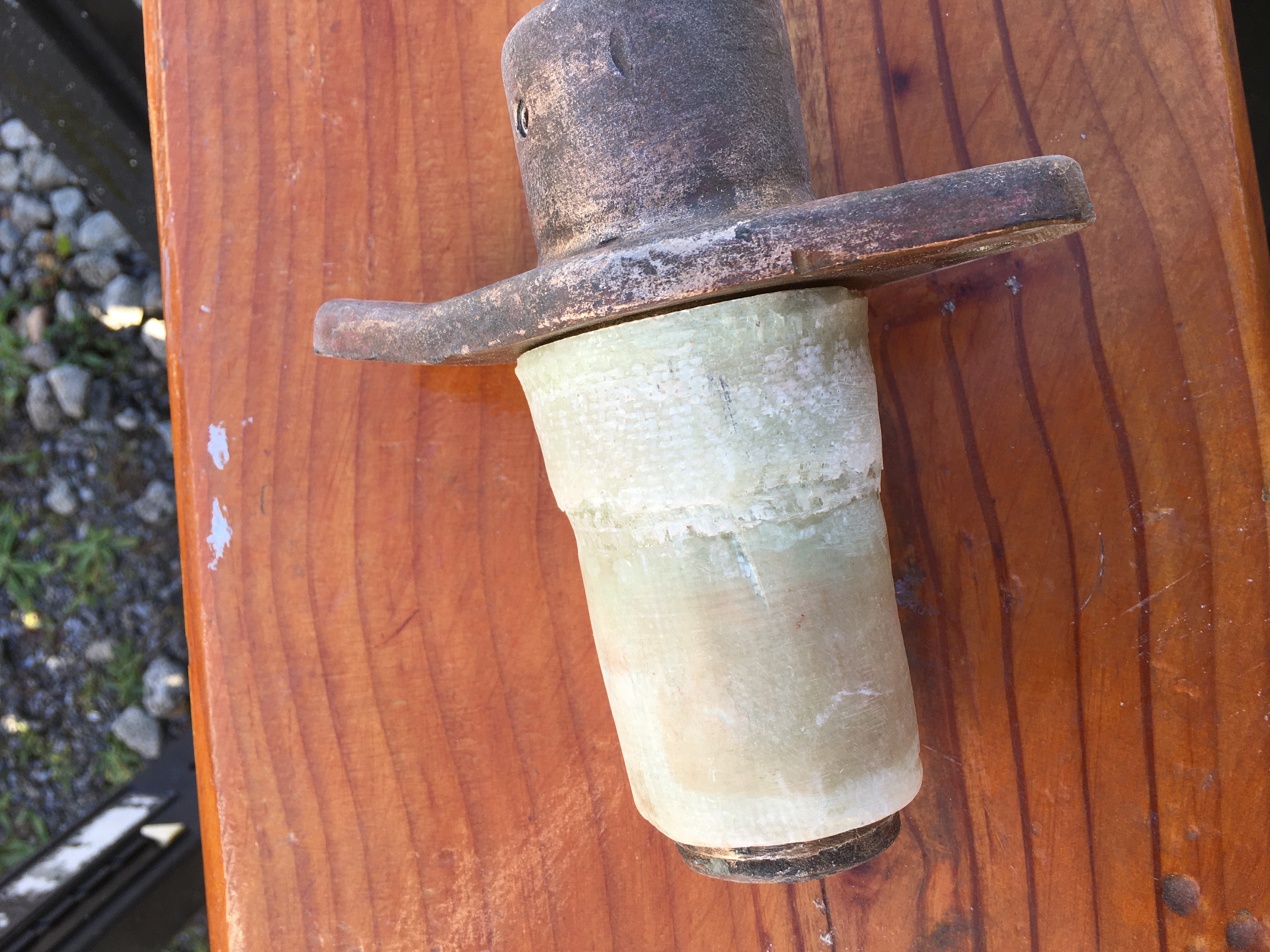

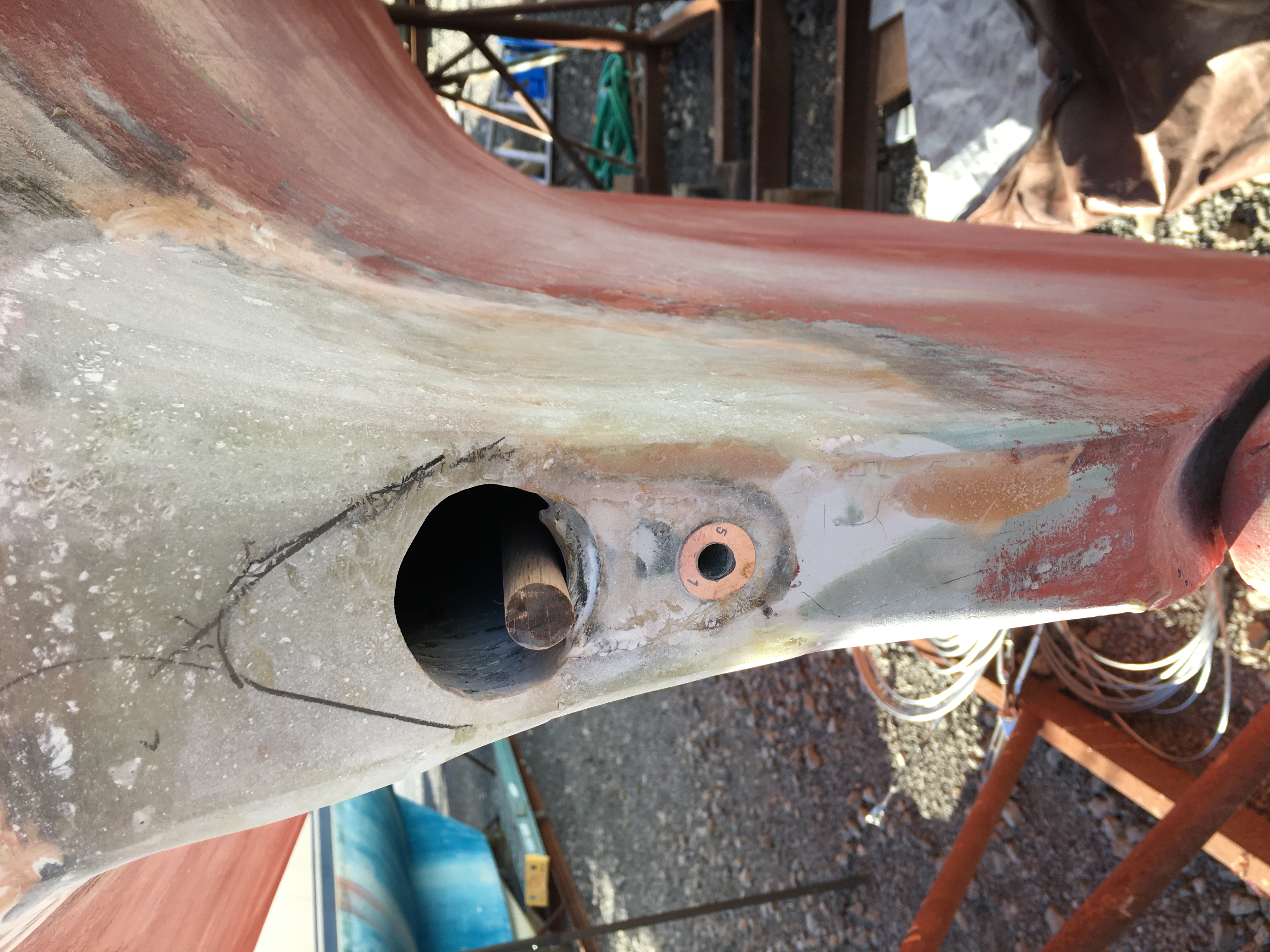

I have been building up the glass on the exterior. I know the lateral walls at the large hole were pretty thin, and there was not much surface area there for any bedding compound. I guess the previous install used 5200, I’ll use something else. The top bolt hole needs to be drilled out. The glass insert is too long, I am going to cut that so it is only about an inch. I’ll then tack it in place, make sure it is lined up and then glass it on from the inside. The oak 1/2in wood dowell is the new drive shaft.
- EE84EECD-F5ED-44E3-A791-B143B0697FDA.jpeg (2.57 MiB) Viewed 698 times
- A6DE9D35-B663-4006-AA92-0BBB05BD256A.jpeg (2.37 MiB) Viewed 698 times
Re: Prop shaft rebuild on a CD33

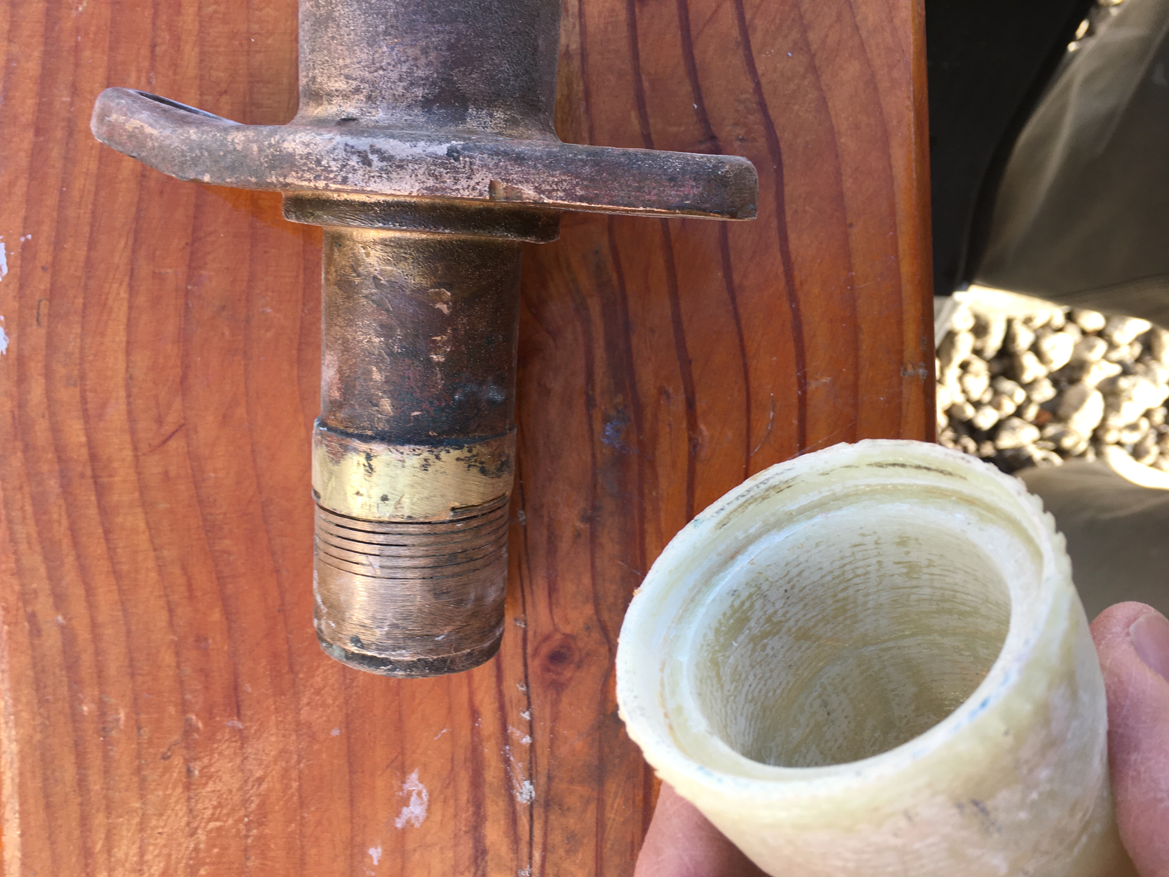

The glass insert. It is long, it will be cut to about an inch, tacked in place and then glassed in from the interior.
- 9E3B8CA1-0BFE-494E-8FC9-3CCEE8A0B8FC.jpeg (2.17 MiB) Viewed 697 times
- A4E51DCA-50F2-45B4-84F2-C67985183D52.jpeg (2.56 MiB) Viewed 697 times
