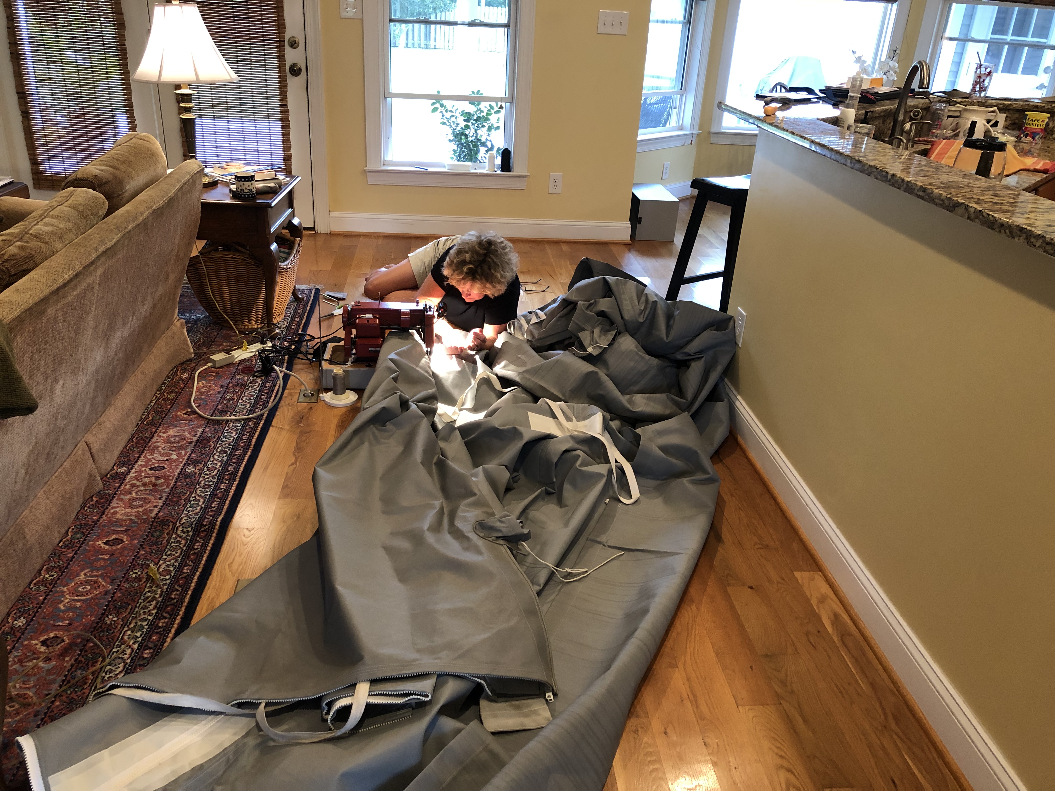

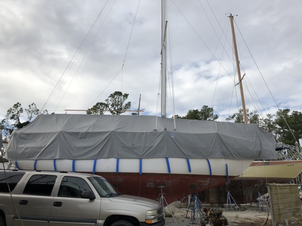

I recently purchased a full boat cover made for a CD 36 by North Sails Annapolis. It was made in 2011 but had very little use. Maybe a season...maybe not that much. It has three parts that zip together. You can put it in the boat by yourself. It does not require a frame, unless the mast is down. It came with 18 bags that can be filled with sand and suspended from loops in the skirt so the cover can be used with the boat in the water.
It did not fit perfectly as we don’t have a bow or stern pulpit and we have two shrouds per side for our double spreader mast where a stock boat has a single cap shroud. Mostly the fit issue was we have six inch taller stanchions and they are in a different location than the original stanchions. So we test fit the cover and marked where it needed to be modified. We took it home and Gayle sewed in it for a couple hours. We added leather chafing patches and some spectra web loops.
Because we need to raise the cover six inches I incorporated a spreader bar. I will see how it works. But, I may have to add a 2x4 riser on a platform that sits in the top of the boom instead. Not that hard to do if necessary.
I was concerned about the cover and lines chafing in the topside Awlgrip paint s we pitched some pool noodles and ran the lines through them. We will keep an eye on them and see if they run the paint.

Nice fitted cover. Is that opening amidships a vent or...... ?

Thanks Jim. I think it’s just a vent to let in air and light. It is zippered on two sides so it folds back like a big triangle. It’s about 30” x 30”. Gayle sewed a tab on it so we can tie it back. I’m happy to have a cover on the boat.Jim Walsh wrote:Nice fitted cover. Is that opening amidships a vent or...... ?

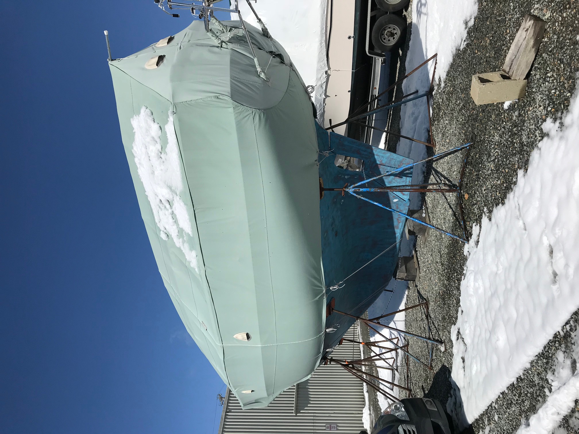

My cover has six soft “clamshell” style vents and they are screened. This is posted as one example and not as the best solution. In my neck of the woods, for five months on the hard each year, it works fine.

That’s a great set up Jim. Very nice. But you are correct...you are using it as a winter cover in NE. I need something I could use in the summer. Doable but requires some thinking. For now, this works well. And it’s great to have a full cover.Jim Walsh wrote:My cover has six soft “clamshell” style vents and they are screened. This is posted as one example and not as the best solution. In my neck of the woods, for five months on the hard each year, it works fine.
