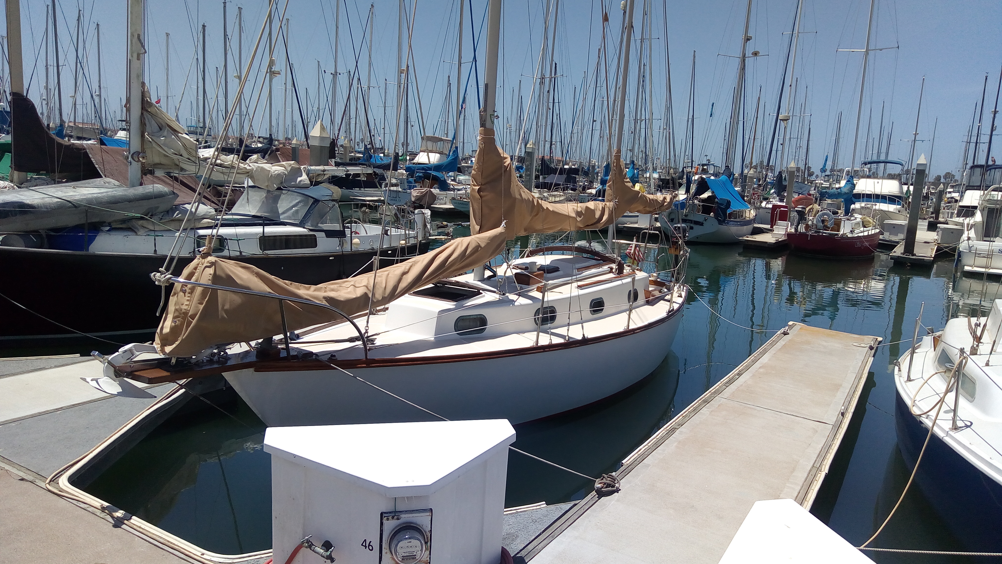

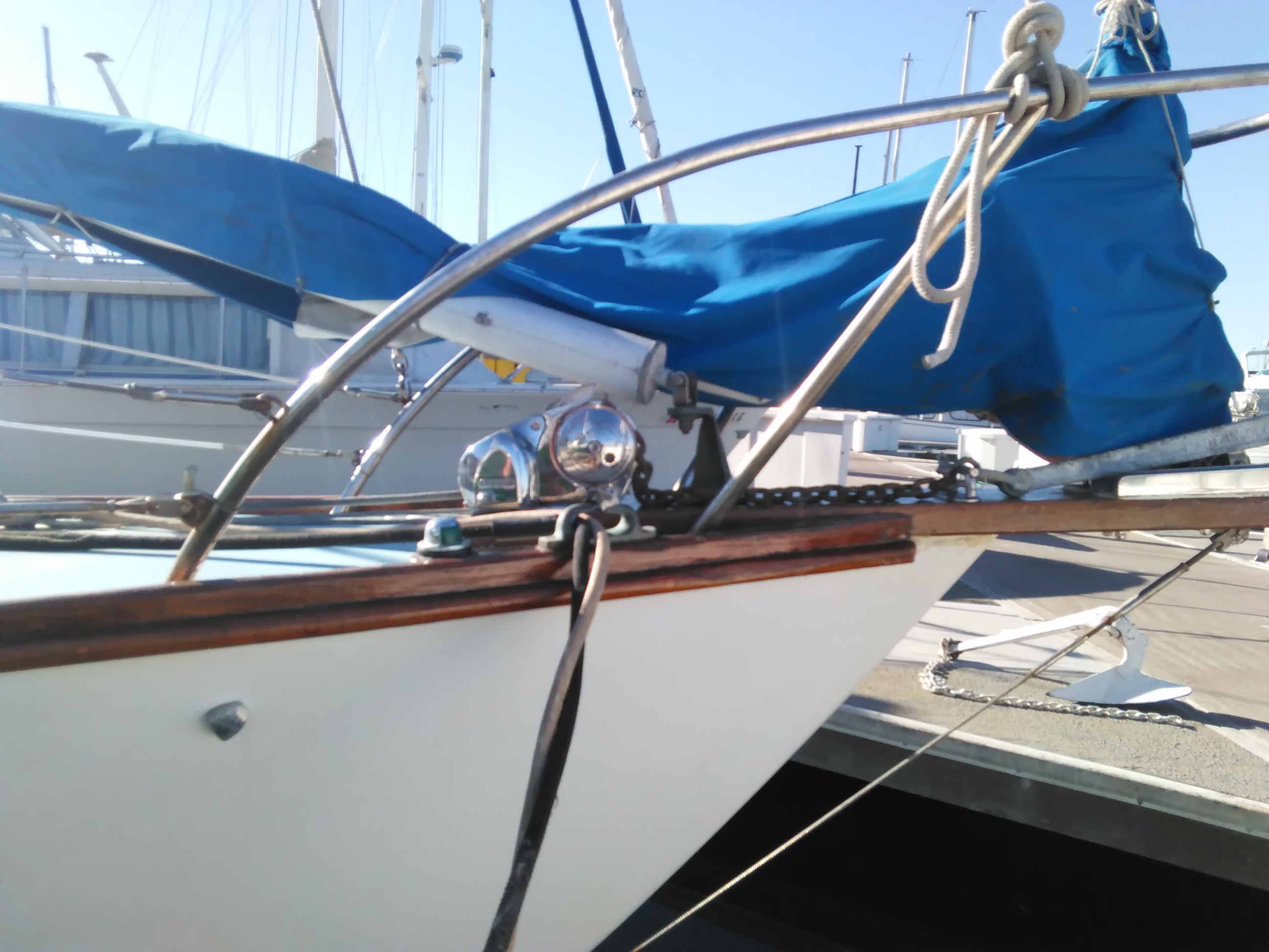

It's gonna be down the line but I am also thinking of this. I definitely want a roller furler but I want to keep my club jib
