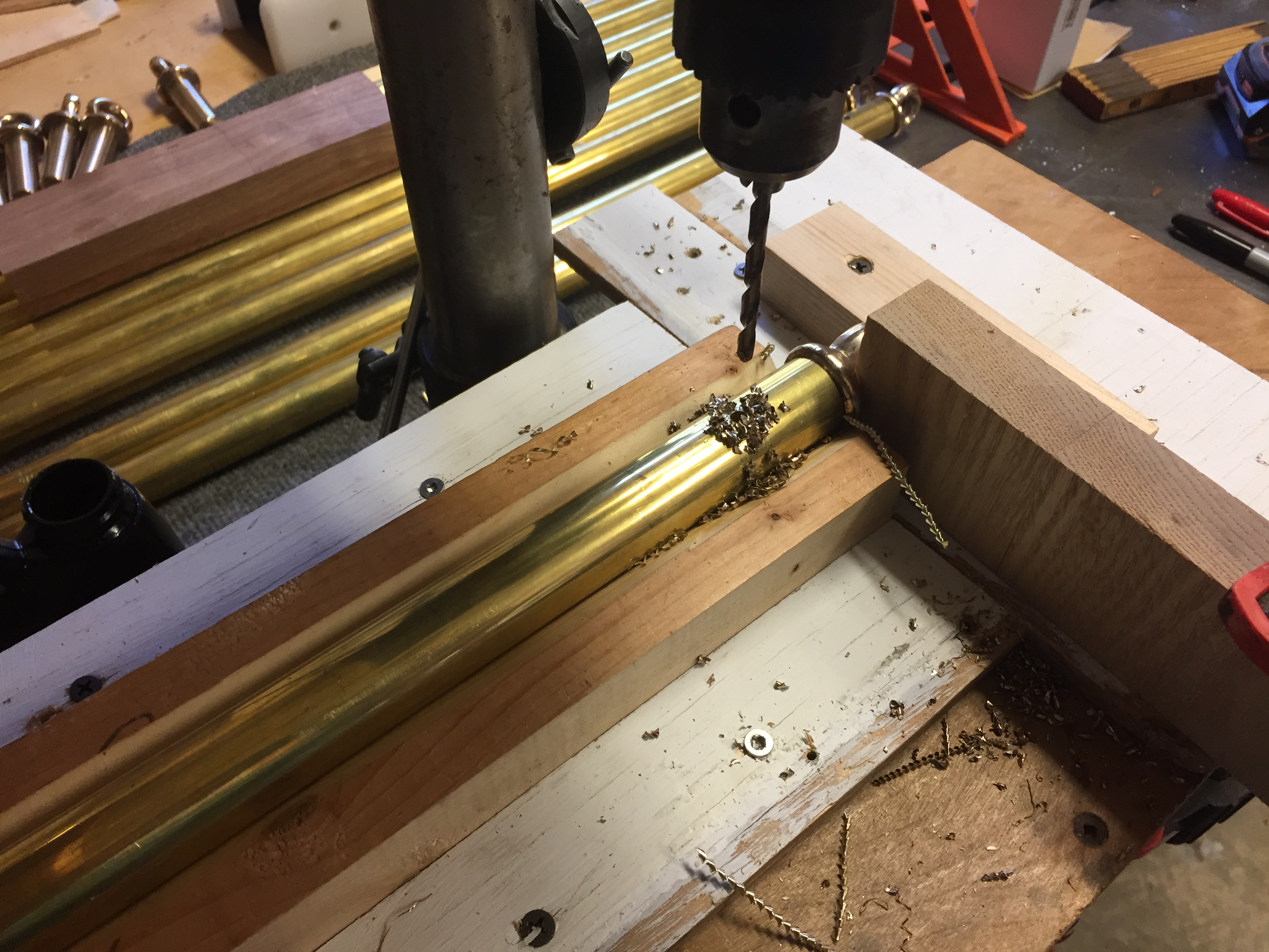

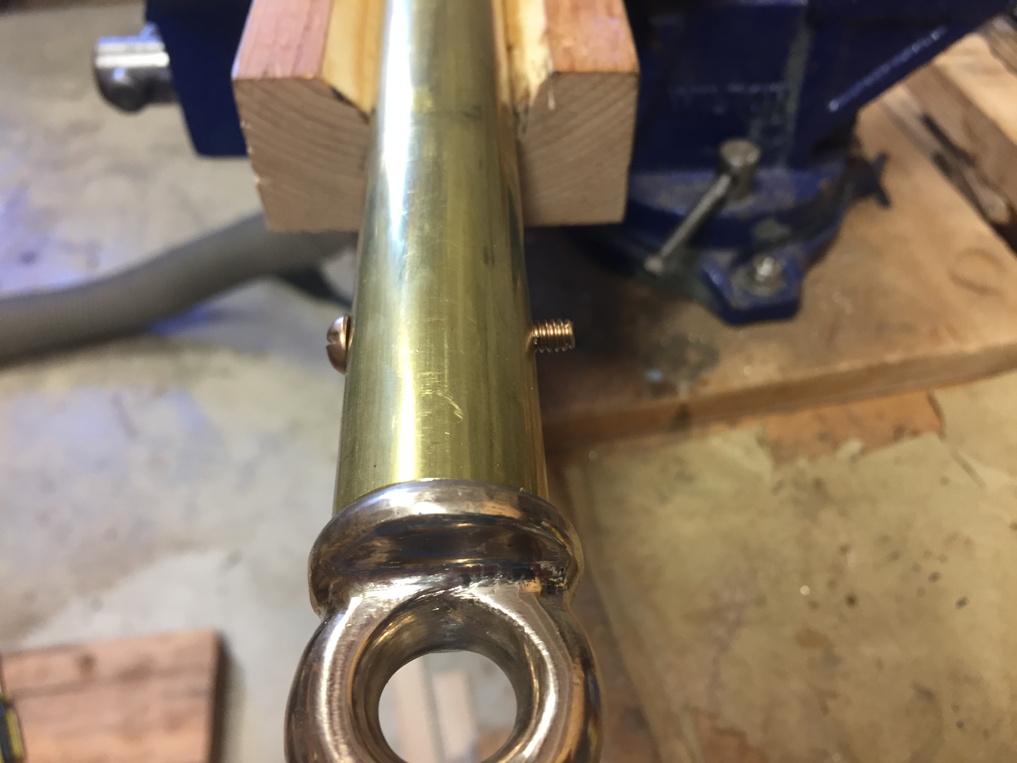

Attached pictures below are of my home built wedge drill block cut from a piece of 2x4 just as Jean described. It’s best to use a table saw to cut the wedge but you can cut it with many different kinds of saws...even with a handsaw if you are careful and patient.
In the photos (not great but best I could find on my phone) I have a stanchion clamped into the bracket while I drill holes for the bronze fittings with a small drill press. I have used the same wood drill block for maybe 8 or 9 years. You can use this kind of block to (a) clamp a pipe so it can’t move and (b) as a drill guide to ensure the hole is centered in the tube. What you do for (b) is drill a hole through the center of the “V” before you clamp to the pulpit. Then flip it over and use the hole you drilled through the block as a guide to drill back through the block and into the pulpit tube. Clamp the drill block to the pulpit tube and ensure you know exactly where the hole is. I usually draw lines on four side of the block showing the alignment of the hole. The thicker the block of wood and the deeper the guide the more accurate it will be. Pine is OK but ash is better as it reaistangetting distorted as you drill multiple holes. For a single project though pine is more than adequate.
If you make two wedge cut drill blocks then you can have two opposing flat surfaces for your clamps and they reduce the likelihood the clamps will slip like they will do sometimes when one end of the clamp is sitting on the drill block and the other is on the convex surface of the tube.
