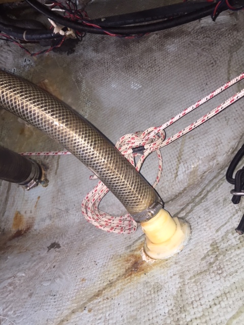

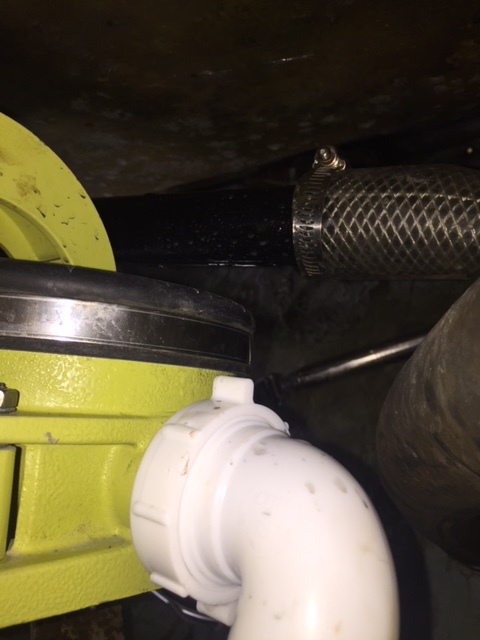

I didn't get any response on these fittings so I'll post again. I know the purists would like to see solid gold fittings and rocket ship hoses with triple clamped but these household drain fitting fit perfect and are very cheap. I don't know if its a good idea. My neighbor says no, they will vibrate loose. . I'm gonna try it for a while anyway. It's way above the water line and I kept some of the reinforced hose down to the outlet. It fit so nice and compact. The original had the green reinforced hose going way around and back and was kinked a little, that must of restricted the flow by half.

Here is my 2 cents about the plumbing:
Avoid household items that are designed for a static environment or unsuited for salt water.
Some examples are solid core electrical wire, copper tube for propane and plastic pipes/fittings.
Also, will the bilge pump through hull be above the water line if the boat is swamped and/or badly listing?
We must all use our own judgement and it will be the sea that is the final arbitrator.

Thanks Jonathon. I'll consider this just a mock-up and redo it with good stuff soon
