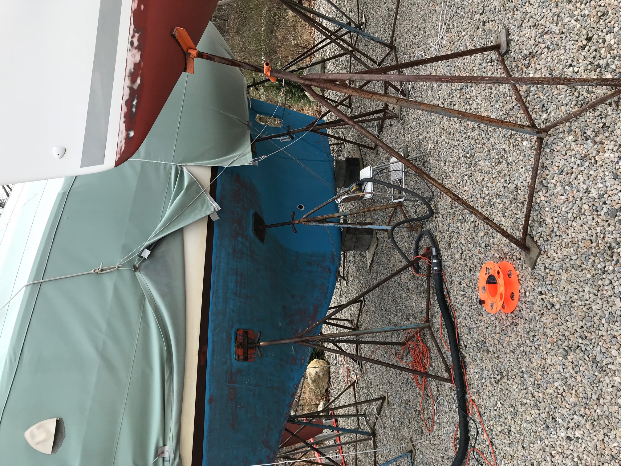

I always find it easier to prep my bottom for a fresh coat of antifouling in the fall. Even though my bottom appeared perfect, and I use ablative paint, I just don’t want to build up unnecessary coats of antifouling.
I put my winter cover on prior to sanding and lift it as necessary to expose where I’m working. I use a DeWalt 5” orbital sander and 80 grit mesh disks. This year I went over it a second time with 120 grit mesh disks and it’s smooth as silk. The mesh allows the shop vac to gather the dust much more efficiently. My dust mask was nearly as white as the day I first wore it when the task was completed.

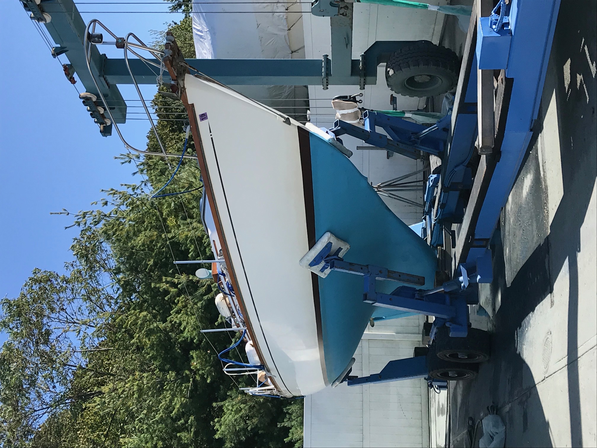

- Orion was hauled on October 19. The bottom looks perfect.

- A work in progress. You can see traces of my red undercoat.

The mesh discs are just great. They don't clog at all if you have a decent sized vac for good suction. Never does any dust escape, very impressive. I used the Diablo brand from Home Depot. They come with a protection pad too. They are way less expensive than the Mirka or the Festool discs.

What you see in the photo is the hose leading from my wet/dry vac which is 2” coupled to the 1” hose for my DeWalt orbital sander. They were mated using a standard soft plumbing sleeve and a plumbing reducer. A couple hose clamps and duct tape held it together. Worked fine for several years.gates_cliff wrote:i like these solutions. Curious as to vacuum hook up arrangement. After searching the web I found one post where a guy used sump pump hose. In Jims photo it seems you have two different size hoses, is that right?
