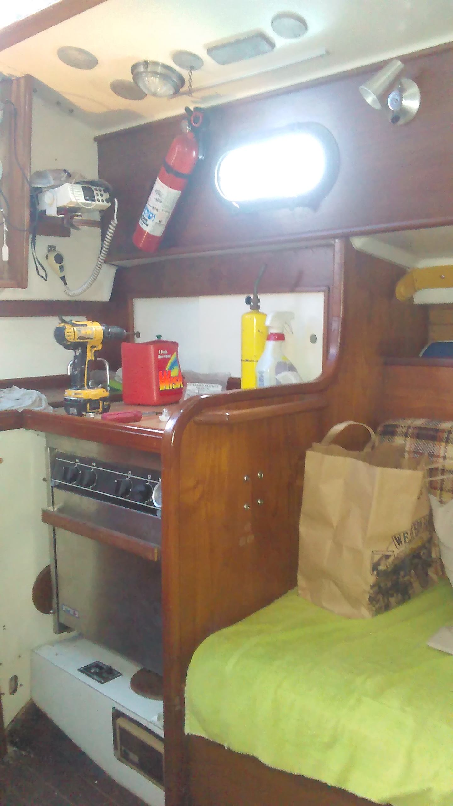

I threw out the old fuel lines because I didn't like the looks of them. there was too many fittings and flared copper tubing. I'm not sure how to test this stove I have that came with the boat, other than hooking it up and testing for leaks. I'm wondering what is the best type of fuel lines to have. The PO had soft copper tubing running up high on the liner along the side and out the dorade vent in the head I plan to get a new aluminum or maybe a fiberglass tank and mount it on top a little aft of the mast so the inflated dinghy will still fit over it. Any suggestions are appreciated. I will be getting a new co2 detector or is it Carbon monoxide.

Bench tested the stove today. It seems to work good so I ordered a new regulator and supply hose. There is a aluminum tank ,horizontal type, at the consignment store. I will probably get that .They want alot for a used tank about the half price of new one. I think 30% is more fair I will offer him, $100. The problem with the stove is the battery holder is gone. I tried connecting a battery up and tried the spark igniters. Nothing. I'll deal with that later. I think that means the safety that shuts off the gas when the flame goes out will not be working either. So I'm not gonna have a leak detector and I will dream up some kinda manual shut off. something like" Far Reach's". My tank will be on top of the cabin close to the dorade box so I will have some type of shaft going thru the cabin top.I think it has to make a right angle to turn the tank valve.
