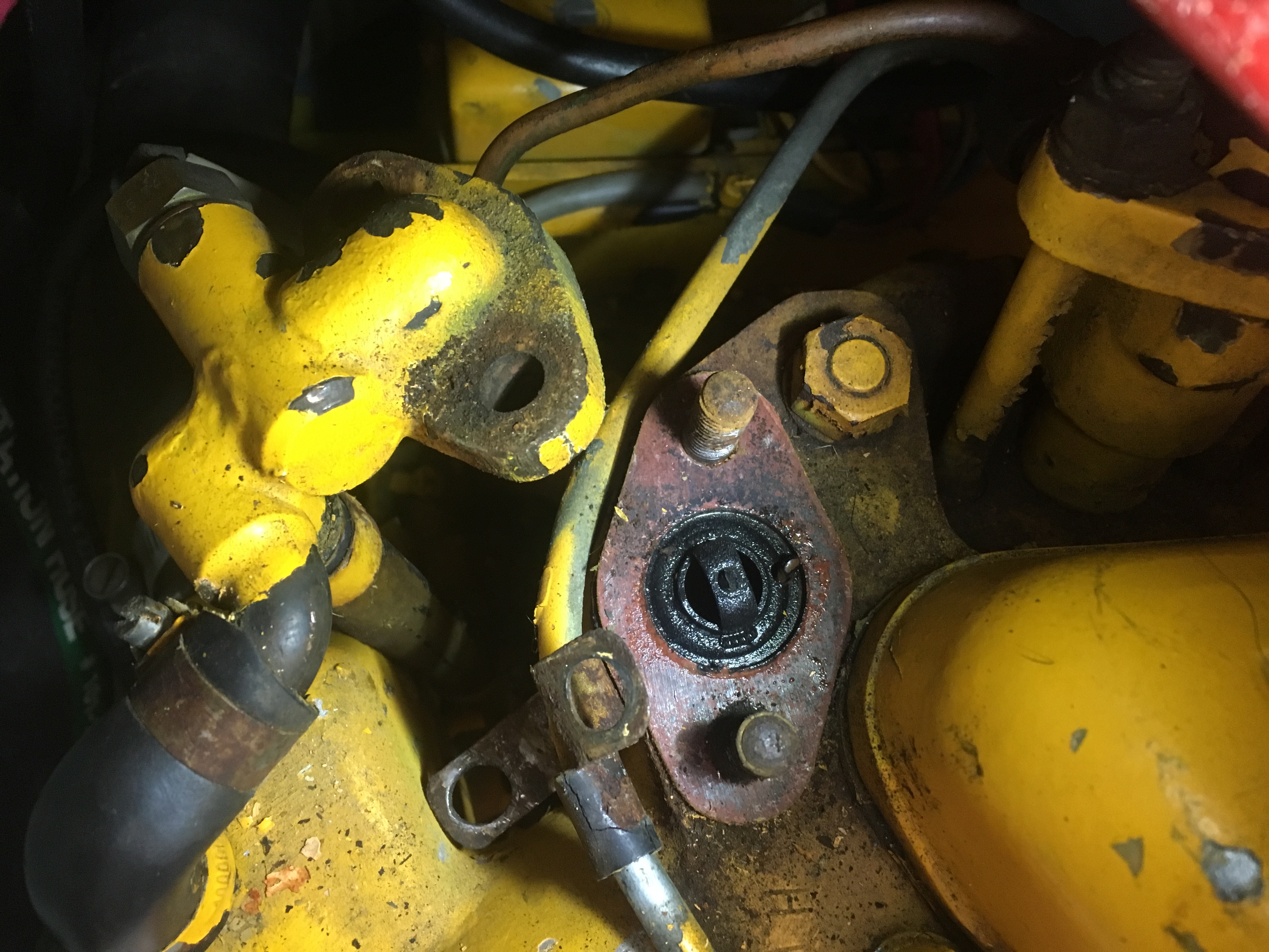

So I went back to the boat and decided to pull the housing where the thermostat was just to make certain that the antifreeze was in the water jacket.
Thermostat housing
Thermostat housing
After pulling the t-stat housing it took a while to chisel the old gasket out before I could remove the thermostat.
Housing off with t-stat intact
Finally got it out and it looks like it was frozen open!
Thermostat out of housing shows open at ambient temp of 38 degrees F!
The cylinder sleeve was full of antifreeze. I will replace the t-stat and the gasket. It is the smallest thermostat I have ever seen. Cute little thing. I also noticed that the petcock on the lower side of the engine, just above the water pump, would drain the water down in the cylinder if I opened it. Still not certain it would completely drain the sleeve, so I will do the complete job again next year but if it drains antifreeze then I will know it reached the sleeve. Thanks for the comments!

Good job! - and now you can rest easy. Yes, that is the tiniest thermostat I've ever seen too. It's probably been stuck
in that open position for a while. One tip- It's not a bad idea to test the new thermostat before installing. Heat it up in
a pan of water and see if it opens before the water boils. I wasted time and effort once before discovering the new
thermostat I installed was defective. - Jean
