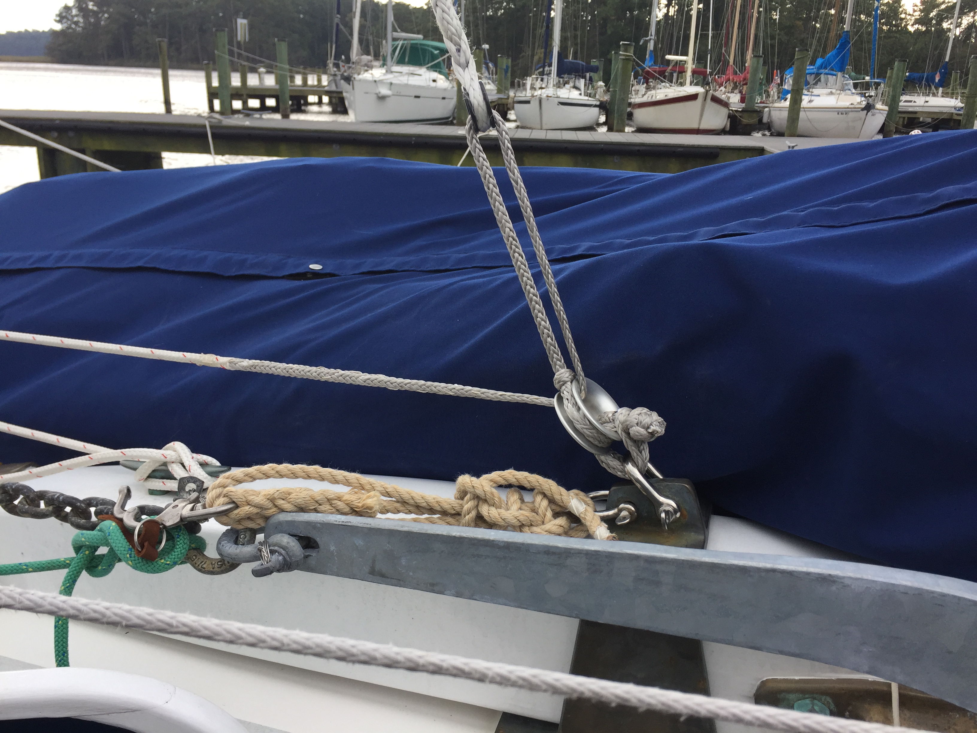

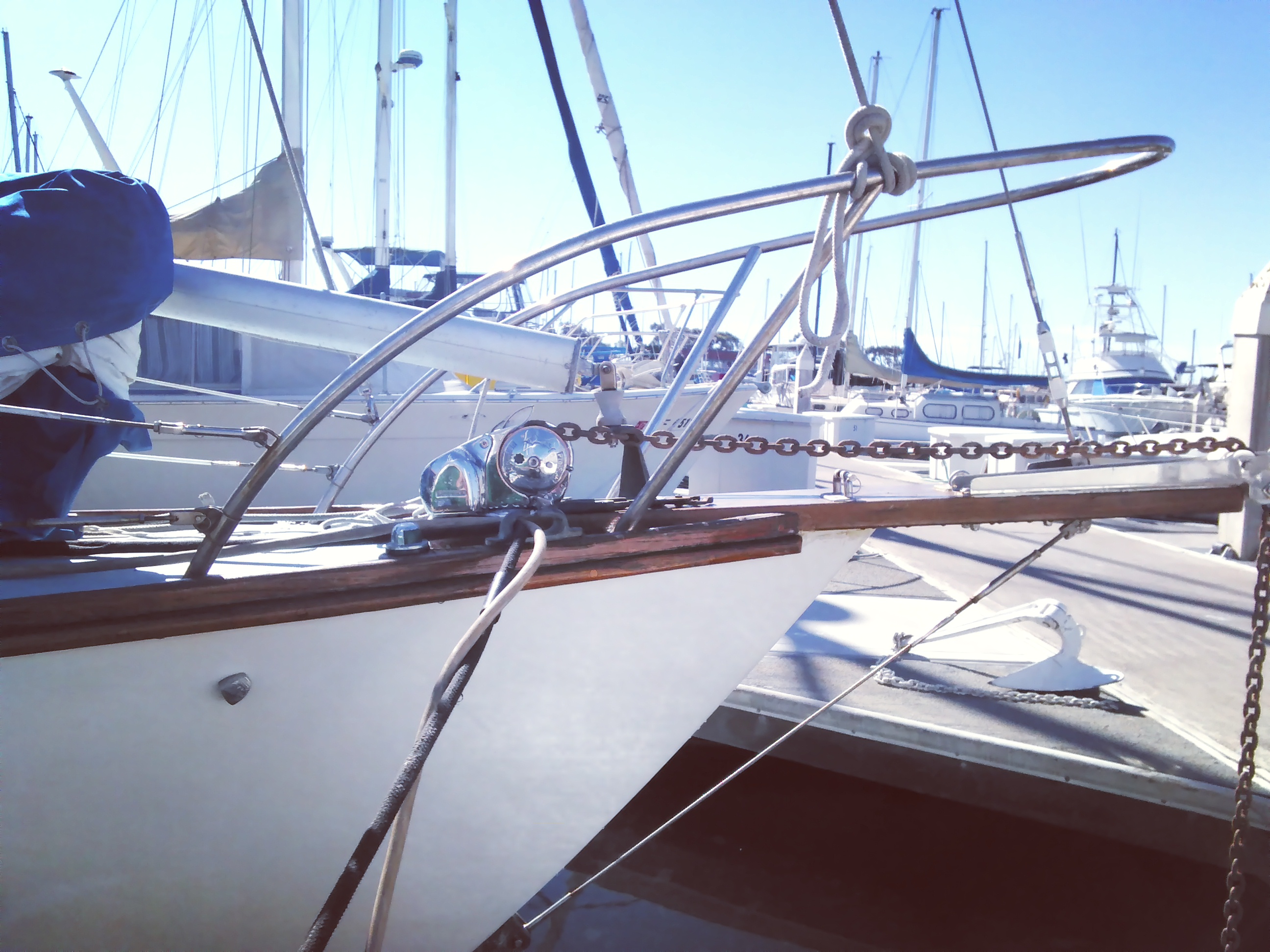

I'm hoping to get some response on my next project. My jib boom needs to be fixed and the pedestal needs modifing and the sail is in tatters. I am wondering if I should just disregard that system and install a roller furling, Self tacking is nice but so is roller furling. My previous boat had a really old roller that had to be either all the way out or in . It wouldn't work reefed at all. I understand the newer ones are roller reefing as well. I think the benefits of roller furling and roller reefing would outweigh the self tacking jib. The only thing I don't like is that I can't( i think) just drop the roller system and put up a hank-on in case something goes wrong. I suppose if I have a brand new system That would be unlikely. The third photo show how I put a spacer on the pedestal to raise the boom to clear the windlass. Maybe a block of wood under the pedestal would be good?

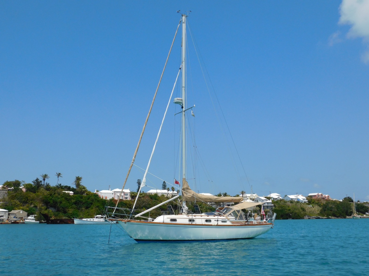

There is no need to rid yourself of your self-tacking capability unless you choose to. I have roller reefing/furling gear on both my headsail and my staysail which is club-footed. You can see from the attached photo how to rig a reefing/furling headsail so as to retain the self tacking ability inherent in the club.
Roller reefing/furling gear is so robust and reliable at this stage of its development that it is routinely used on blue water vessels. Even if the furling drum were to disintegrate you would still have a luff foil and the ability to raise and lower whatever headsails the weather dictated for use.

I guess I will try to keep things stock. It took me a while to navigate thru the rigrite website. I can see why so many are frustrated with their customer self-service. I took my boom to the boatyard and told them to verify the part no. I came up with. They can put the boom back together. That way I can get to know them if I want them to finish my chain plates next year. The pedestal need to be raised 1.75" so instead of a spacer on the top like I have in the photo, probably a block under base would be good. I'm not gonna buy a different pedestal the next size they have at rigrite is almost double the height, 9" . I also told the sailmaker here, (Ulman) to come down to measure the three sails and give me a quote. I don't know anything about That brand. I hope they are good. My previous boat I bought Doyle, Mostly for name recognition(my last name also). My sails won't last long they tear almost every time the wind blows. One good thing is its teaching me to be careful. Oh I'm probably going to sail down with CDSOA member Arch007 from San Francisco to LA. We met for dinner and he hopes to depart 11/2. It's a fun sail NW winds all the way
