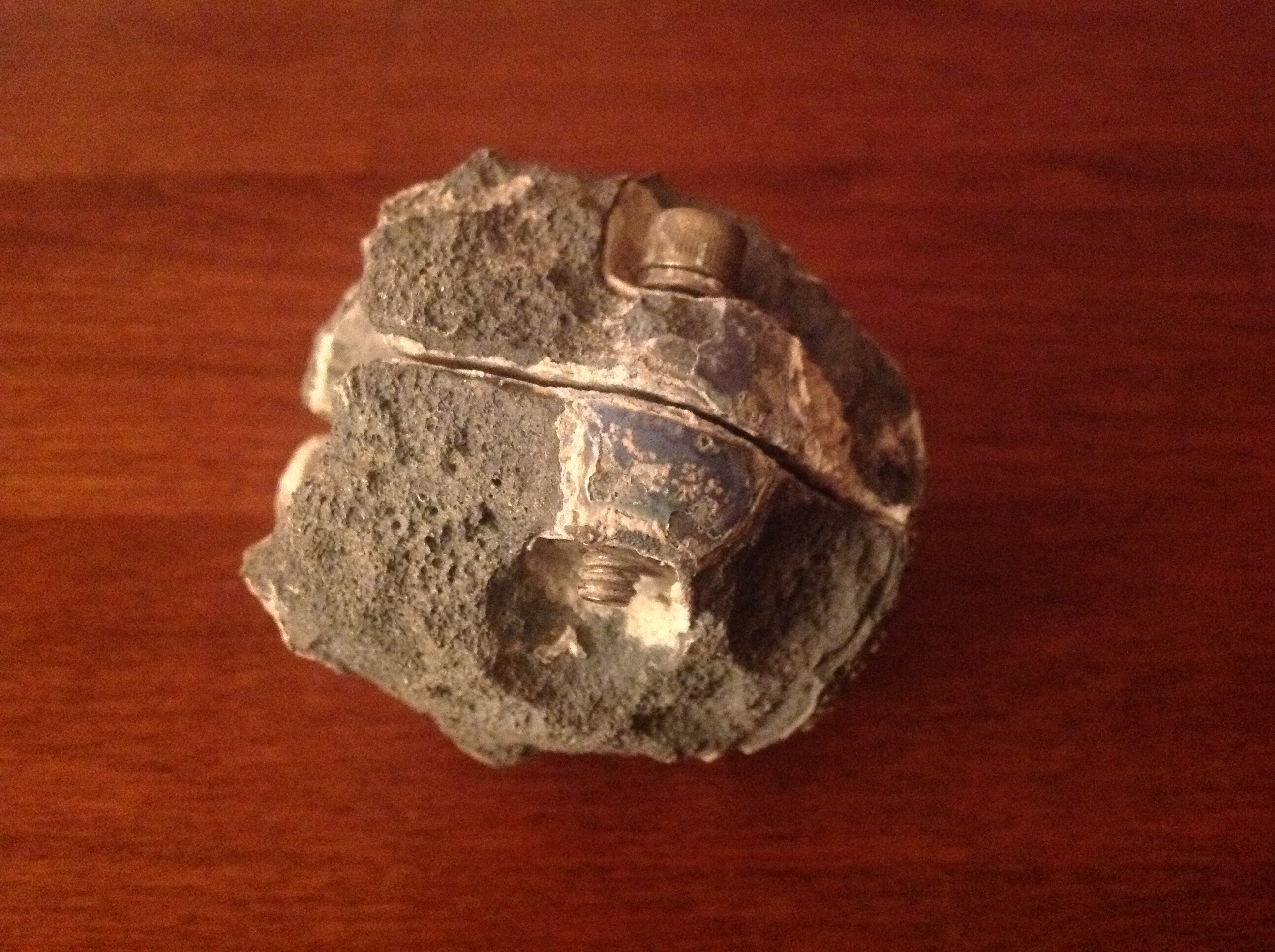

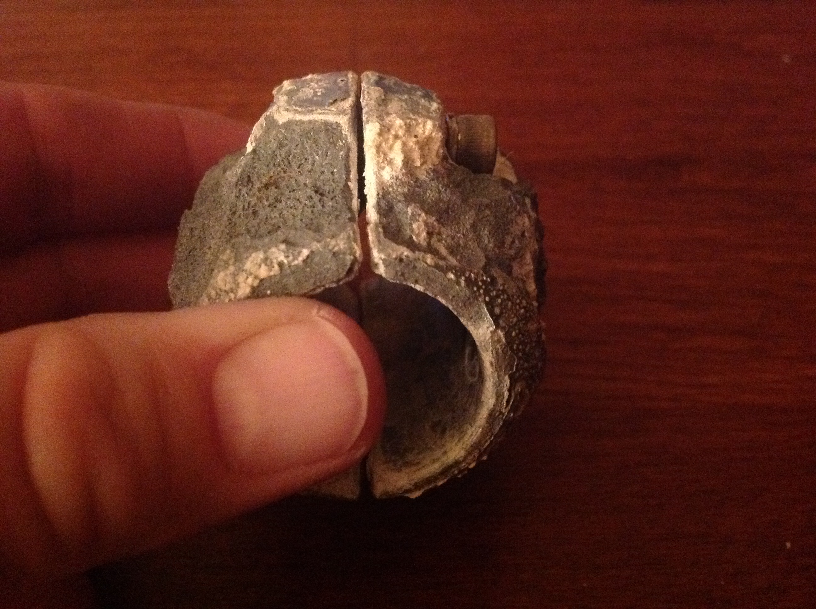

The attached photos provide graphic evidence of the value of a dab of nail polish. I apply a stripe of nail polish (dries fast, comes with an applicator, and was provided free by my daughter......doesn't get better than that :wink: ) where the machine screws bolt the two halves of a streamlined shaft zinc together. This is a simple and effective means to halt the erosion process and keeps the zinc in place through several months (this zinc was in place for seven full months) of use. Since I started doing this a few years ago I have never lost a shaft zinc.
I hope this tip may come in handy and keep your zinc in place next season.
Zinc condition after seven months

If possible, can you post a photo of a new zinc with the polish applied :?: My vision is admittedly not what it used to be but I am not sure I see the polish in your photos. Is it the "bluish" color :?:

In the attached photo the area in red would be given a couple coats of paint to keep the zinc from eroding where the machine screws are located Don't forget to do both sides :D

It never occurred to me to try the nail polish trick on the prop nut anode. It's a good idea and I'll do that this spring. Here's how my prop nut anode fared this year.
