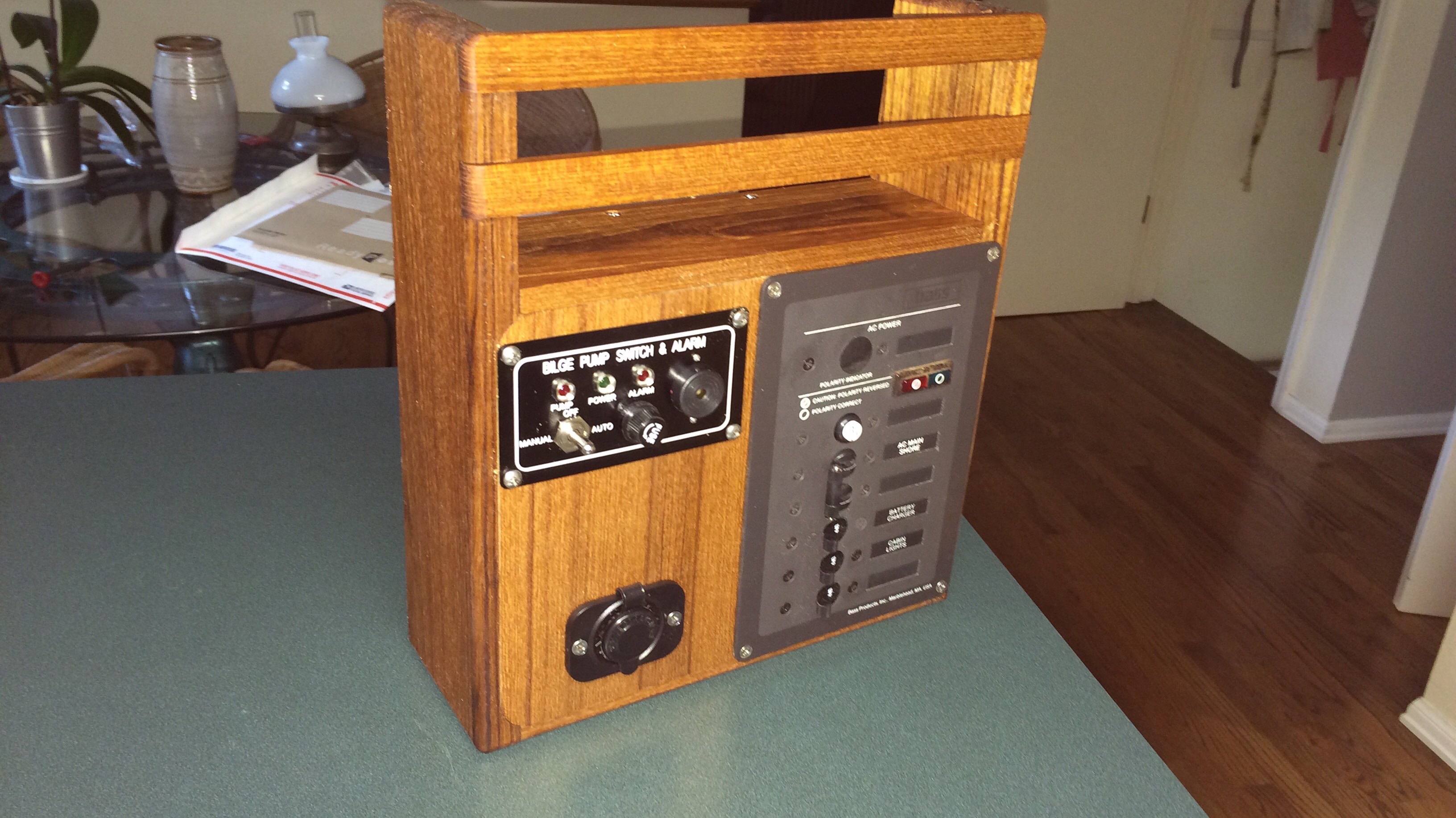

Here is a snapshot of the new Supplementary electrical Panel we are adding to Slainte. I am not sure if mixing AC and DC in the same panel is recommended, but the two are actually separated internally and this is what would fit that space we have.

I am reusing a Bass panel, but I added a new ELCI breaker. If I hadn't had the Bass panel I would have gone with a Blue Seas panel. I like them.
I will be posting a picture why the panel is installed.

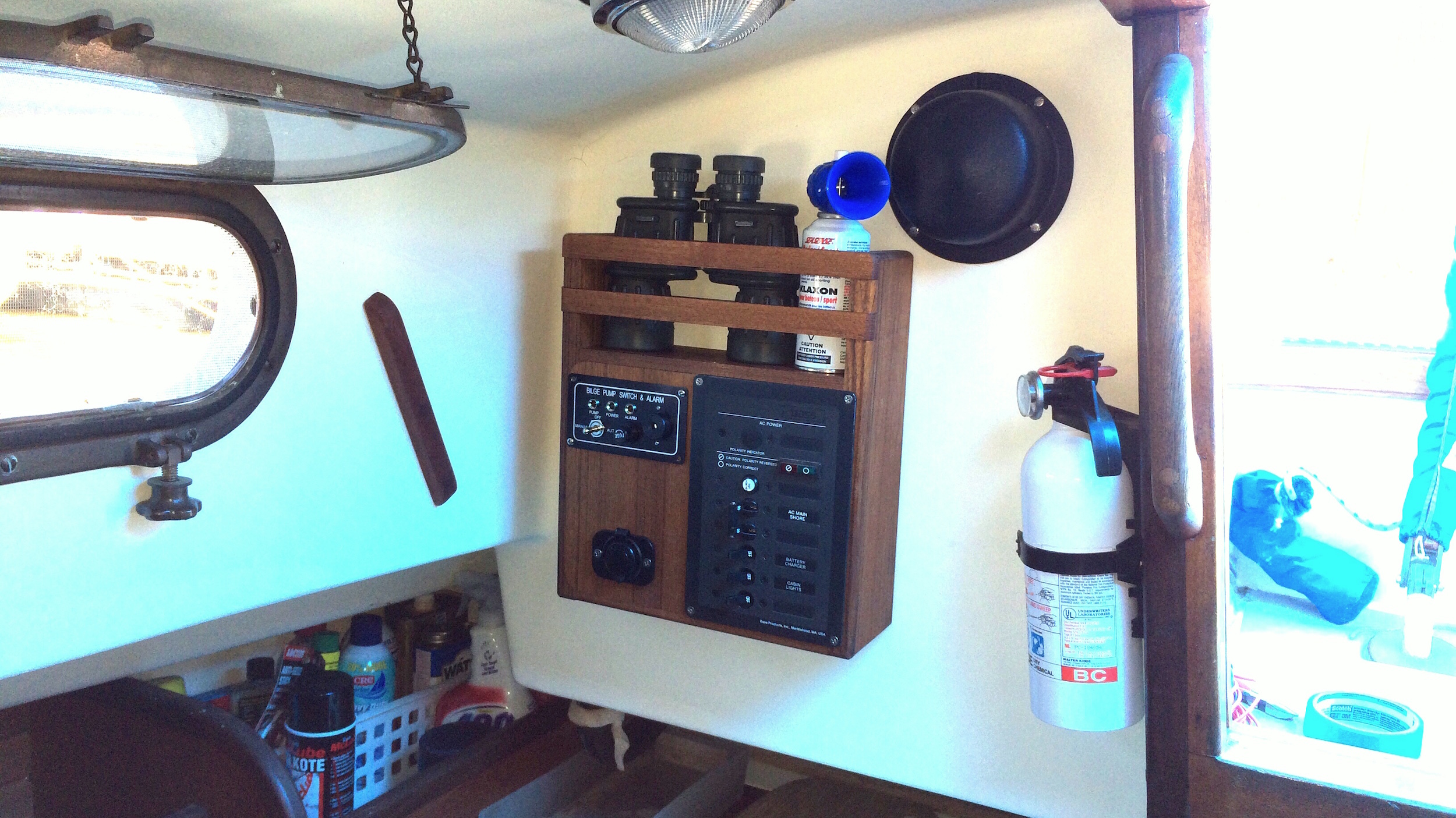

After a long delay the new panel is finally wired and installed ( with the wires going through the breaker and then the sensing coil ). We will plug her into the shore power tomorrow when I will have a helper on shore. I am very happy with the way it turned out and the bonus binocular rack. :D
I am amazed at how many boat bucks were sunk into Anhor heat shrink ring terminals :cry:

Re: Electrical Panel
Very neat. I like it a lot. Planning, execution, and results meshed nicely.

Very nice job, Looks like it could be original.

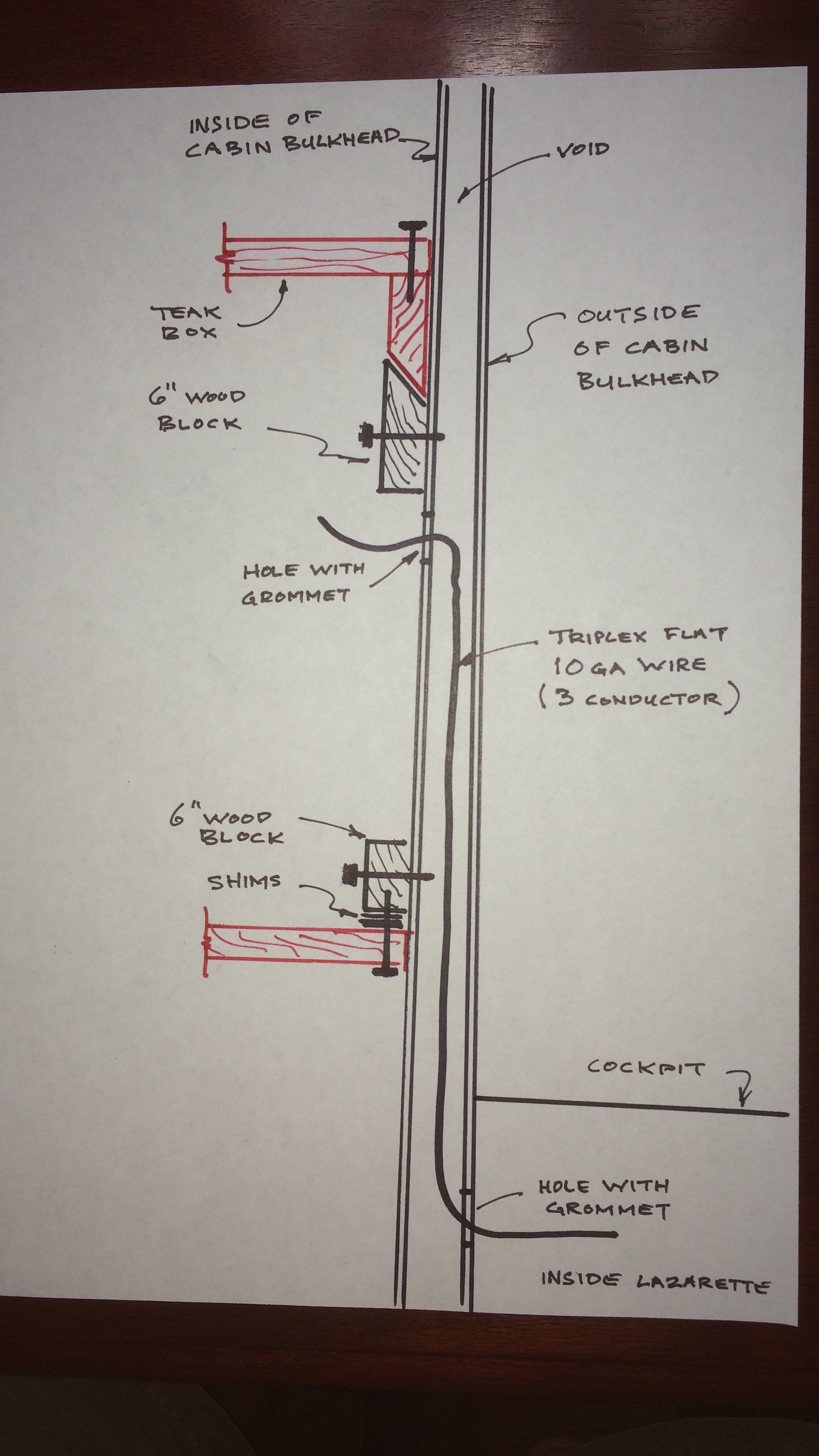

Steve, I used Teak for the panel enclosure. I had some leftover from the days when it was $9.00 a board foot! If I wouldn't of had the Teak I would have used Cypress or Mahogany. I like Cypress because once stained and varnished it looks a lot like teak. Fishing the wires was the hardest part of the installation. I ended up using two fish tapes one down from inside and then another up from inside the Starboard lazarette. Use the most flexible fish tape you can find. It would have been easier with a second person working the other fish tape. Once I got the fish tape through I used the wire puller that looks like Chinese (sorry Roberto) Handcuffs and was able to pull 10 gage flat triplex wire through the 1" diameter holes that I drilled. I had to do this for five different wire runs; the AC Main, then AC distribution, the AC for the Battery Charger, the DC for the power Socket/cigarette lighter, and for the seven wire bundle for the bilge pump switch. So I have five 1"diameter holes through the inside skin of the cabin bulkhead and five 1" diameter holes through the fiberglass bulkhead that separates the cabin and the lazarette.
For attaching the box, I used the same method that you would use to hang heavy cabinets in a house. Wood blocking with a 45 degree cut (see the sketch).
Section Thru AC Panel.jpg (871.97 KiB) Viewed 1240 times
The Panel enclosure changes off of the block and then shims under the lower block pull it down good and tight. A couple of wood screws hold it all together and it is easily removed if I ever need to rewire.

thanks for the cross section. the hard work is always the planning. that makes all the difference. well thought out plan. looks really nice.
