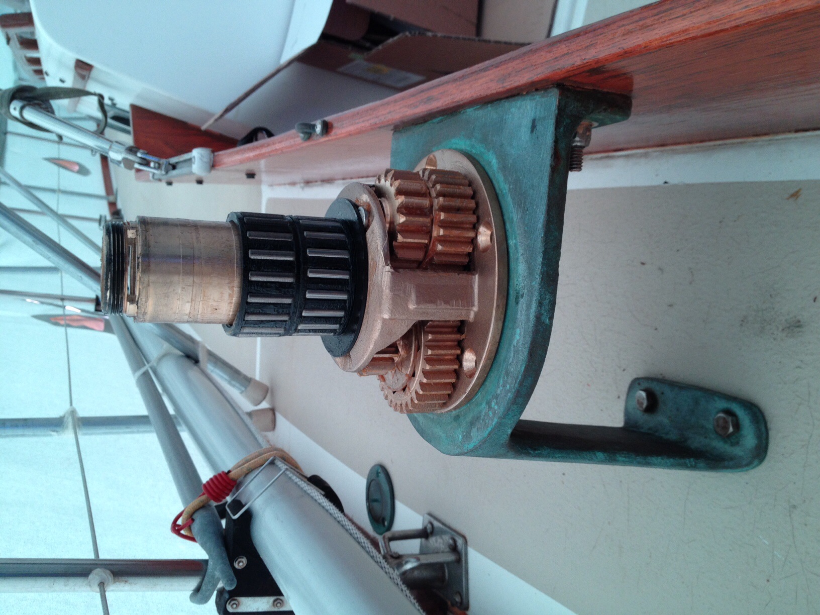

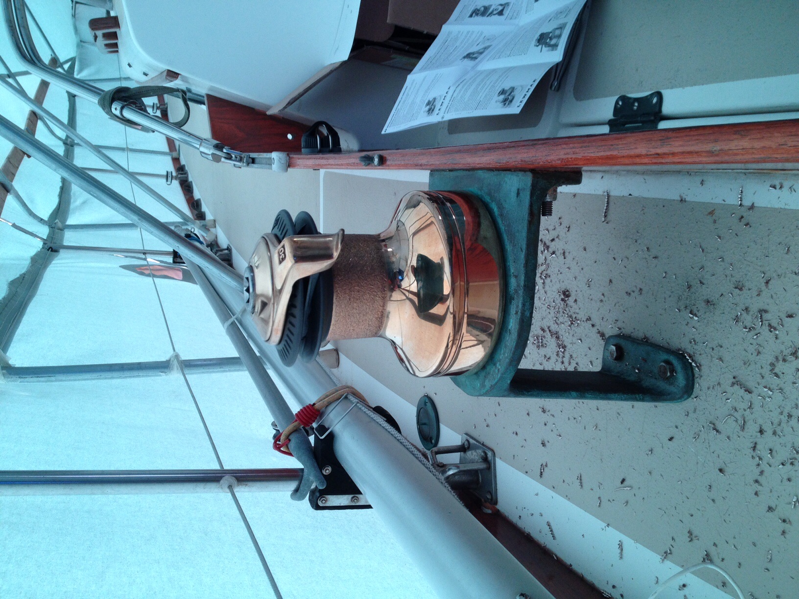

Removing the old winches was simple and straightforward, no problem whatsoever. The original winches were attached to the winch bases with stainless machine screws and there was no evidence of any bedding compound. Even though the current installation instructions call for the use of bedding compound I chose not to. Of course, the hole pattern was not the same so new mounting holes had to be marked, punched, and drilled. I clocked the base slightly since the old and new hole pattern overlapped in a couple places, being careful to keep the load perpendicular to the output gear. The punch marks help the drill from drifting initially, and a new drill doesn't hurt either. After drilling the 1/4" holes the fun part was fastening the winch base with the stainless 1/4X20 machine screws, washers, and nylock nuts. Don't forget the carpenters advice, measure twice and cut once. I measured, marked, and dry fitted at least twice before I drilled the new mounting holes. I torqued the nuts to about 20 foot pounds. Reassembling the winch was a thrill and admiring the finished product was even better. ORION is ready for her next 30 years!
Today was in the low 40's and sunny but it felt much warmer under the winter cover. The breeze was off the 33F water so I kept the door closed!
- New mounting holes drilled in base

- Base ready to be fastened
- image.jpg (486.47 KiB) Viewed 1095 times
- Success!
- image.jpg (612.14 KiB) Viewed 1095 times

Jim, in your photos, it looks like you drilled the new holes very close to the old ones. I went the other way and spent a lot of time trying to figure out how to drill the "new" holes for the new winch so that they were as far away from the "old" holes as possible. My reasoning was that two (2) holes drilled close together (one old, one new) would weaken the winch stand base at that location. That's probably just my lack of knowledge about bronze but ...........

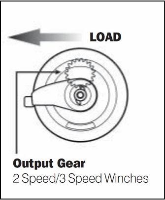

There are a couple black dots visible which are early positioning attempts. I actually used one of the existing holes and drilled four new ones leaving some "meat" between old and new. Of primary concern was ensuring the output gear was perpendicular to the load. All five fastening would have to shear through the bronze base so I'm confident they are staying put.
Re: Sheet winch upgrade
Jim: Can you explain this statement a little more and bring it down to a level I can understand.Jim Walsh wrote:Of primary concern was ensuring the output gear was perpendicular to the load
The load from your sheet should lead to the output gear of your winch. The output gear is the largest gear seen in the second photo of my original posting. Here's a photo and a diagram that might be helpful. The output gear is the large gear seen on the right side of this photograph.

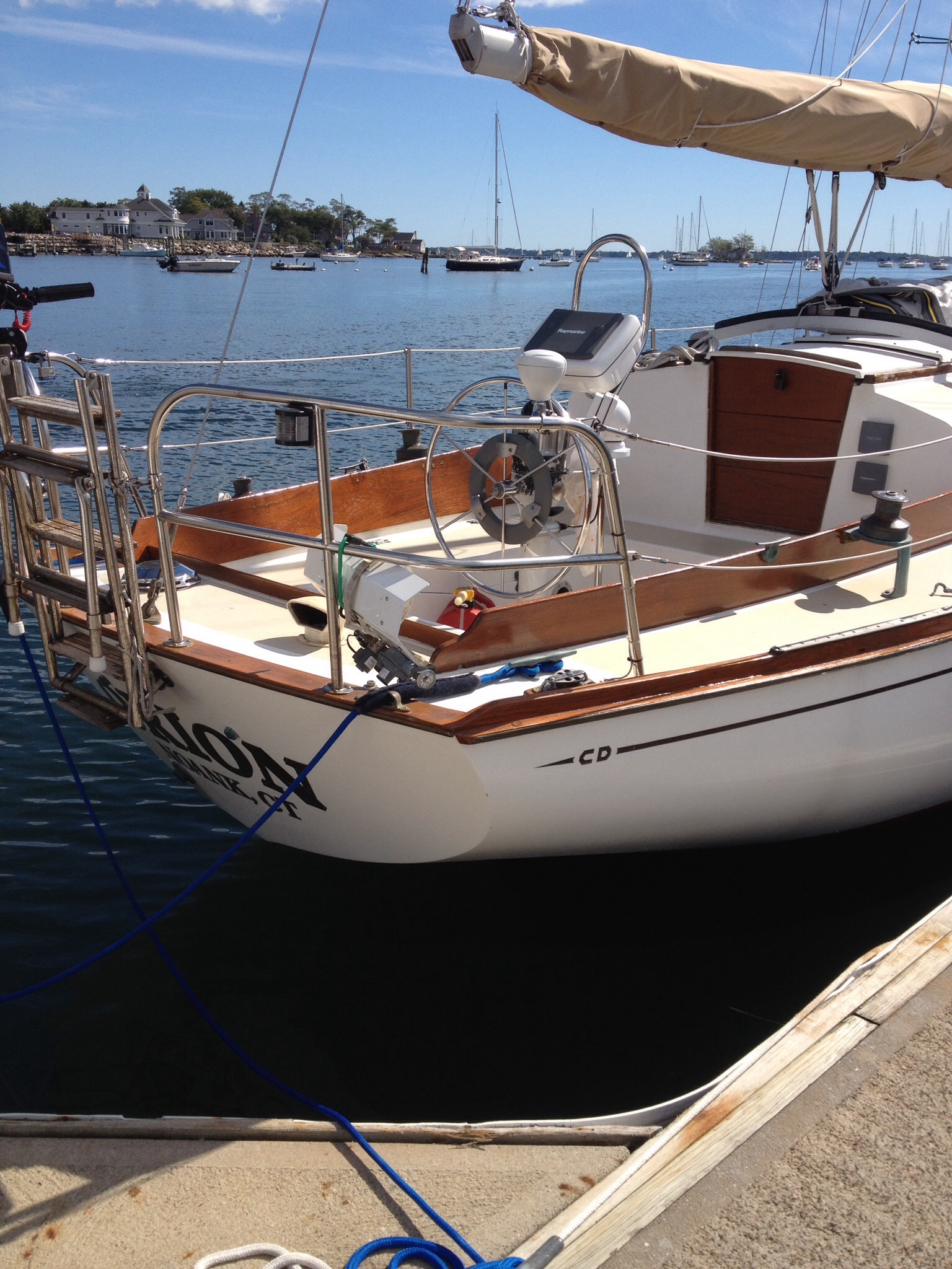

I just thought of what might be a little confusing. My sheets are led aft to turning blockes at the stern then forward to the winches. Here's a picture which shows my starboard turning block, it's right near the starboard aft cleat. This photo doesn't show the sheet since I took it off while in the middle of varnishing.
