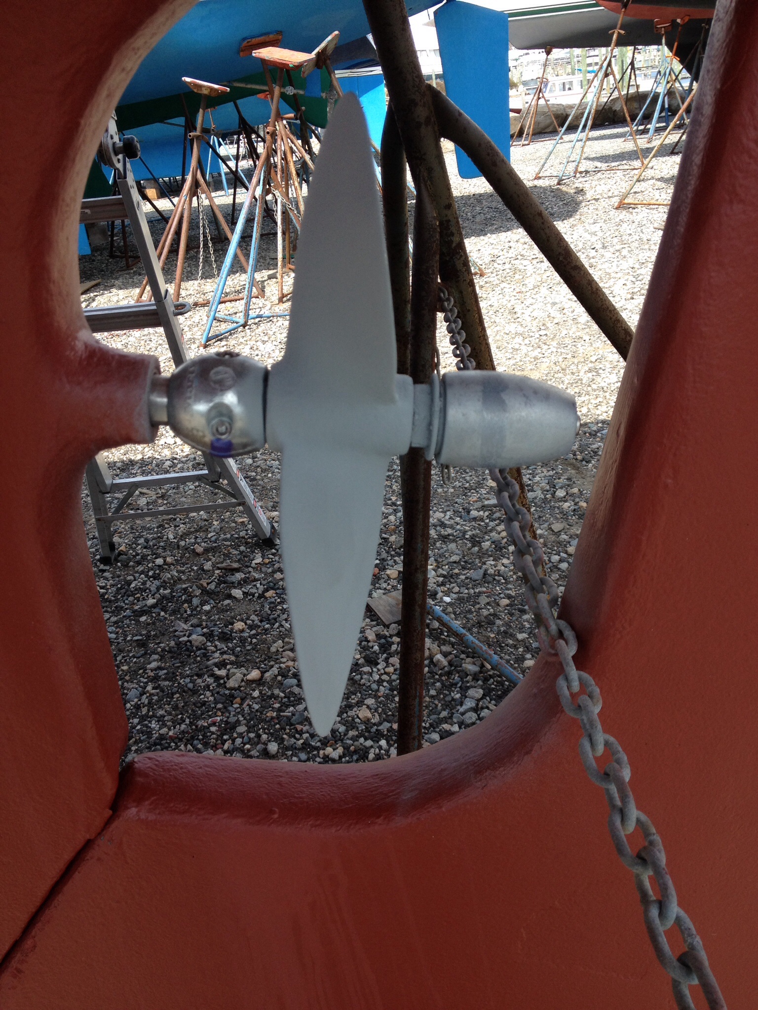

After reading other members accounts of using zinc paint, or "cold galvanizing compound" as Rustolem describes their product, I decided to give it a try this year. I had always just painted my prop with bottom paint. I know it's not considered a good practice but scores of owners still do it and so had I since the 60's.
I also decided to augment my prop nut style anode with a "streamlined" shaft zinc. I trimmed it by a half inch, or so, for a better fit. Ill have to update this posting with the results of my experiment in the fall.

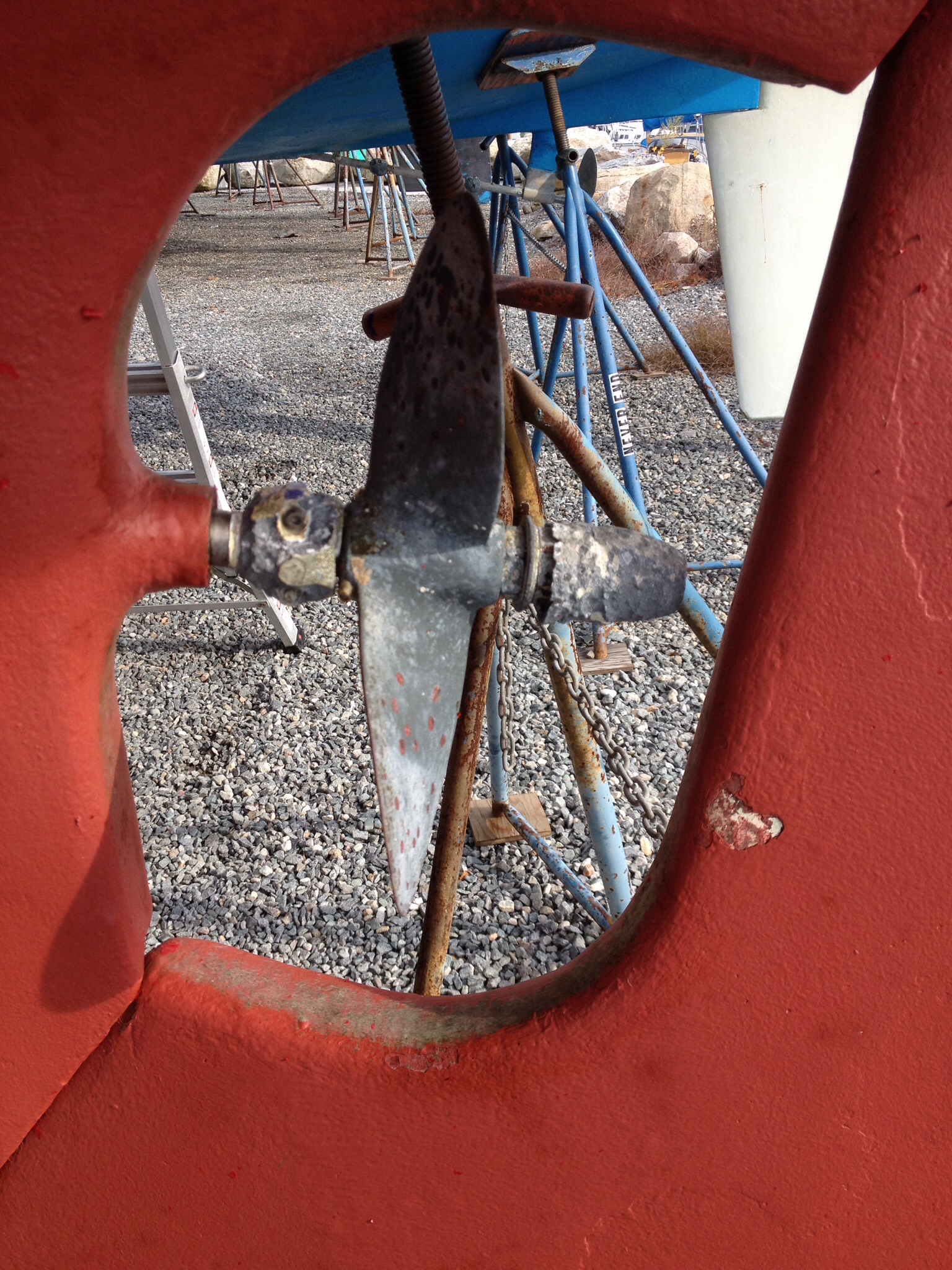

This is the result after 6 months in the water. The shaft zinc worked out fine. The prop-nut zinc was rattling in place. This is the first time I've had it deteriorate so much. The cold galvanizing spray worked great. I had a couple 1/4 inch barnacles attached to the hub and nothing on the blades of the prop. The red freckles on the prop are where the old bottom paint, which had not all been removed prior to applying the cold galvanizing spray, flaked off. I'll spend a little more time with the sandpaper and try to get the prop cleaned up properly before applying the new coating in the spring. I'm now a true believer in this anti fouling technique for props. It's real cheap, real easy, and damn effective.
