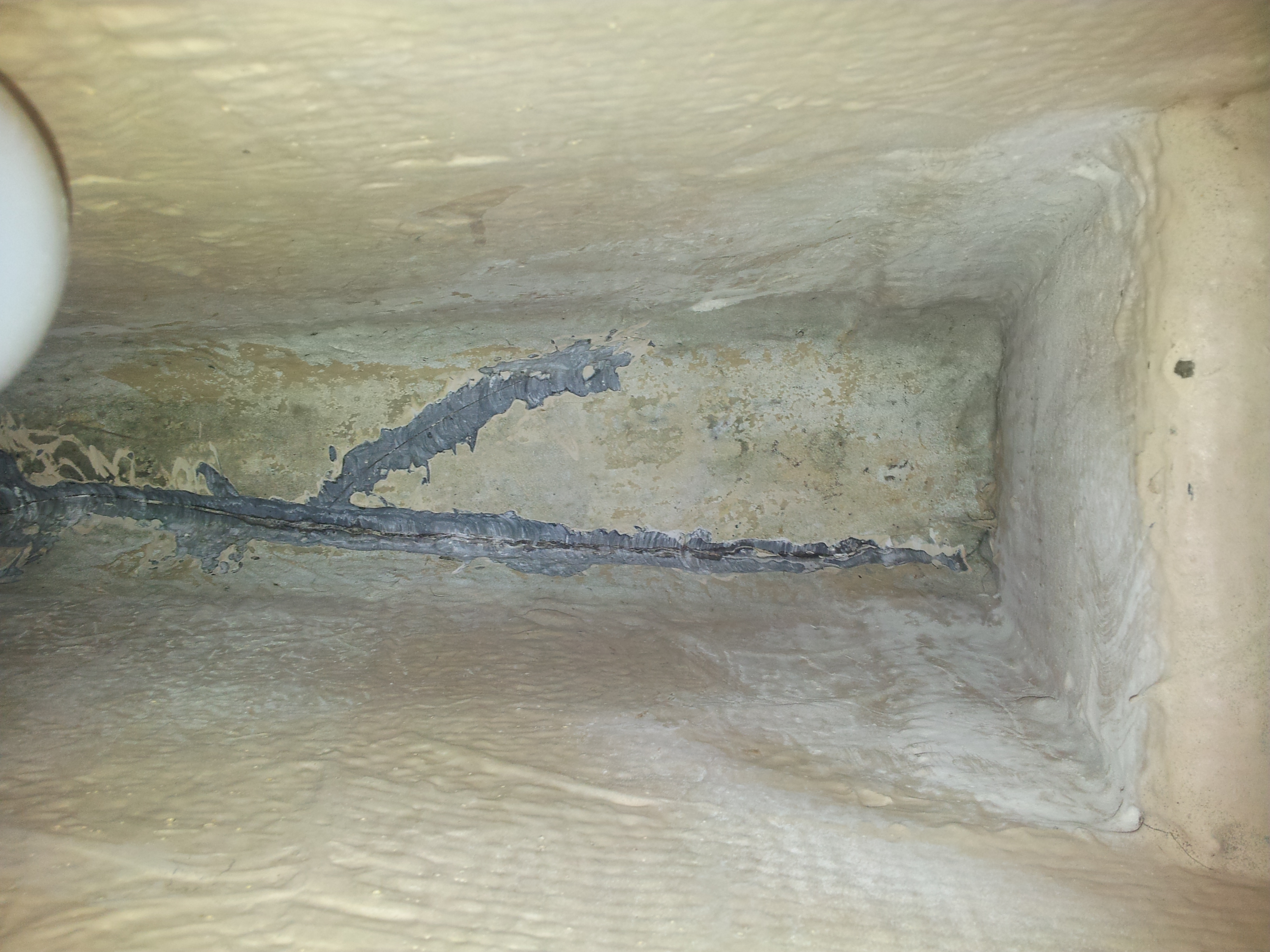

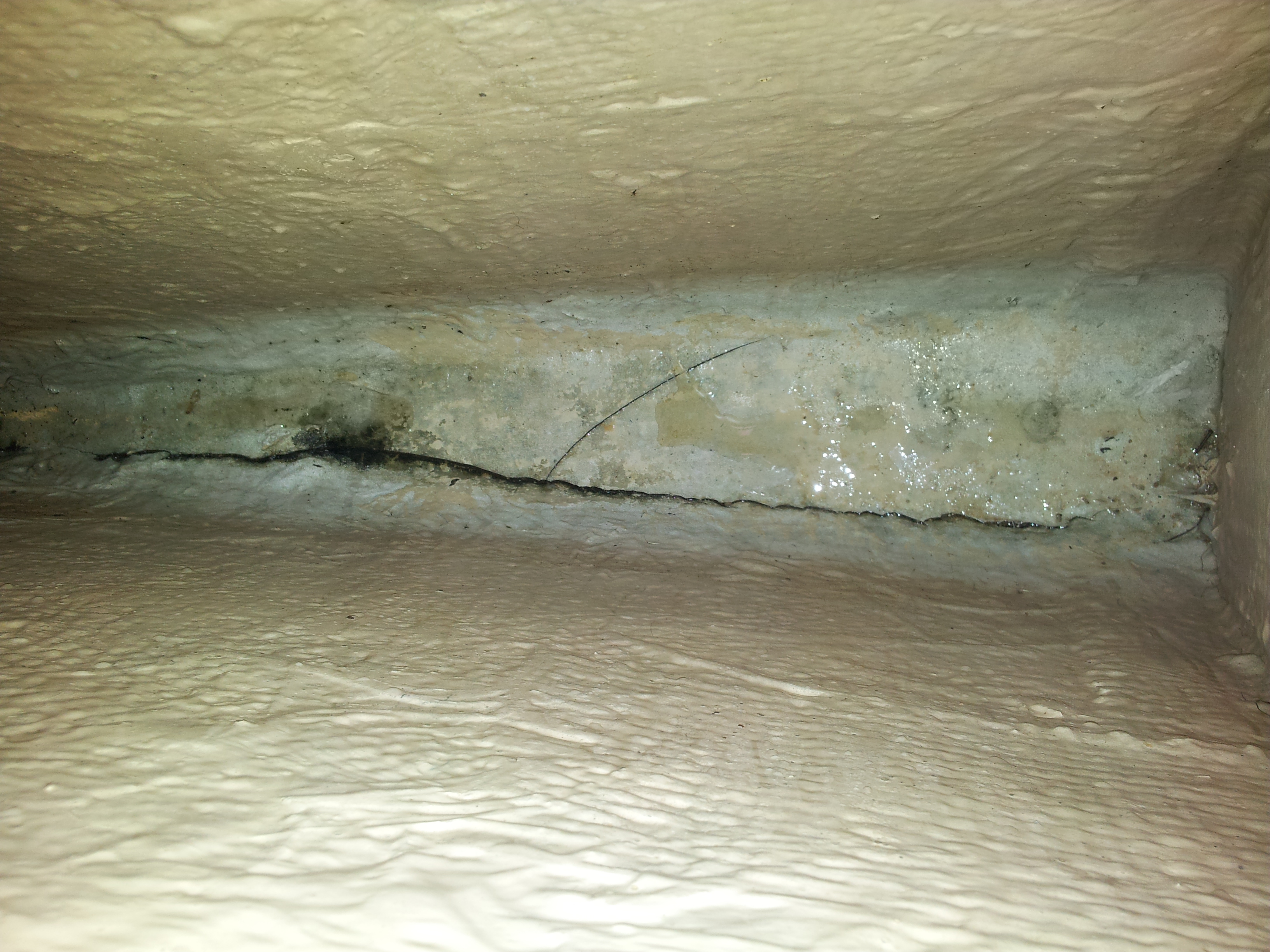

Hello all,
On a 1981 CD 27 (new to me) after TSP'ing the bilge in preparation for epoxy paint, a crack running the length of the bilge was discovered. It appears to be as much as 1/4" wide in places with another arm shooting off about 1/8" wide. The bottom is blistered and has been prepped for a barrier coat. There are a couple of small impact repairs low on the keel that continue to weep moisture though they are not in proximity to the bilge. Photos of bilge and one repair low on keel attached.
Anyone experience cracking of this nature in the bilge?
Does this look like de-lamination issue due to the bilge being constantly saturated or does it look like a structural (ie keel impact...etc) issue? Any thoughts or advice would be greatly appreciated!
I plan to grind the cracks to see if / how far the crack extends into the laminate. Then if the problem doesn't appear too serious (ie. structural) fill, glass and epoxy paint
Should I be more concerned about a structural issue at this point?
Dave.
Dave.

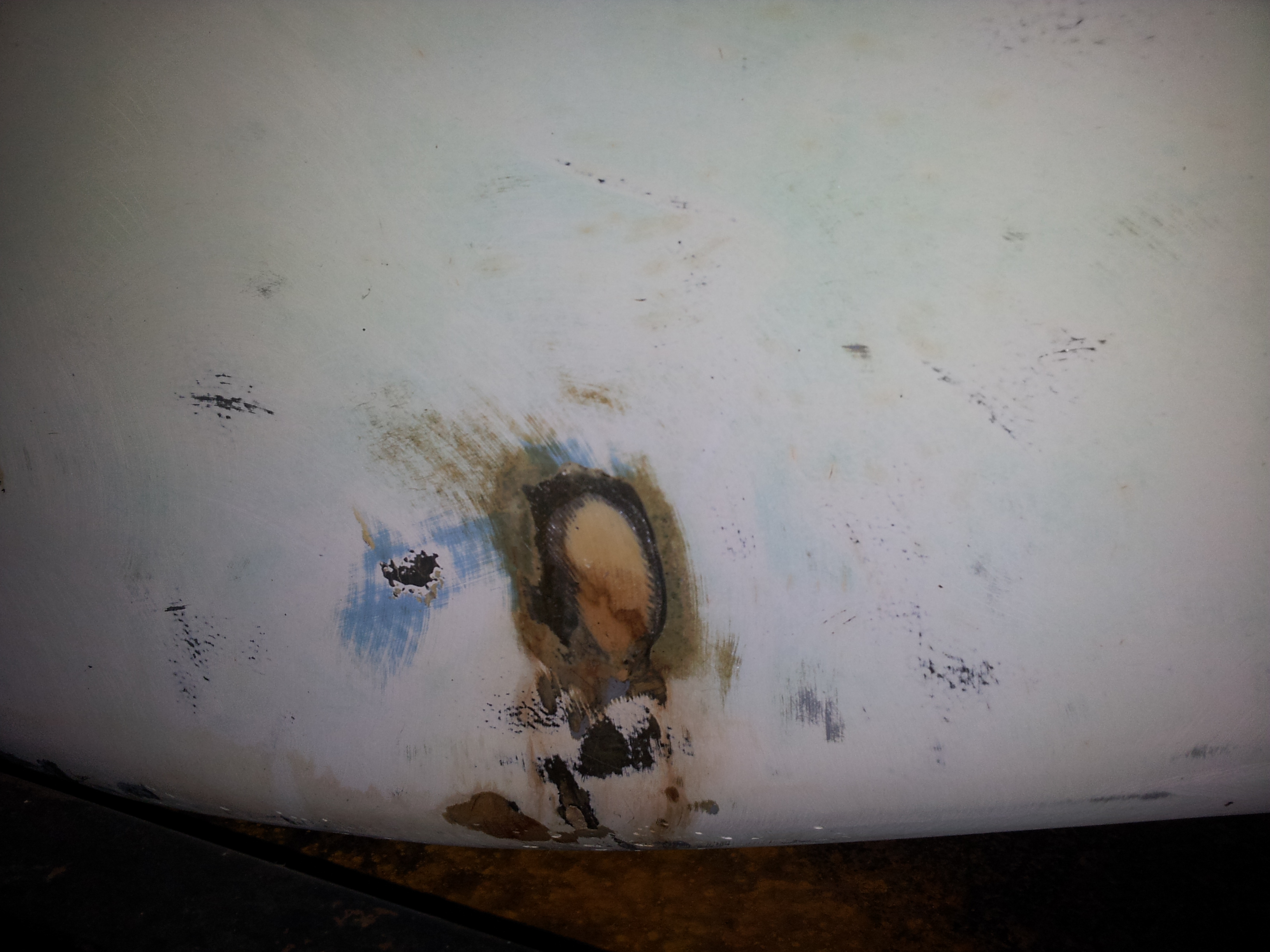

- WEEPING KEEL REPAIR
- 20130430_141515.jpg (2.07 MiB) Viewed 1333 times

We have a 1981 27 too and I cannot picture where you are in the bilge. We don't have anyplace that looks like that on Sláinte. Can you give me a better idea of where this area is? Have you tried to probe the crack to measure the depth? Where is (or was) the boat located? Could that be freeze damage?
- Posts: 4131
Re: CD 27 BILGE CRACK
That certainly looks like damage from freezing. If it wasn't in the bottom of the bilge it would be a pretty straight forward repair. Getting down in there will be the hard part.
I would drill holes at the end of the cracks to relieve stress then grind away both sides of the crack to get as much taper as you can and clean up the contact area for the repair. Drying out the ballast area as much as possible before you seal it would be a good thing but I don't have any advice on the best way to go about that. Once it is clean dry and prepped, make up a patch of glass layers with epoxy. The first layers you set down should be the widest and turning up onto the inside of the hull would help to bind things. The successive layers of glass should get progressively narrower until you build up a laminate at least as thick as the surrounding area.
Then you can go back and do the painting you set out to do in the first place, Steve.

Yes the boat lived in Illinois for most of its life so likely freeze damage. Hope so. There are couple of weeping keel repairs that I don't believe are related by impact damage etc. Wet laminate is likely sending bilge crack moisture through the path of least resistance.

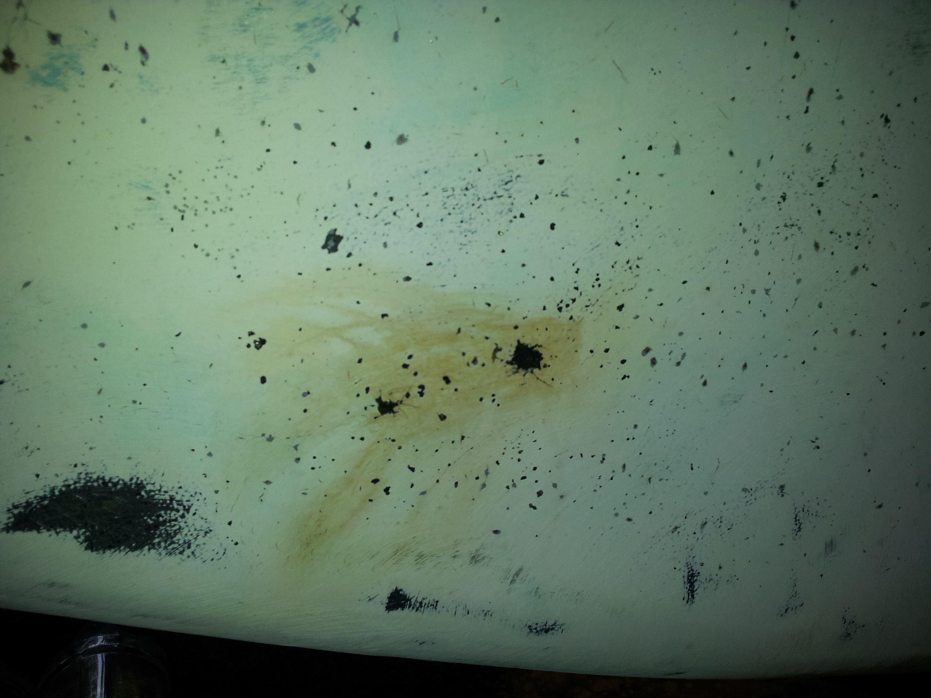

....ps could this rust colored weeping be tainted from the cracked bilge leaking into the lead ballast ( apparently lead does not rust though ) or is it a polyester resin reaction to moisture in the laminate?

...sorry, picture.
- Rust colored weeping
