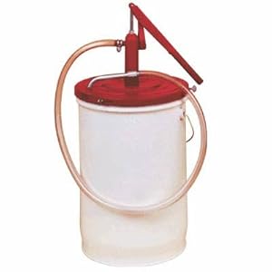

Has anyone got a good pump or pumping system for changing their oil?
I have what I thought was a nice little pump, but it spewed dirty oil on me and the cabin today.
It looks like this:
LINK
I was all set up nicely: cushions out of the way, plastic covering the sole, a round, shallow plastic tray on top of that, shop towels to hand, you probably know the drill. I find this a pretty dicey procedure, holding and pumping and trying to keep the two hoses where they should be, etc.
Anyway, I had great peace of mind until the lower (output) hose gave way under the pumping pressure, and spewed (maybe a cupful). That spew, of course, got me from the knees down, as well as everything else in sight.
Anyway, long dirty story. It's mostly all cleaned up now, but it kind of spoiled my afternoon, and I'm sure there's a better way to do it.
Anybody ready to point me in the right direction?
Maybe something like this, only a bit smaller? It looks steadier and better made anyway.
LINK
EDIT:
Or maybe this one - looks like the right size, anybody use one?
LINK

In defense of the small red hand pump
Post by Warren S »
Those work great for pumping diesel fuel out of a contaminated tank. I think it really is designed for fuels rather than heavy oils. I do on the other hand have the canister pump from West Marine. It works so well I also use it on the car rather then jacking and crawling under.

I had the previously shown little red pump and it did work for the last nine seasons but not without serious risk of oil spillage in the galley, large amount of worry and oily hands and thus everything else. Boy I came close to major environmental disasters. I cannot recommend it for one who wants to change oil frequently as it does not encourage it.
I too will be looking for a new oil change system and have heard of the copper tube system. The $41 Defender piece looks like the one for me. I cannot justify an electric system and I have fully outgrown the old Jabsco red pump.
