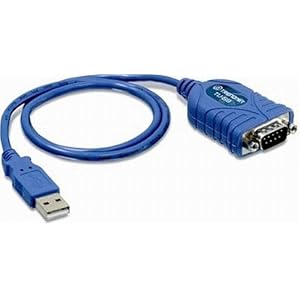

Well there is a significant amount of history there. The old 9 pin serial port (RS232) was more or less electrically compatible with NMEA-0183. A GPS that comunicated via the old standard RS232 serial port interface could also talk to auto pilots, DSC radios and computers with navigation software. I'm not sure when the GPS Map 76 came out but it's at least 9 years ago. Back then USB was new, few computers had it and even those that did had many problems. MAC's as nice as they are still only represent less than 10% of the PC market, software developers will go for the low hanging fruit.
The good news is that you can purchase a generic USB to serial adapter for less than $20. Just make sure it works with the version of Window's you are running. You may find some old ones that won't work with Vista or Windows 7.
Here is one on Amazon that looks ok on paper for about $15.
http://www.amazon.com/gp/product/B0007T ... 9JW5CJYZV3
Dean I do have one of these adapters (older model) on the boat (for my old laptop that died) but I'm not sure it will work with my current laptop (Vista 64) , something I should really check.
Carl, the Map76Cx has a USB cable, the Map76 doesn't.

I've been using my GPSmap 76 (with a plain old 76 as backup) for years. When I got a new computer, I ran into the same problem you had.
I bought a generic Serial-to-USB converter, like the one shown in Rich's posting, and it didn't work.
After a call to Garmin's excellent customer support people, I ended up buying a Garmin-made USB compatible cable, for about $60. Everything has worked beautifully since then.
However, I've gotta agree with Carl that Hamilton should not have sold you a unit that came packaged with a serial-port cable. I'd take up the issue with Hamilton--they've always done right by me, and most other customers.
You'll get lots of miles out of your Garmin.

I have a Mac and a 76map GPS. Here's how I got it to work
1.) Purchased VMWare Fusion software to run Windows OS on the Mac
2.) Purchased serial to usb converter cable. I think it was a Keyspan cable.
3.) Instal the Garmin software in the VMWare session and plug the cable in to the USB port.
This configuration has worked for me. All charts and firmware updates have worked. I've never been able to figure out why Garmin refuses to support the Mac OS.
