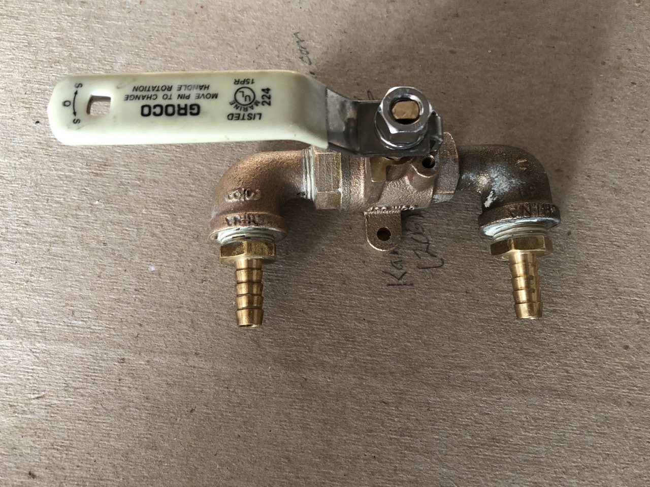

It took most of the day to figure out why I could not prime the fuel system. I was detaching fuel lines, blowing air through them to find obstructions, moving the priming bulb slowly up stream. For awhile I thought maybe an issue with the tank as implausible at it seemed. I relocated the first ball valve from up high in the port locker to the engine space level with the top of the tank. Still would not prime though.

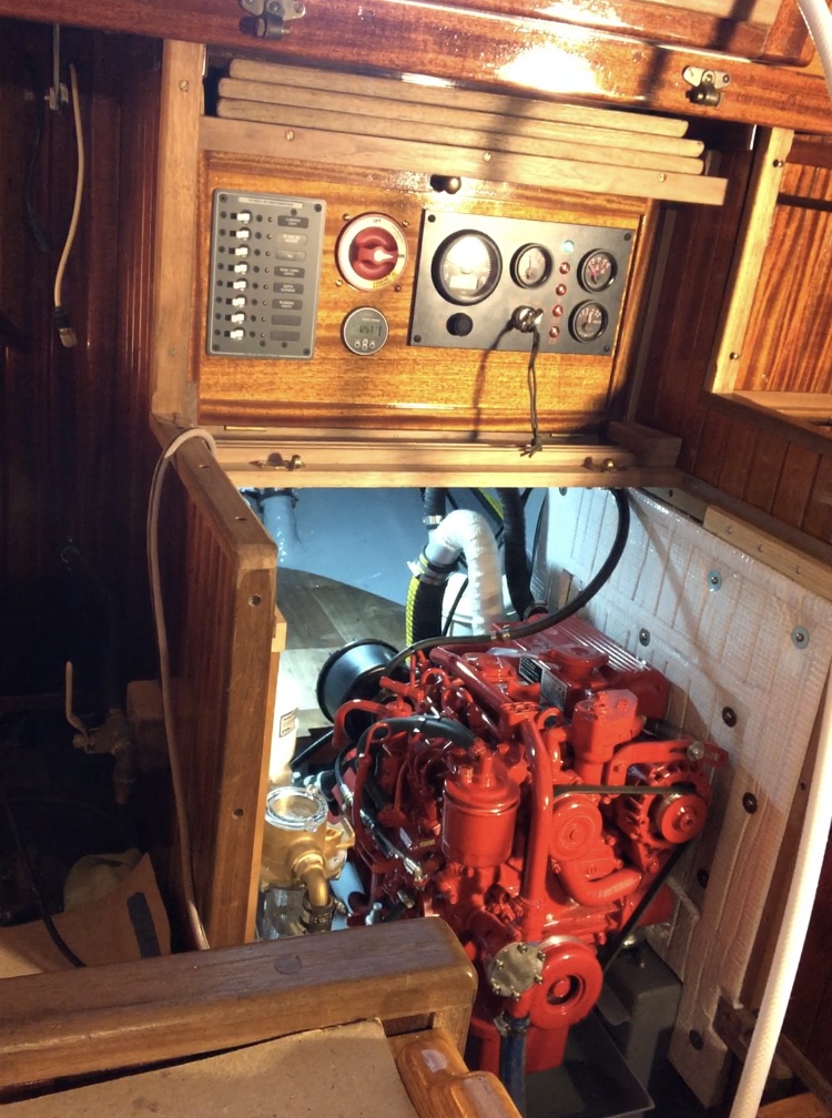

Turns out it was the first ball valve...I finally removed it and in five squeezes fuel was rushing into the Racor filter. For the life of me I don’t understand how or why the fuel would not pass through it. I blew air through it when open and could not when it was closed. Anyway, once fuel made it to the Racor it was a simple matter to bleed the engine fuel filter. When I hit the start key the engine instantly fired and went to a good idle. I ran it for 5 min and then shut it down and checked fluids. All good. No leaks and only one drip off the water lock muffle which I took care of by tightening some hose clamps. Then I started the engine again and advanced the throttle a bit to maybe 1200 RPMs and let her run for 25 min. The house bank charged right up.
I am very pleased which is an understatement.
I wish I could post the video I took of the start up. Alas, a photo will have to do.
This was the culprit.  Maybe it was the Chinese elbows...
I have a Moeller Marine brass fuel shut-off between my tank and the fuel/water separator. Not as rugged as the ball valve but entirely sufficient for the task.
It’s nice to hear that your engine has been test run successfully.....congratulations.

Thanks Jim. I still have another Groco shut off between the tank and the engine. Right before the Racor. But the one I removed was close to the tank and accessible through the locker. It’s weird fuel wouldn’t flow through it.

Congrats John! It's a wonderful feeling.

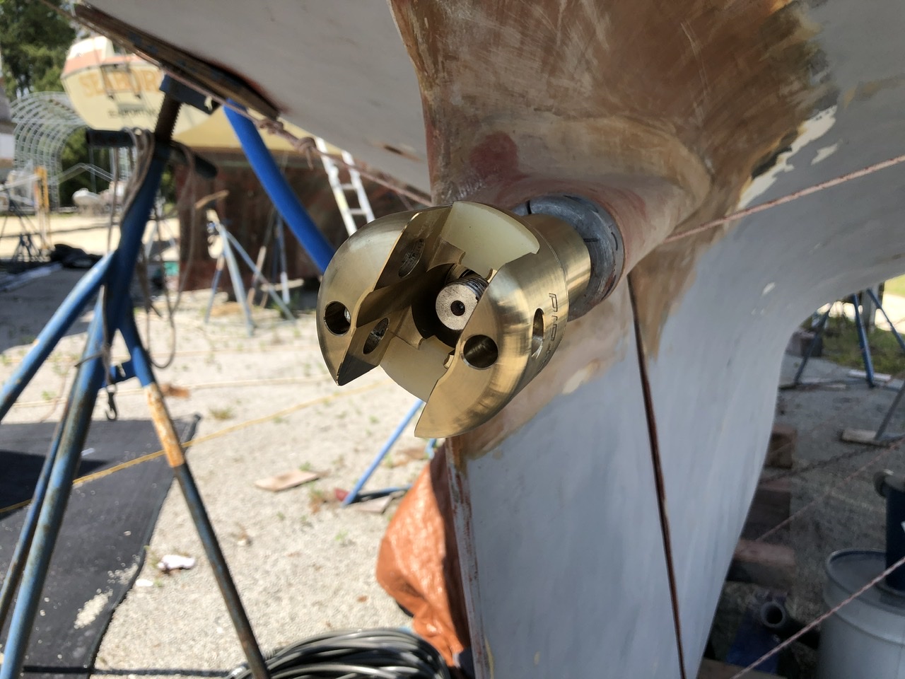

After I topped off the tank I tested the propeller puller I made in the shop last night. The issue is if Flex O Fold did not get the pitch right on the folding two blade they will exchange the blades for free. The catch is the prop can’t be painted nor can it be in the water more than a week. So, I need a simple way to remove the propeller in the water. The blades have to be removed before the shaft nut can be removed which holds the prop on. Shouldn’t be too hard unless I drop something. So Ill need a weighted bucket. But you still have to pull the hub. Hubs can get seriously stuck to the tapered shafts. Standard wheel puller doesn’t fit. Flex O Fold makes a prop puller but it’s universal and fits all their props, it’s big, it’s expensive. So I made my own by laminated scraps of 1/2” and 1/4” G 10 together with West epoxy. I drilled a recessed hole in the center using a 7/8” fostner bit and epoxied a SS nut for 1/2” bolt into the recessed hole. When cured, I filed two recesses in the G 10 to align with the two holes in the hub that hold the blades on. I cut down two 1/2” shoulder bolts. The shoulder bolts lock the G10 in place. Then tighten the center bolt down with a 3/4” wrench on the end of the shaft which pushes the hub off the shaft. I finished the day by using a scraper to clean up the top edge of the waterline in preparation for hard bottom paint.

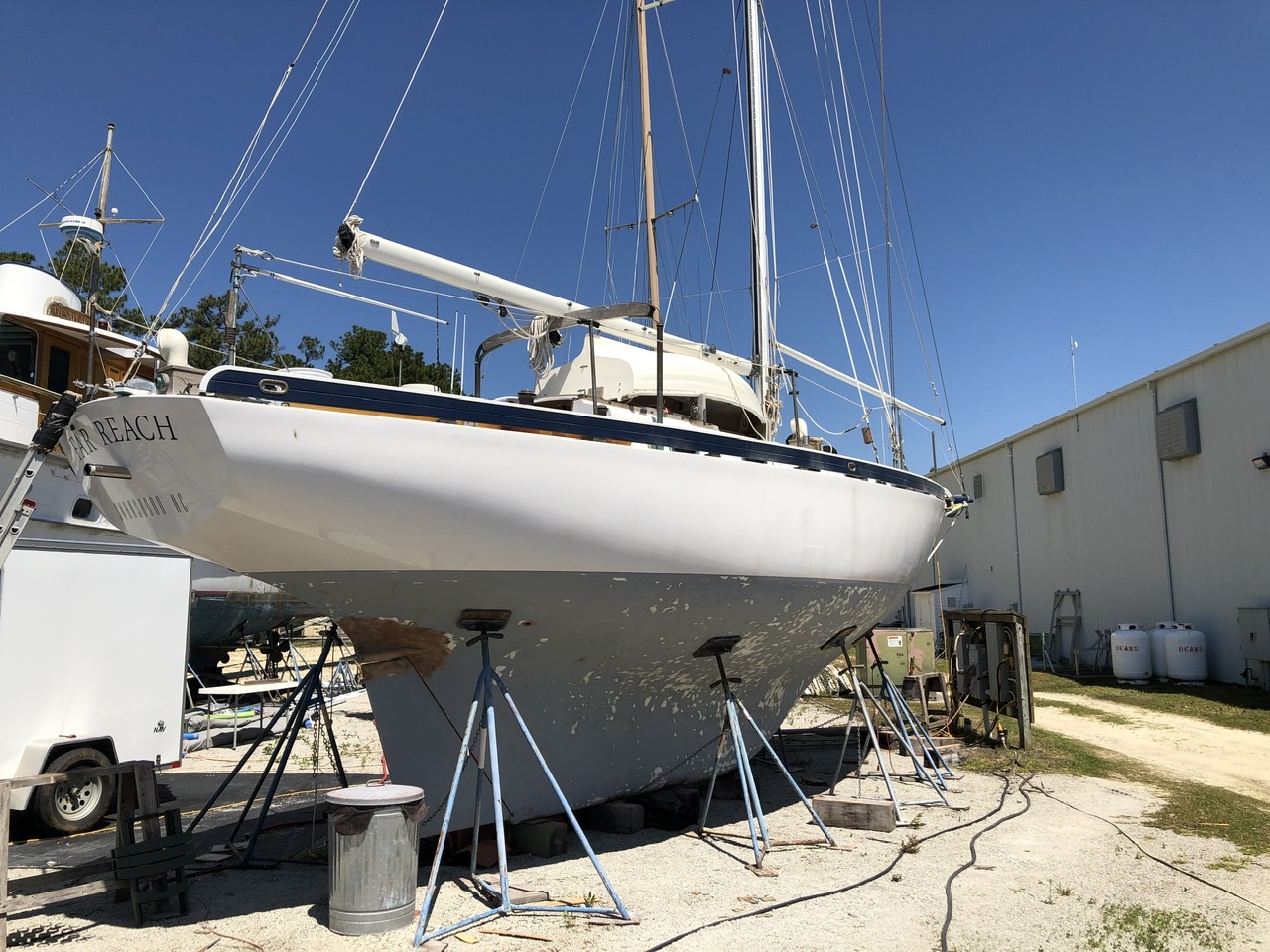

I spent the last couple days sanding the barrier coat some more to address where barnacles had breached it and left an uneven surface. We also moved the jack stands and sanded the paint off there too.

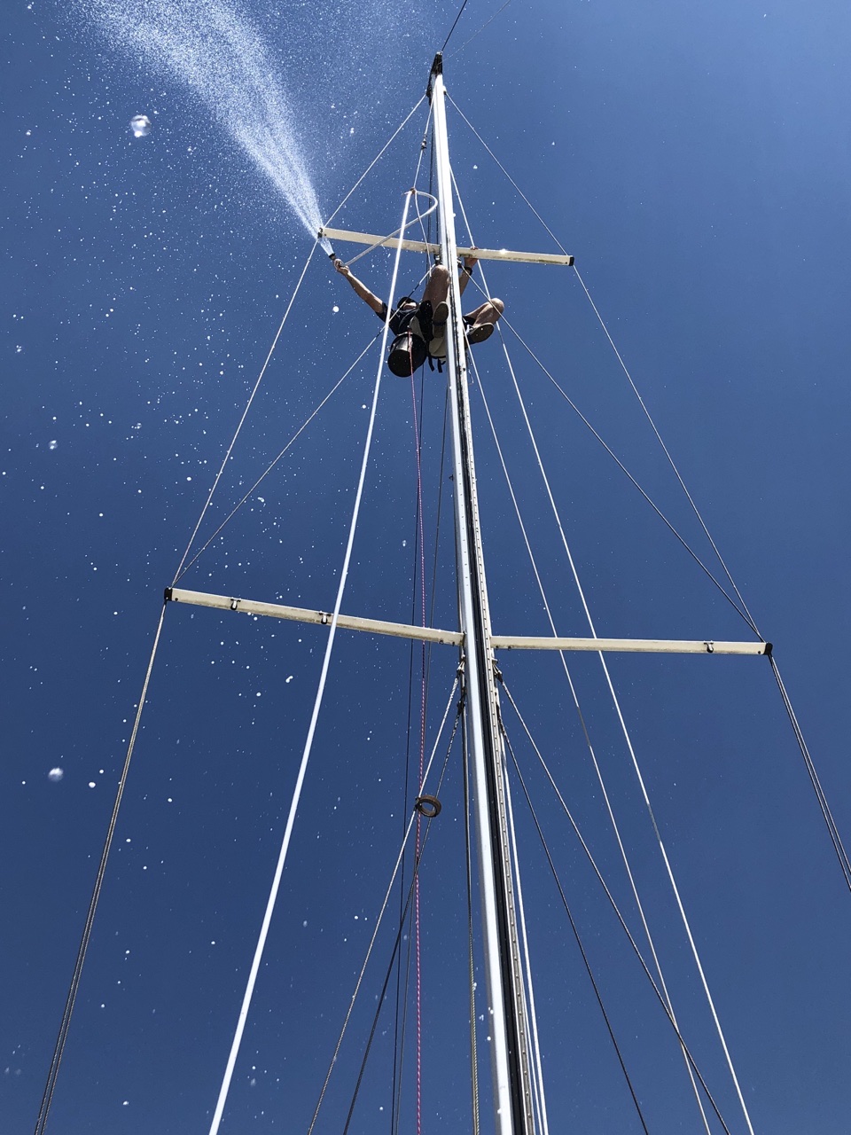

Finally, I took the cover off the Far Reach. I climbed the mast and hauled up the hose and washed the mast and rigging with soap and water from the very top to the deck. Gayle did her normal great job safely belaying for me. Then we washed the deck and topsides, which she desperately needed. Sunlight poured through the port-lights and deck hatch. Gorgeous breeze blew through the boat. She cleaned up pretty well. I need to wax the topsides and knock out some varnish work. With the protective covering we had down over the cabin sole we had not seen the walnut planks in about 18 months. It was great. I think tomorrow we will temporarily put the cover back on while we varnish the coamings and companionway.

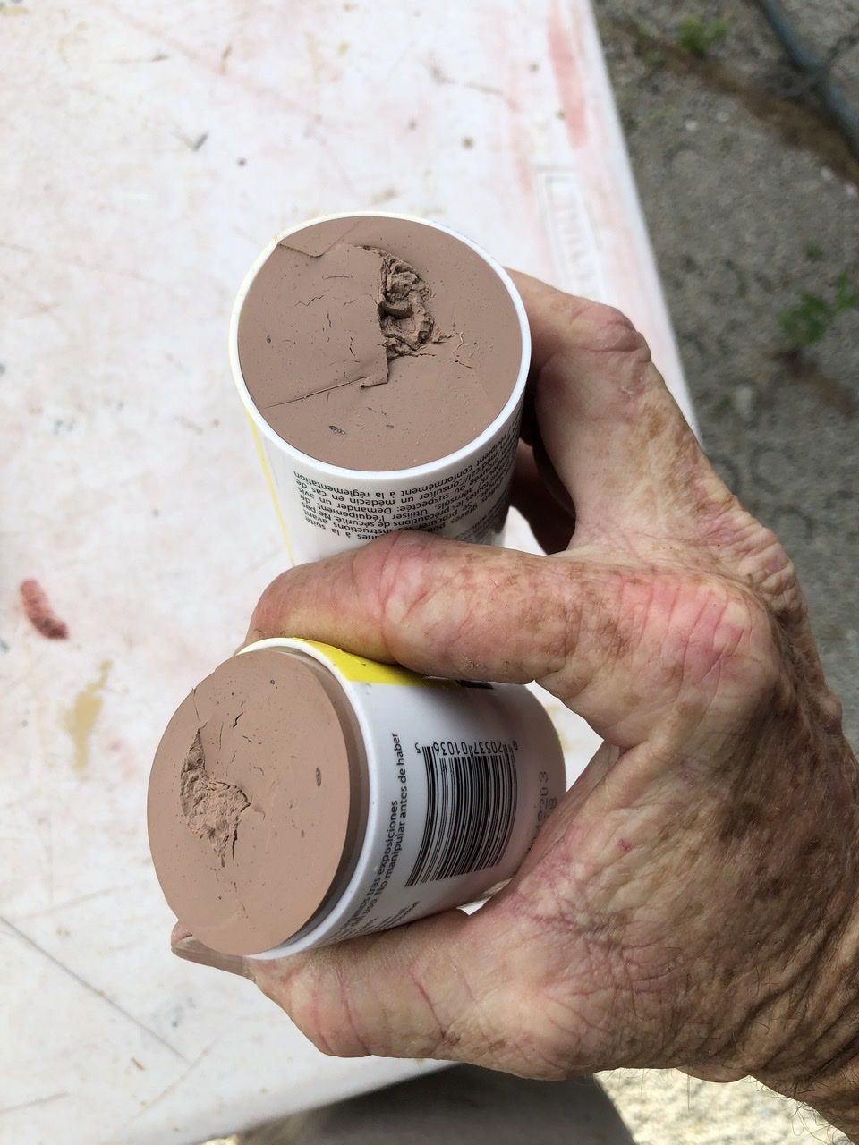

Trying to bed a small piece of bronze I spent the day milling, filing, drilling. Cover some exposed teak endgrain part of gallows framing. Test fit. Taped everything up. End of the day. Hot and tired. Ready to install. Boat life teak color polysulfide. Never opened. Dried out all the way through end to end. Give what I pay for that stuff it should last 20 years. We can make an MRE last 10 years and we eat them. Dead in the water. Should have brought my trusty Dolphinite. Sent Boatlife an email. Had some unkind thoughts....arrgghh
