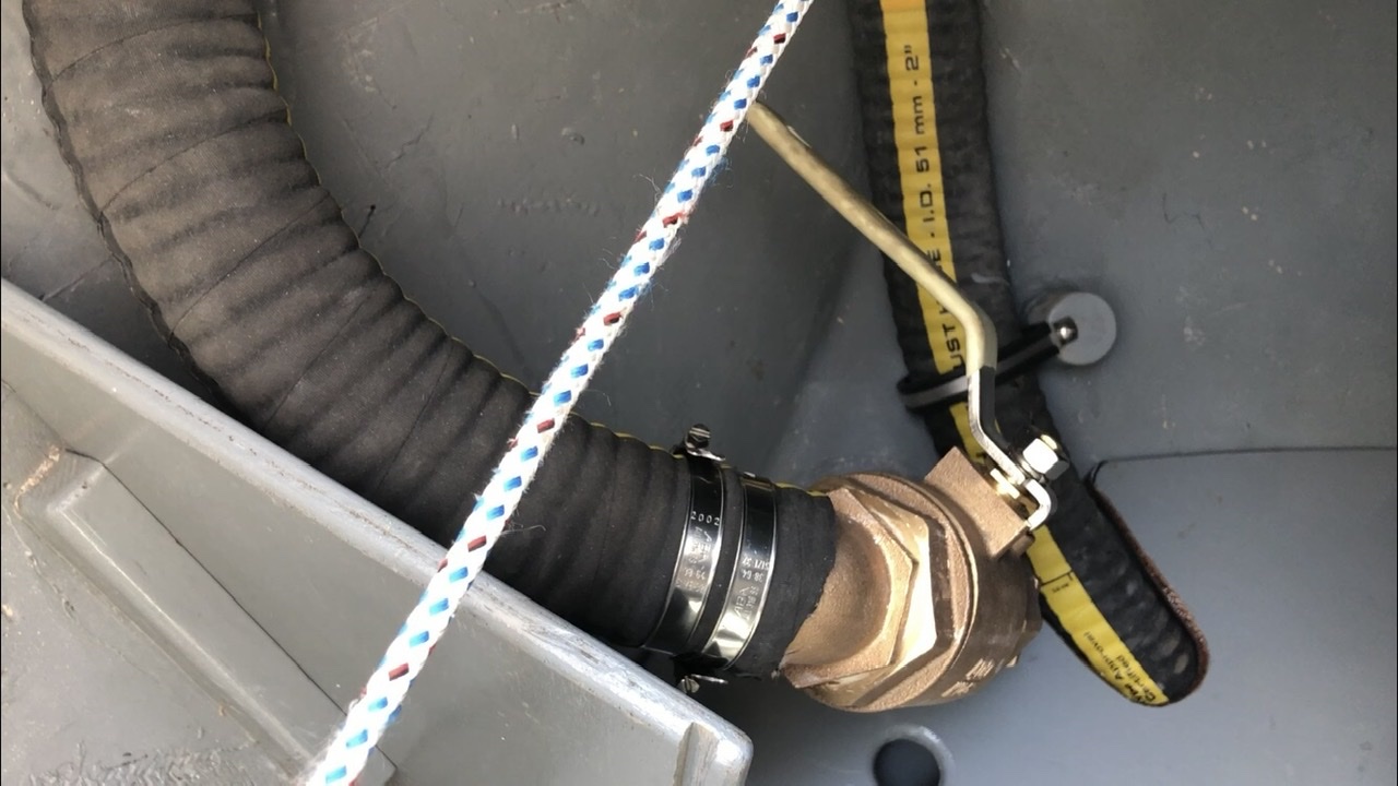

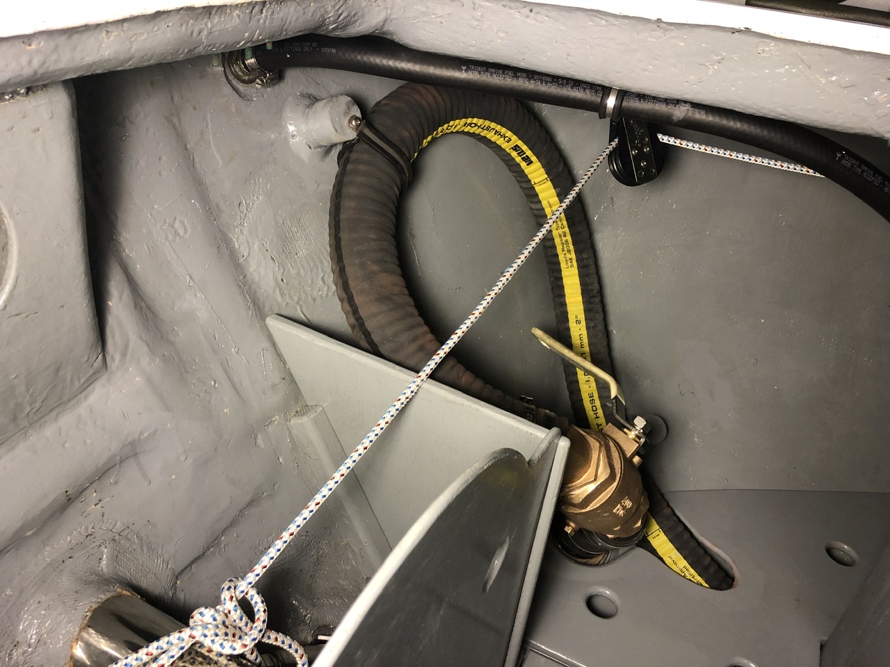

finished off installing the exhaust hose with the ball valve. Couple days ago I epoxied in some Iroko wood brackets that I could use to secure rubber coated hose clamps to. I also installed a 2” ID stuffing box hose to the bottom of the ball valves to make it very secure to the hose barbed exhaust flange.

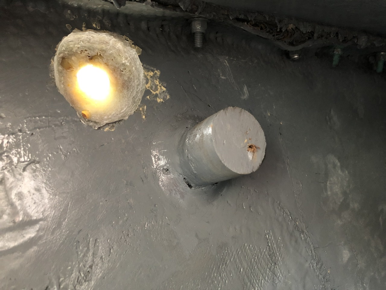

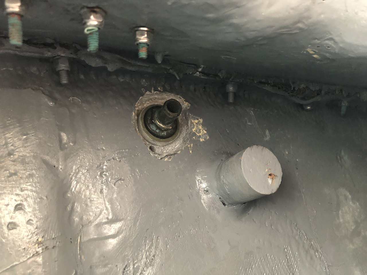

Today I installed the diesel tank vent line. I picked a place to drill in the transom (up high and in-line with the tank). What I didn’t count on is a hull nearly 1” thick that close to the deck! There was not enough threads exposed to secure the nut to the vent fitting. What to do? Took a while to come up with a plan. I considered various options but the best one was to counter sink a recess deep snd wide enough to accommodate the nut from the inside of the lazarette. But I had drilled the hole so high I couldn’t get a drill in the space between the transom snd the deck. Just not enough room in there. Then I remembered I had my dremel with the flex cable in my truck. I put it together and selected a small wedge shape grinding stone. I wedged myself down in the lazarette locker with the hose end of the big vacuum and just ground it out. Nothing to it. I recessed about 1/2” deep. I epoxied in a 1/4” thick fiberglass washer to create a dead flat surface then wrapped the vent with packing tape and pushed it in the hole. I faired in around the hole on the inside with thickened epoxy. Tomorrow I’ll put the fitting out, wash off the amine blush and paint it grey. In a couple days I’ll bed the fitting with 3M 4000 or butyl.

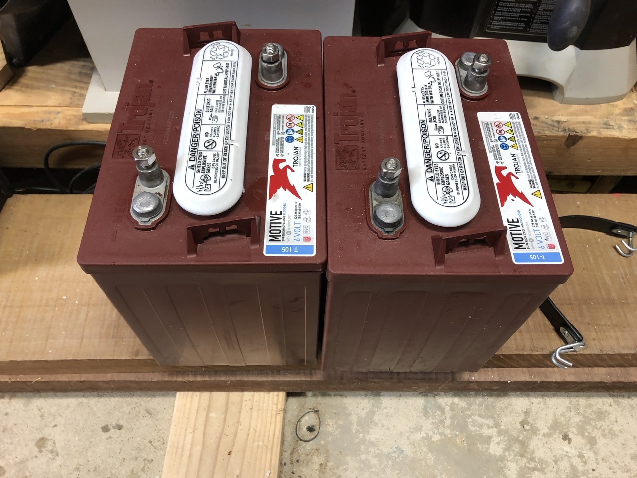

I also ordered the batteries today. I ordered two Trojan T 105 6v deep cycle golf cart batteries. Total of 225 ah when wired together to give me 12 volts. They were $159 each with free shipping. The best I could find for Lifeline Group 27 100 ah AGMs was $330 each. So essentially the AGMs were twice as expensive for a little less capacity. There are some trade offs but that’s what I decided. Need to keep moving forward.
This is the ball valve for the exhaust hose.
This is the location of the vent.
I didn’t count on the hull being this thick this close to the deck.  Not enough threads exposed for the nut to work.

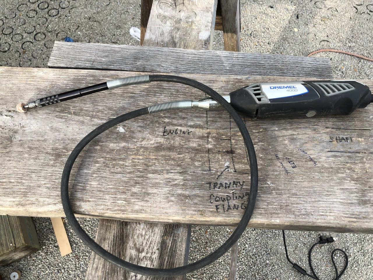

Couple pictures showing the recess I created for the nut.
The dremel with flex extension.
The picture obscures the hole due to the exposure reacting to the light but there is still a 1/2” thick hull under the recess.
After I took this picture I filled the void around the fiberglass washer with thickened epoxy. I’ll remove the fitting tomorrow and paint the fairing grey then bed it.

Trojan T105s arrived. Ordered the low profile terminals and got the standard height. Sigh. Will have to see if they will fit with Blue Seas terminal fuse fuse block.

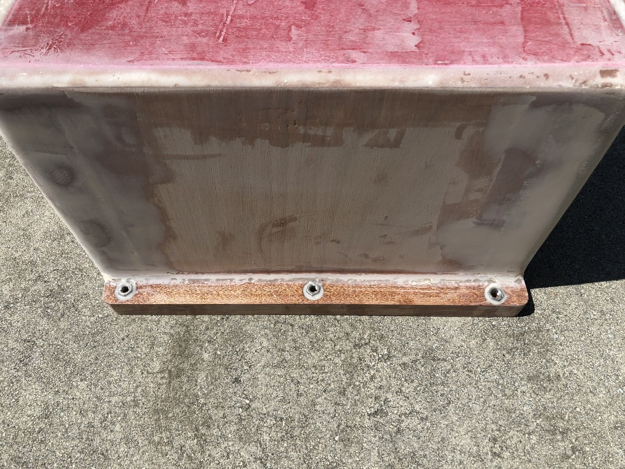

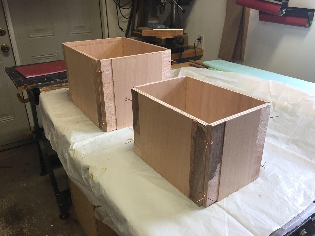

Been working on the battery boxes. Made the sides out of 1/2” BS 1088 Okume and the bottom from 1/4” manufactured FRP I had in my stash pile.
I used simple stitch and glue method. I cut 1/16” deep rabbets and wired them together with copper wire. Made sure they were square. Then, I filleted the outsides with thickened epoxy and then applied a strip of 1708 to the corners where the rabbets were so the biaxial is flush. The idea is the solid glass bottoms with fillets will contain any acid if it spills.
I made them with about 3/16 gap all around. I’ll add inside fillets tomorrow. Then the cleats to secure them tightly in place.
The house bank is T105s which I got on-line from Battery USA for $159 each so $320 total for 225ah which is exactly the same price as the Lifeline Group 27 100ah. I added a Diehard group 24 marine starting battery with 850 CCA. The Beta Manual called for min 550 CCA.
The idea is the house bank should last for the long haul 7-10 years(?) and I just replace the starting battery when required. The engine will charge both banks but the solar charges only the house.
Tomorrow I’ll cut the boxes down in height just a little then apply fairing compound to smooth out the finish. I’ll eventually paint them grey. Need to sort out the retention system to keep the batteries in the box during a knock down. I have a plan....

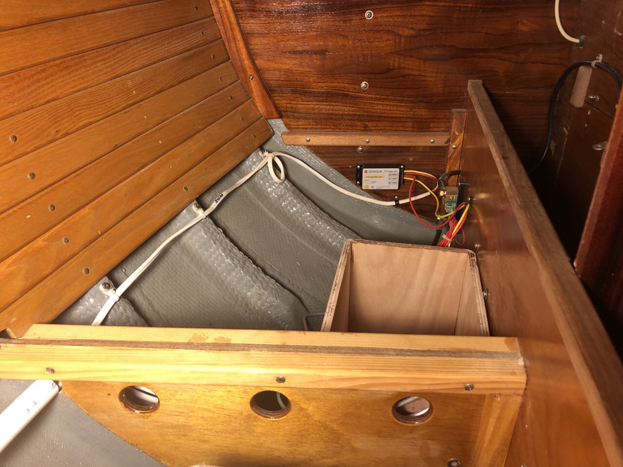

I test fit the battery box’s. The closest in the photo holds the two T105s. ‘thwartship. As recommended. The starting battery is further aft—where the old single AGM was located. It fits easiest fore and aft. See the photo. But if I build a small frame to raise it 1.5 inches to clear the hull it will fit ‘thwartship. The only caveat is sufficient overhead clearance with it raised up. Find out when I get home and measure the battery.
Both battery boxes positioned. The Trojan T 105s fit ‘thwartship in the forward box. In this photo the starting battery box (further <br />aft) sits high because of the frame under it to raise it so it doesn’t not make contact with the narrowing hull.
Starting battery box easy fit fore and aft. Not recommended however.

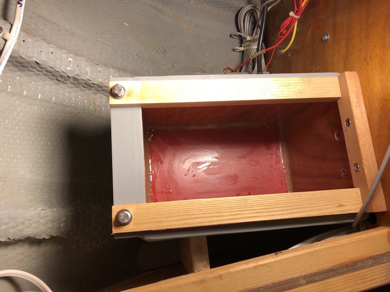

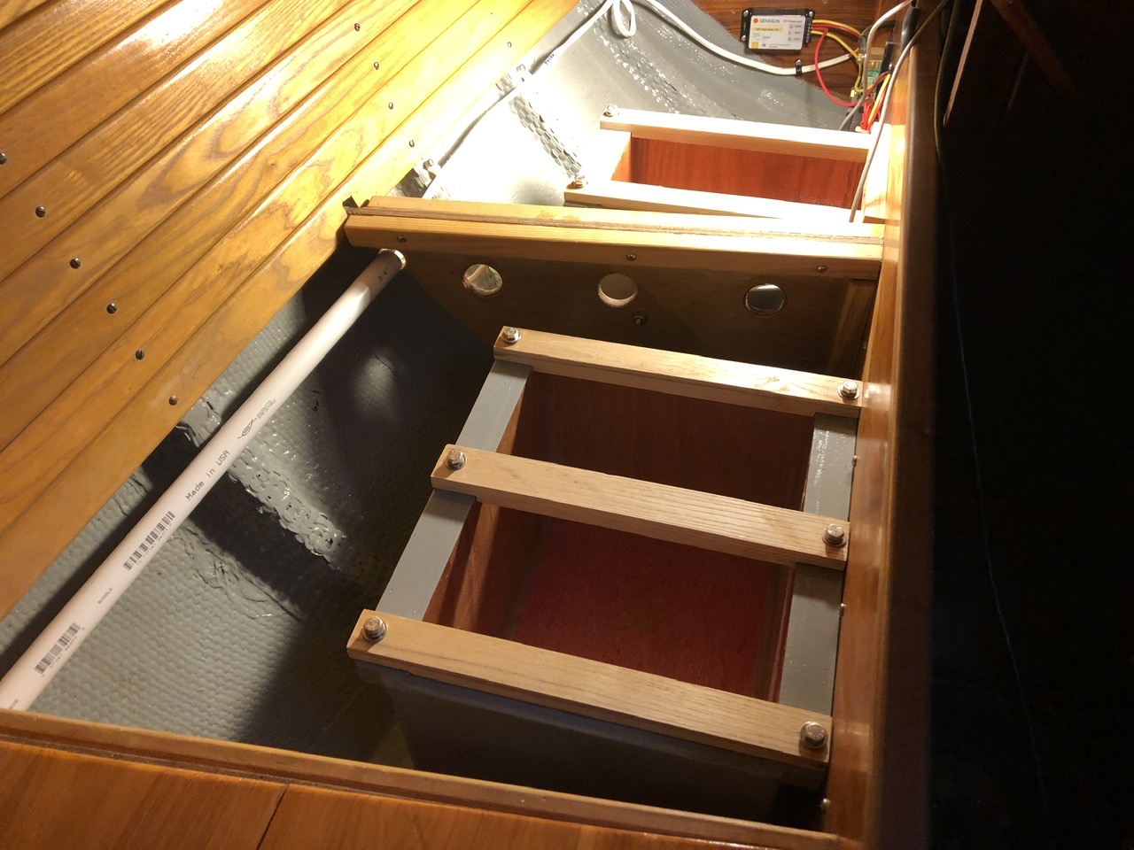

Not much to report. I fabricated the ash brackets that retain the batteries in the boxes. I used a
paddle bit to recess the underside of the cleats and epoxied nuts and washers in place. The 5/16” bolts thread into the nuts so I only need a wrench on top to loosen or tighten the bolts. I drilled the holes to

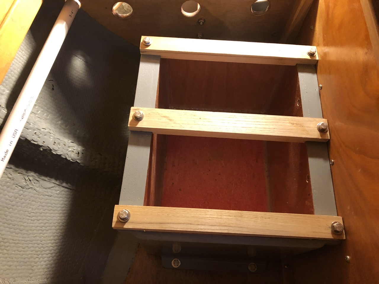

mount the Trojan box yesterday. It’s held down by four 5/16 hex bolts with over sized washers and nyloc nuts. Seems very secure. I had to fabricate some wood blocks to better position the starting battery box so I have a little more work to do there. Might paint the boxes today. Second Moderna shot yesterday so a little under the wx.
225 ah House bank under Q berth. Looks like it will work out Ok.
Boxes with ash brackets to secure the batteries.
underside of the top cleats with nuts epoxied into position.

Completes the installation of both battery boxes. Through bolted bottom and side to Q berth bulkhead. Painted two coats of paint. Very pleased to get this behind me. Tomorrow start working on the battery cable, Blue Seas Add A Battery Relay, Vetus throttle controls for the engine.
