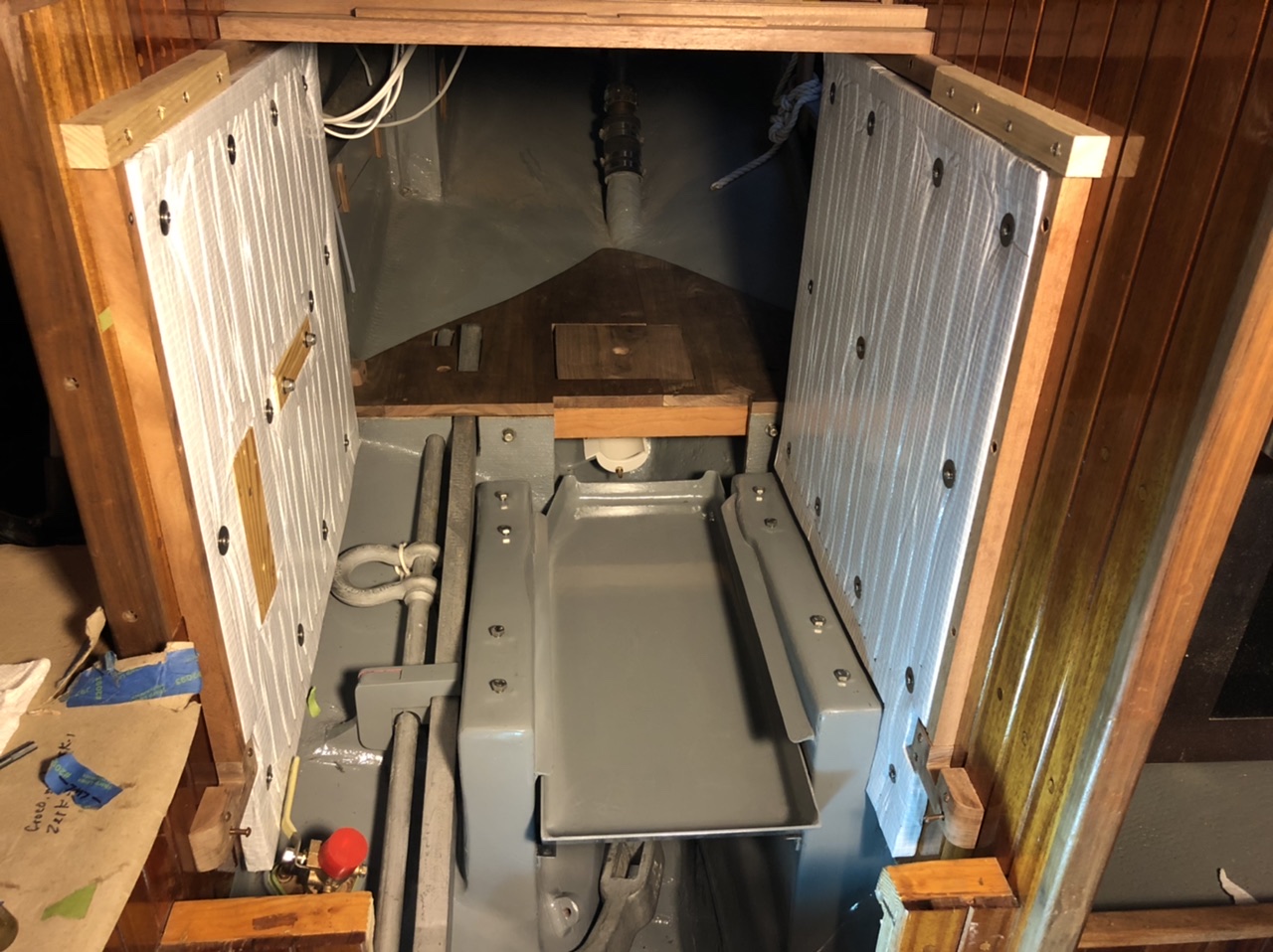

All engine bed holes drilled and tapped. First section of Soundown barrier installed. I used #10 SS is head and fender washers. No glue.
I’ll remove the wood blocks for the filter and strainer mounts and give them two coats of grey paint. I need to install the fuel line and fuel cut-off. Unless I forgot something, next step is to install the engine.

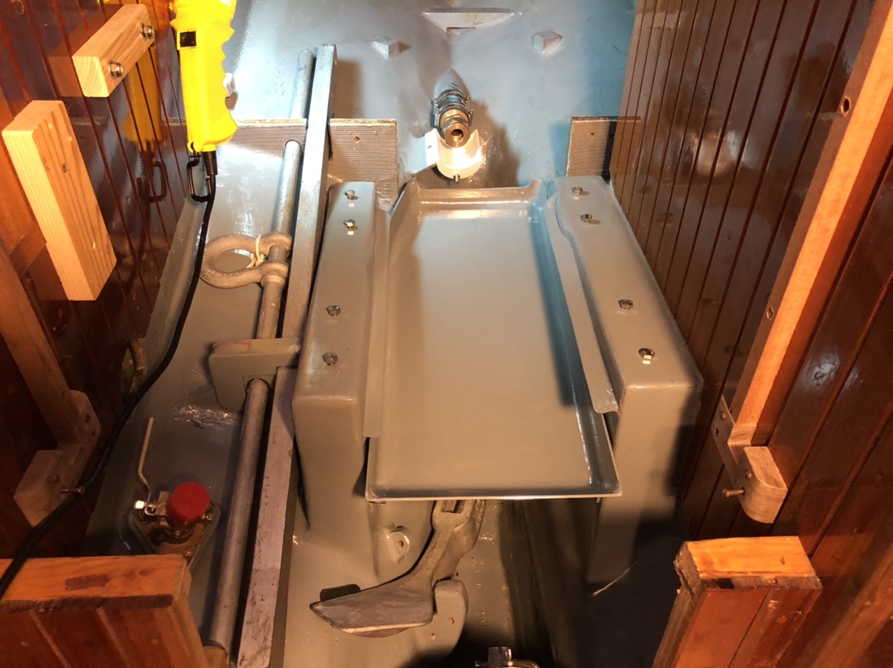

Just dropped the engine in. Took 12 min from trailer to engine beds. We used a fork lift with a chain fall. Cost was $75 for fork lift rental.
I’m glad to get it in there. It’s tight on the port side as I knew it would be. But I have time to line everything up over next week or so. Might be shifting back to the shed we are building in the backyard. Priorities. Too many balls in the air.

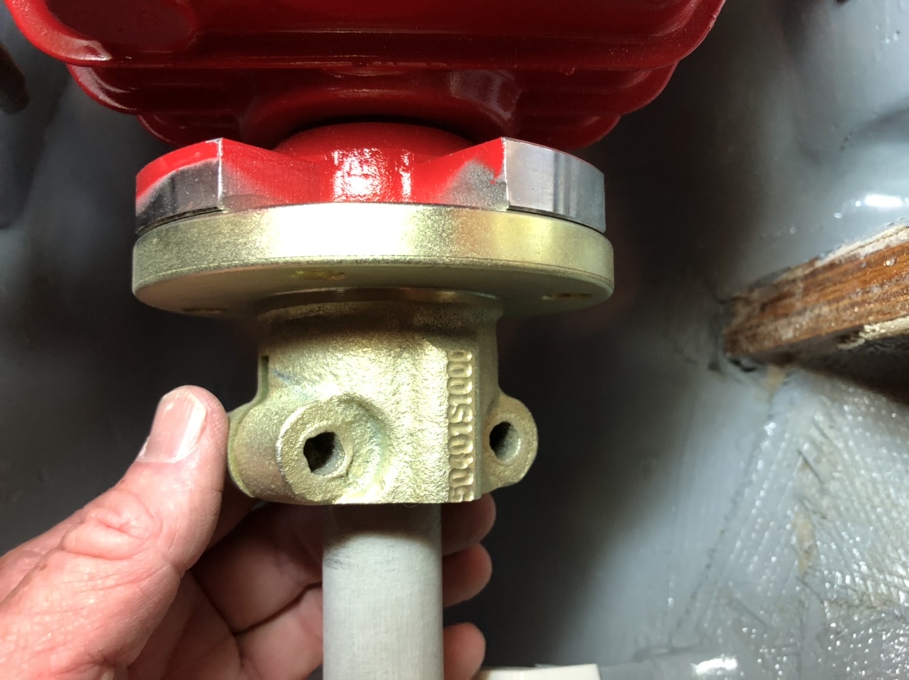

I installed all 8 bolts through the feet and into the holes I tapped Into the beds a week ago. Everything lined up. I was curious. So I installed the cutlass bearing and pushed the 1”OD fiberglass tube I used as a shaft mock up. I crawled back into the boat and slipped on the rigid shaft flange to see how everything lined up. Absolutely dead on. All the way around. All bolt holes lined up. Shaft turned smoothly. I knew that I had done this right. I have been careful and thoughtful and as precise as a Grunt can be throughout the entire project so I was confident it would work but even I was surprised it married up perfectly. I shot a video but can’t post it on the forum.
Of course I will install the flex coupling later with the actual shaft and there is no packing material in the stuffing box but I’d be lying if I didn’t say that I am pretty darn happy about it. I think I’ll have a Guinness tonight.

Very nice, John. One little tip I can offer is to torque the clamping bolts on the prop flange carefully and evenly.
Because you have a split flange like I do, it's possible and easy to move the flange out of perpendicularity with the
shaft. I found this out the hard way. You can use a table showing correct torque settings for different size bolts. -Jean

Jean, you mean just torque the two flange bolts evenly? No problem. The flex coupling also came with tightening sequence info and torque specifications. I can also call Beta on the flange since that is their product. Good reminder. Thanks.
