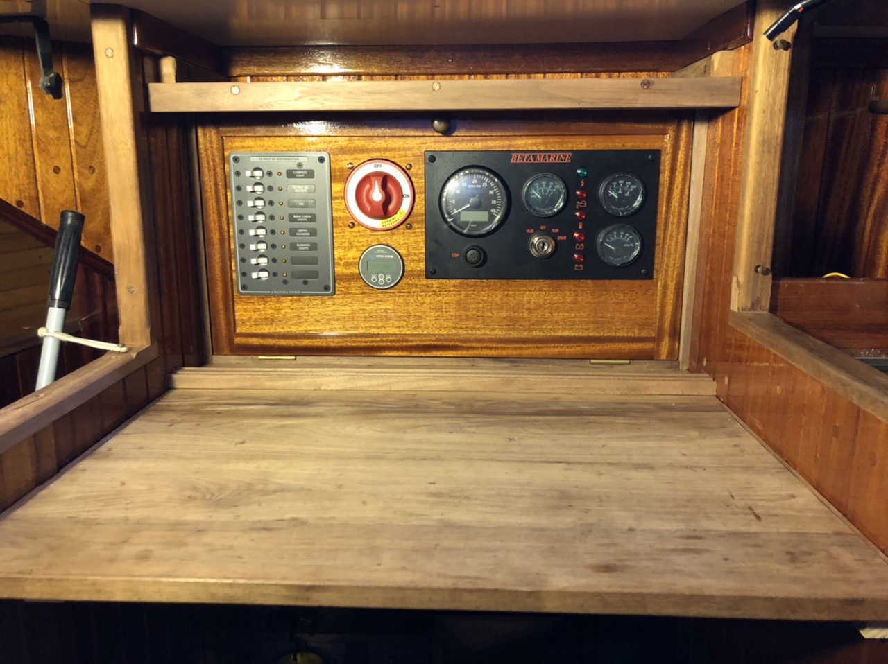

Hopefully start in on the panel today. Plan to pick up the engine next week.

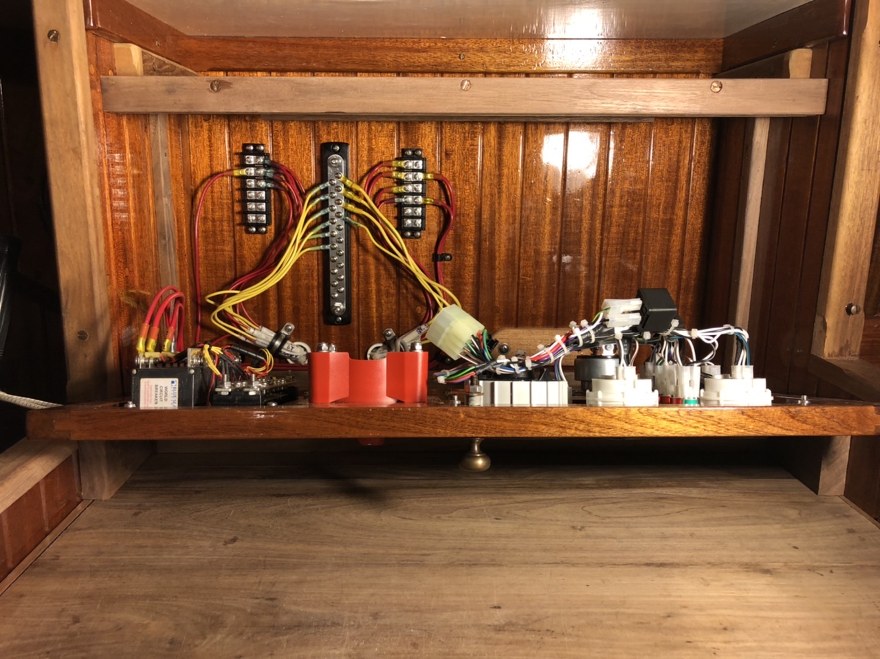

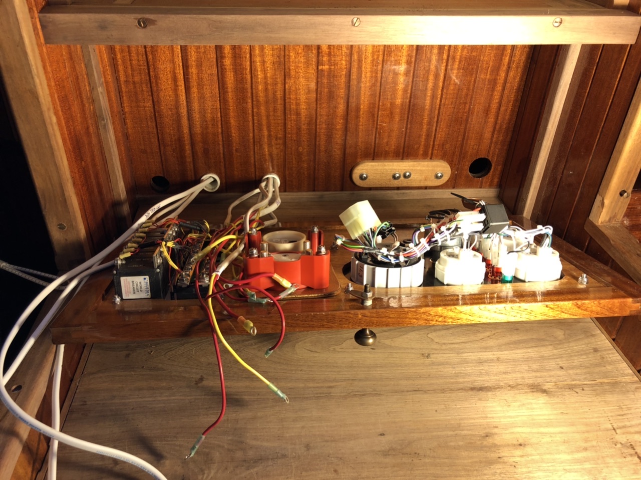

I wired up the panel over the last two days. I still need to tidy up and secure the wire bundles but that will wait as I need to pull the wires for the AIS and the depth sounder. I’ll probably hold off on the depth sounder till the boats in the water as that is when I will determine the precise location of the transducer...which will be installed on the inside of the hull. Probably under the refleks heater.
Wiring is not my high skill area. I have to go slow and think and draw and just plan it all out. I have a long time mentor I trust completely to make sure I am doing this correct and to ABYC standards...at a minimum.
I decided to use two matching terminal blocks on either side of the negative buss bar as they lined up with the chase holes for the bundles of wire. It was the cleanest design I could come up with. The terminal blocks allow me to gang the wires up using jumpers and run to the breaker panel with just one wire per gang. Keeps it neater and simpler. Plus it’s symmetrical which I lean towards. There is room for some growth. Got to have room for the flat screen, forward looking sonar, satellite TV, and of course the hot tub.
I used a label maker to attach Printed labels to the wire sheathing. Then I covered the labels with clear non adhesive heat shrink and shrank them down tight with a heat gun so the labels can’t come off over time. Same method I used for the first smaller panel this one replaced. The labels are under the soft clamps right where the wires exit the chase holes. If I remove the soft clamps I can see each individual label.

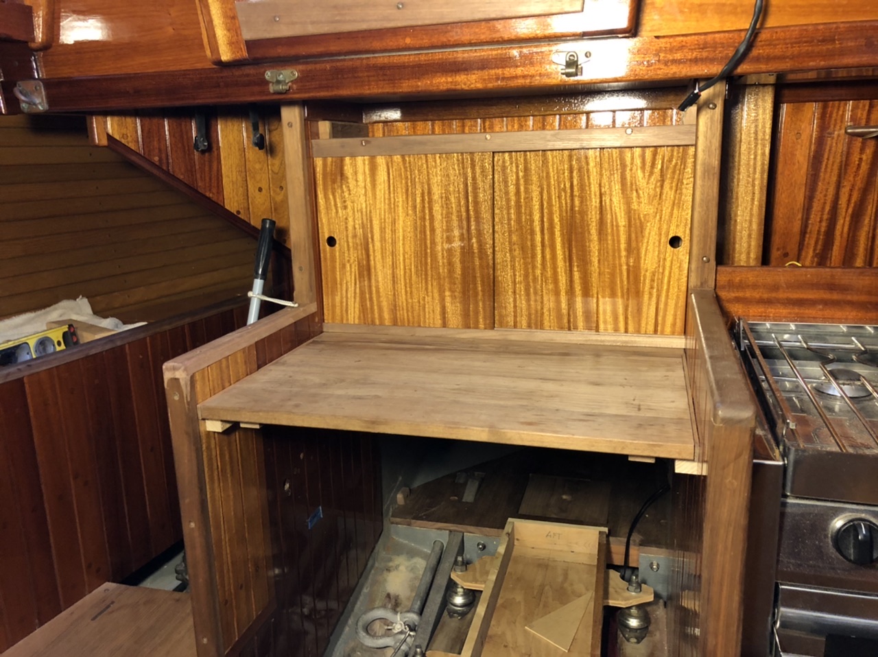

I also sorted out how to stow the back up 35 lb spade which has vexed me for months.
I still have some tidying up to do but this is the basic layout.

Beautiful job on the wiring, John. Please deep six the hot tub idea, though. - Jean

Beautiful work, John! A neat electrical installation makes troubleshooting much easier later on.

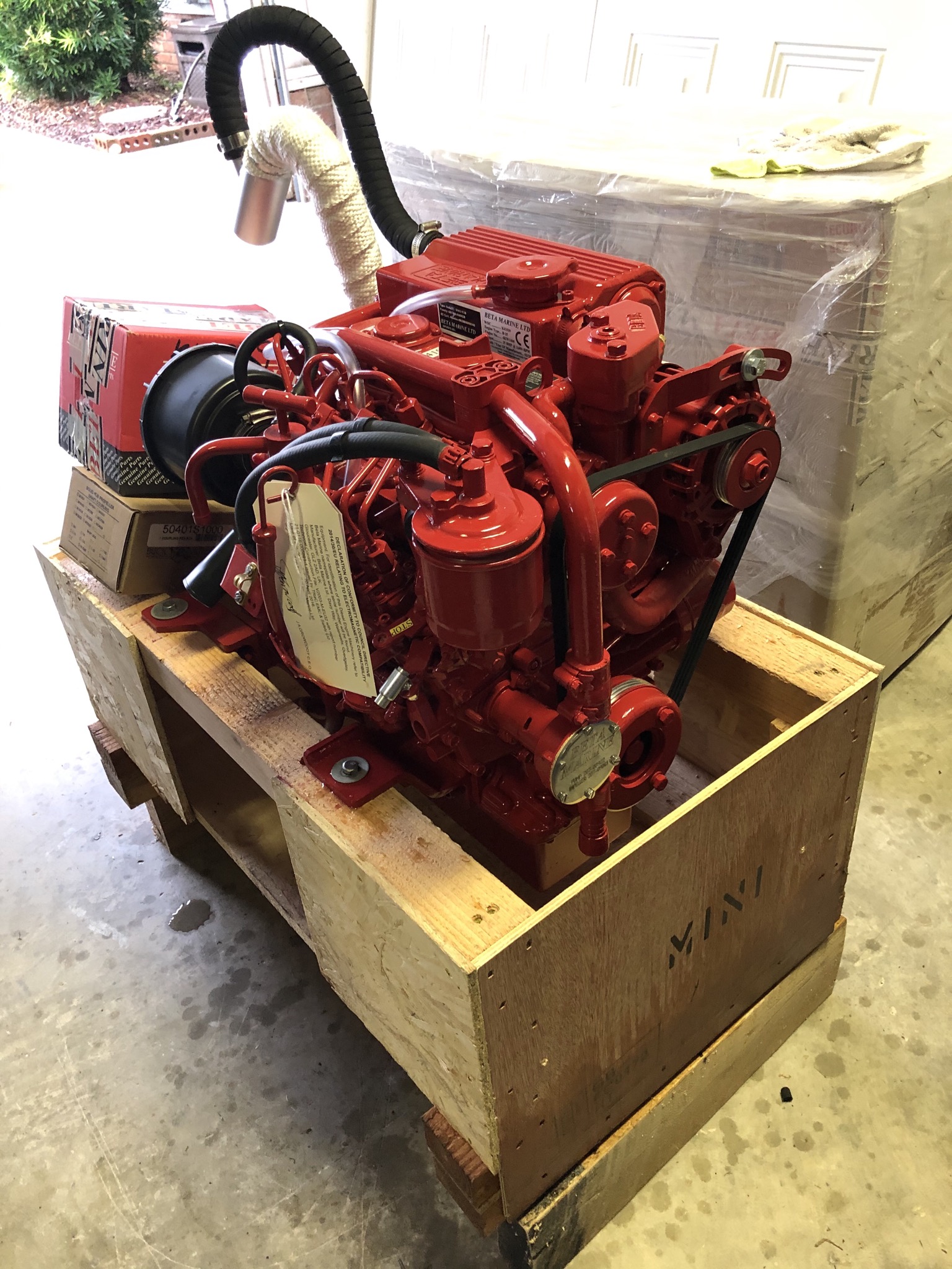

Lookie what I brought home in a rainy day. I don’t know whether to be happy or sad....
Very cool. Have to admire a new engine. I think you made a wise decision in the grand scheme of things.

- I think you'll end up very happy. My new Beta starts up instantly and shifts smoothly. Just remember to keep the
rpms way down when shifting. Good luck, Jean

Forget about all the pretty wood and varnish, that right there is some boat porn.
Now put the thing in and go sailing, Steve.
