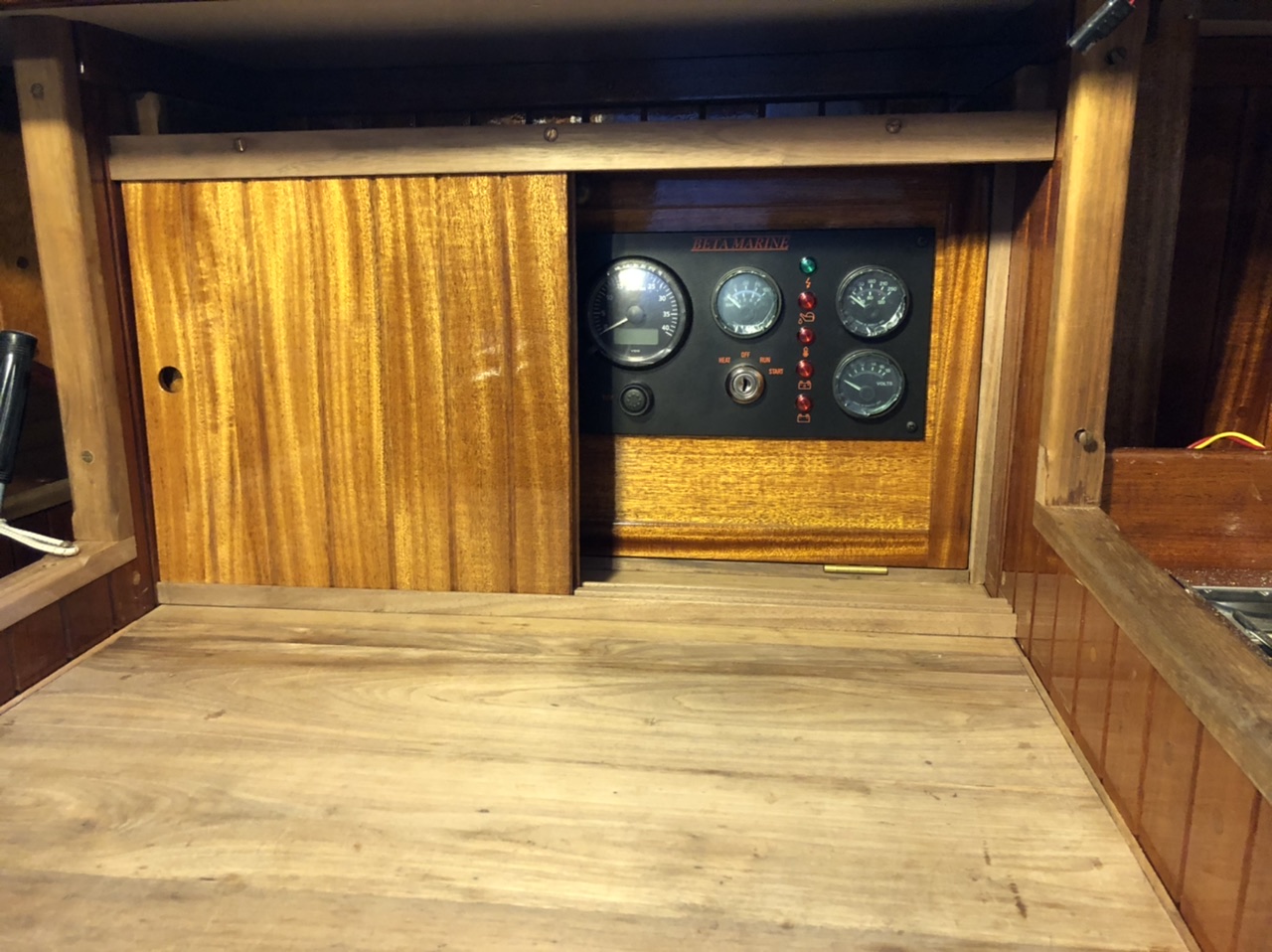

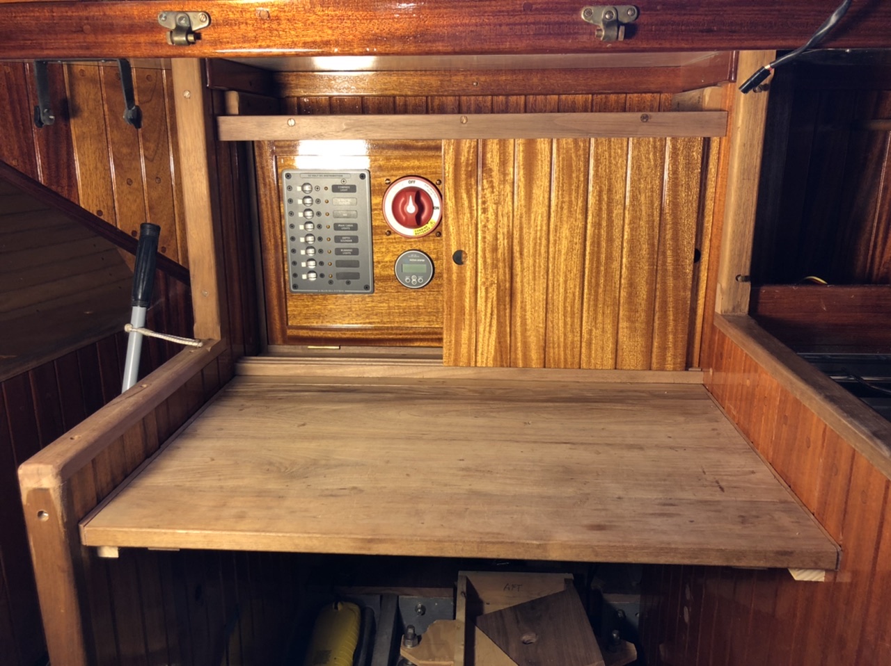

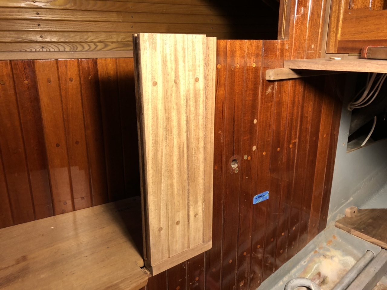

So, today I test fit the bulkhead extension. Fit great. I marked it to trim it down about 1/16” proud. Recut in the shop this afternoon. Will use flush-cut router bit and guide bar to make final trip after its epoxied in place. I installed the depth-sounder. Pretty simple. I have two trim rings and I started with the square one. I can swap them any time. Will start on the rear cover box tonight.

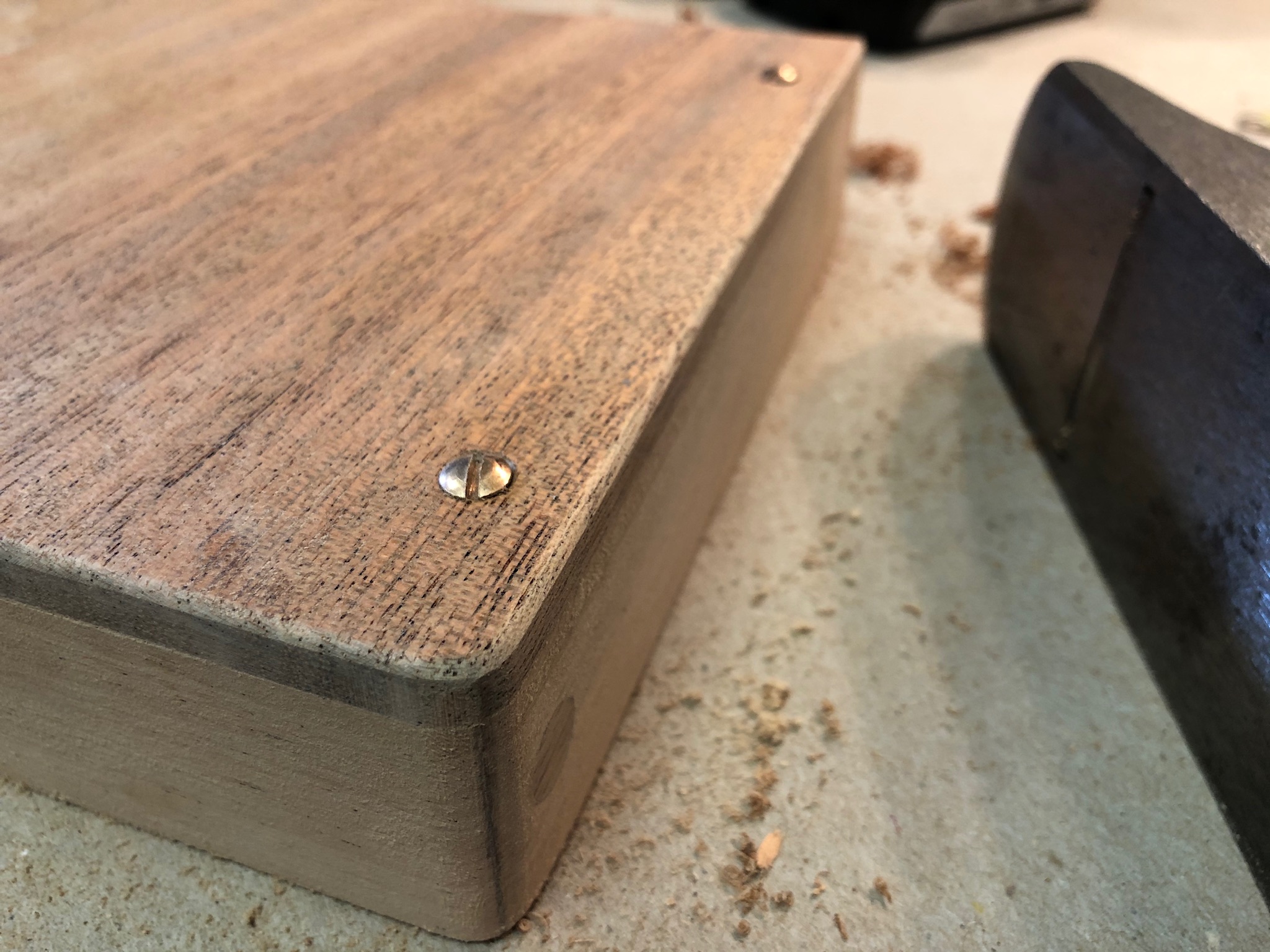

Been thinking about how to support the panel when it’s open. Didn’t want to install lanyards and padeyes. So, I made a couple black walnut wedges and covered the top side with leather. They seem to work very well. So I’ll use those.
Just finished applying the first coat of sealing varnish. I’ll get a couple coats on it and then epoxy it in place. Apply last couple coats of varnish on the boat.

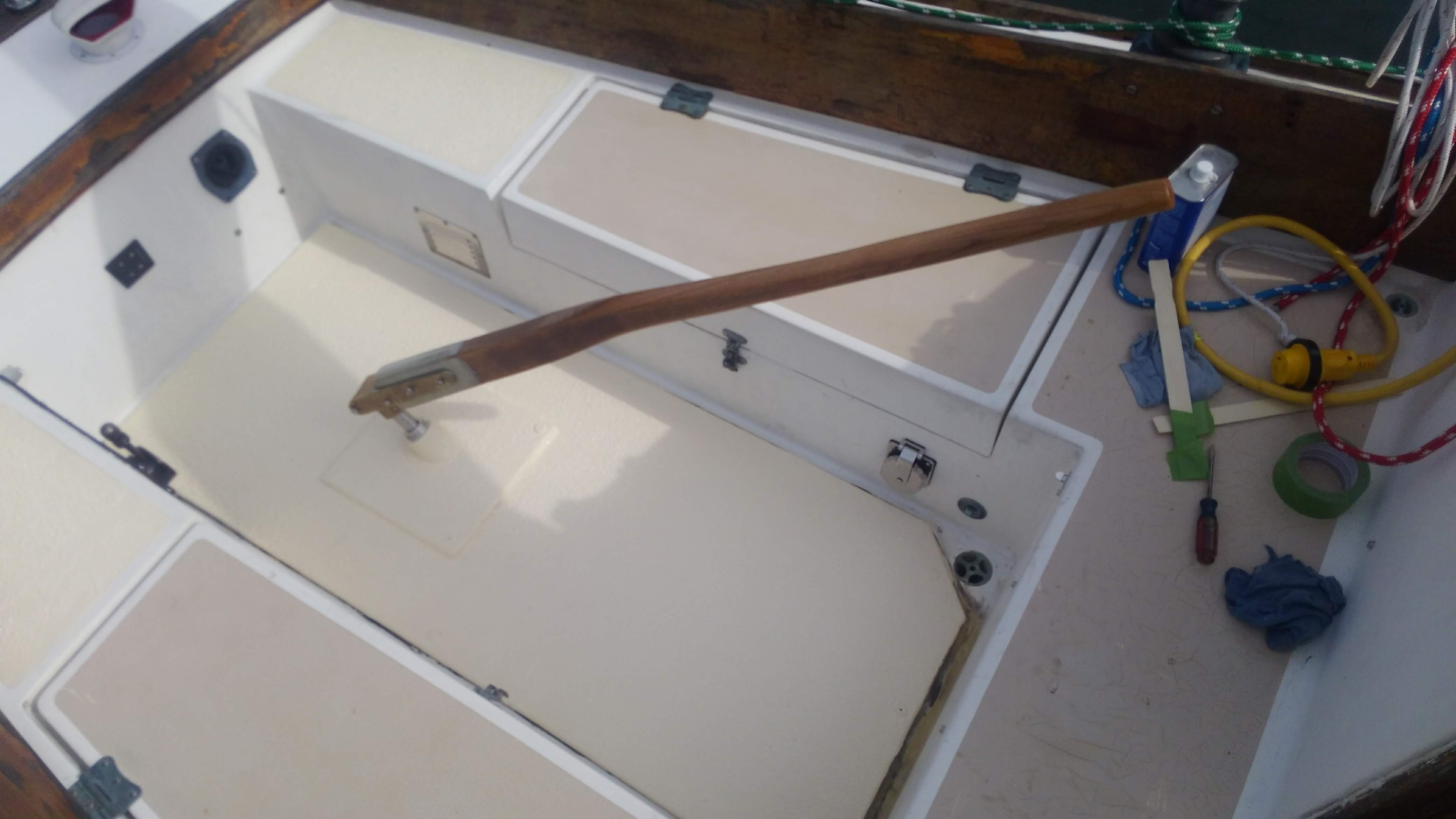

Tiller Project.jpg (277.12 KiB) Viewed 1536 times
Off subject but we converted from wheel to tiller also. I was inspired by some of your earlier work. Dennis

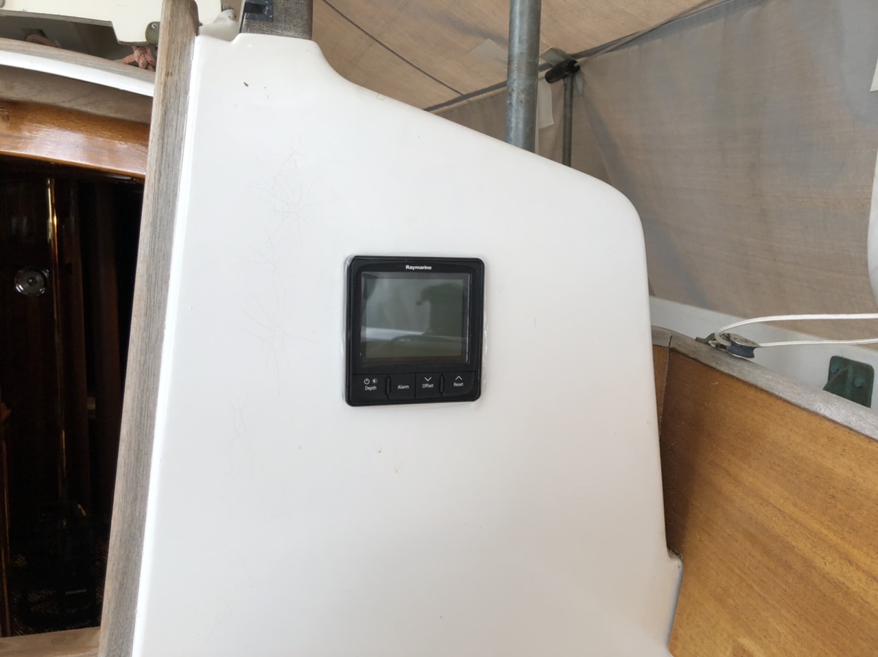

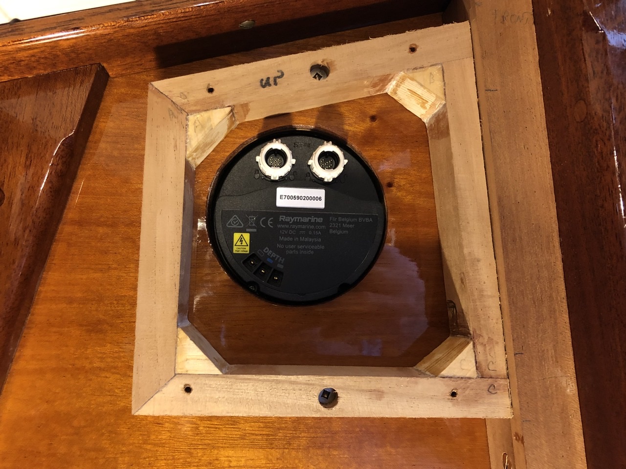

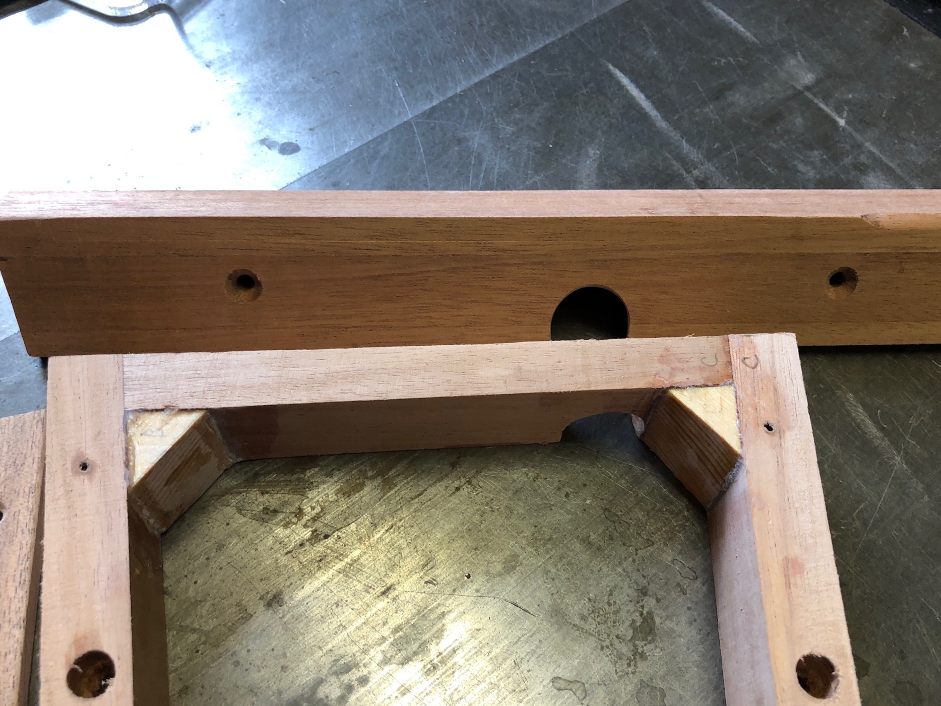

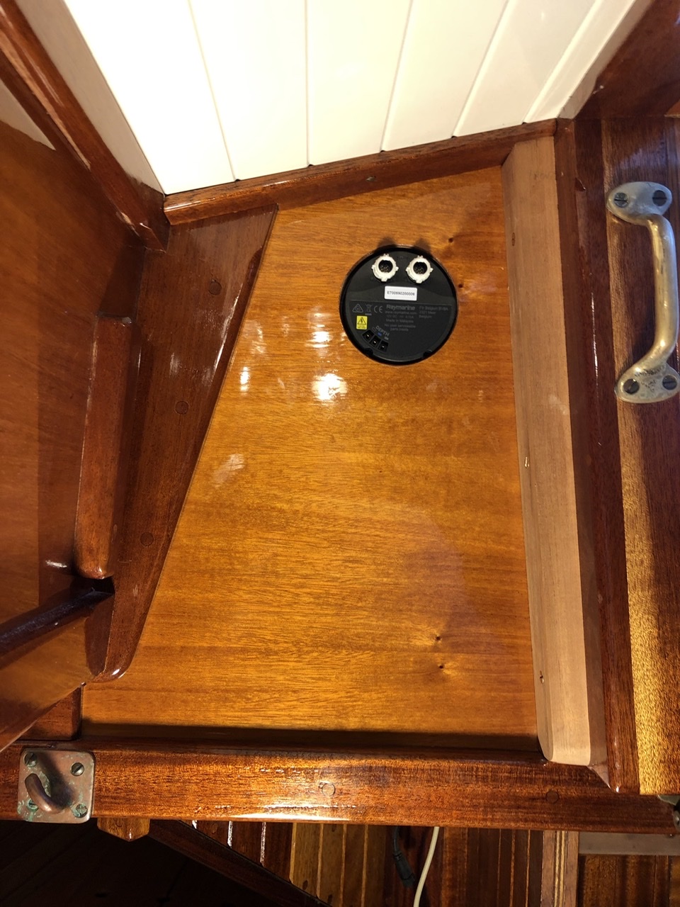

Built the depth sounder box and cover as well as trim for supporting wiring.
The long piece of mahogany has three laminations as it has donut dimensions. It has a fair size dado cut in back which covers the wire for the nav lights I installed earlier this year. The compass box has to fit up against it flush so I can creat path for power and data cables which support the sounder to that dado race in the long mahogany trim. A number of complex angles involved. All solid mahogany. Just using scrap I have left from other projects.
In the photos below the long piece of vertically oriented mahogany is not yet radiused along its edge nor is the cover for the sounder box trimmed to fit or radiused. I’ll do that tomorrow. Also, the box for the back of the sounder has to be positioned to allow the wiring to take as gentle a turn as possible. That’s why it looks like the compass is not centered. It’s that way by design.
I’ll finish trimming them tomorrow and get a seal coat of varnish applied. Then start work on the utility trailer. Good grief. Will we ever get back to sea? Stay tuned to find out.

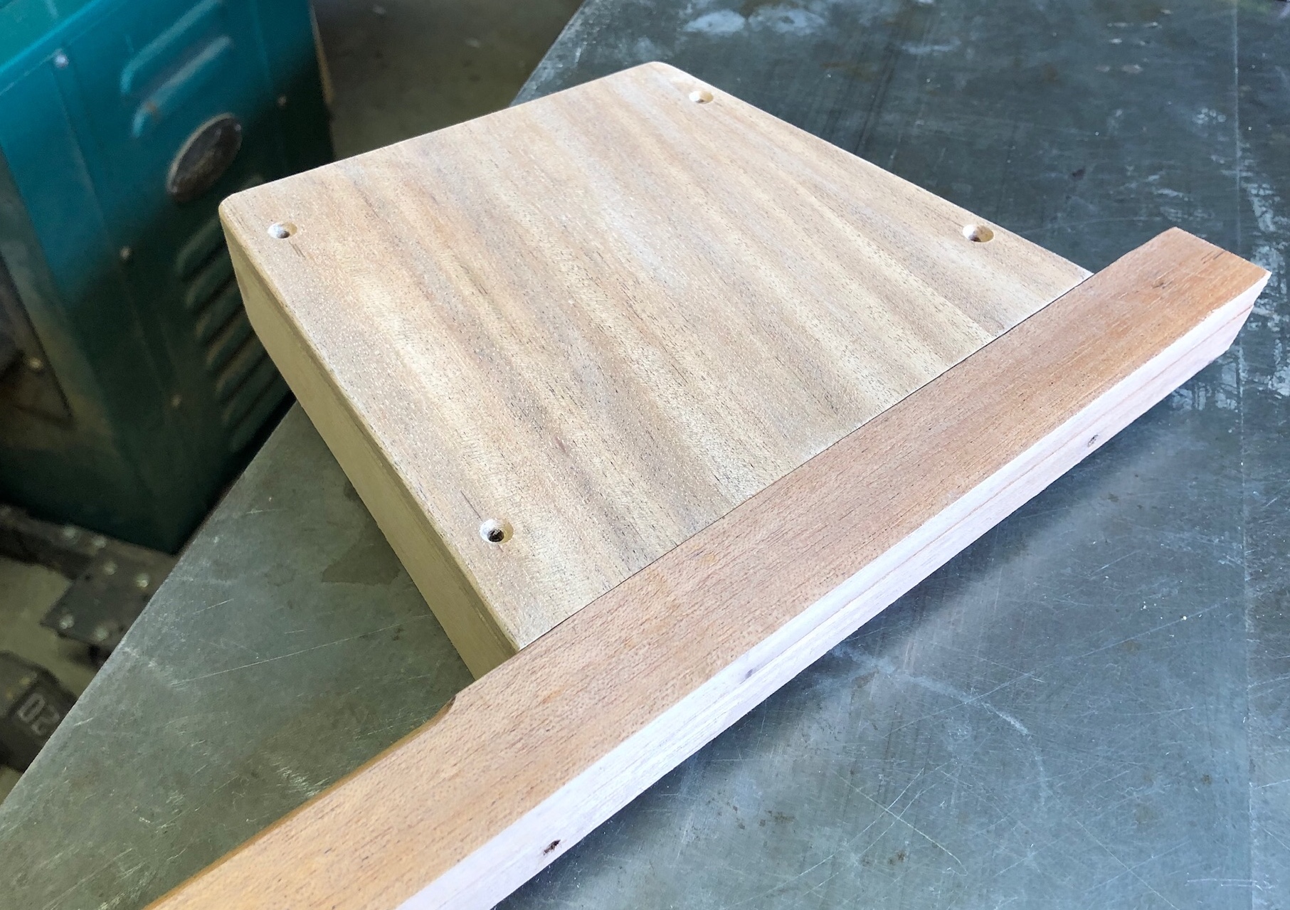

Trimmed the cover and radiused the edges with a low angle block plane. Drilled the hole between the box and the trim for the wire run. Applied the first coat of varnish.

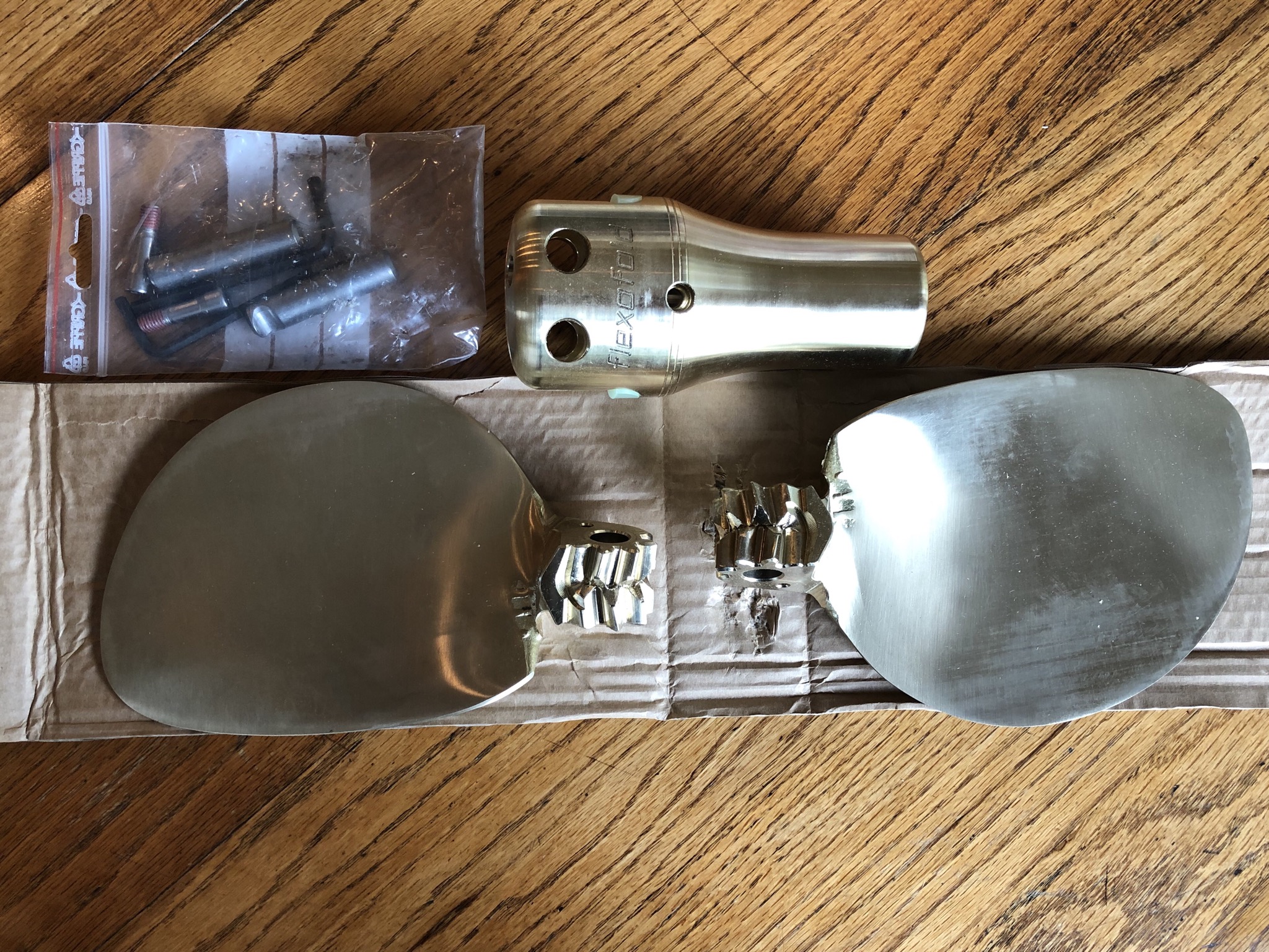

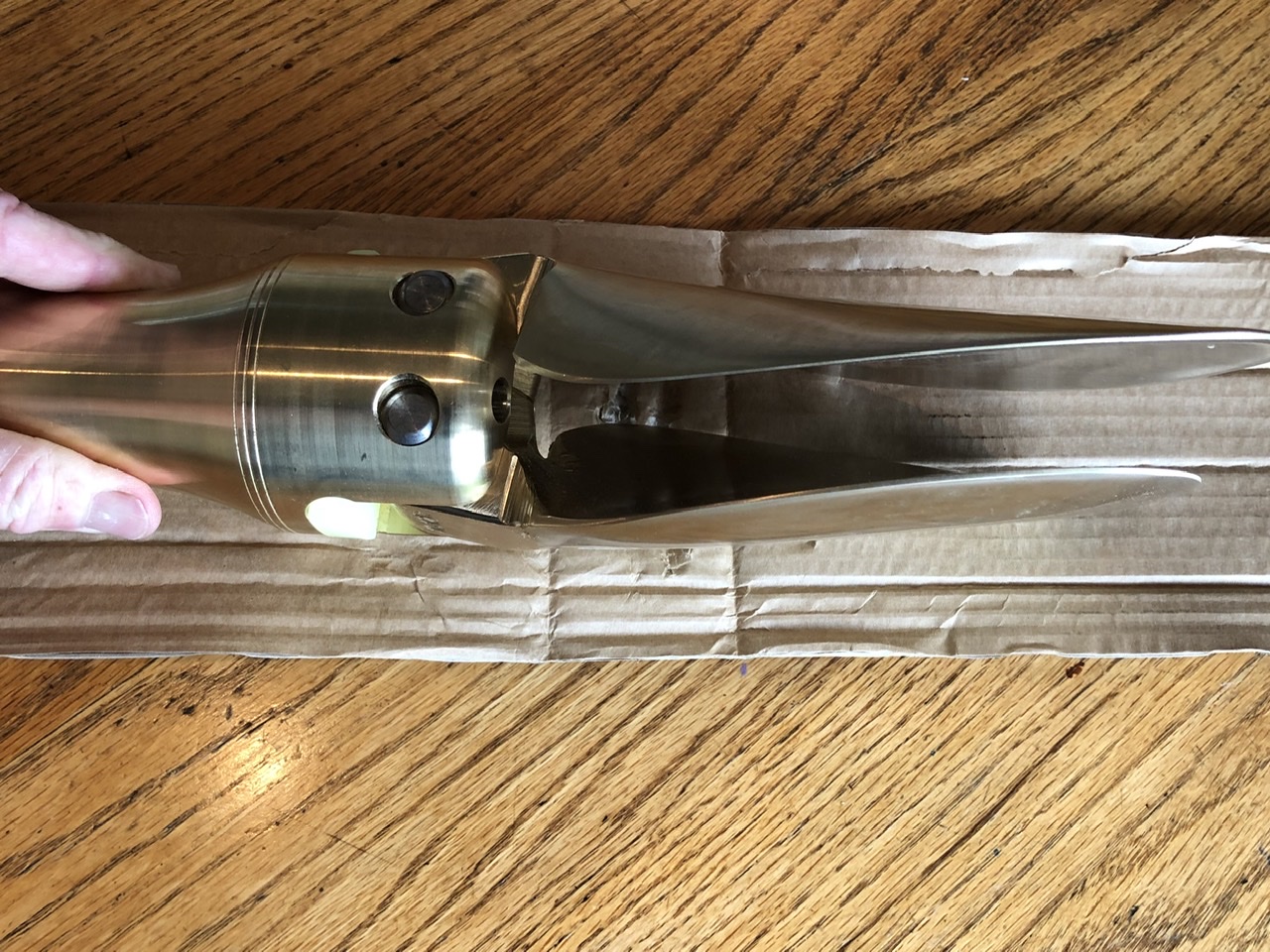

Oh boy! Look at what just arrived from Denmark. LOL.
Flex O Fold 1” SAE 16x12 two blade folding prop.
Very streamlined.
Very streamlined.

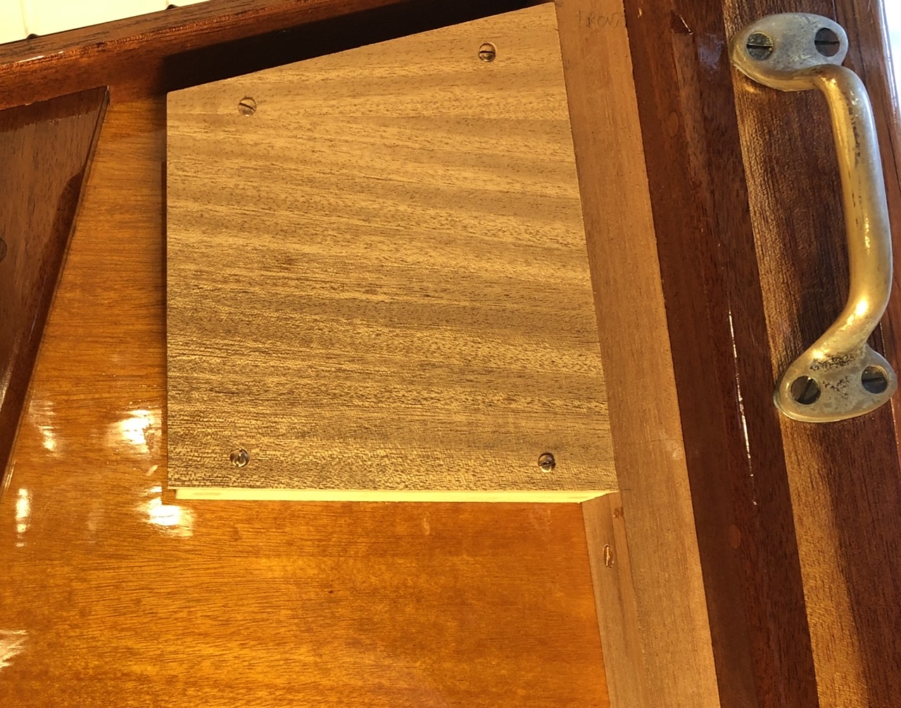

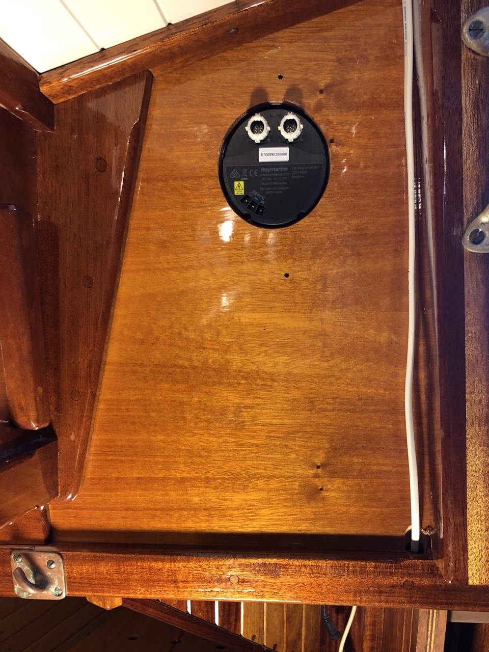

This morning I installed the newly varnished trim and box to cover the back of the depth sounder. All solid mahogany. It’s lighter but will darken with age. Bronze fasteners all around. Easy to remove. Easily covers electrical and data wire.

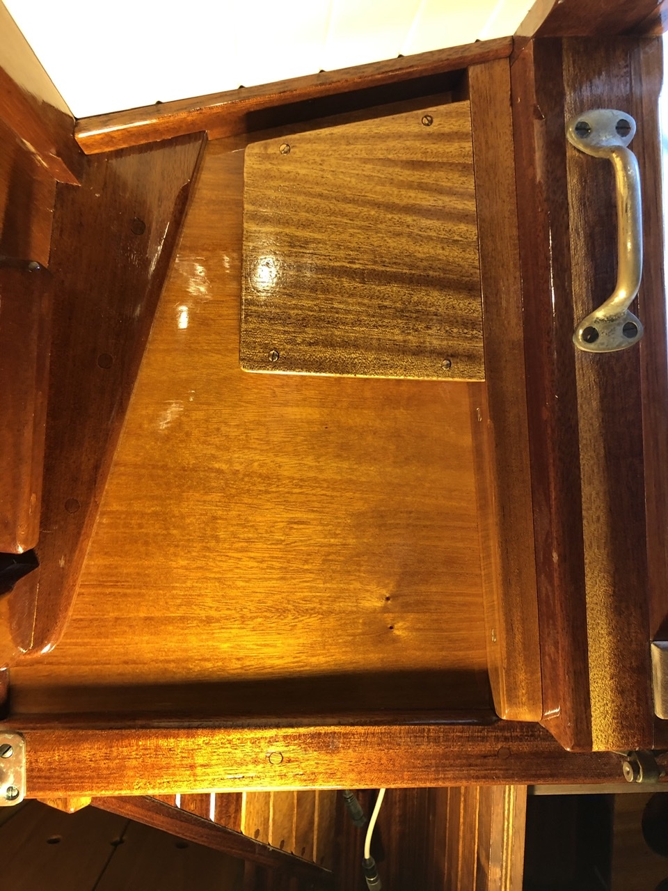

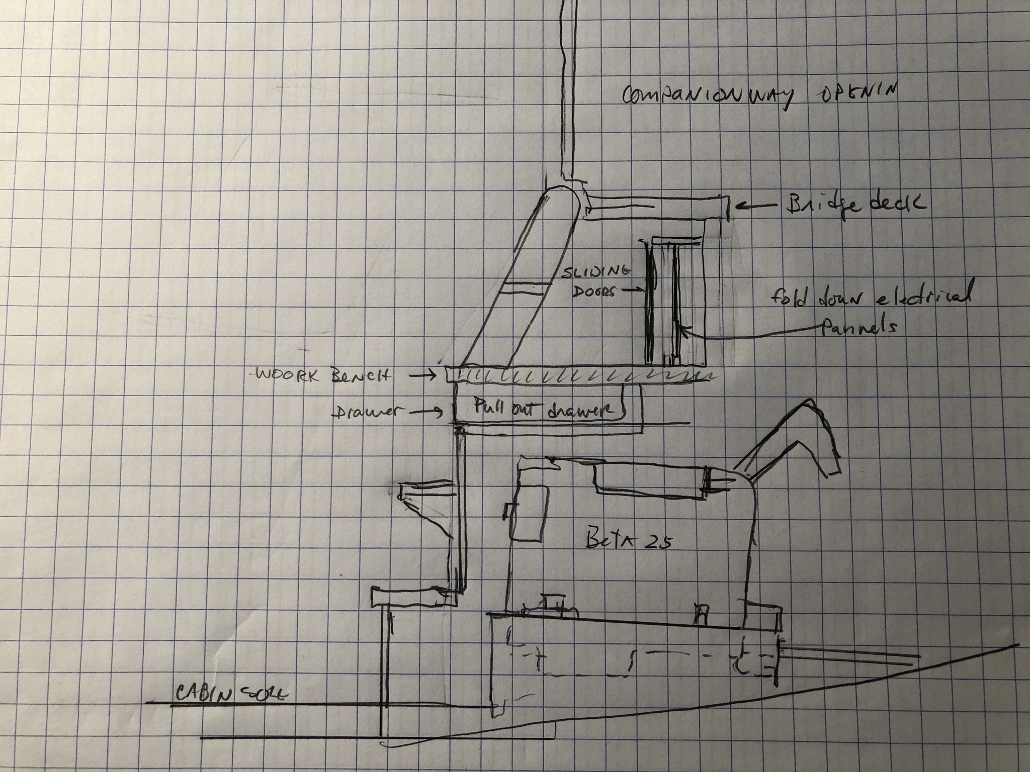

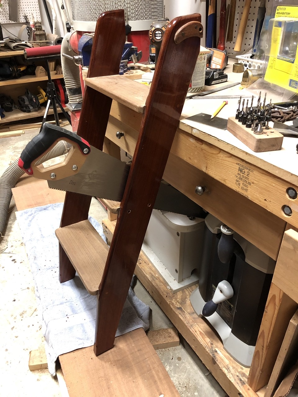

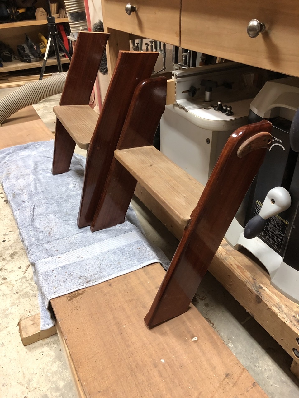

Because of the new engine box the companionway ladder can’t be full length. The ladder will have just one step. The bottom of the ladder will land on the workbench top. The top will be larger, one benefit of the engine box, and will serve as the second step down. Then there will be another step on the front access panel. The last step be below the access panel on the old landing, 11” above the sole. The spacing will remain evenly spaced the same as before—11” between steps.
Cutting up the ladder I so painstakingly built six years ago was not easy, though it was necessary. Boats that live long healthy lives, like the humans that love them, sometimes have to endure changes to adapt to new circumstances. That’s what I am telling myself tonight.
I removed the bungs and screws for the second step then cut the tread out to preserved the teak for some future project. Then I carefully cut the ladder at the correct angle Right at the dado slot with the chip saw.
Press on mister.
Just looking at the before and after photos of the companionway ladder is painful. I can’t imagine actually performing the surgery......

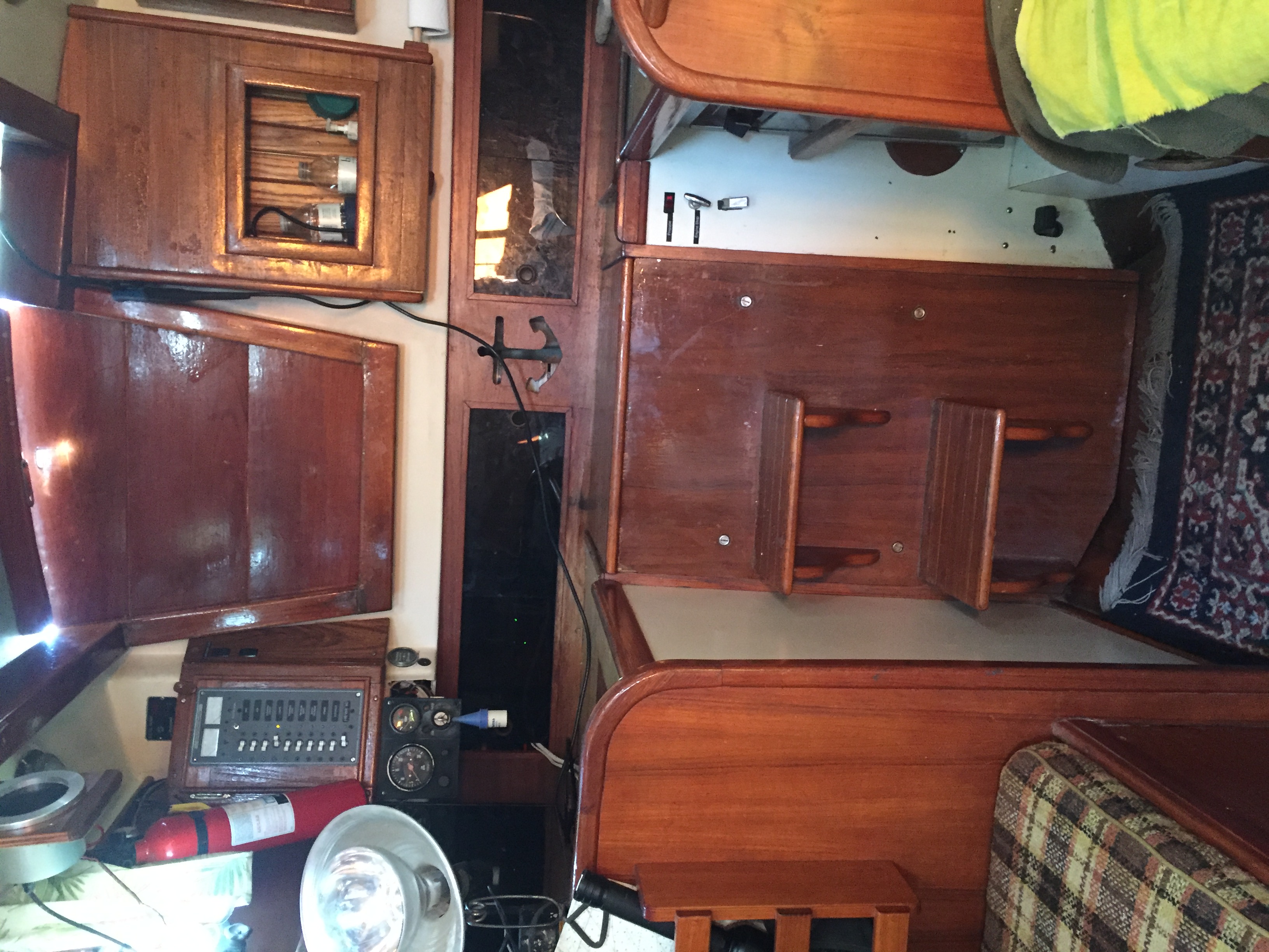

I decided to show my steps just to be in the conversation. I suppose they are typical for all the 30’s. I’m supprised they have lasted so long,43 years, just fastened to the 3/4” engine cover with those braces. They are off to one side to make standing room for the cook. I wonder why some want the stove in the other direction. It seems like the gimballs work this way?
JD-MDR wrote:I decided to show my steps just to be in the conversation. I suppose they are typical for all the 30’s. I’m supprised they have lasted so long,43 years, just fastened to the 3/4” engine cover with those braces. They are off to one side to make standing room for the cook. I wonder why some want the stove in the other direction. It seems like the gimballs work this way?
John
Copy. Well, I mounted my stove ‘thwartship... and you’re correct the final won’t work that way. I did it because it created a lot more room. Also, no chance of getting burned by falling into the stove or having something hot come off the stove and down on to me. Anything that spills goes left or right with the cook in front of the stove. I think it dramatically reduces the chance of getting bad burn at sea. Sailors crossed the oceans of the world for millennia without gimbals. I have never had an issue with it. We use deep pots. Not for everyone but I love it.

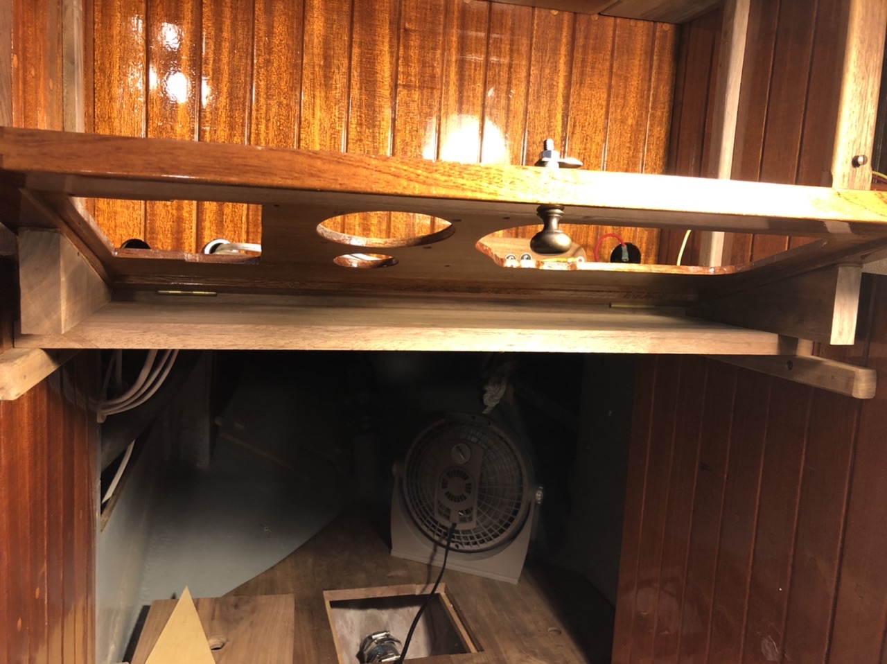

I installed the bulkhead trim. Other than wood plugs and teak oil on the bare walnut to help it match the other trim it should be good. The new mahogany is lighter but most of it is in the engine compartment and the little that shows won’t be obvious even to me and it will darken with time.
I installed the gauges. The doors still allow good access. With the leathered wedges the door folds down and is positioned securely.
All the wires look like they will fit. I’ll pick up a 20 connector buss tomorrow.
Need to taper the legs back on the ladder so it doesn’t look “cut off.” I’ll shape it like the lower end of the old one. An easy jig and a couple quick cuts on the table saw. Then revarnish while I finish up the wiring. But, I’m pleased so far.
