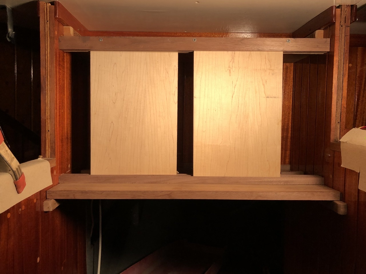

I was able to get to the boat late yesterday afternoon to test fit the rails. I gently and incrementally shortened the rails till I could just slip them between the bulkheads. There are two techniques to a tight fit. The first is to wedge the bulkheads apart. I can just do that here. The rails slip in ever so lightly then release and bam, they are held tight. I have a clamp that reverses and allows you to drive two surfaces apart. Very helpful sometimes. The second technique is to bevel cut the back side that you can’t see so only the front edge is tight. Did not use the latter for this project.
With the rails temporarily in place and held by SS fasteners (will be replaced with bronze) I was able to cut some doorskin ply as a sliding door template. The upper dado is more than twice as deep as in the lower dado so the door can be lifted up and dropped down into the lower slot.
Lastly, I miscalculated how far forward the downward hinged panel door could be positioned and still clear that upper rail for the sliding doors. It just barely contacted the rail when opened. So, I brought the work bench top home and repositioned the mortises bottom trim that captures the brass butt hinges. I repositioned it 1/2” further back and filled the holes with standard 3/8” walnut wood plugs.
This looks like it will be a good design though it’s not perfect. I can see a few changes I could have made to the design to improve it a bit and allow the hinges door and sliding doors to be located more closely together. But, it would have required the electrical panel to be smaller and would therefore have eliminated an opportunity in the future to add anything else to the panel. It’s a compromise. Still, so far, so good.
- I mispositioned the lower trim that holds the butt hinges. I drilled out and filled the holes with walnut wood plugs.
- 54C63C3A-1FF3-4390-BE7D-03293B350438.jpeg (379.36 KiB) Viewed 1609 times
- Doorskin ply trimmed to determine the correct height for the mahogany doors.
- A43729A6-8A6A-4E68-891F-953BEA06CF9D.jpeg (241.36 KiB) Viewed 1609 times

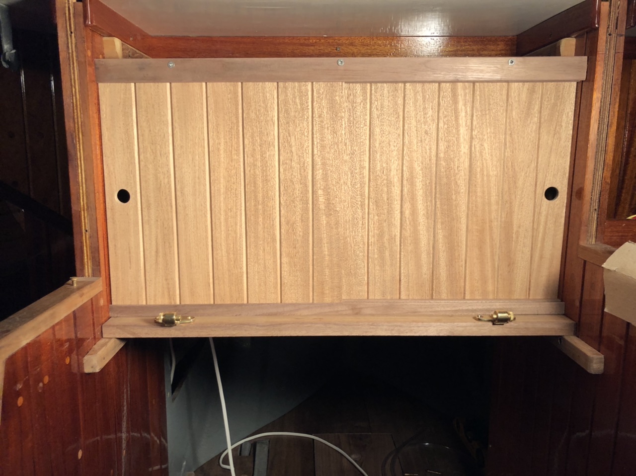

I test fit the sliding doors. Very satisfied. Finishing up some walnut trim around the electric panel. Start varnishing. Can wire up at the same time.

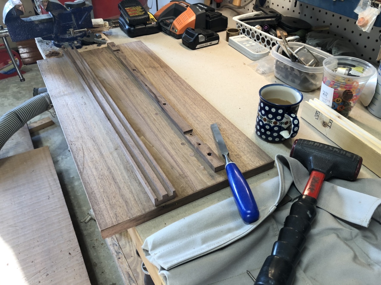

Cut an extension for the walnut work bench top. Used simple biscuit joints and then epoxied (T-88) it to top as it will have to extend further forward with the cut down ladder landing on the top of the bench. This is all part of the mods necessary to accommodate the engine. Sigh. I may have to add some more as I may have got the measurement mixed up in my head. LOL. Will know tomorrow. Either way it’s a small thing to correct.

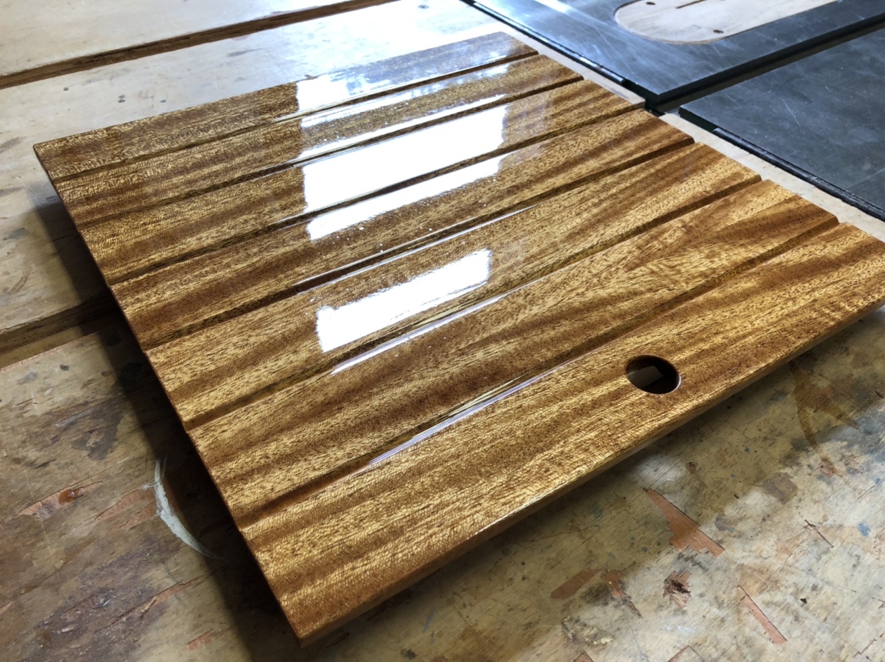

Applied the first varnish sealing coal to the mahogany sliding doors—50-50 mix of varnish with mineral spirits. I’ll come back in an hour and apply a second near full strength coat. It’s the only coat you can essentially hot coat. All others you have to wait a day between coats.

Thanks Jim. It’s coming along. Applied 6th or 7th coat this morning. I lost count. But I think it’s complete.

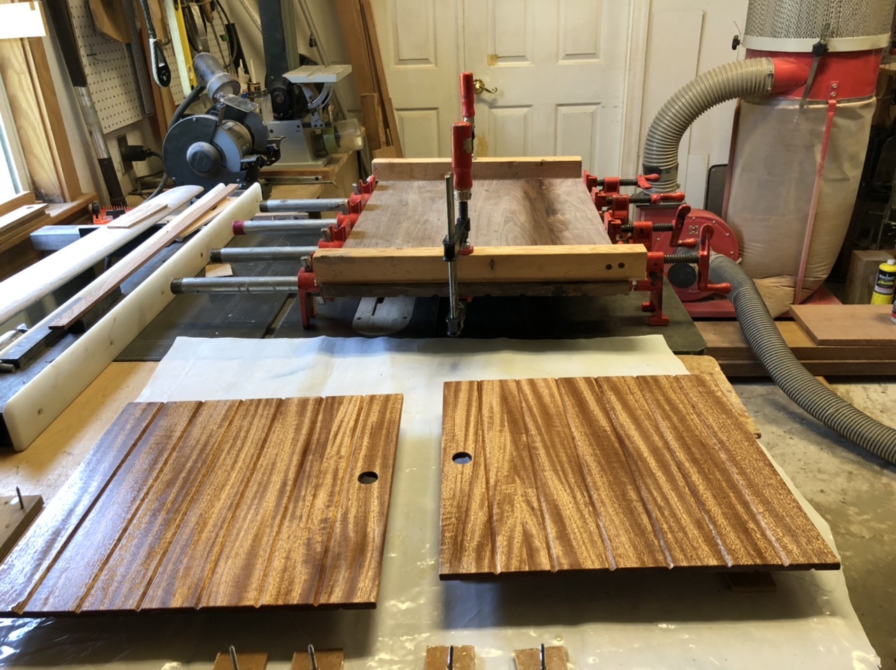

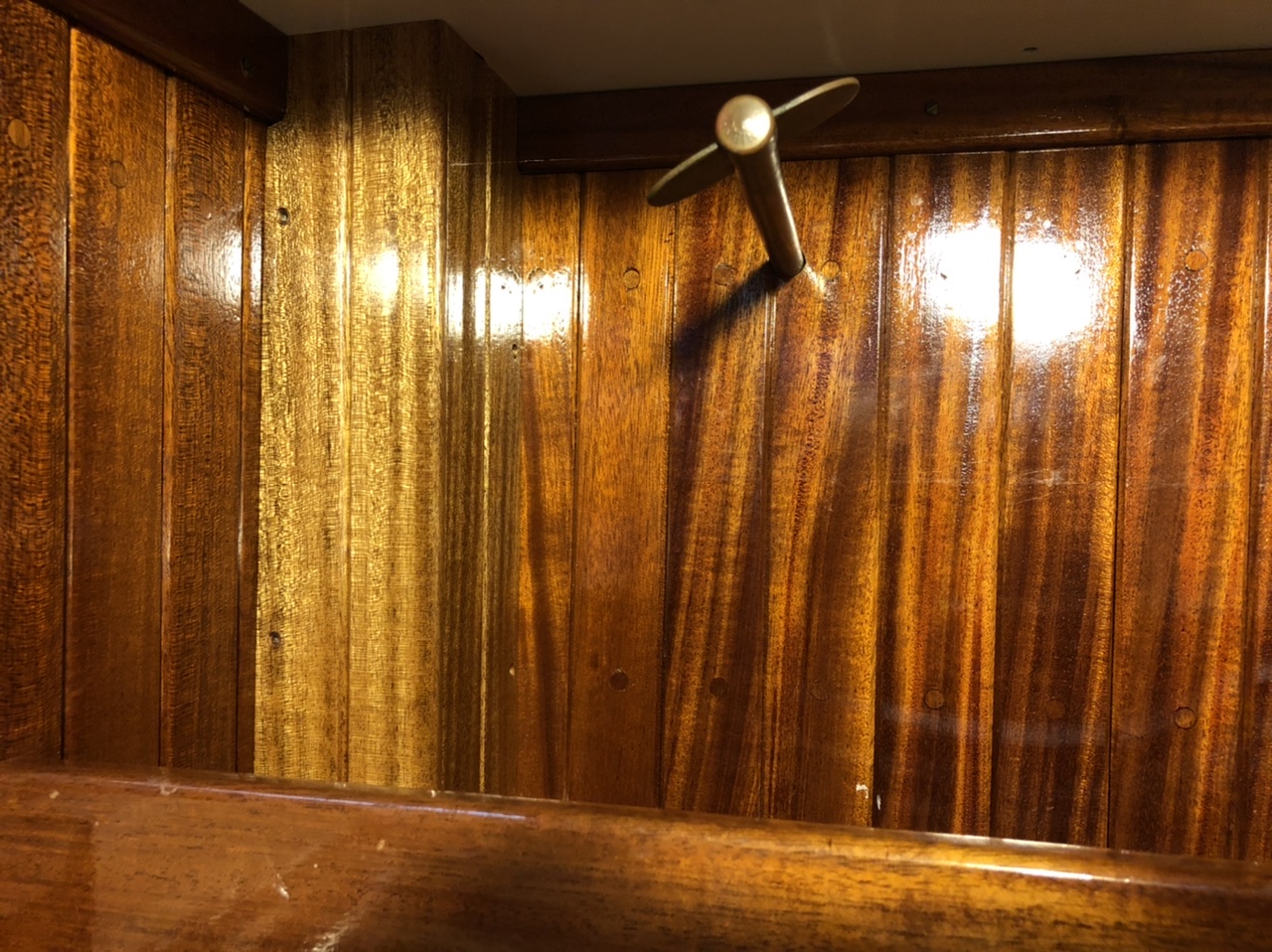

Completed the varnishing of the sliding doors to hide the electrical panel and engine gauges. I thought I was finished two days ago. But there were a lot of dust bubbles in the final coat. It was my own fault. I got lazy. Though I did move the panels to a more sterile environment (upstairs guest bathroom on a folding table) I took short cuts. I didn’t apply freshly stained varnish in a new cup. I didn’t change my shirt or really attempt to eliminate as much contamination as possible. There are no short cuts when it comes to varnish. So, I had to sand the finish flat with an RO sander and then go through my normal final coat protocol—upstairs head with folding table, vacuum the panels, wipe down with mineral spirts with lint free cloth, Strain varnish in fresh cup, thin and swirl to mix, wait 30 min, then tac cloth, put on a fresh T shirt, no hat, etc. Pictures below show the difference between three coats and seven coats of varnish. Not flawless...a few specs of dust...but pretty darn good. I’m satisfied. Move on.
Heat advisory again today.
- Three coats of varnish.
- 87D0CF1F-ED31-4A2F-BF86-38782C3B5083.jpeg (329.85 KiB) Viewed 1533 times
- Seven coats of varnish.
- AB306F92-F9BF-4763-AEB4-9F6AD5BFC661.jpeg (484.91 KiB) Viewed 1533 times

Changing my shirt is something I've never thought of doing before varnishing. I'll have to try that. Maybe even a shower is in order to get the dust out of my hair/beard? I always get too much dust in the varnish.
Absolutely. I wash my arms and vacuum my beard, etc. It makes a difference. Lin Pardey tells a funny story about a professional varnisher she knew in SOCAL that wiped the boat interior down, closed it up, stripped naked, put on classical music, and varnished while getting high on the fumes. LOL. Too extreme for her but apparently his varnish results were legendary.wikakaru wrote:Changing my shirt is something I've never thought of doing before varnishing. I'll have to try that. Maybe even a shower is in order to get the dust out of my hair/beard? I always get too much dust in the varnish.

You sure do put down a pretty finish. The flair in that wood is amazing. That first picture looked like there might have been some oil in the pores of the wood. I once tried to spray a gun stock for my dad. We had it all prepped up nice and wiped it down with solvent but we kept getting these fish eye spots. We finally figured out it was from gun oil that had soaked into the stock. After a lot of coats we finally got rid of them.
Those are some very pretty doors, Steve.
Thanks Steve. Much appreciated.Steve Laume wrote:You sure do put down a pretty finish. The flair in that wood is amazing. That first picture looked like there might have been some oil in the pores of the wood. I once tried to spray a gun stock for my dad. We had it all prepped up nice and wiped it down with solvent but we kept getting these fish eye spots. We finally figured out it was from gun oil that had soaked into the stock. After a lot of coats we finally got rid of them.

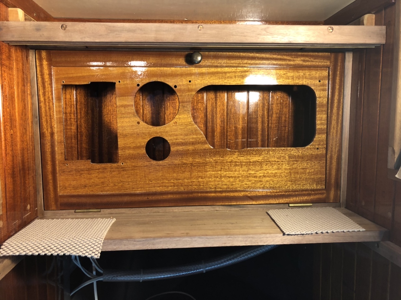

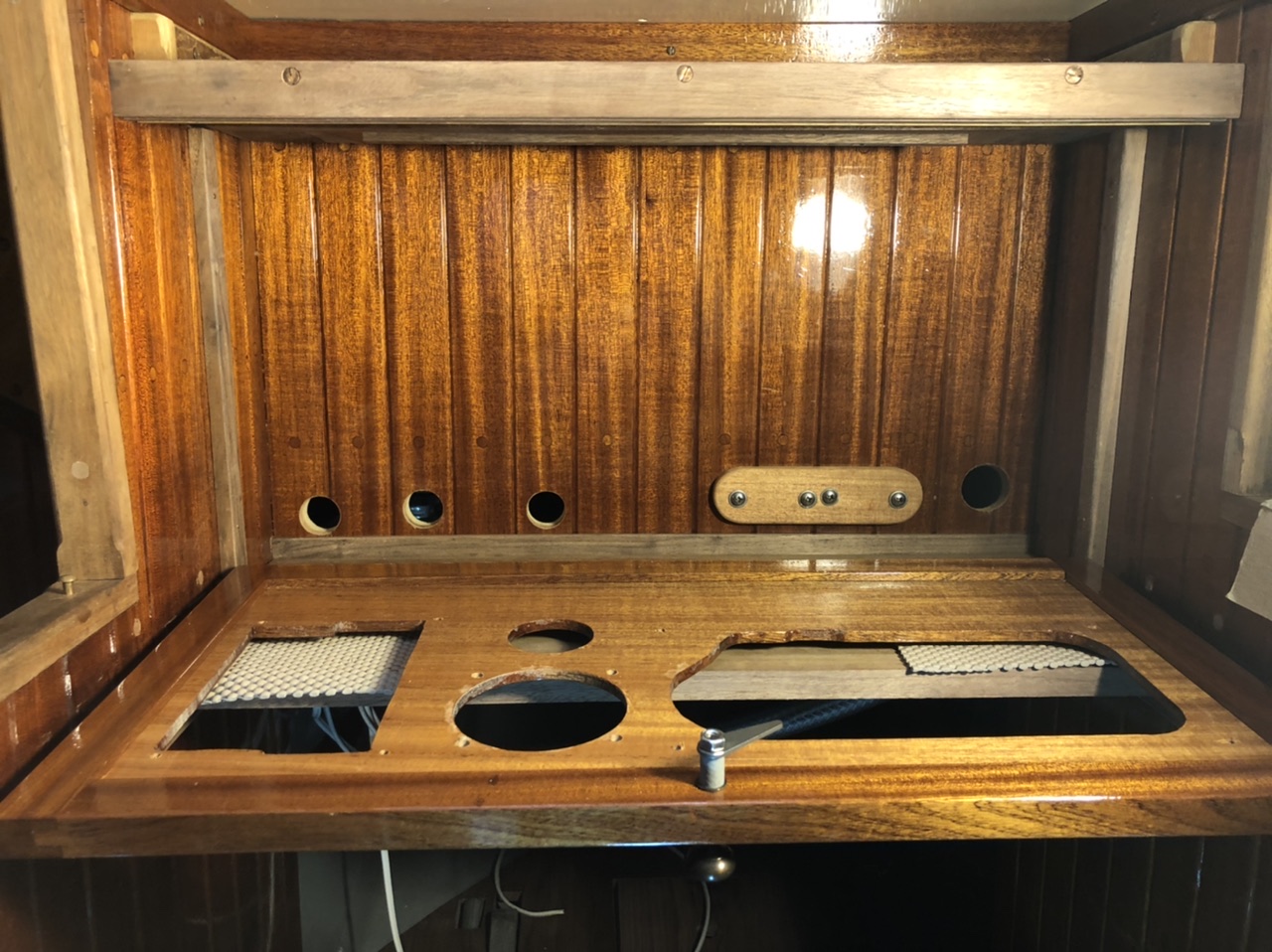

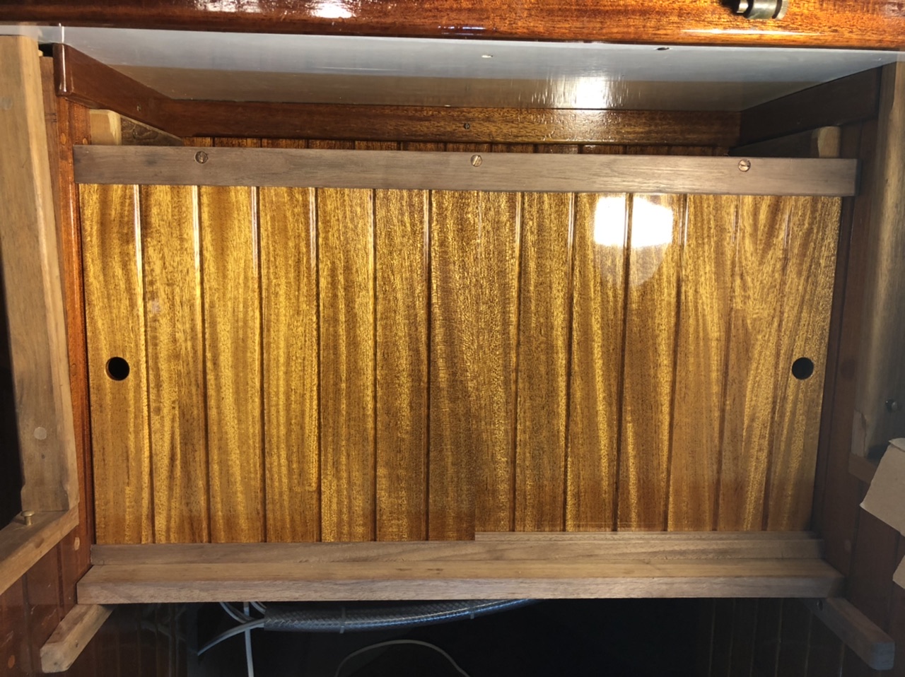

I reinstalled the sliding door rail above the hinged door with three bronze FH screws. That shelf holds the drop boards. I don’t varnish either. Bare teak drop boards are easy to store...just stack them and slide them into the shelf. Quick and easy. I have been keeping them there for five years. Perfect. But, I needed to add the top rail. Done.
Then I added the walnut door stop to the underside of the shelf so the door would not over-travel when closed. Done.
Next, I installed the walnut trim around the panel door frame. That was fussy work getting everything right and aligned just so. Secured them with brass escutcheon pins. Done.
Last, I played with the wiring. I removed all the little plastic wire keepers that hold the duplex in place from the old location. I spent time lying on my back looking up at that space—I only snoozed a little—to figure out how the wire would be routed to the new breaker panel location. I thought about the wiring harness for the Beta 25hp and how it would be routed to the instrument panel. I thought about the chafe guards and tried to envision the wire plan to include the battery cables and the relay box location for the Blue Seas Add A Battery switch. I thought about that darn water lock muffler and where it might go and what could interfere later with this or that. I have never installed an engine before so my thinking has to be careful and methodical—make the unknowns, known...as it were. I sketched a few things out and made some notes. I sent an email to one of my long time mentors.
I gathered two hole saws. I drilled one larger 1.5” hole—on the right—which will just allow the fat multipin connector on the Beta harness to pass through to the instrument cluster. Next, I drilled a smaller 1.25” hole for the duplex wiring. Both chafe guards fit snug. Good to go.
But wait...what about future growth? What about the #2 battery cables? Once that panel gets wired up
drilling additional holes will be very tough. So, let’s think about it some more. Ok, drill two more holes. That should do it. There were some obstacles to dodge behind the mahogany—framing cleats and the scupper and hose that supports it. I couldn’t get perfect alignment. I had to compromise a wee bit.
I’ll apply some epoxy to seal the end grain next time I am at the boat. Then start rerouting the wiring. Keep putting one foot in front of the other.
A long day. Only a little to show for it. More brain work than physical work. But that’s the way it goes some days.
- The panel door is all trimmed in. Ready to go.
- DEF59D20-6636-45AC-AED8-09D75D92DB6B.jpeg (354.05 KiB) Viewed 1506 times
- The holes for wiring are all drilled.
- 9AD5D52B-F76B-45C4-8FD1-EDAAB2D77F50.jpeg (368.83 KiB) Viewed 1506 times
One more picture. The completed varnished sliding doors final test fit. I’m pleased with how they turned out.
- 54B1768A-9A84-44E5-8133-A8F285019E23.jpeg (401.3 KiB) Viewed 1506 times

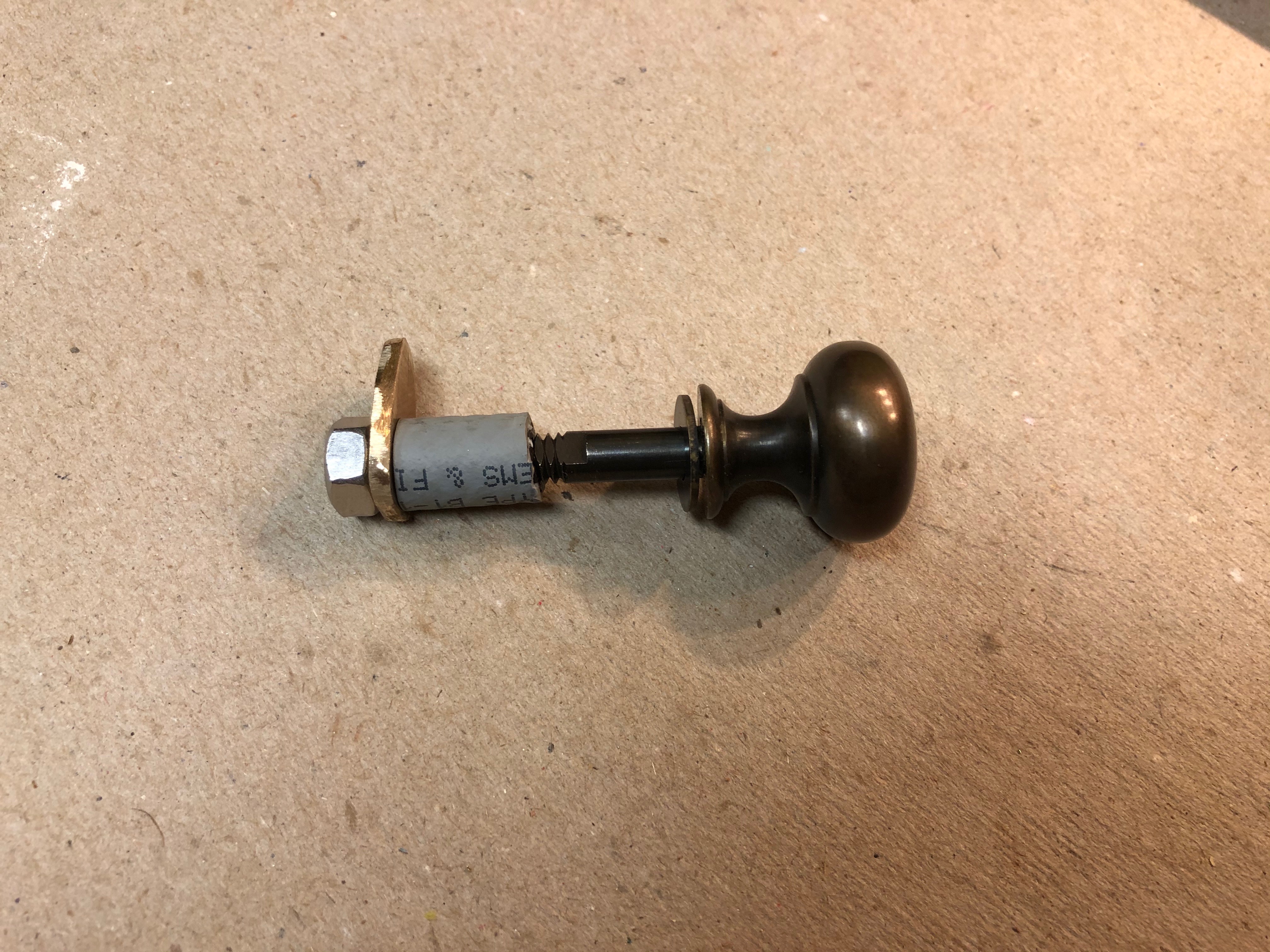

I am using the downtime to work on the icebox lid/plug improving it a bit. It’s solid teak and ash and gave me a little trouble during the last voyage but I think I have it figured out now.
I’m varnishing the cover box I built from mahogany for the diesel fuel hose behind the stove. I also worked on the cabinet knob for the electrical panel. This is the same kind of bullet proof brass turn-knob I used on all my cabinet doors. It’s non ferrous solid brass except the steel latch. The latch is too long for this particular door frame so I replaced the latch with a short 1/8” thick silicon bronze one I fabricated yesterday. The hose is from a piece of fuel line and serves as a spacer to position the keeper so it catches behind the door stop. Sounds complicated but very simple.
I’ll check on the boat tomorrow and again during the storm. In the meantime I’ll work in the home shop. As soon as the storm passes I’ll go back to work inside the boat on the electrical wiring.
The Raymarine depth sounder arrived and looks like a nice piece of equipment though it will never be as accurate or reliable as my lead line. Just saying.

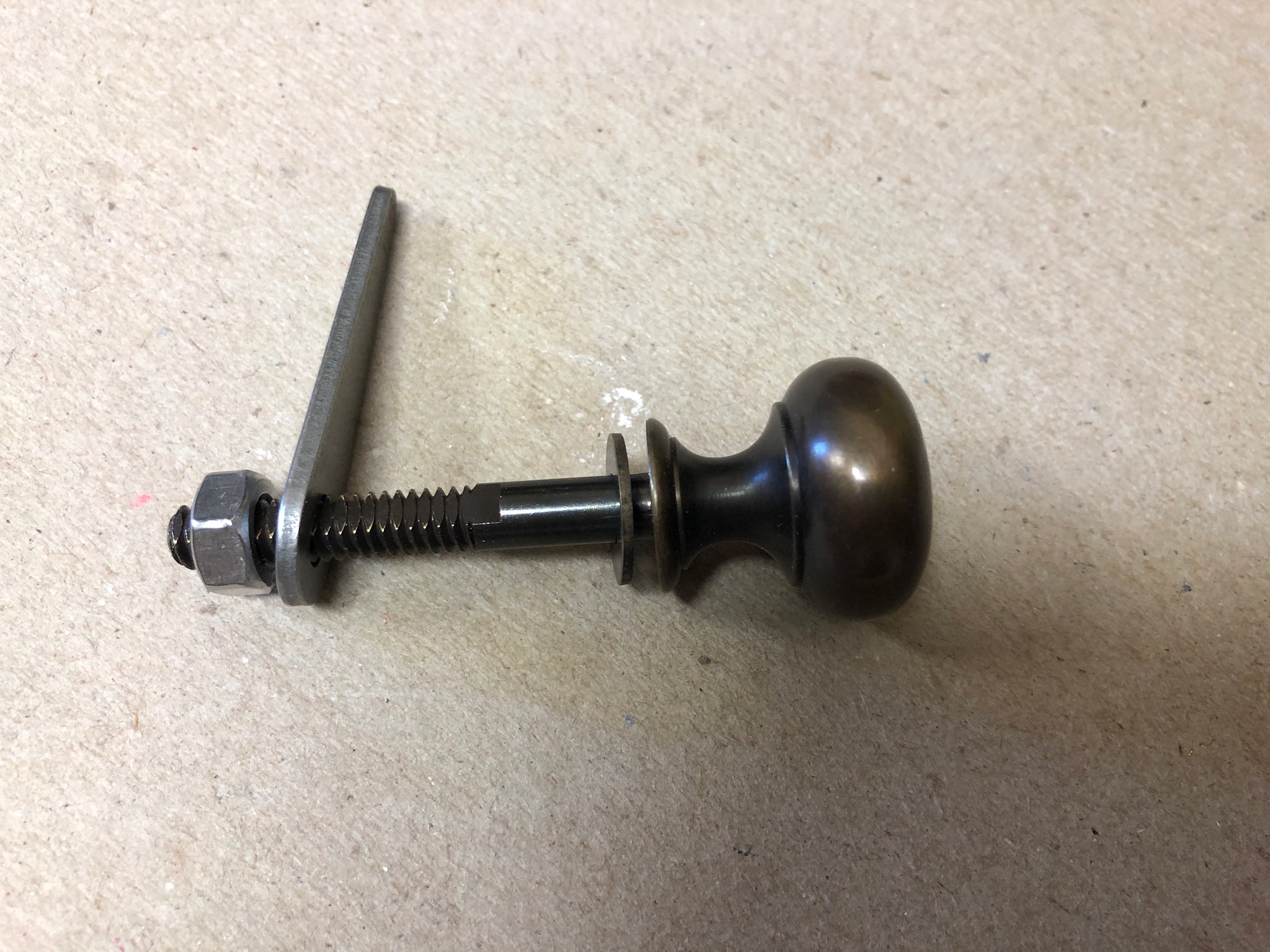

- All the knob components are brass except the latch which is steel. It’s also too long for this particular door frame.
- B191CAFF-4022-4D6E-8089-E8E74503FE57.jpeg (863.67 KiB) Viewed 1489 times
- I fabricated a short latch from 1/8” silicon bronze.
- 54ED7817-032E-46C6-821A-5C3D4E736ED2.jpeg (2.59 MiB) Viewed 1489 times

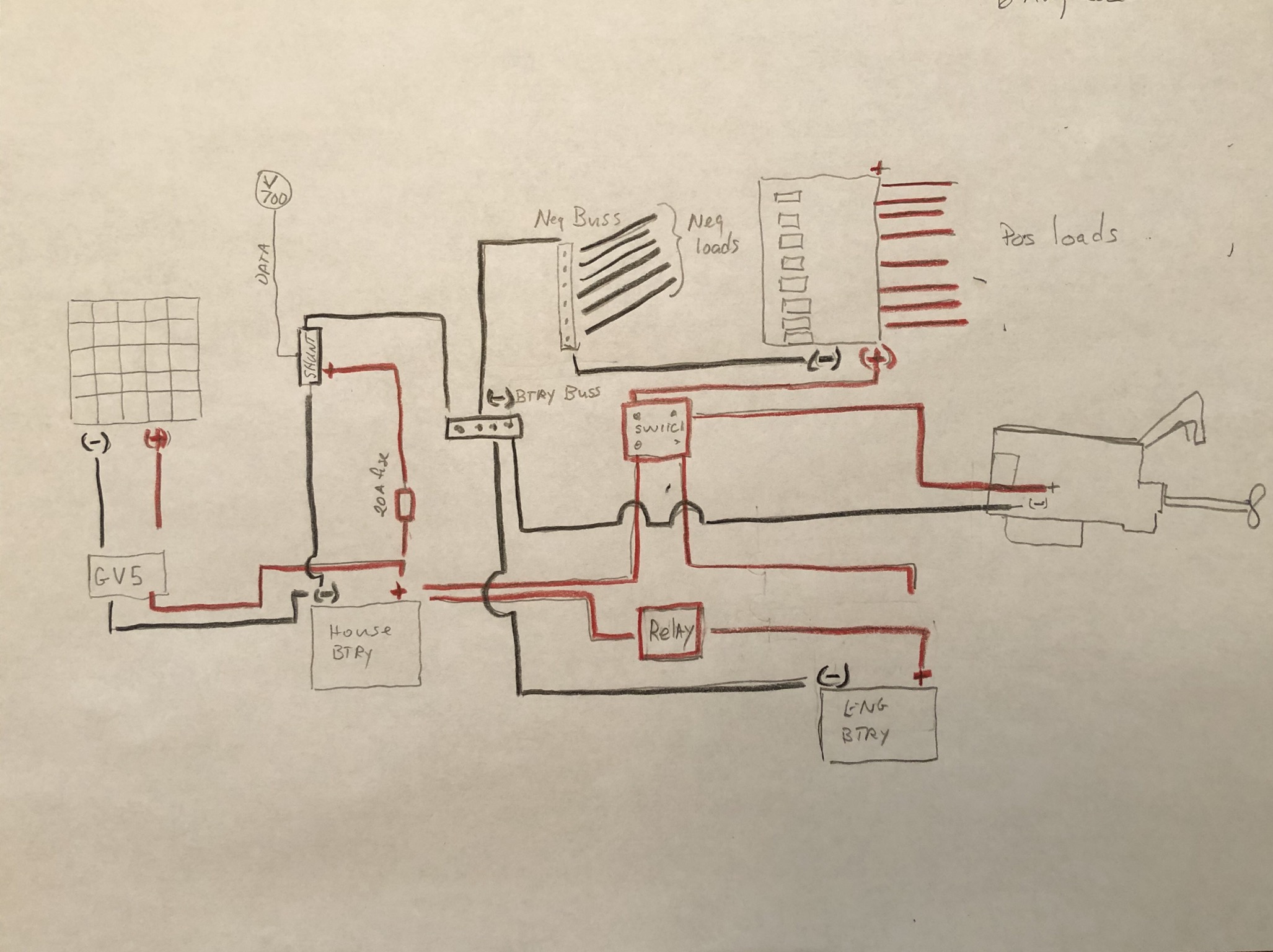

I have also been sketching out an electrical schematic diagram so I don’t get lost relocating the panel or installing additions to the current system. The only thing new is adding a dedicated AGM engine battery and a new battery switch. Of course the engine is new and I am adding one more LED light and the Raymarine depth sounder. That seems like enough change to last awhile. Still trying to keep it simple. Put a lot of thought into going to Trojan T105 6v lead acid batteries. They have a lot going for them. But, I think I am going to stay with the single 100ah AGM For the house and add another for the engine.
Of course it’s the relocating of the distribution panel and the engine that’s really the focus of the work.

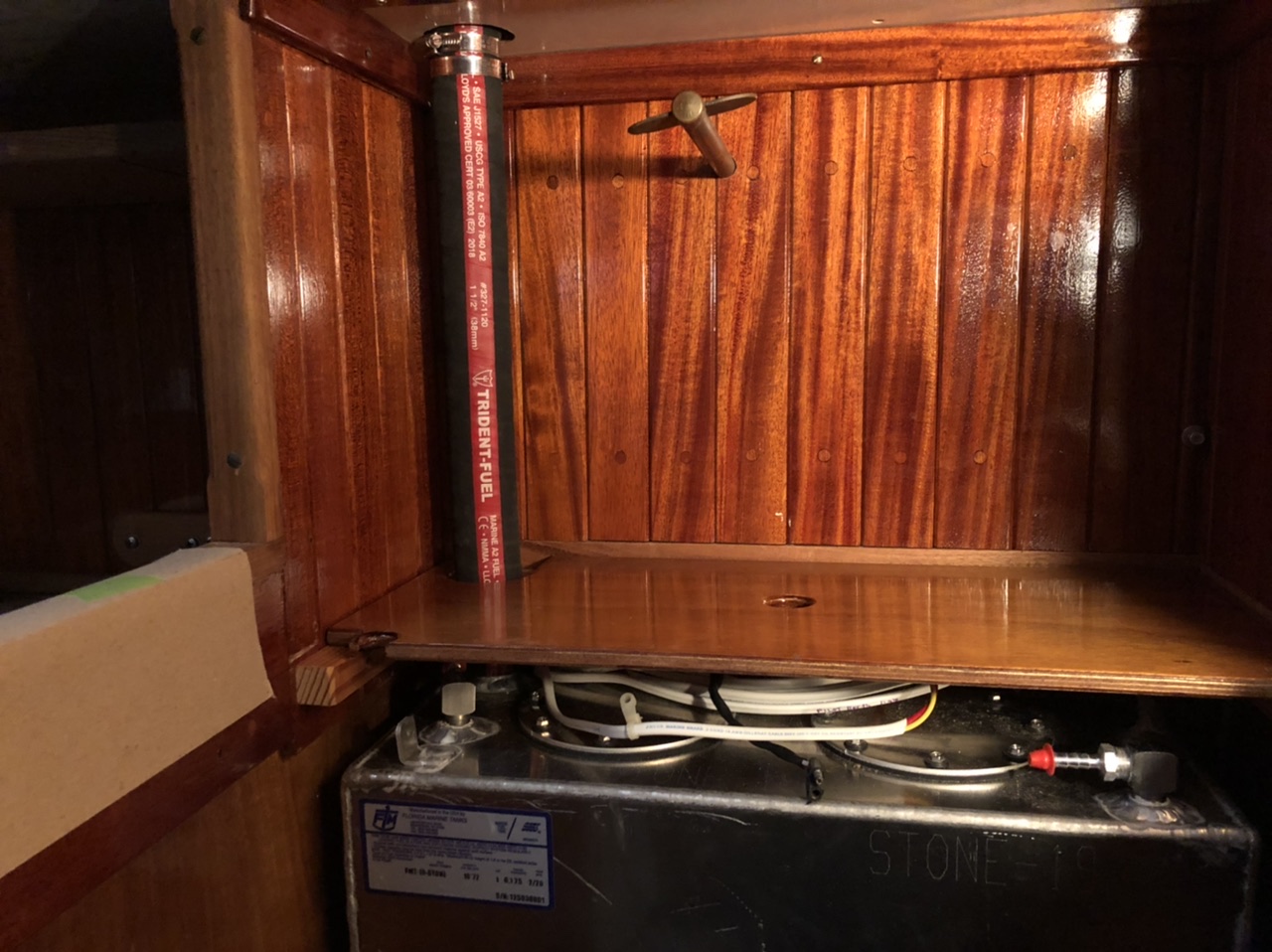

- This is the fuel hose I installed connecting the deck fill mounted on the bridge deck with the tank behind the stove.
- D826173F-2576-411B-A41B-BA9482E53FF1.jpeg (307.88 KiB) Viewed 1467 times
- The cover box temporarily in place. Bronze OH screws hold it in place so it will be easy to remove.
- B8ED0570-9E94-47EF-BEFB-22B1067B6E66.jpeg (458.33 KiB) Viewed 1467 times
- This is my basic electrical plan.
- AFF56461-D682-4BCF-B59B-AA52CE9D1A3B.jpeg (451.85 KiB) Viewed 1467 times
