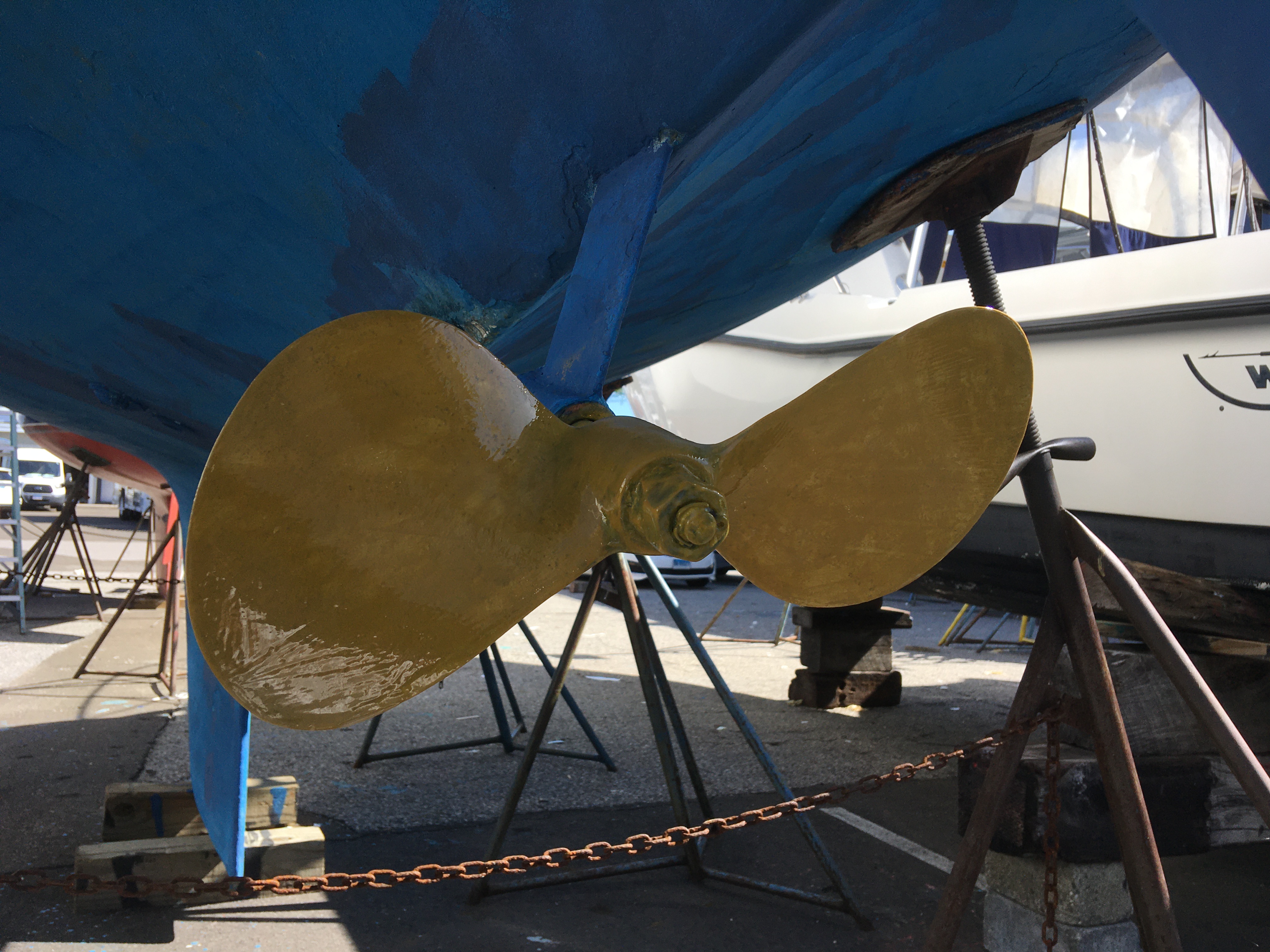

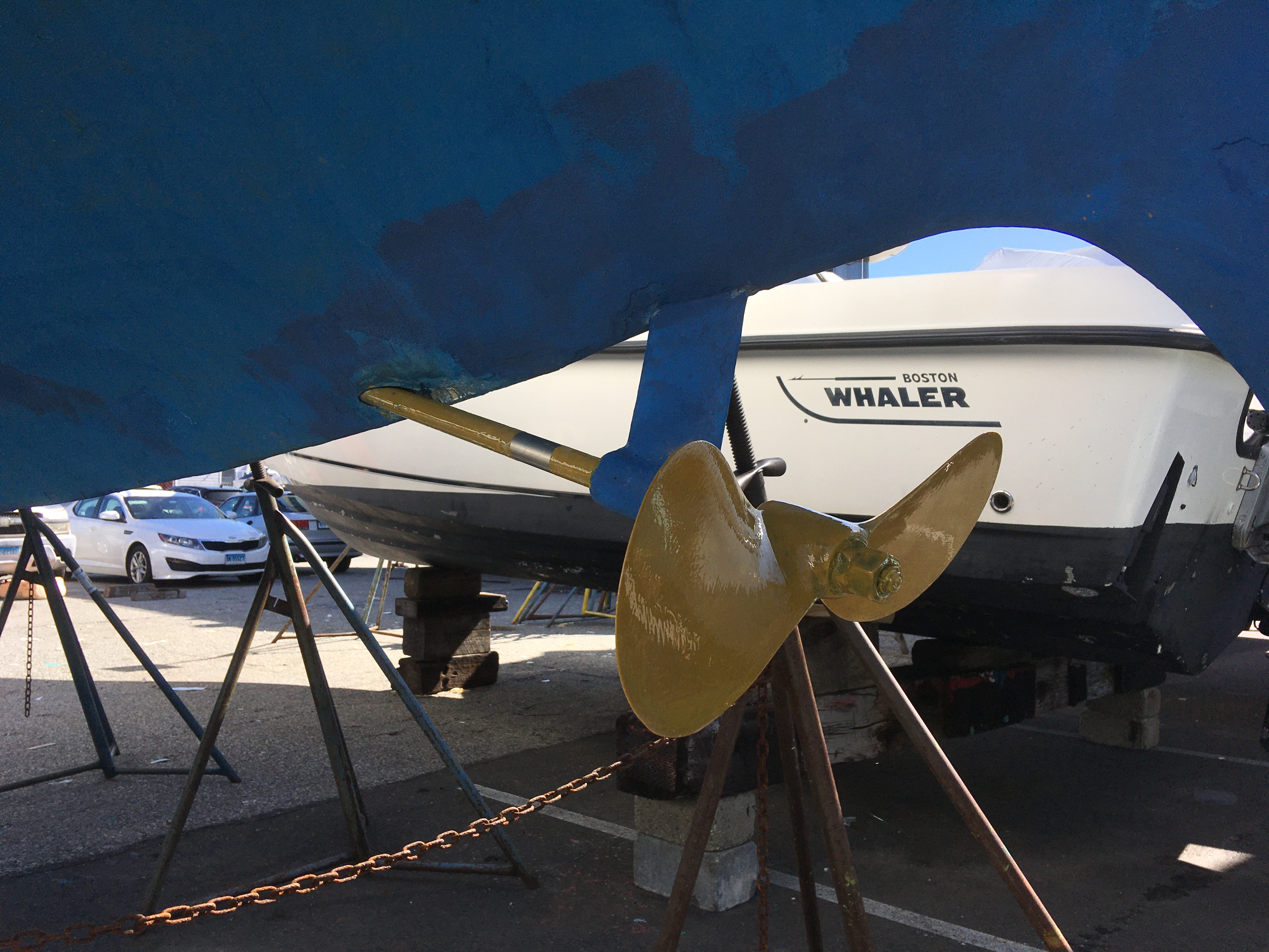

For this season (2025) I am using PropGlide.
I bought the "small" size kit which was enough for two boats. I could have just bought the "sailboat" size.
My neighbor at the marina was not around so the extra paint went to waste.
Not really difficult to apply. Just need to get the prop and shaft clean to begin with and then sand with 80 grit.
See how it does this season.
I'll post the results in November.
