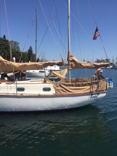

Re: Fayaway winter projects: chainplates, dodger and more
I had to pay big bucks for mine. It should last the rest of my life. It's an "Iverson". I was installing the cockpit canvas when this photo was taken. I have it all tightened up nicely now.What are they called? One guy called them cockpit curtains. He's a liveaboard and never sails. just thinks they are for privacy. I was referring to them as splash shields.
Thanks for nice comments, guys.
Keith, the key is a good template. If you have an accurate template and sew on the lines it'll come out perfect.
JD, that's a very nice dodger. They did a good job. I've since added struts and side grab rails to mine and it's as solid as can be. I also used stainless awning track with bolt rope for the forward windows and added some coamings on the cabin top to seal it up nicely. I template and install these things for a living but this is the first one I've sewn myself.
