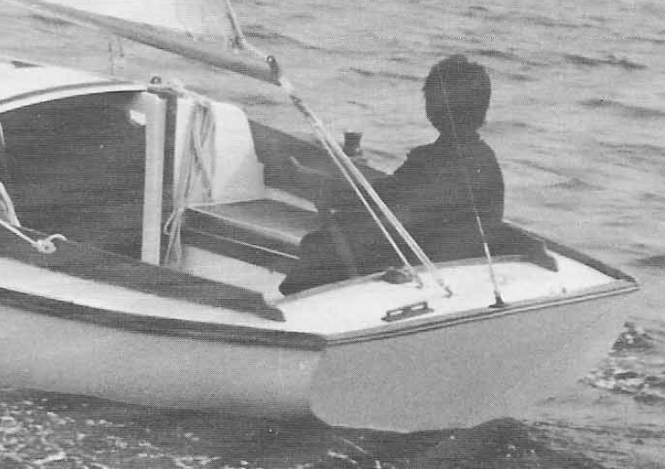

Skeep wrote:Karl, not that, but that is a great source. I'm referring to this tacky bit of stuff on my vessel:
I'm fairly certain that's factory applied garnish/trim to cover the taffrail-to-hull seam. My '76 TyWE has the same piece. I think a lot of them went missing as they seem prone to snagging lines at the outer edges. I've spent some time cleaning and polishing the one from my boat with good results. Still, I think I may omit it in the final assembly as I think it's a cleaner look without it.
Nice job on your boat, BTW!
Edit:
I remembered this picture in the Cape Dory brochure published in 1977. You can see the trim piece on the stern in this photo. I think the trim allowed them to apply the taffrail without spending a lot of time fairing the joint.

Skeep
Posts: 617
Joined: Feb 23rd, '13, 08:16
Re: Skyle the Typhoon - Complete Restoration
Post by Skeep »
Thanks for the photos and comments. After consideration, I re-put my trim piece on the advice of another who said, "you know, if it does come in contact, at least the trim will take the beating." Although it does look a bit ratty, I put it back on the stern and for the time being am ignoring how ugly it is.
