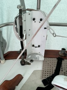

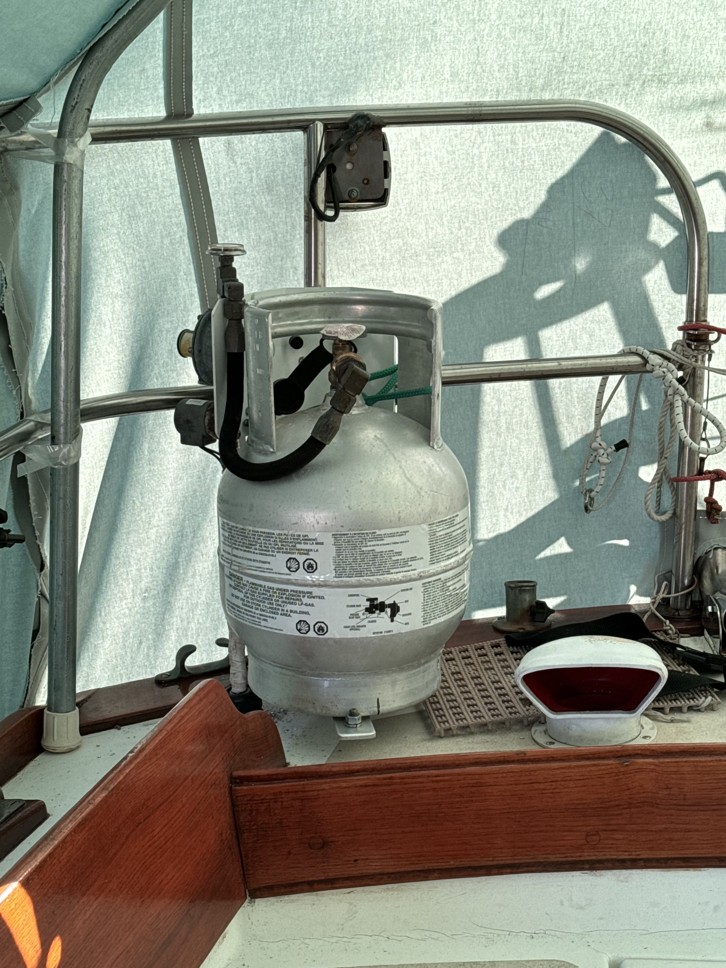

This is the latest version of the rail mount propane tank bracket I have. https://www.suremarineservice.com/Galle ... -749A.html
It’s a fine bracket and has served for many years. At our last winter meeting free raffle I scored a slightly larger tank so I just extended the base to accommodate it. Here’s a couple pictures of the old and new. I have had a Sunbrella cover made for the new tank so it’s now just as neat as the old installation.

Thanks Jim! The photos are great. That's the exact same spot I'm thinking of using.
