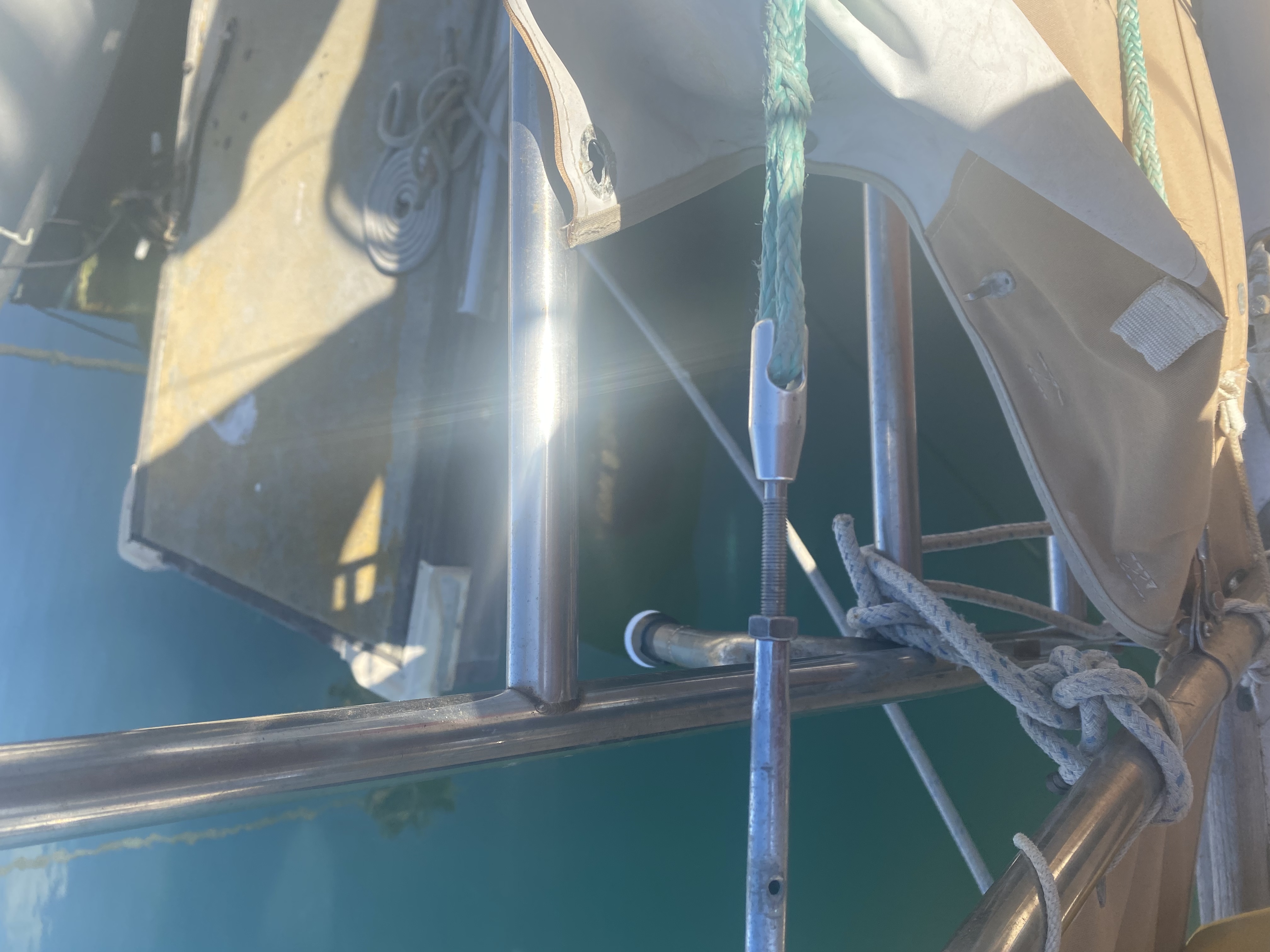

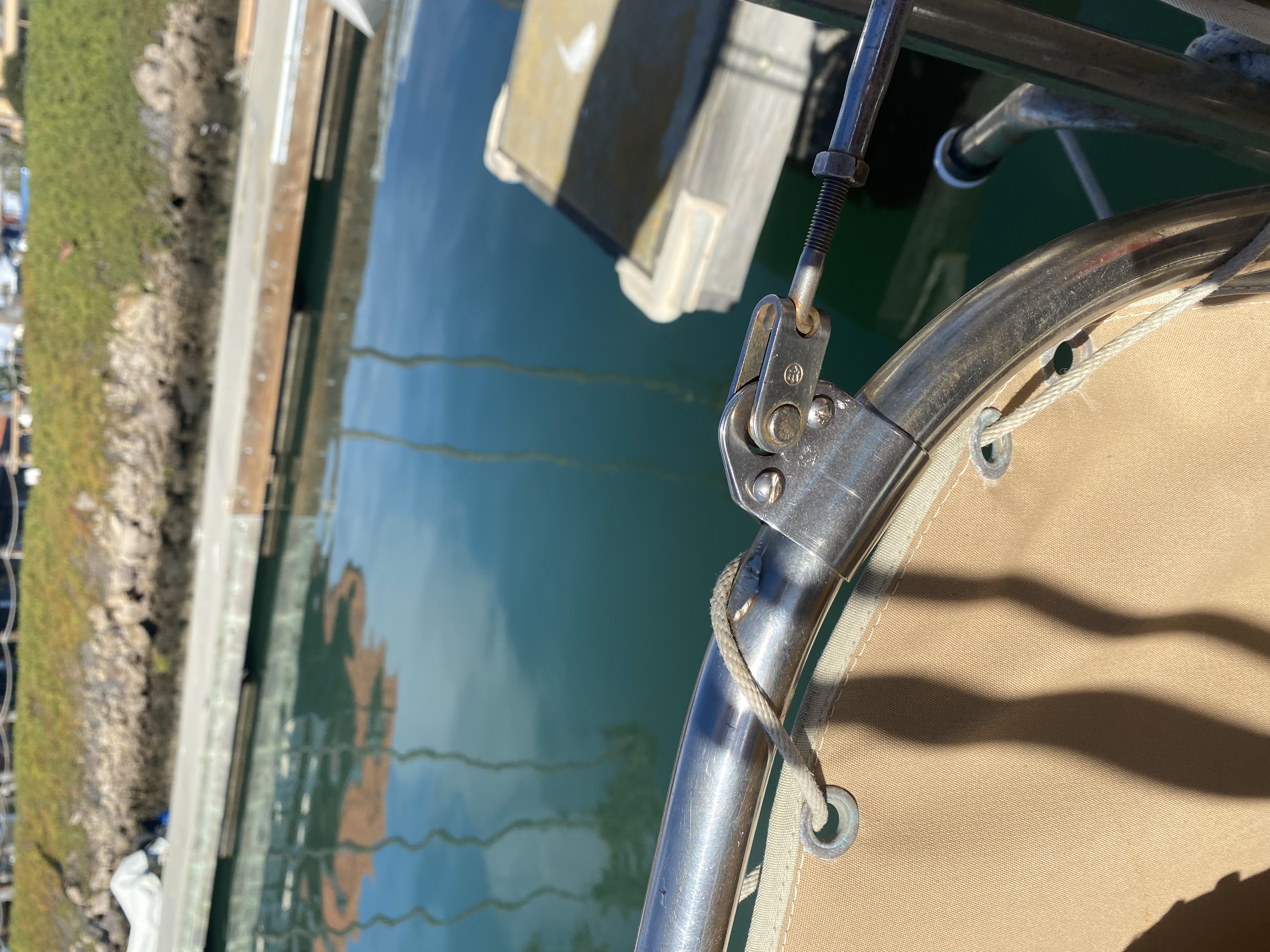

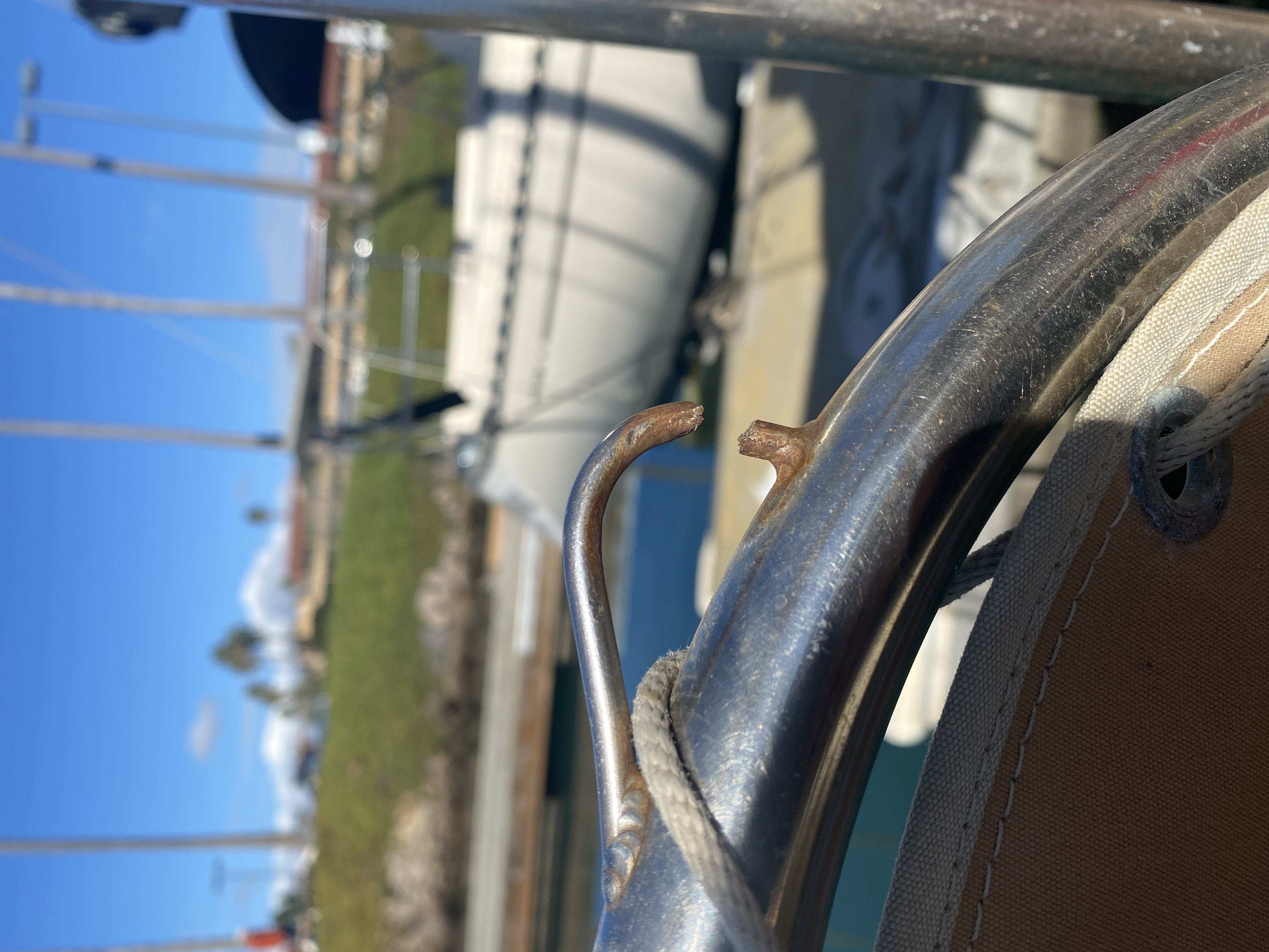

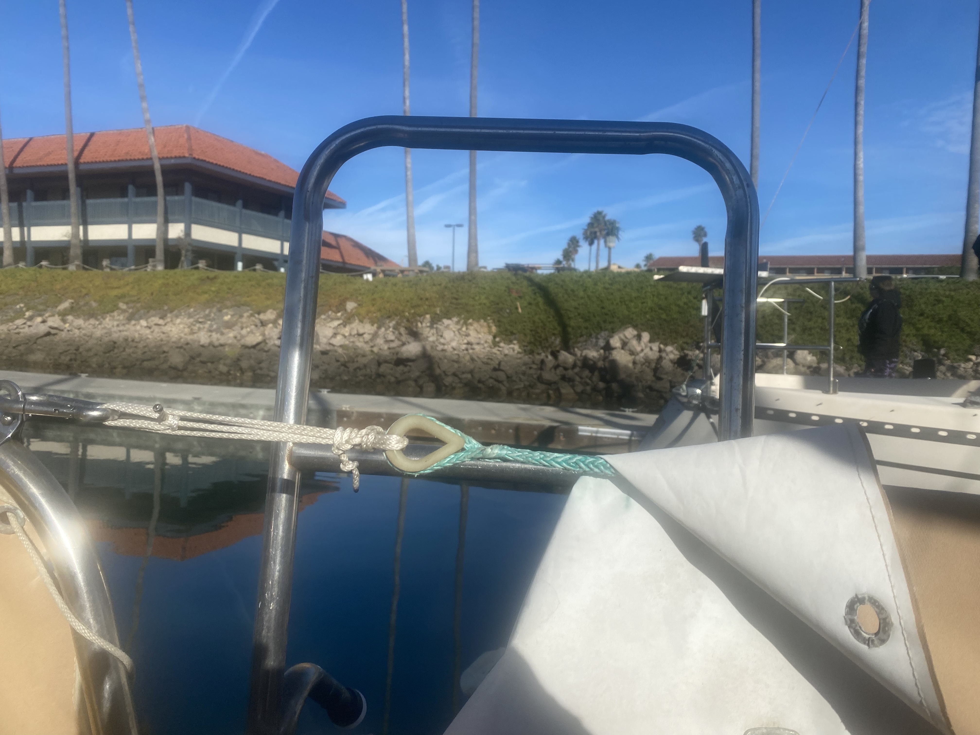

I installed Dyneema on my boat. There is so much positive discussion on the forum. I’m really glad I did it. So easy. I only want to point out one minor issue. The lifelines are only as strong as the part they are attached to. Here is a photo showing the welded loop on the pulpit. It snapped like a pretzel. This is the second time. I barely put any weight on it reaching over the side for something I dropped. I replaced it with a clamp on part. Maybe next time I pull the pulpit I’ll get them welded. Welded loops look much better.
I wonder if the 45 yr old turnbuckles are just as bad

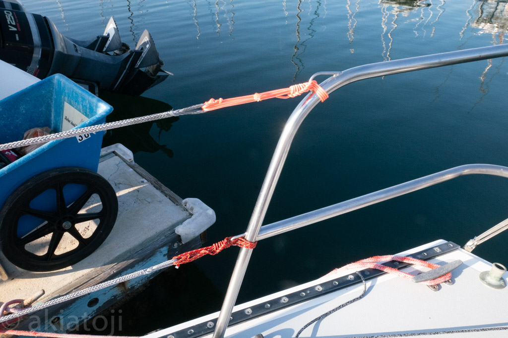

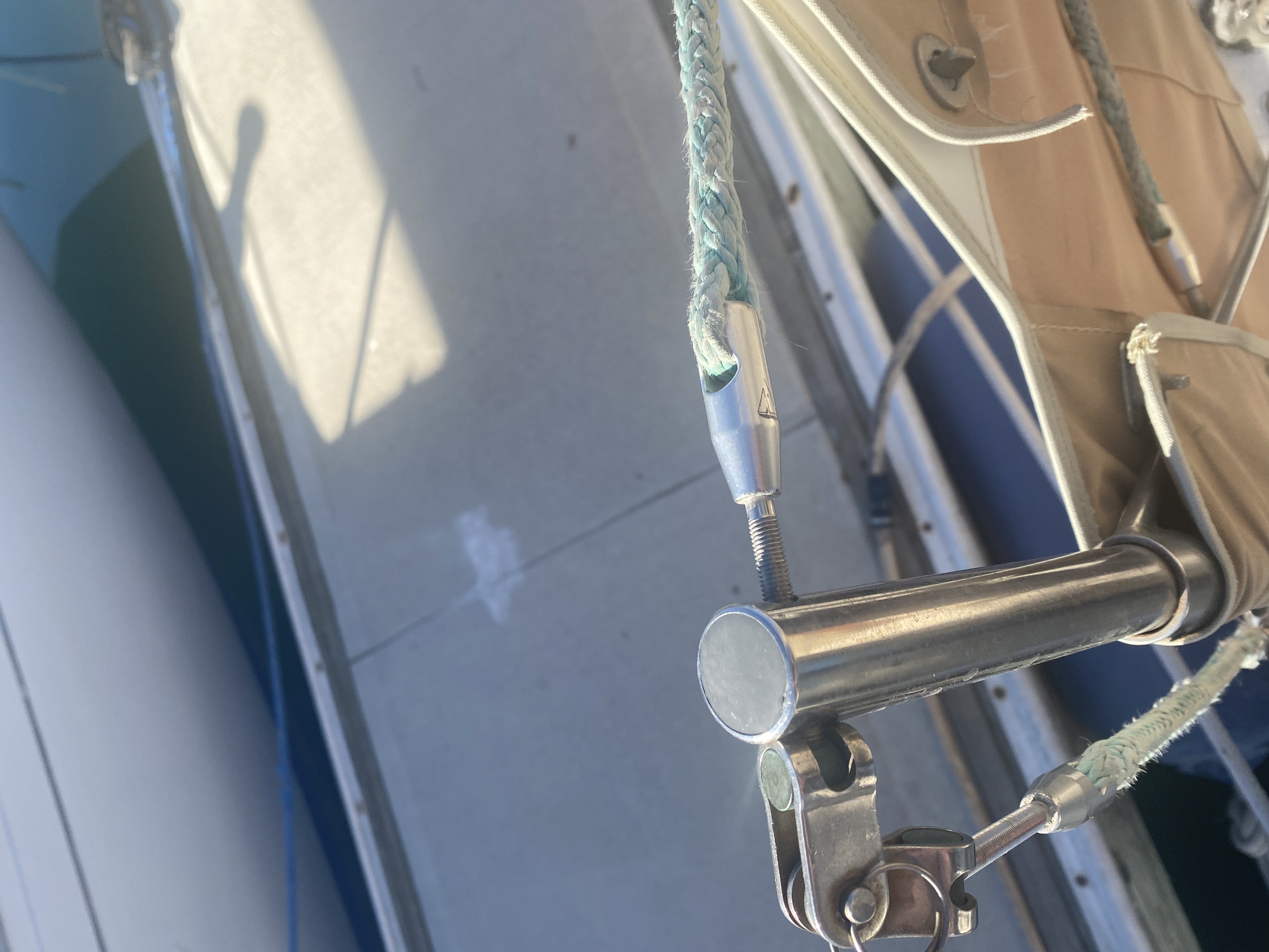

I like your clamp-on terminal connection. All the Brits forego the turnbuckles on lifelines and lace the terminal ends. The RYA insists that you be able to use a knife to drop the lifeline quickly in an emergency. I personally use snap gate hooks on the port side so I can quickly drop the upper and lower lifelines if necessary. I have my boarding gate on the starboard side only, which is similarly equipped. I replaced my original coated lifelines with uncoated 1x19 stainless years ago so I didn’t have to worry about what was going on under the coating. I prefer stainless for this application because of the chafe factor with dyneema. We all get to choose our poison.

Good idea with the snap hook. I will upgrade mine sometime in the future. I was thinking just a cow hitch on the forward end( I need the welded loop). I guess with the lacing i wouldn't need the turnbuckles. Just noticed. I did use cow hitch on upper port side. If I decide to lace the aft I will have to discard those expensive aluminum adapters that i bought. Maybe somedayJim Walsh wrote: ↑Nov 30th, '23, 09:39 I like your clamp-on terminal connection. All the Brits forego the turnbuckles on lifelines and lace the terminal ends. The RYA insists that you be able to use a knife to drop the lifeline quickly in an emergency. I personally use snap gate hooks on the port side so I can quickly drop the upper and lower lifelines if necessary. I have my boarding gate on the starboard side only, which is similarly equipped. I replaced my original coated lifelines with uncoated 1x19 stainless years ago so I didn’t have to worry about what was going on under the coating. I prefer stainless for this application because of the chafe factor with dyneema. We all get to choose our poison.

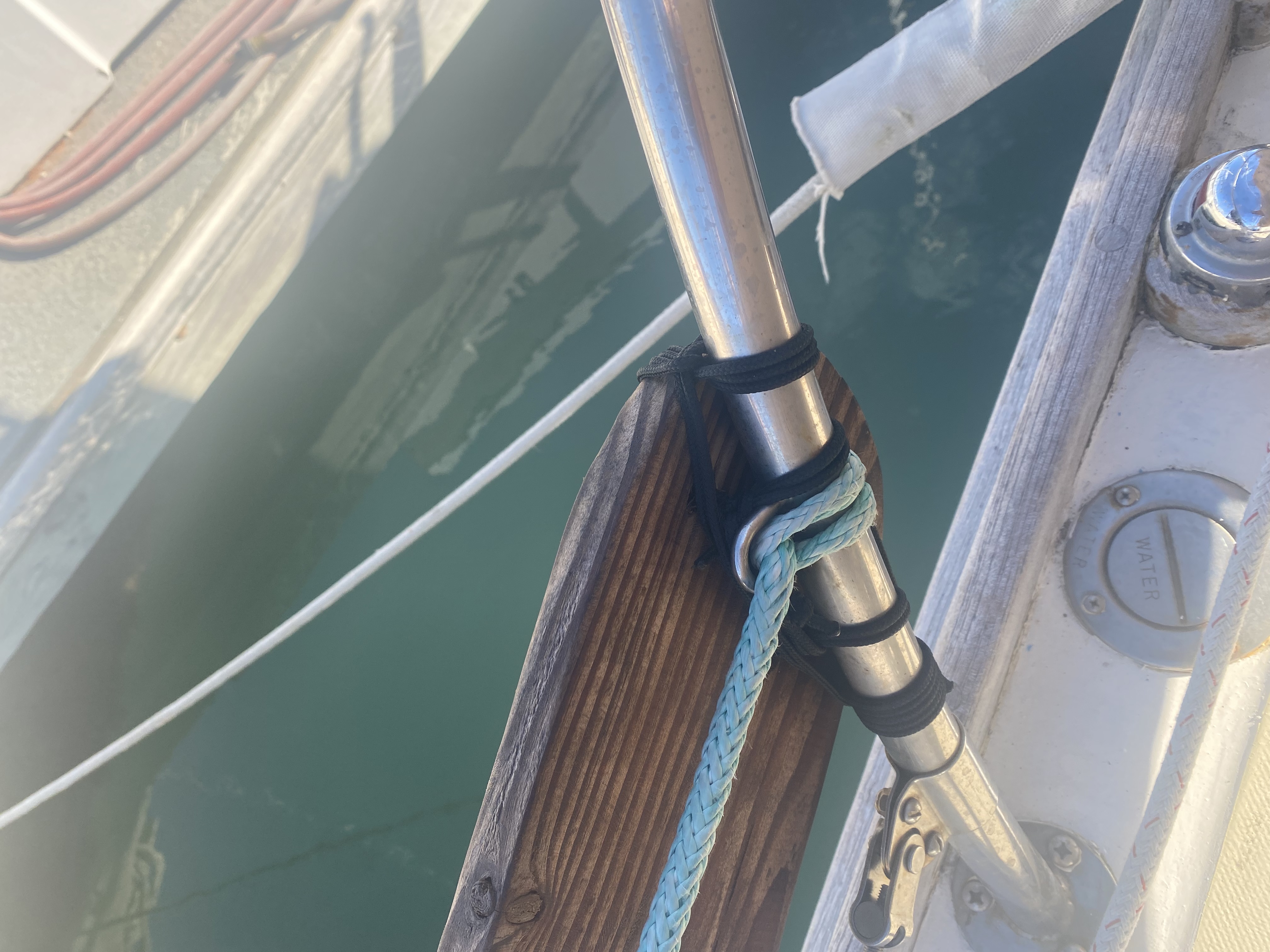

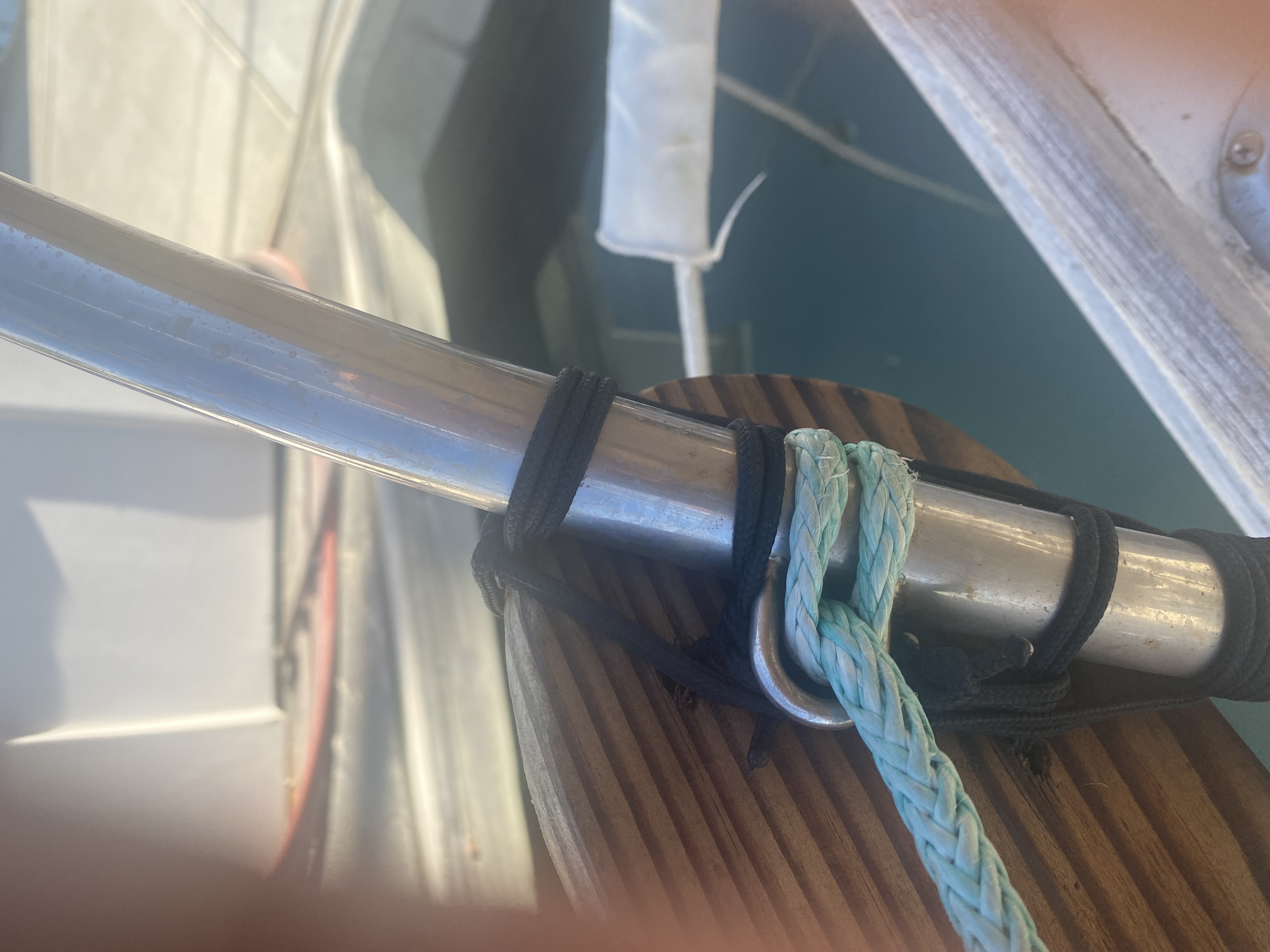

I ended up finishing the port side with cow hitch forward and lashing aft. I had to use materials on hand and cant buy anything. Im not worried about the lowers. I think the bolt part of the turnbuckle is what would break and Those have all been replaced with the aluminum adapters. I think I’ll be ok for a while

Good temporary fix! Sometimes you have to be resourceful and use what’s readily available.

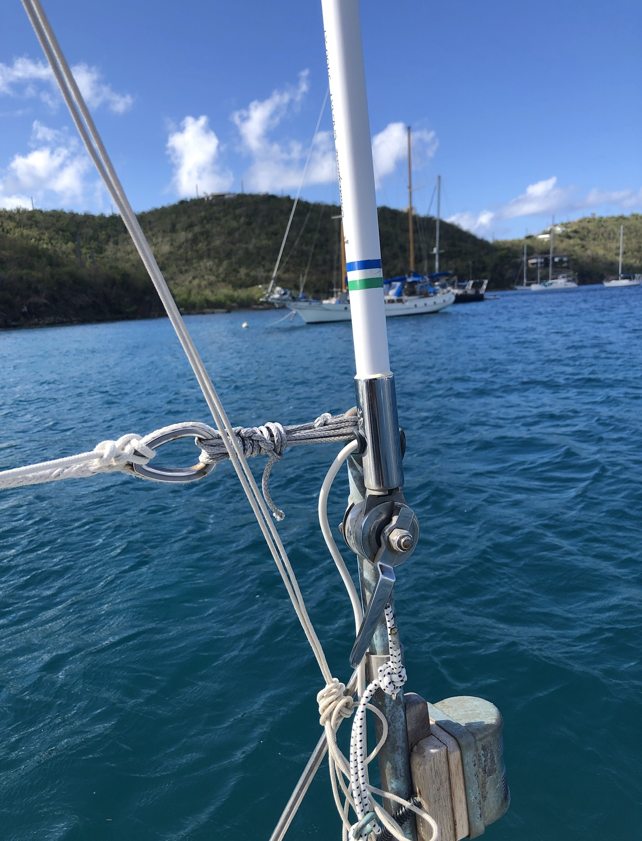

I have dyneema lifelines too. Like them very much. Cow hitch is what I use on forward end. No turnbuckles either. I lace them with 1/8" diameter dynema. You never want to rely on that welded bail on the pulpit. You were right to secure the end to the main
