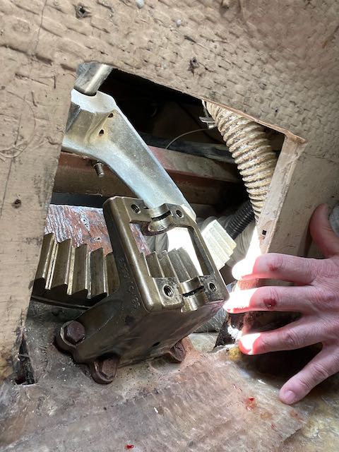

Autopilot quadrant, rack & pinion gear and chain disassembled and ready for cleaning.
Reassembling the quadrant mount with new SS bolts.

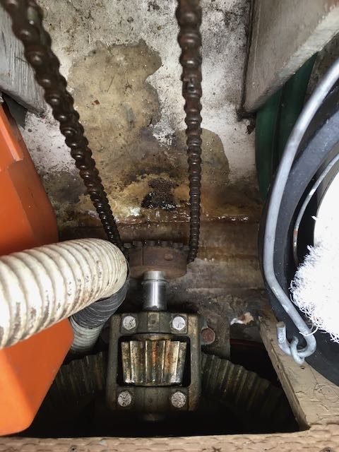

In the lazarette, the rotary chain from the AP motor above to the AP Edson quadrant. This was pre project but it looks the same, only lots cleaner and lubed nicely.

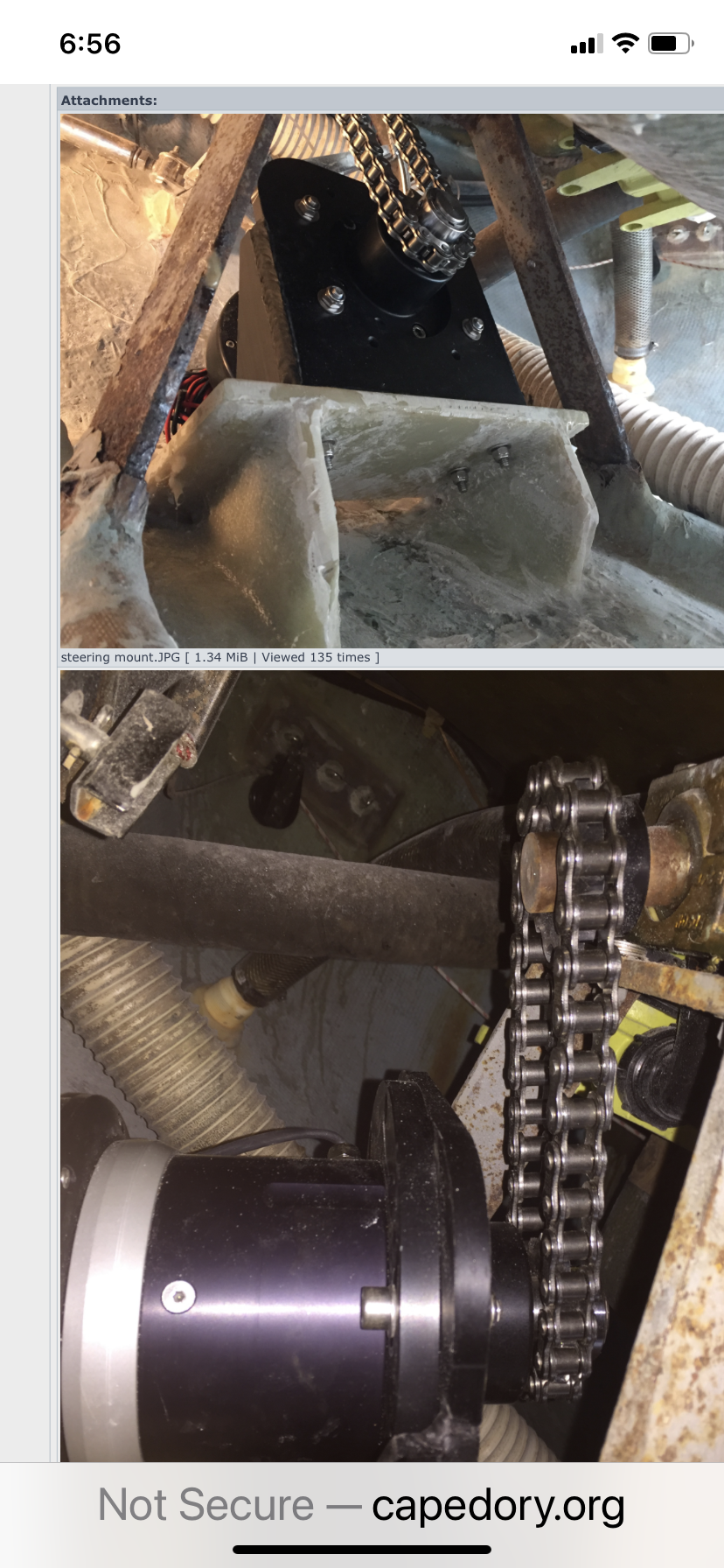

Looks nice. Paul. Just to contribute to the topic. I installed Jeffa sprocket drive system on Leoma’s worm drive steering gear you can see in the photo how it connects to the aft end of the worm gear shaft. It has been working flawlessly. It is quiet and doesn’t use much power and when the centrifugal clutch is disengaged it has no noticeable friction to affect the windvane steering
