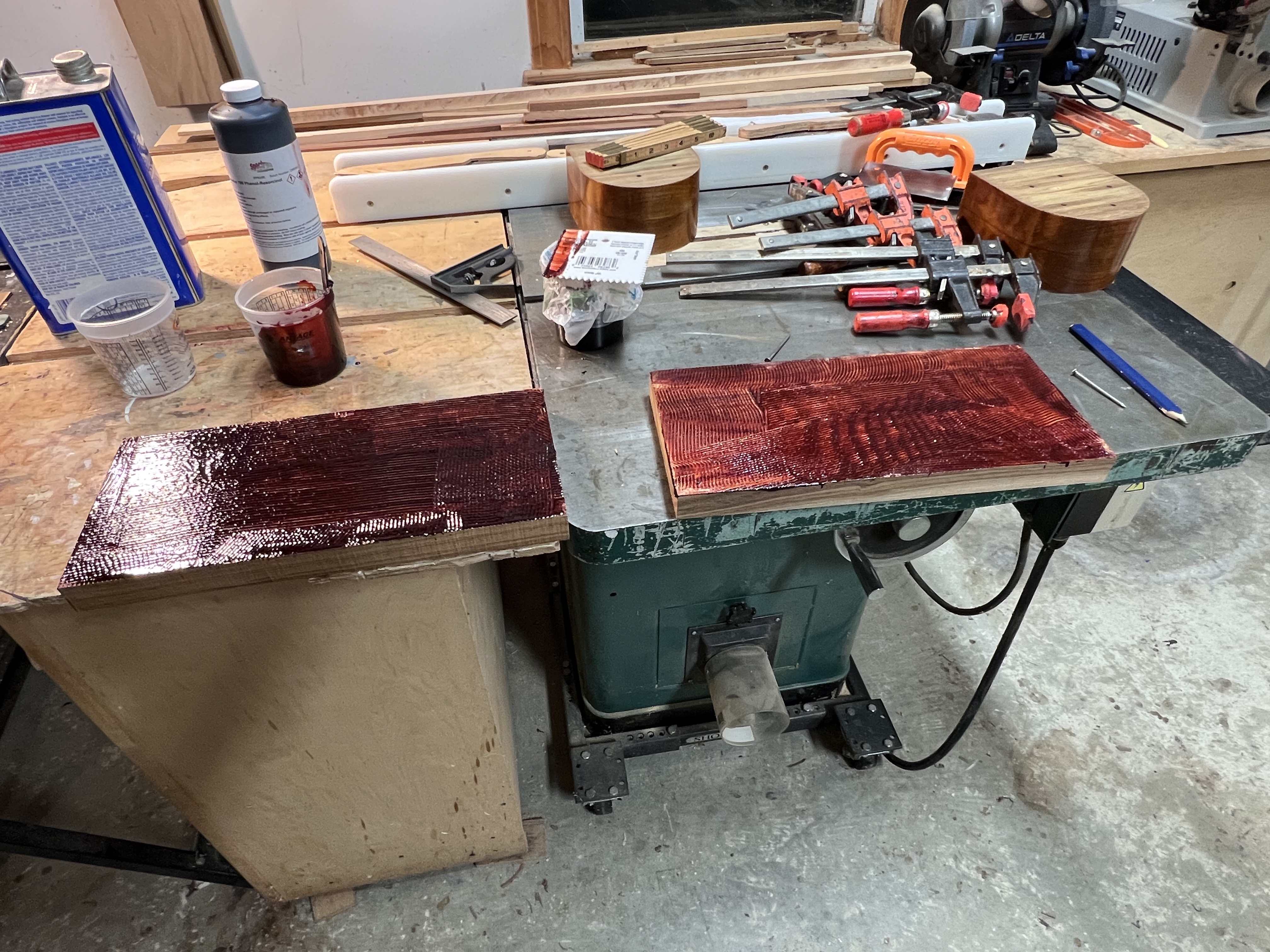

I am modifying the winch riser blocks for our stays'l sheet winches. Previously they were 4" tall and varnished with a 2" bare pad that sat on top and then the winch was on top of that. It worked well. The height was right but I wanted to match how I modified our primary sheet winch riser blocks a few years ago--with a bronze plate on top of the riser block and under the winch.
My wood supplier did not have in 8/4 (2" thick) teak shorts. So I bought some 5/4 and milled them to 1&1/16" thick. I drilled for alignment pins so they would slip around when I glued them up.

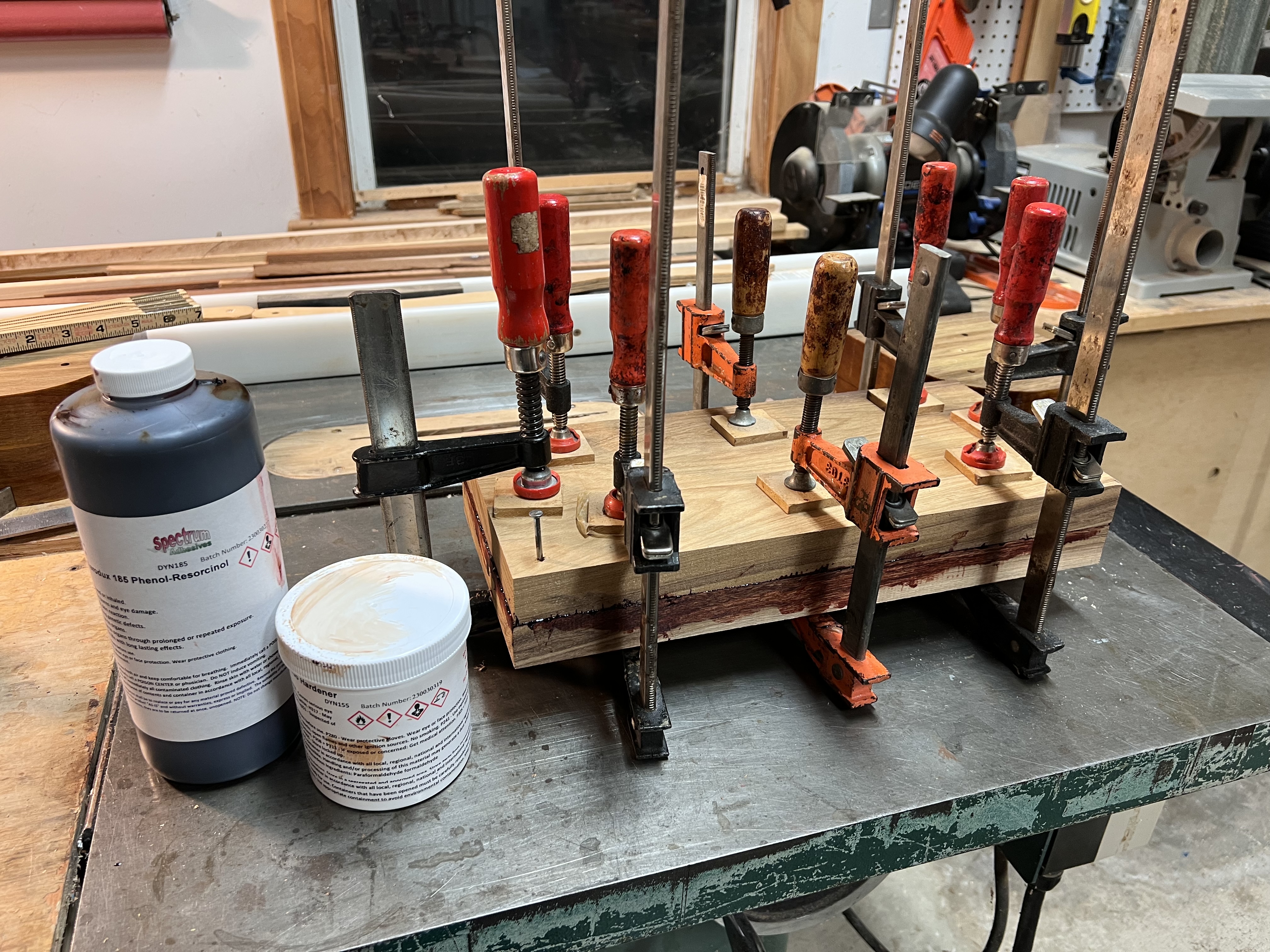

Next, I mixed Aerodux 185 which is an advanced resorcinol adhesive. A little thicker than standard resorcinol and can be used down to 50°F. You can always tell when resorcinol is used because it leaves a distinctive purple glue line. I spread it on thin and clamped it hard. No sanding. Just machined and wiped down with acetone, glue and clamp.
I have written about resorcinol before. Resorcinol is an adhesive far superior to epoxy in certain circumstances. It is not used much any more because epoxy is less expensive, does not require precise joinery, leaves a minimal glue line, and has a long shelf life. But epoxy, as an adhesive, is not waterproof. It also loses its strength substantially as it get warmed up, say from tropical sun. I have used plenty of epoxy and I like it for a lot of things. But I have avoided it on exterior wood and especially if it's wood left bare. Epoxy as an adhesive is prone to failure when subjected to saltwater and heat.
But resorcinol is boil proof, heat proof, steam proof, and waterproof. It is approved for overhead structures. It is the same glue used to make BS 1088 plywood which is built to standards established by Loyds of London. So, it's good glue. But it's a tool like any other. No one tool does everything. Another arrow for your quiver.

- Resorcinol is mixed by weight. 5 parts resin to 1 part powered hardener.
- 31EF73BB-941C-4C5D-9D69-E2DE220A7ACE.jpeg (3.85 MiB) Viewed 2647 times
- Glue spread thin.
- 37C682EA-5C23-4CFA-825A-757C97D1BD92.jpeg (3.37 MiB) Viewed 2647 times
- Glued and clamped.
- F2853587-20A2-4EE5-BE16-BCE407056D73.jpeg (4.3 MiB) Viewed 2647 times

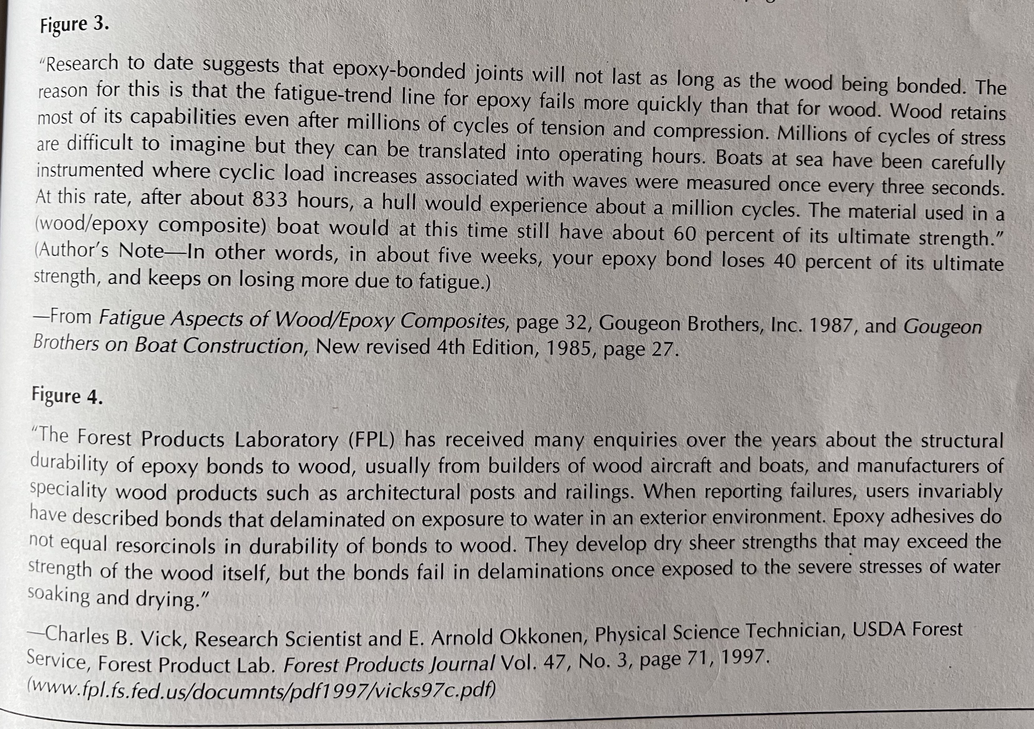

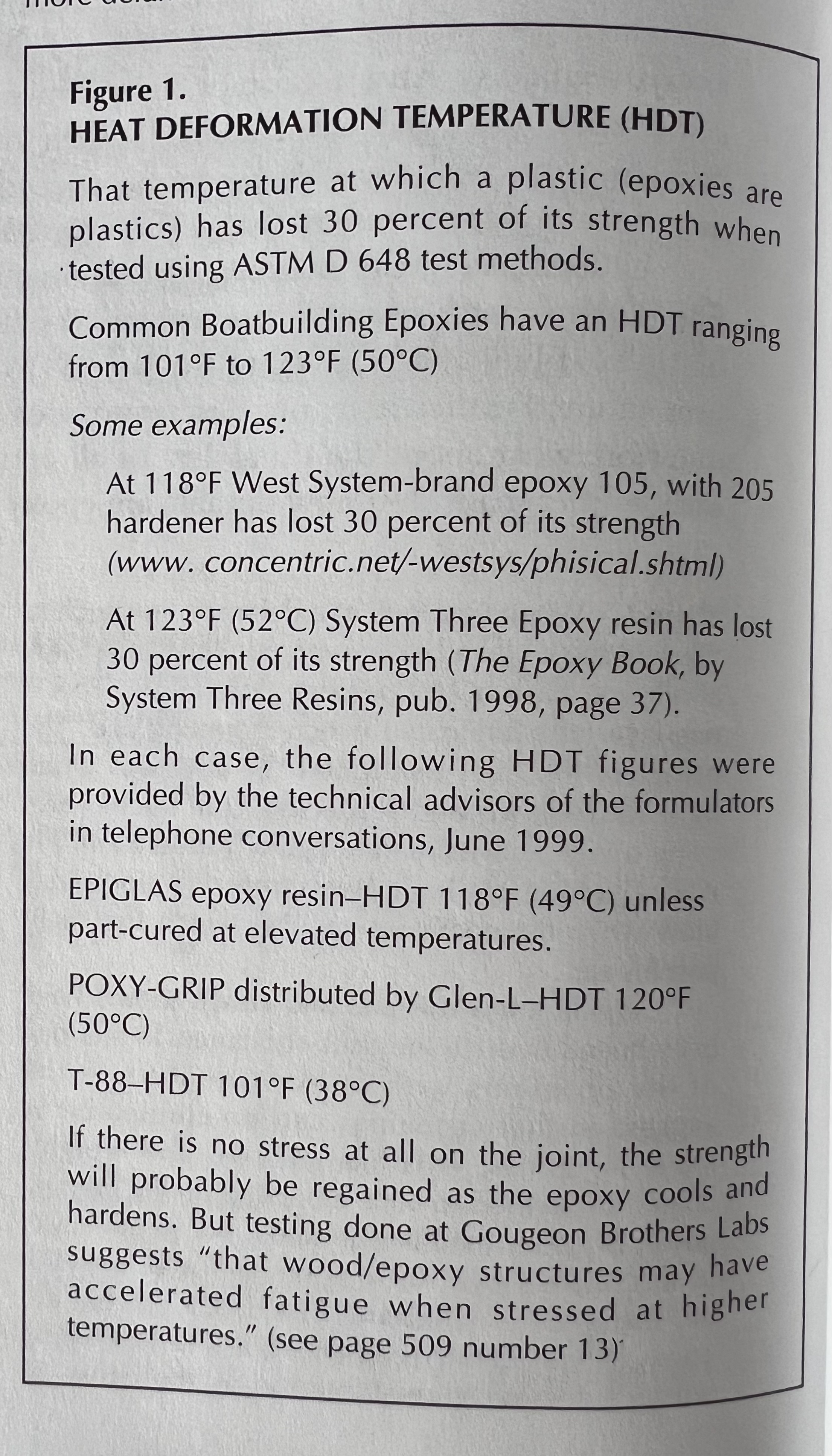

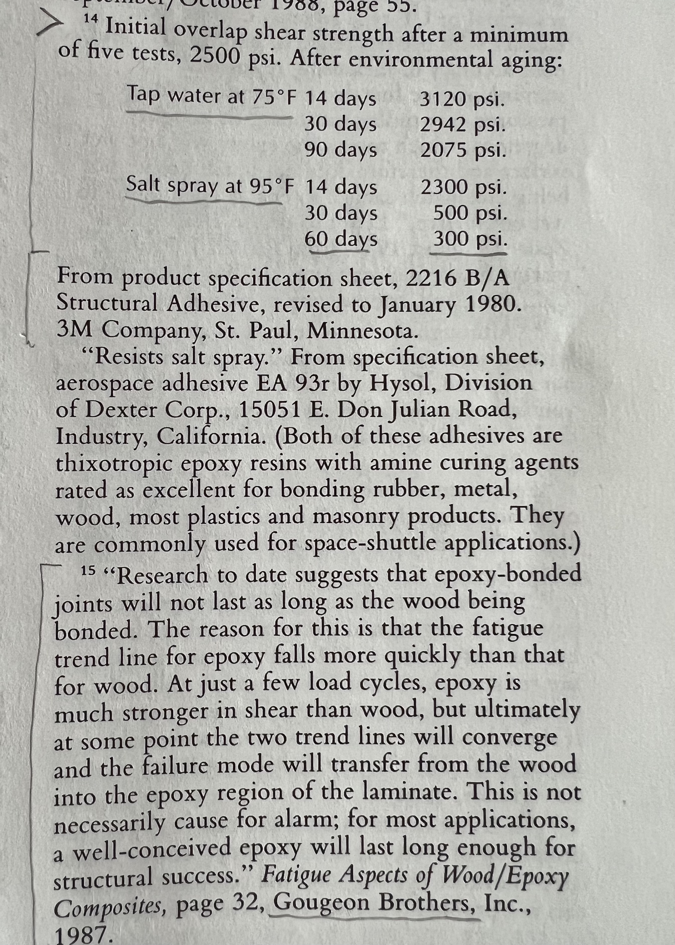

I have seen these failures on my own boat. All epoxy laminated winch pads original to my boat failed. I rebuilt the dorade boxes with epoxy and they failed. I think due to UV and tropical heat. IDK. I rebuilt the winch pads and dorades with Resorcinal. The dorade were left bare. The glue joints are still perfect. That's not to say all epoxy wood joints fail. Certainly not. Epoxy is vulnerable to UV damage. No doubt about that. It has to be protected. I have seen other epoxy glue joints fail on other boats. So it's not the super adhesive that people make it out to be. It's a tool, but it has limitations.
People are going to do what they want to do. I used epoxy for my new steam bent laminated tiller. I did it because I didn't have the tight fitting joints I had in my original tiller. And I could not source weldwood glue. The tiller is varnished. It will be interesting to see how it holds up. But I bet I have seen a hundred delaminated tillers built with epoxy over the years. Epoxy is used in all kinds of construction--especially composites. My sense is they use it differently than boat builders and amateur sailors like us. They are not using it to laminate teak. They are allowing for its loss in strength during cyclic loading....I don't think most of us do that.
Poor joinery is poor joinery. Tight joints require skill. I have gotten better at it over time and mostly I am pleased. But, it's not even an issue with epoxy...so people use it. In fact epoxy works better with loose joints and less clamping pressure. But it's not going to last as long as tight joinery built with Resorcinal.
All that said, I have included some excerpts below from test results and analysis provided by Gougeon Bros (West Systems--my epoxy of choice), the US Forest Service, 3M Company, etc. The test results indicate Resorcinal based glues are a better adhesive for wood than epoxy. Better meaning stronger and longer lasting, not better meaning more convenient or easier to use. Take a look at the shear strength test when the laminations were subject to salt spray. I'd like to read that whole report so I understand the context.
