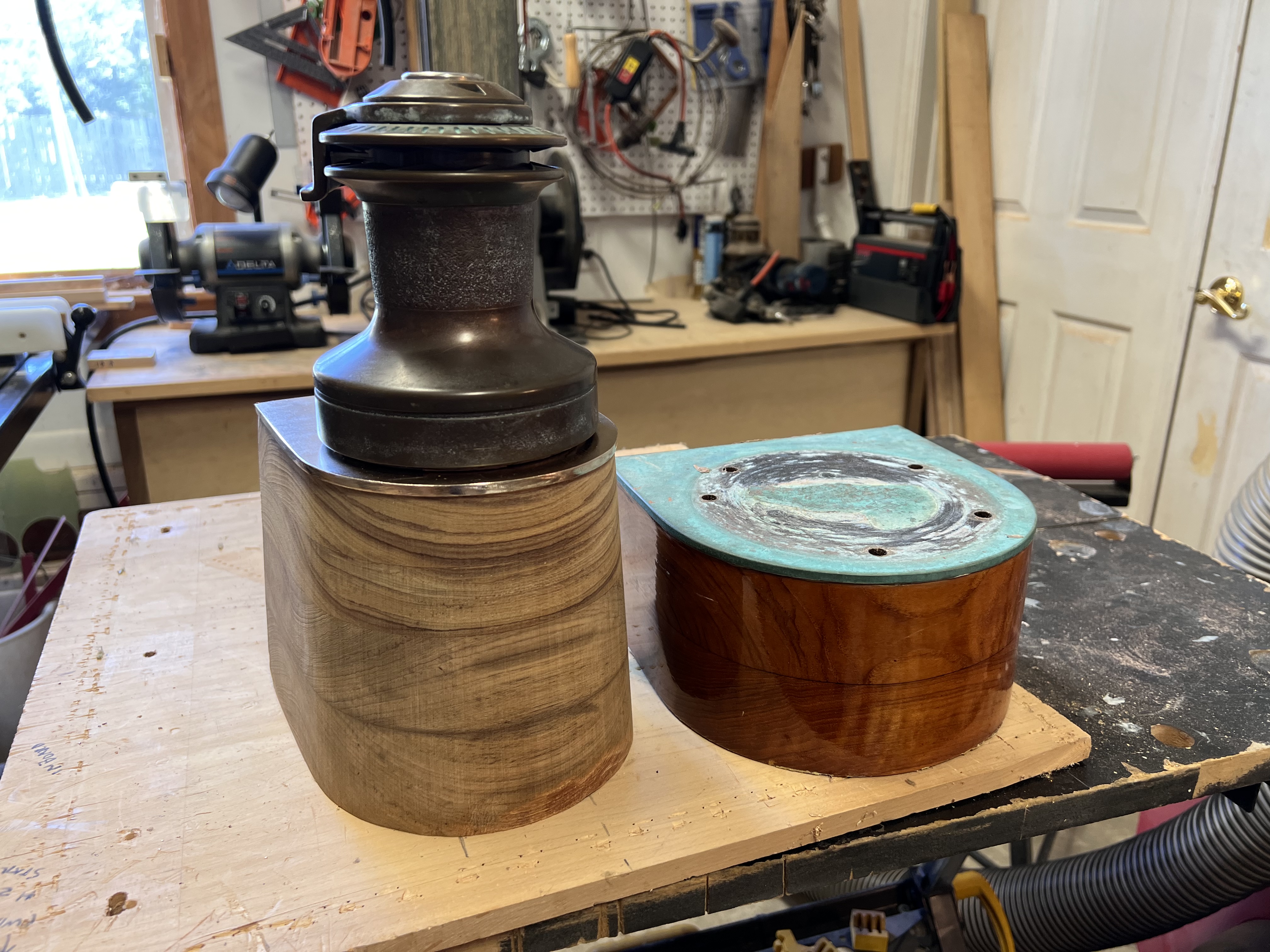

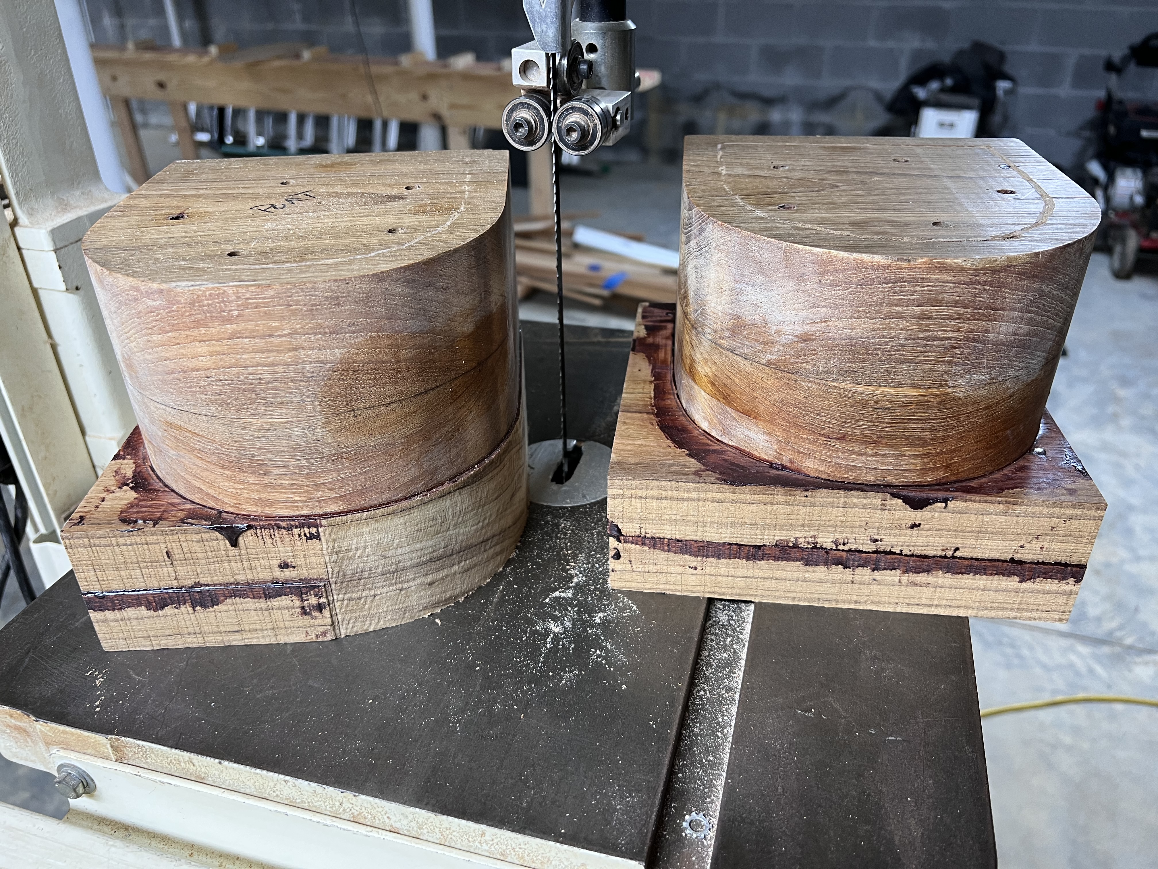

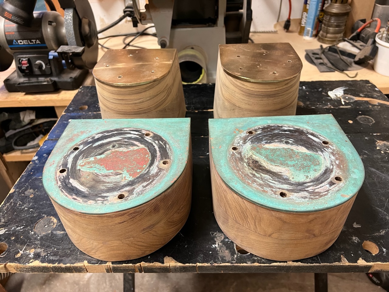

I milled the secondary (stays'l) winch pads down about 1/4" to remove the radiused top. Then laminated two 5/4 teak boards together with resorcinol. Then, when the glue cured I cut it in half and glued a section to each original pad making the new pad about 5.75" tall. I cut the excess off on a band saw. They looked a little bulky to my eye because they were so tall (they are mounted on the forward part of the coaming which is taller than where the primaries are located) and cylindrical. Anyway, I decided to taper the pads about 4° to give them a refined more elegant profile.

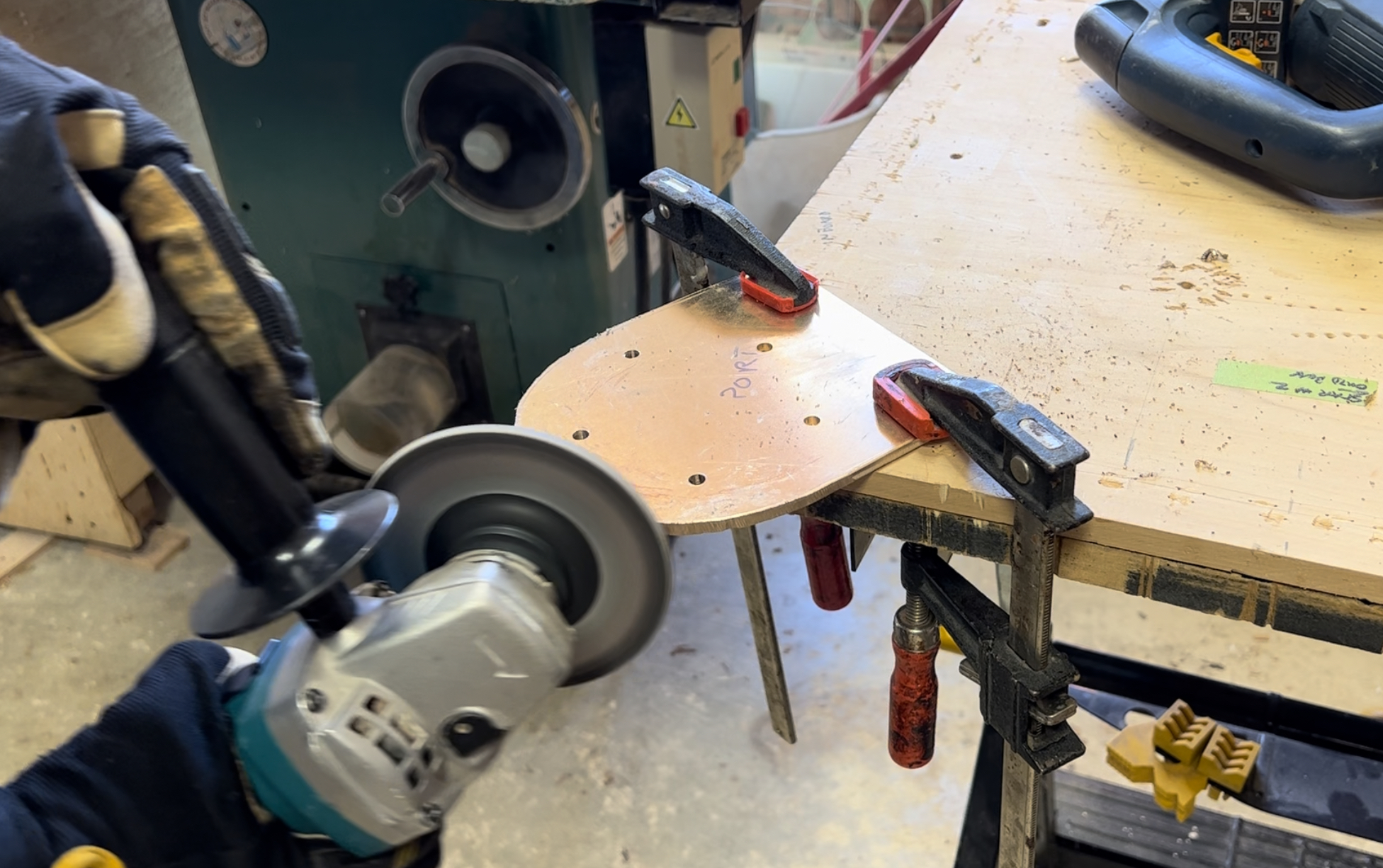

Today, I clamped and drilled the holes in the bronze plates for the winch using the old holes in the pads as a guide. Scribed the profile on the plates with a scratch awl then I cut the plates to fit the winch pad top with a jig saw (bronze is so much easier to work than SS). I used a high speed 4.5" Mikita grinder to smooth the edges. Then I removed the machine marks with a couple mill files. I want the bronze plate to be proud of the edge 1/16" so I have a clear cut line for varnishing.

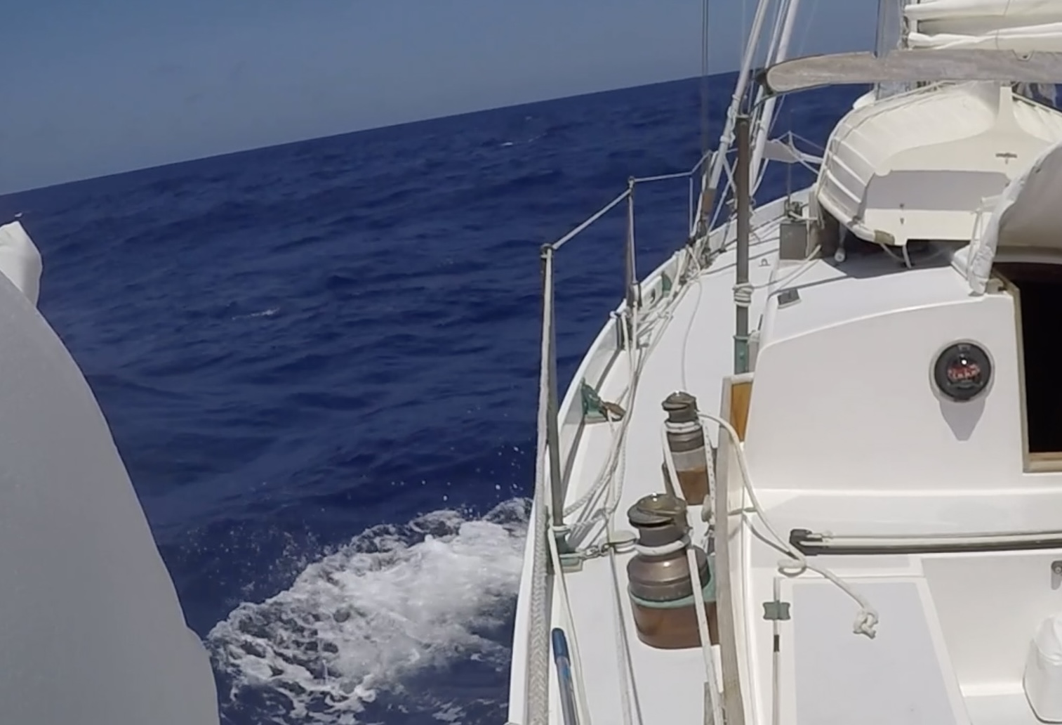

Here is a picture of the original set up. Essentially I'm replacing the bare round teak pad with the glued on riser pad. Everything else stays the same.

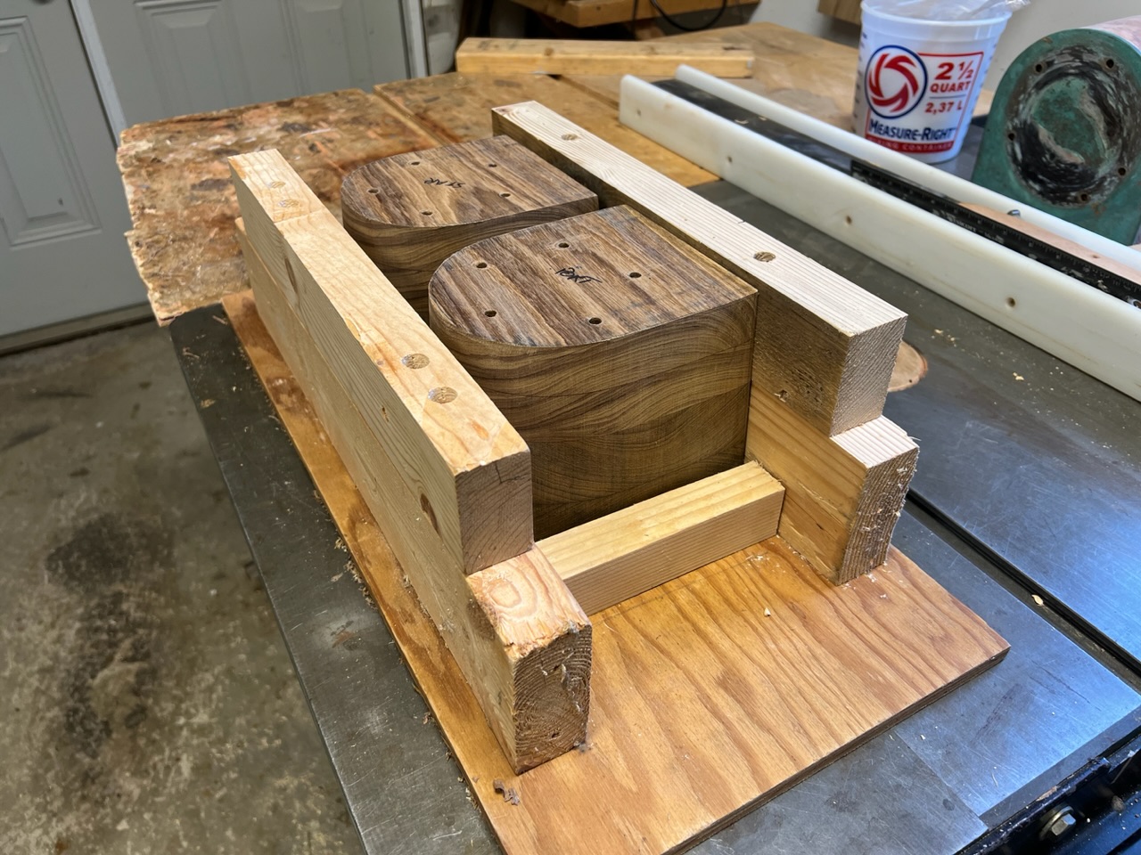

As the coaming rebuild continues I went back to work on the secondary winch pads. I felt the top of the pad was a little closer than desired to the bare teak cap rail, fastened to the top of the coaming. I wanted to take 1/4 inch off the top of the pads. But, how to do it? The pads are angled on all sides. I decided to build a simple jig from scrap wood to hold the pads tightly in place (isn't that why we never throw bits and pieces out of our shops to the exasperation of our wives.
I bracketed the pads with blocks screwed to a plywood platform. Then screwed the pads to the plywood platform from underneath so they would remain secure and dead flat during the planing. I made the 2x4 side rails a little taller than the pads so the planer would start cutting them down first. Once they were even with the top of the pads the king side rails prevented snipe I would other wise have gotten when the cutting head rolled off the top of the teak pad.
After planing I sanded the winch pads. Probably lay on the first coat of varnish tomorrow.

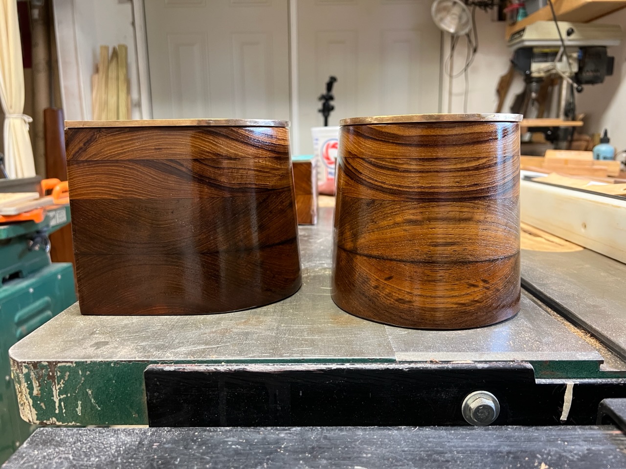

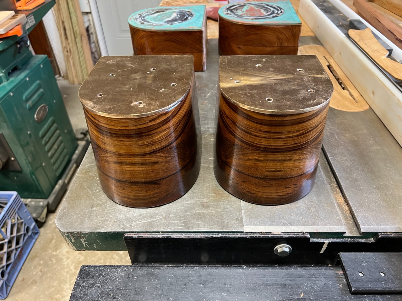

The secondary winch pad project is essentially complete.
I applied four coats of varnish. I'll install the coamings, then the winch pads, then complete the varnishing. Probably a total of 8 coats. Then as before we varnish about three times a year, two coats each time, if we are actively sailing.
Over time with exposure to UV I think the teak will darken a bit and look a little more homogeneous....
The silicon bronze plates will go green and match plates on the primaries.
