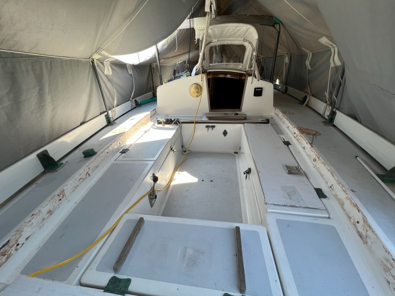

After we returned from the Virgin Islands we hauled the boat out in August. I wanted to wait for the temperature to cool before starting boat work. In order to rebed them however I had to remove them first.

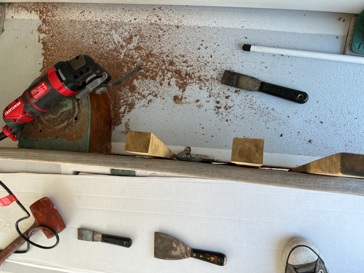

The first step was was to remove all the fasteners from the coamings. Not difficult because I can remove the overhead panels above the quarter berth to access the most hard to reach fasteners. I used a fostner bit to drill the wood plugs out. Gayle and I worked together to remove the 1/4-20 machine screws. Next, I used an oscillating tool to cut the bedding compound between the coaming and the fiberglass. I could not get to the bedding in the areas around the winch blocks. With as much of the bedding compound cut as I could manage I began to drive wooden wedges between the coaming and the vertical fiberglass face the coamings are bolted to. I knew there was a high probability the wood could be damaged removing the coamings which in fact occurred. The damage is not terrible but is extensive in a few places. 3M 4000 is not near as tenacious as 5200 but it is still a very powerful adhesive. I'll know more when I strip the varnish from the coamings at home. If I have to rebuild them it is not a very difficult project. I'll know more later in the week. Today, I cleaned off some of the bedding compound from the fiberglass.
Lesson learned: I will not use a polyurethane adhesive when I rebed them. I will probably use a single strip of butyl rubber. I might use polysulfide though for the winch blocks as it released with out a big struggle. The other option is Dolfinite, which I use for wood I want to be able to disassemble such as dorade box tops, kranze iron, bowsprit anchor rollers, etc.
Next step is finish cleaning the fiberglass of residual bedding compound and then strip the coamings back to bare wood.
- 5F76764D-6531-4E91-91F7-664AE0DA3CF1.jpeg (440.05 KiB) Viewed 7428 times
- AB04C6C4-9544-4DE3-835E-0D52A6DE74E2.jpeg (485.41 KiB) Viewed 7428 times
- 360347BD-AD1E-45F0-8D12-7B0D0435F8B8.jpeg (287.58 KiB) Viewed 7428 times

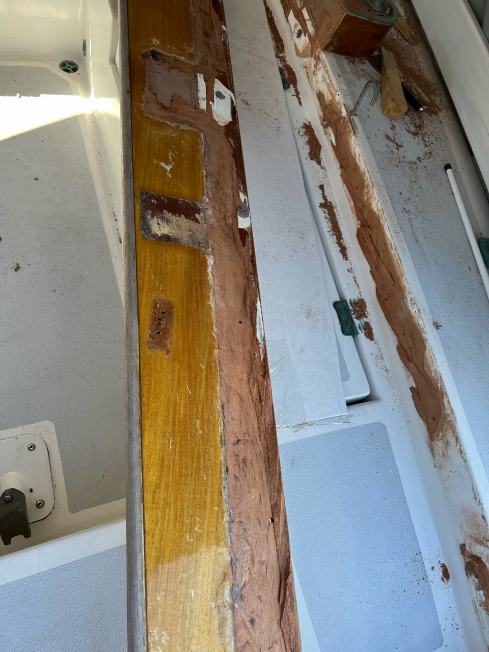

Some sections of wood peeled from the plank held to the fiberglass by the 3M 4000. I'll post some more pics when I have cleaned it up. I'm not really concerned if I decide to make new ones--not difficult or particularly expensive. Two 10' long by 10" wide by 1" think unmilled A. Mahogany is about $150.wikakaru wrote:I was expecting from your description to see the coamings split into multiple pieces. In the photo they look good. Is the damage on the other side?
Good luck with the project!
Smooth sailing,
Jim
But once I strip the varnish and bedding compound I will be able to examine them much more closely. If I can fair in the damaged areas with thickened epoxy or even grave in some pieces and since it will be unseen faced against the fiberglass I may do that.

Whoa, that side is way worse than the first photos you posted. If you are lucky all the damage will be hidden and can be filled and forgotten, though I can also see why you might want to replace them.John Stone wrote:Some sections of wood peeled from the plank held to the fiberglass by the 3M 4000. I'll post some more pics when I have cleaned it up. I'm not really concerned if I decide to make new ones--not difficult or particularly expensive. Two 10' long by 10" wide by 1" think unmilled A. Mahogany is about $150.
MTF.

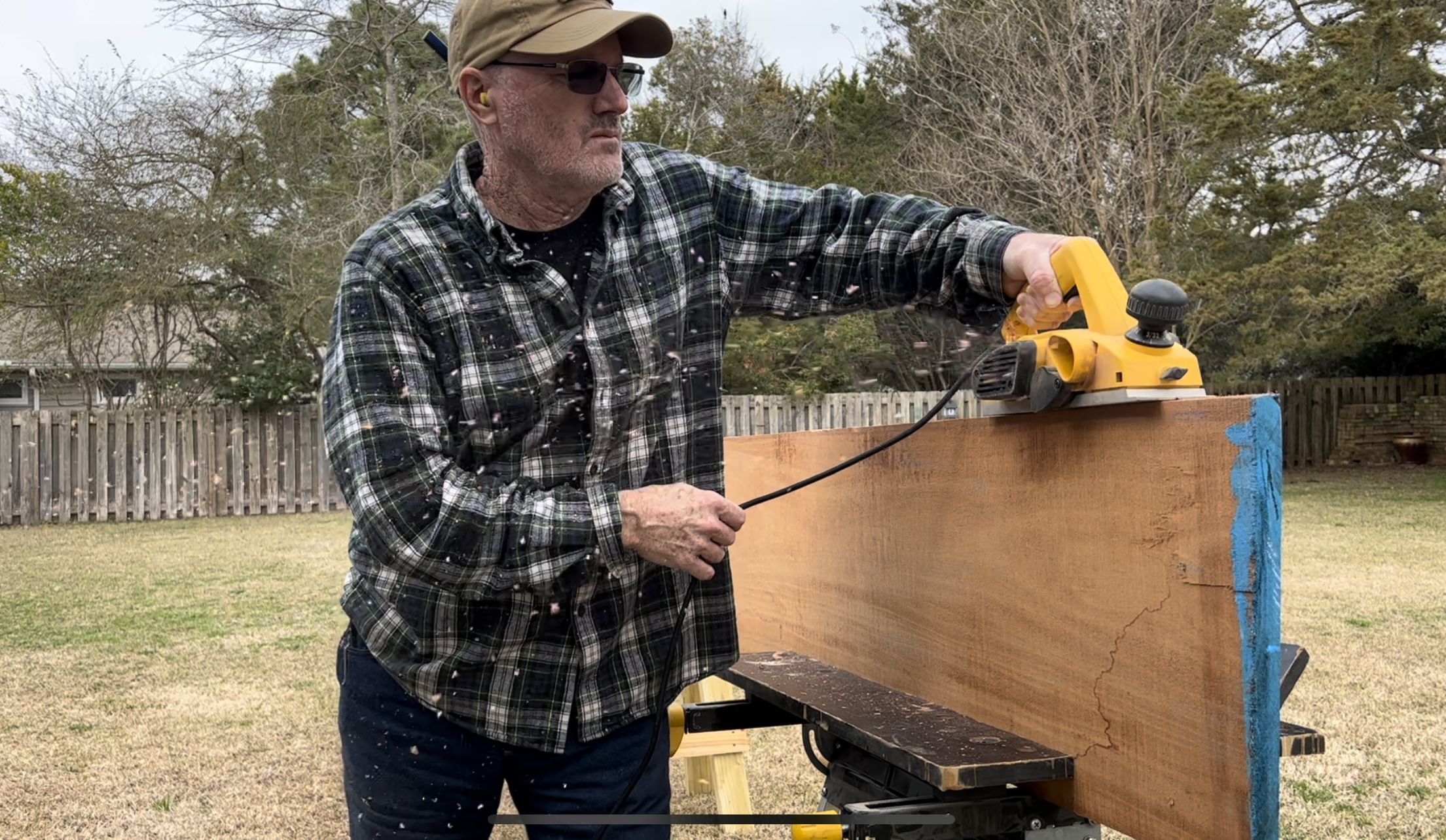

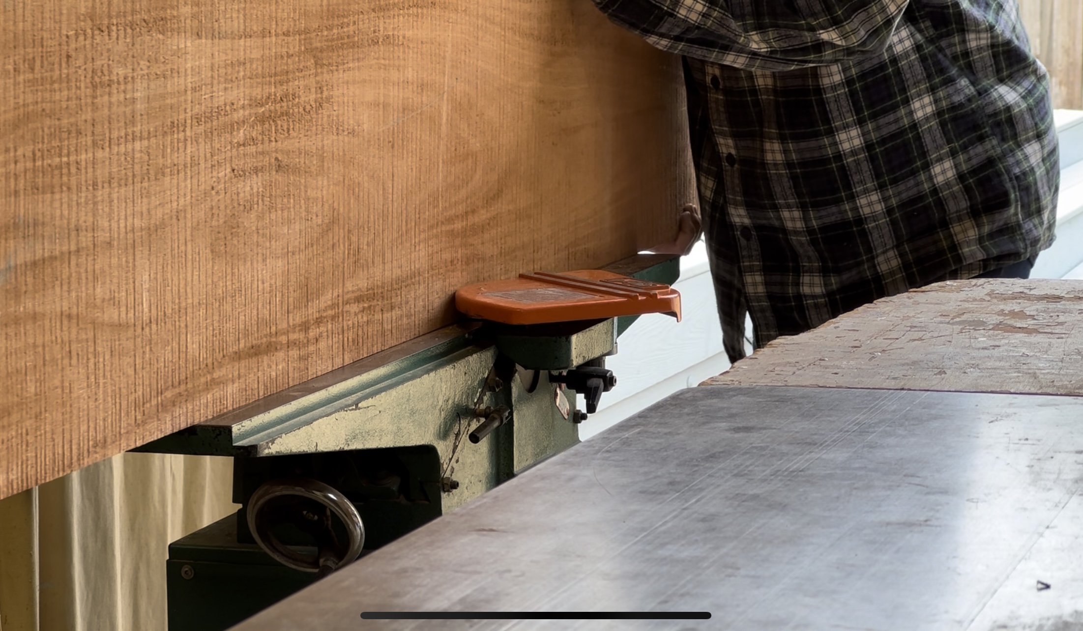

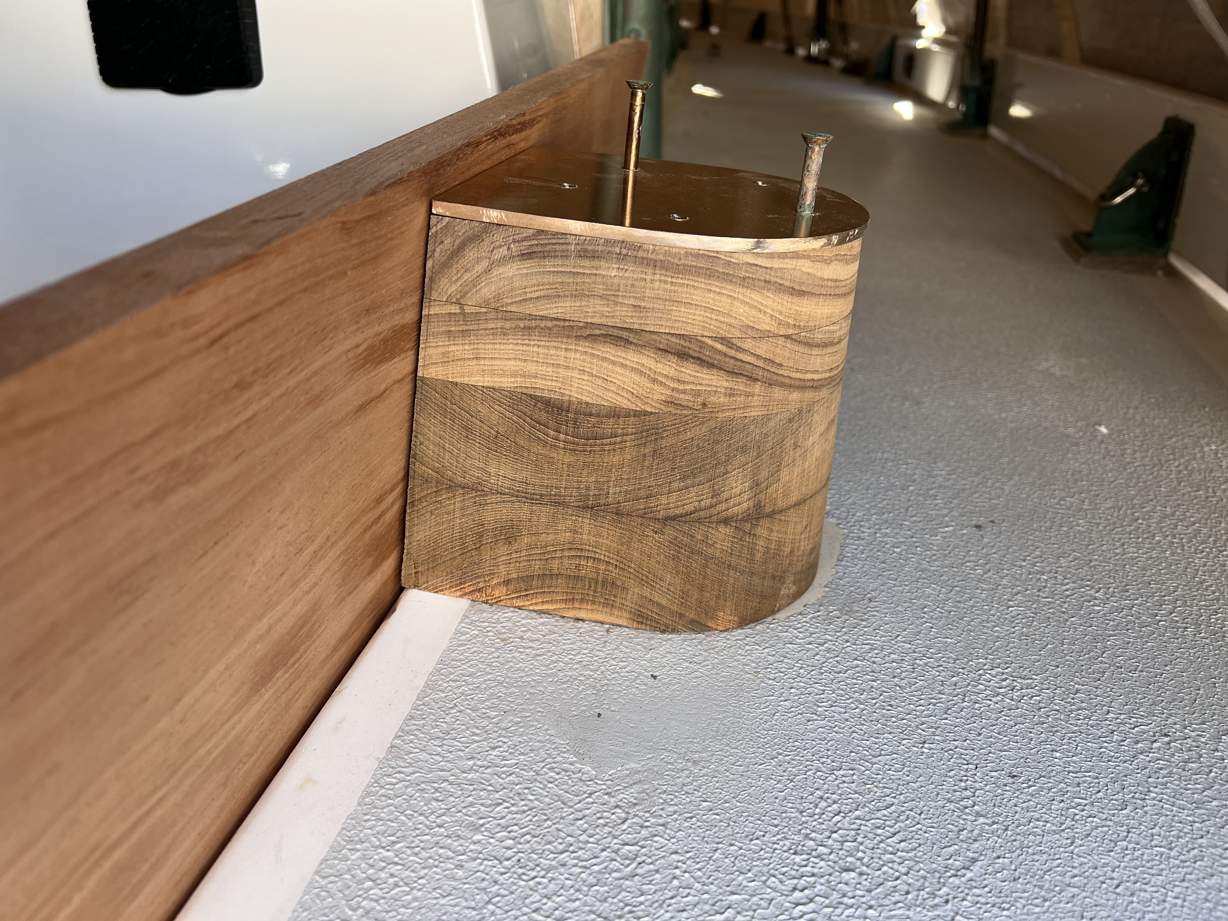

After a dark and wet winter we have had some warm sunny weather. I was a slug this winter. I somehow got double pneumonia and didn't even know it till Jan. I was so tired. I did not want to do anything. But that's all behind me. Anyway, now all I can think about is sailing.
I bought some African Mahogany and jointed one edge, ripped the other side so it would fit through my planer, then took it down to 7/8" thick. I removed the teak caps on the old coamings.
Will use the old coaming to draw the layout for the new ones. Plan to make them an inch taller on the aft end.
I'm also making the teak stays'l winch blocks taller and will cap them with a bronze plate same as the primary winches.
I'm so happy to be back at it.
We have a long planned overland trip in our Jeep planned for March. I was looking forward to it all winter. But now I hear the sirens calling from over the horizon....

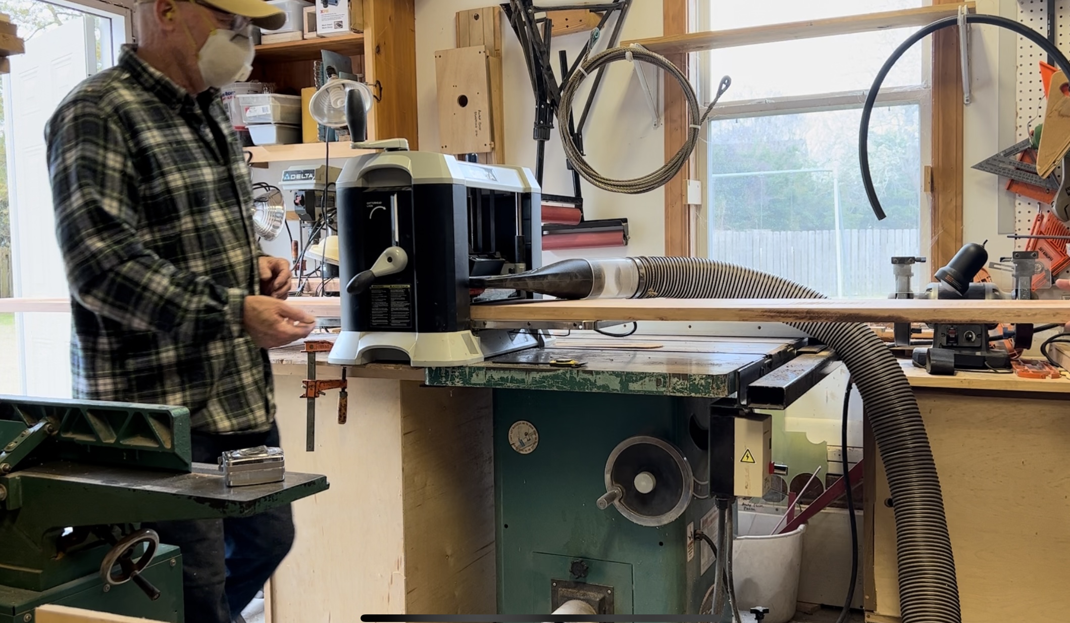

- Getting one edge reasonably flat.
- 4BF5653E-93EA-449B-94D6-09872846577C.jpeg (1.05 MiB) Viewed 7232 times
- Running the edge over the jointer.
- BB8AE58D-4039-4DBC-92C1-326DA272CC79.jpeg (673.17 KiB) Viewed 7232 times
- Running the planks through the thickness planer.
- 33B3F6EC-2999-4AD3-B66E-D4F900A6AF44.jpeg (679.65 KiB) Viewed 7232 times

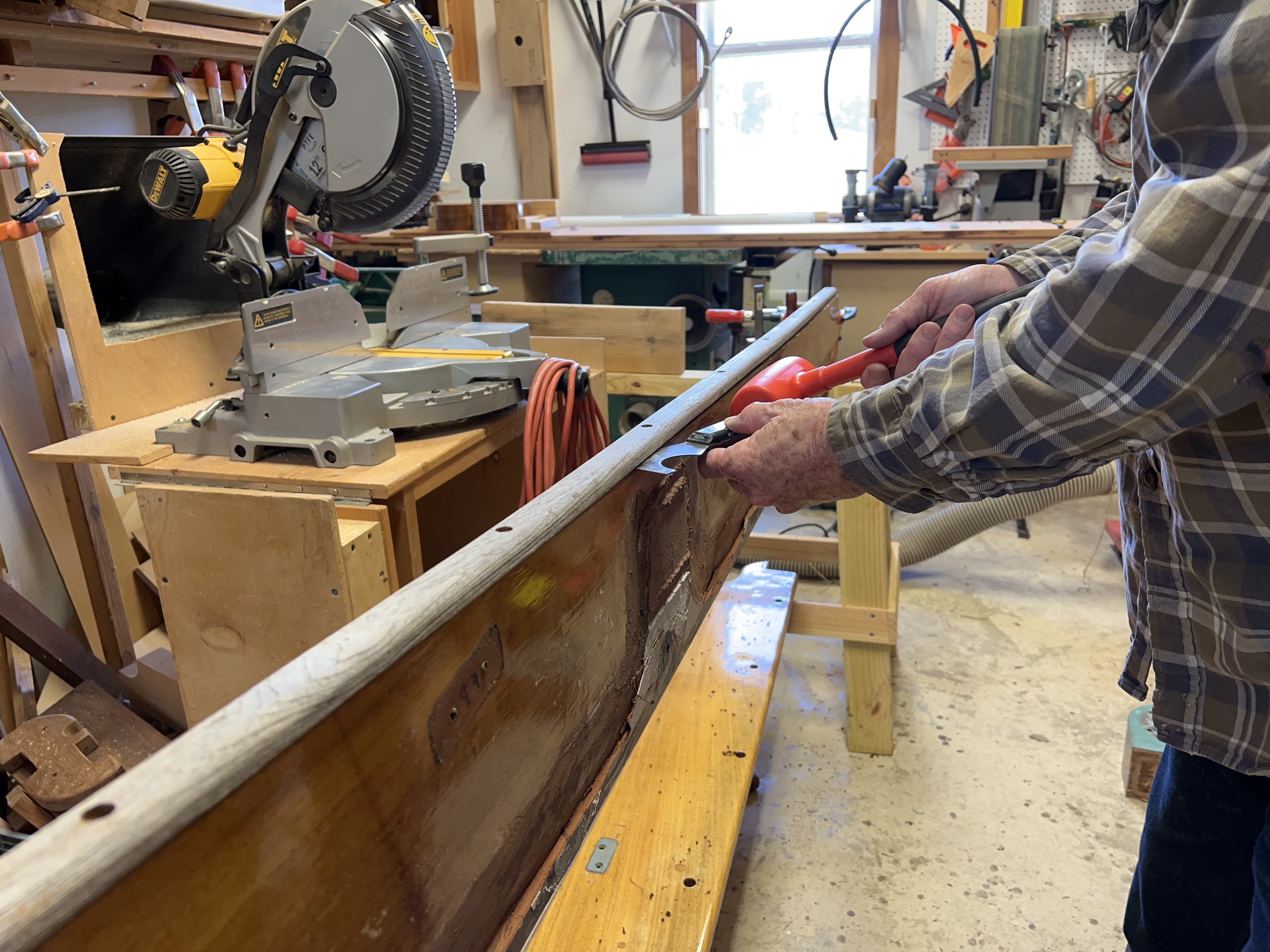

Re: Cockpit Coaming Rebuild
Another photo.
- Removing the teak cap rail.
- 1D4ACA6B-52EE-4EEA-834E-0F041894CBF9.jpeg (2.71 MiB) Viewed 7232 times

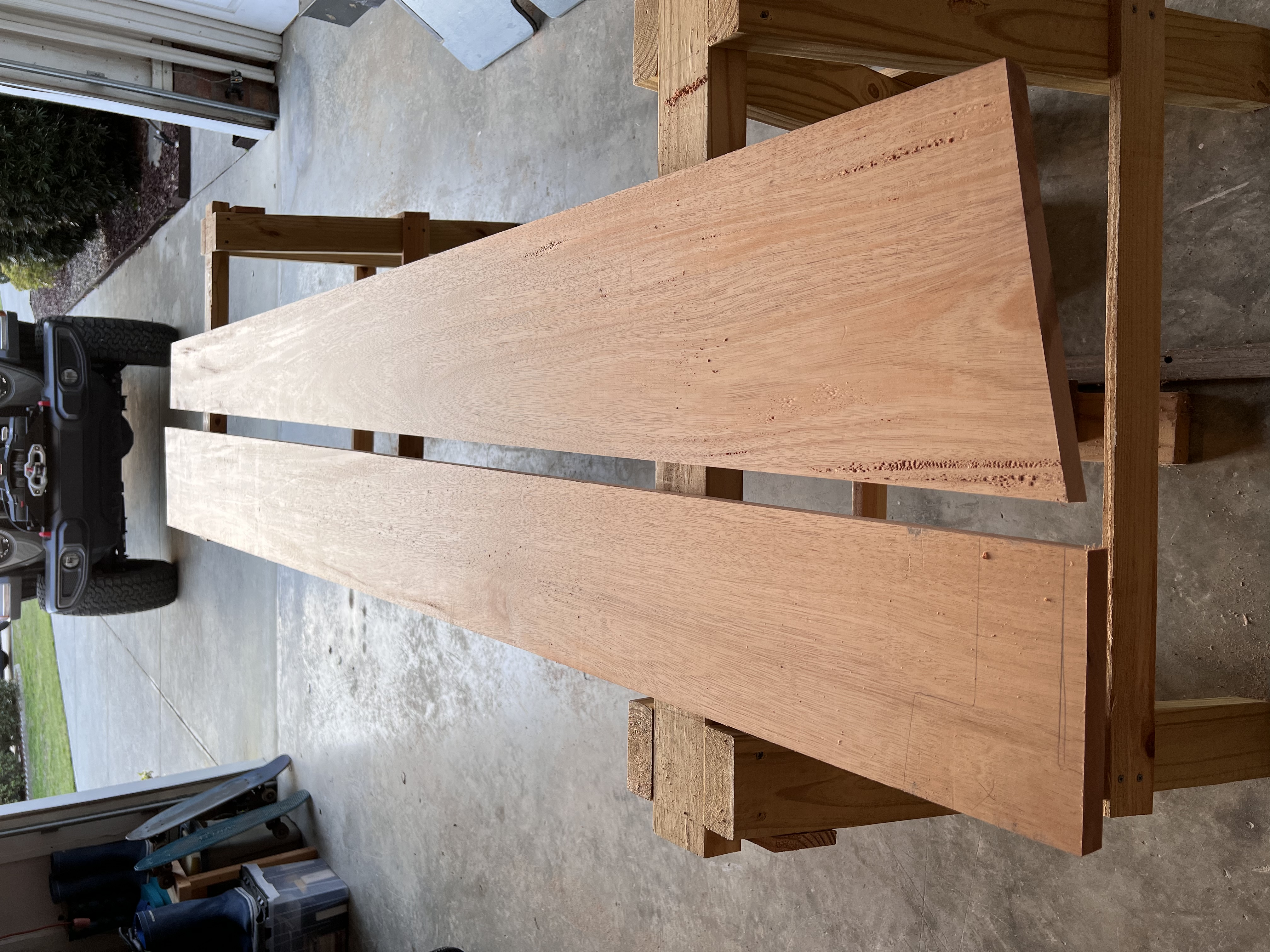

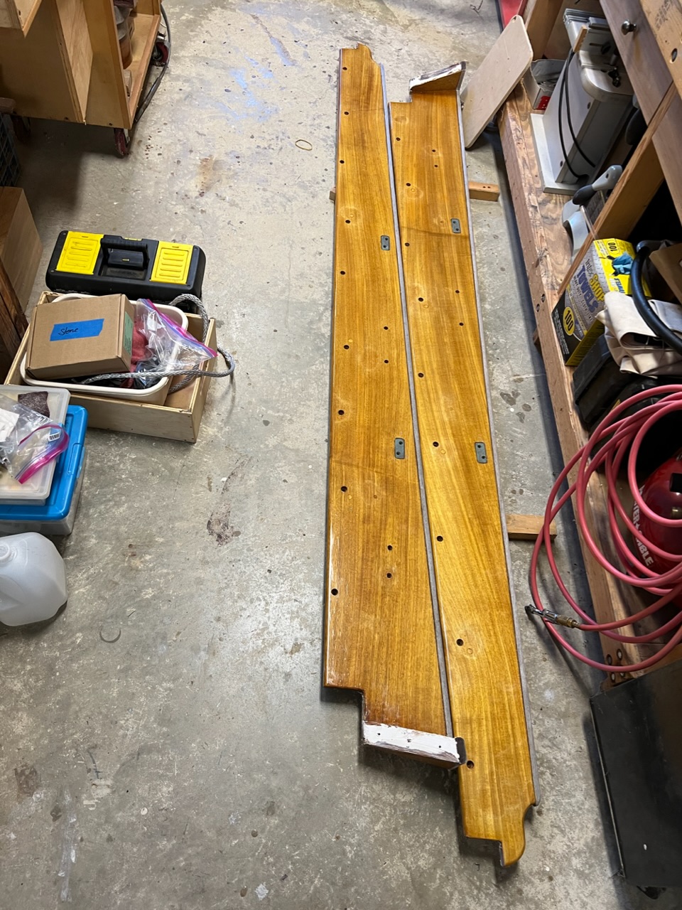

Using the old coamings as patterns I traced them out on the newly milled planks. I drew the lines to raise the aft end of the coamings an inch. Then, with a long guide bar clamped in place I cut the tapered top line with a circle saw. A let both end run a wild for now.
- AF1729AB-9377-4C4B-9DA8-E3B5274631D0.jpeg (3.61 MiB) Viewed 7185 times

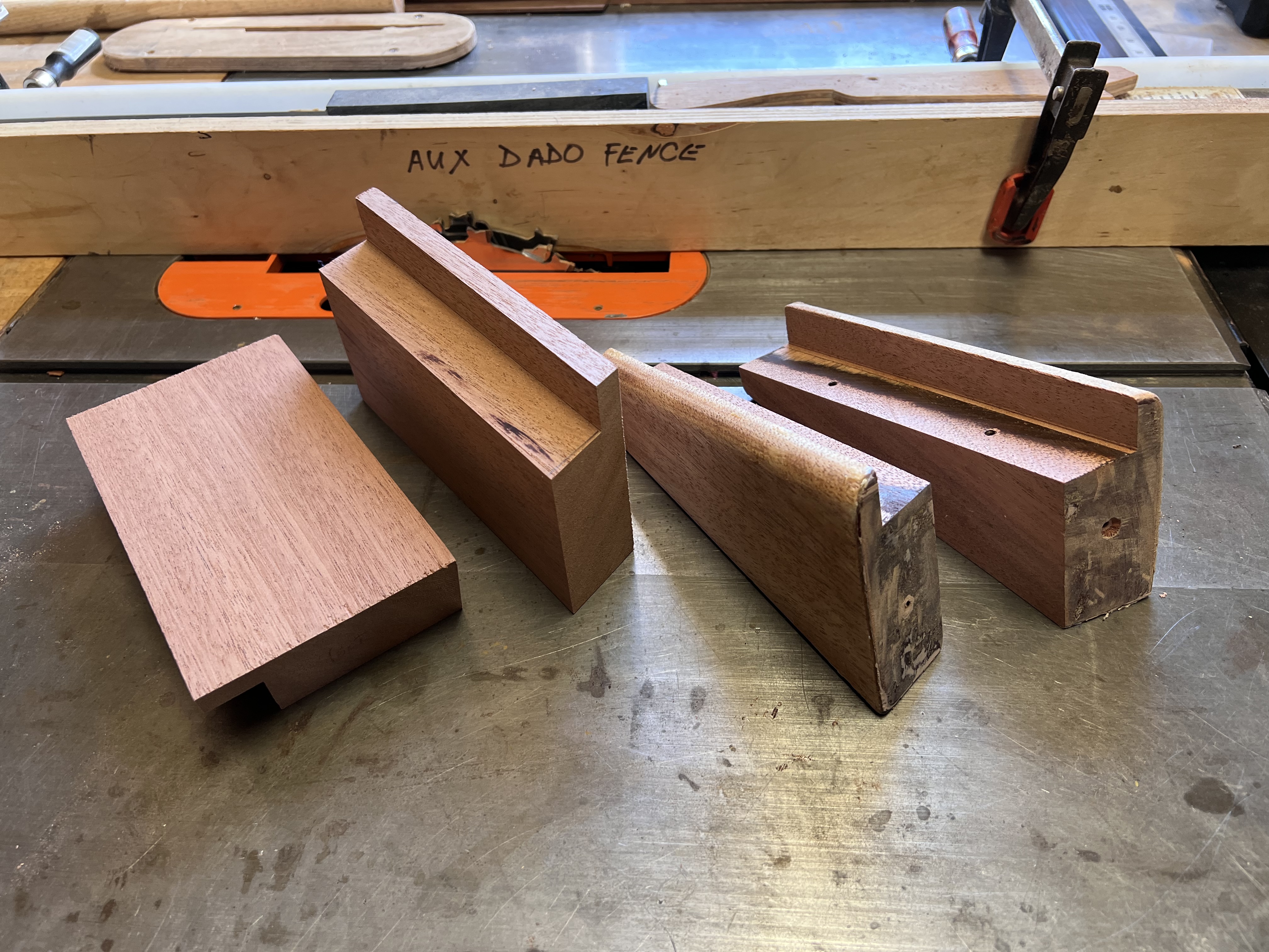

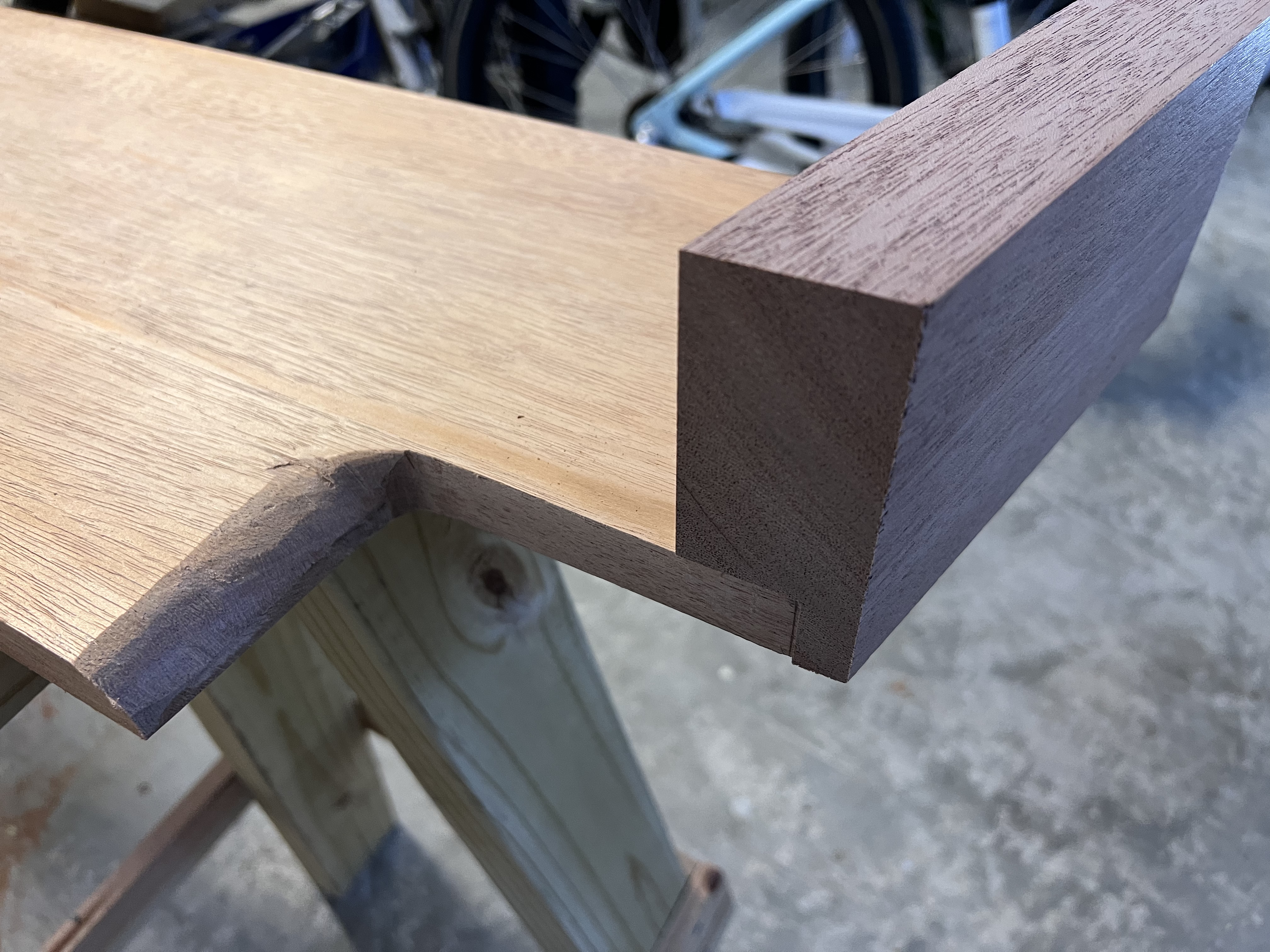

Yesterday, I worked on the return blocks. I milled some 8/4 mahogany left over from the 2009-2015 rebuild. I planed a small section to 1.75" and ripped them a little wider than I thought necessary. Then, cut the dados. Next, I cut the 15° bevels to match the angles on the forward edge of the coamings.
I also cut off the old return blocks and dado'ed them to fit the coamings so I can use them as a mock-up.
Cutting the final inside bevel is tricky and potentially dangerous depending how I do it. Originally, I cut the outside edge last having left it wild so it was safer. Then cut the dado. I have a friend with a tapering jig and it might could work. I can also bandsaw them and clean the surface up with a bench-top sander. I won't cut them on a chop saw--too dangerous.
MTF
MTF
- Test fit. Pretty good joint. No gaps. Perfect for resorcinol.
- 55BCB32C-FF93-442F-B940-BD2CBAE431BF.jpeg (3.62 MiB) Viewed 7150 times
- 338D2F3A-F08C-4D13-AAE5-84ADF3D4E820.jpeg (3.93 MiB) Viewed 7150 times
