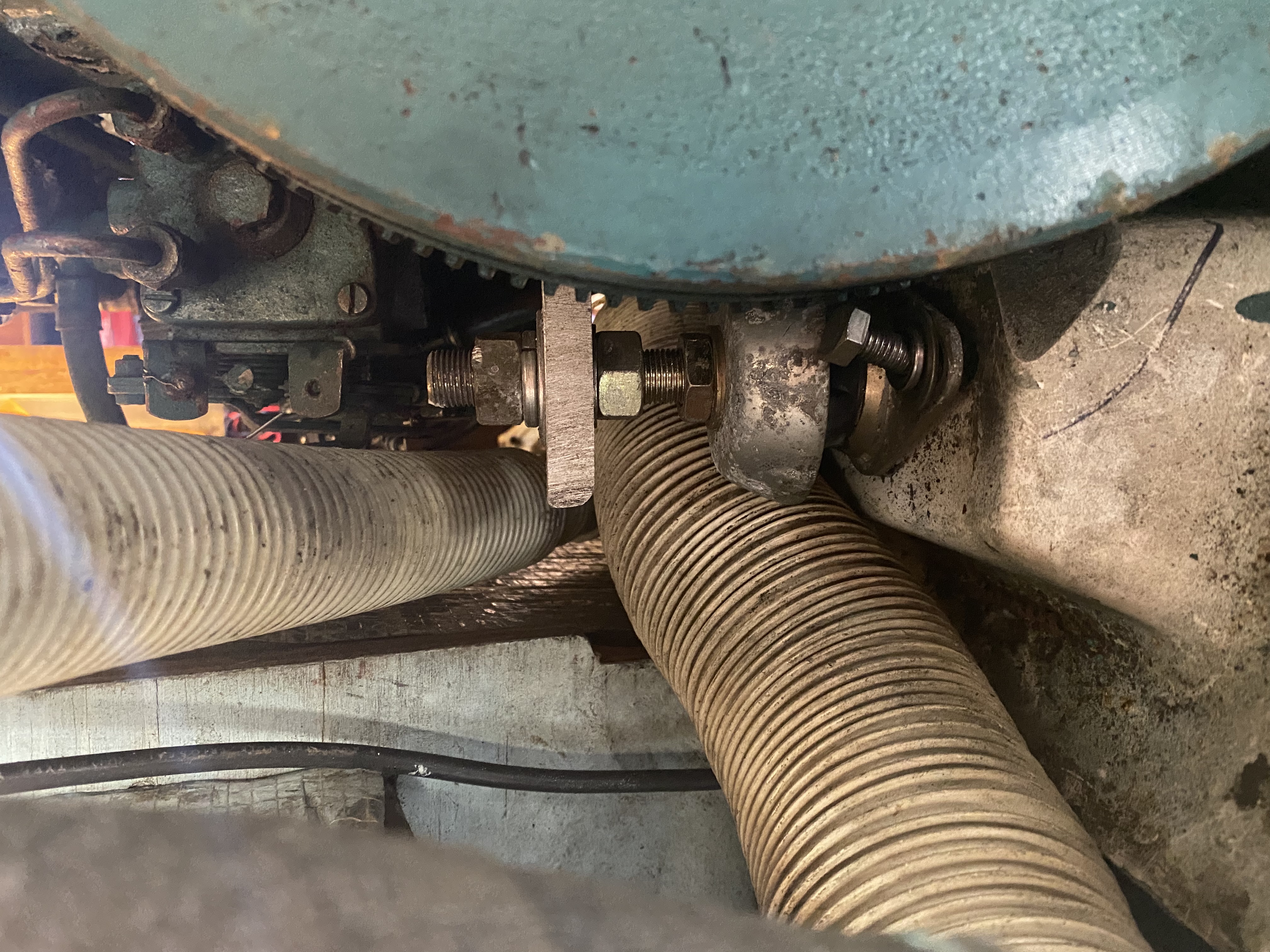

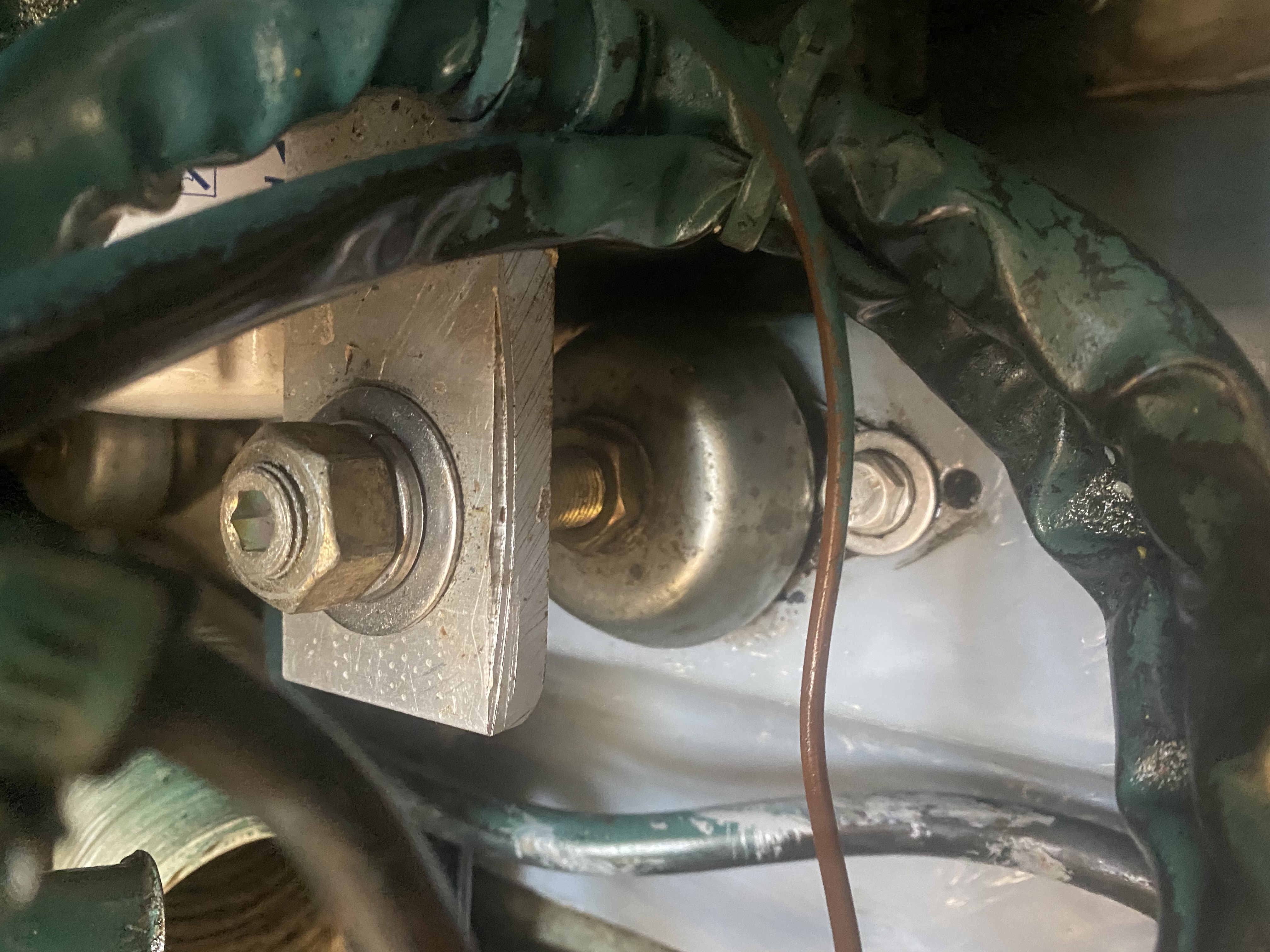

Big problems with new motor mounts and shaft alignment but I made it back. It was a very comfortable and pleasant cruise. I dont know why everyone says its such a mad beat upwind. I’m dissapointed I didnt sail more. I was too worried about mechanics I just needed to get back. I anchored and realigned the shaft and checked everything four times. Stayed anchored till weather was calm at Turtle Bay, Cedros Isle, Bahia San Quintin. San Diego sucks. Very inhospitable. I heard Mission Bay is good. Im at Dana Point now. So Nice. All in all it was a nice trip weather was perfect. I could spend the rest of my life cruising the Sea of Cortez. No need to go to Hawaii or Alaska. I was freezing here on the Pacific side. Hopefully I will come back next year. Now that I know what to expect maybe. I can bring someone with me

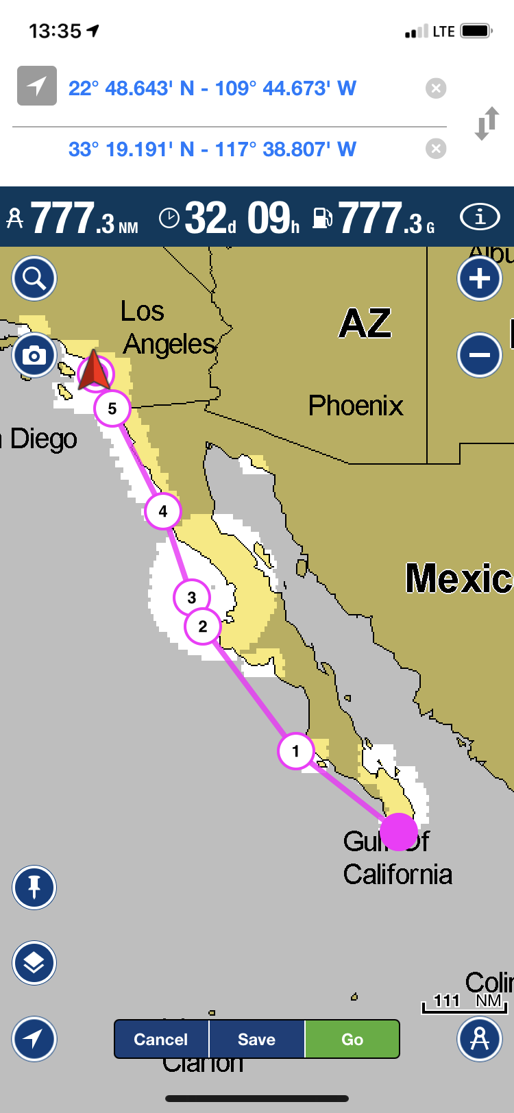

Here is the route

Everytime I stop the gears wont shift. I have to let it cool and change the oil. I dont know whats wrong. The gear is way hot. The oil is pitch black and very smelly. The motor mount I retapped at Dana Pt seems to be holding but It was only 30 mi. The alignment was way off again.
I hope the boatyard at Ventura will warranty this. I have a feeling I need a new reverse gear. I wonder if the v-drive would also be messed up since I’ve run it so much misaligned. I have set $ aside to repower but I dont want to discard this motor. There is a rebuilt gear w/v-drive on ebay. I may go with that. Im not sailing much. Its all been upwind and I dont feel good with things not functioning correctly. I just want to get home as direct as possible.

I'm going to the boat tomorrow. I've been busy on a job. Some things the yard guys pointed out to me (new Owners) Motor mounts on one side are adjusted all the way to the top and the other side is much lower because the bolt will hit the injector pump. The engine brackets aren't designed right. There is no way to adjust sideways, the motor mounts are tapped into the stringers which I found to be very spongy, It didn't seem to have any steel in the stringer. I went to the boat last Sunday and it was on the hard. I didn't get to talk to anyone. I saw the cutlass bearing is wasted. I will speak to them tomorrow. I told them I am busy out of town for a few weeks so they don't have to hurry. They assured me that they will make it right and I don't have to pay any more. I'll believe that when I see it.

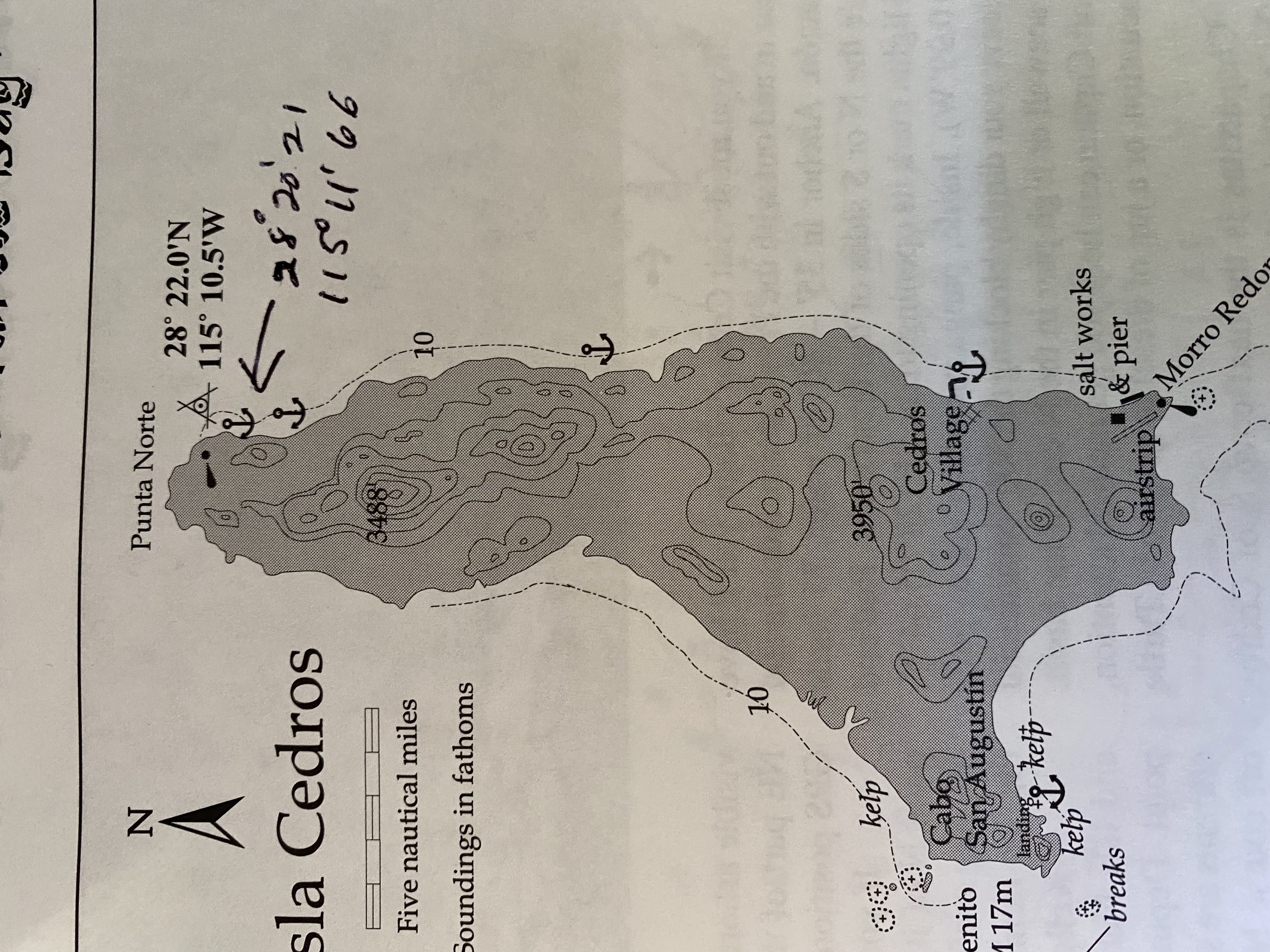

I got a new chartplotter before I left. It worked great but I didn’t know I needed to buy the $400 Mexican charts. It only gives the over all of the whole Baja Peninsula. Same with Navionics. Luckily I was able to get Navionics Mexican charts when I was close to wifi only $15. I also have Admirality charts, a set of three of the peninsula not details of anchorage and marinas. One very dark night I was going to anchor at Cedros North. I saw another boat and called him for advise. He said he was keeping watch all night cuz he was worried about the anchorage. I was headed strait for him then he started shining his spot lite at the cliffs. He was about 50 ft from the cliff in deep water. if he had not warned me I might have went strait into it. At home a neighbor, who sold out, gave me these guide books. The one by Rains give coordinates to the second where to anchor. Just as the guide said I found the Sandy mesa off
A small beach just about 100 yards south of where the other guy was. But that 10 fathom line is not accurate it was 100' right up to the cliff except where the mesa is. In the mornings I noticed the other boat anchored right next to some big rocks. I think he left in the night. I wish I would have told him to move down where I was.
