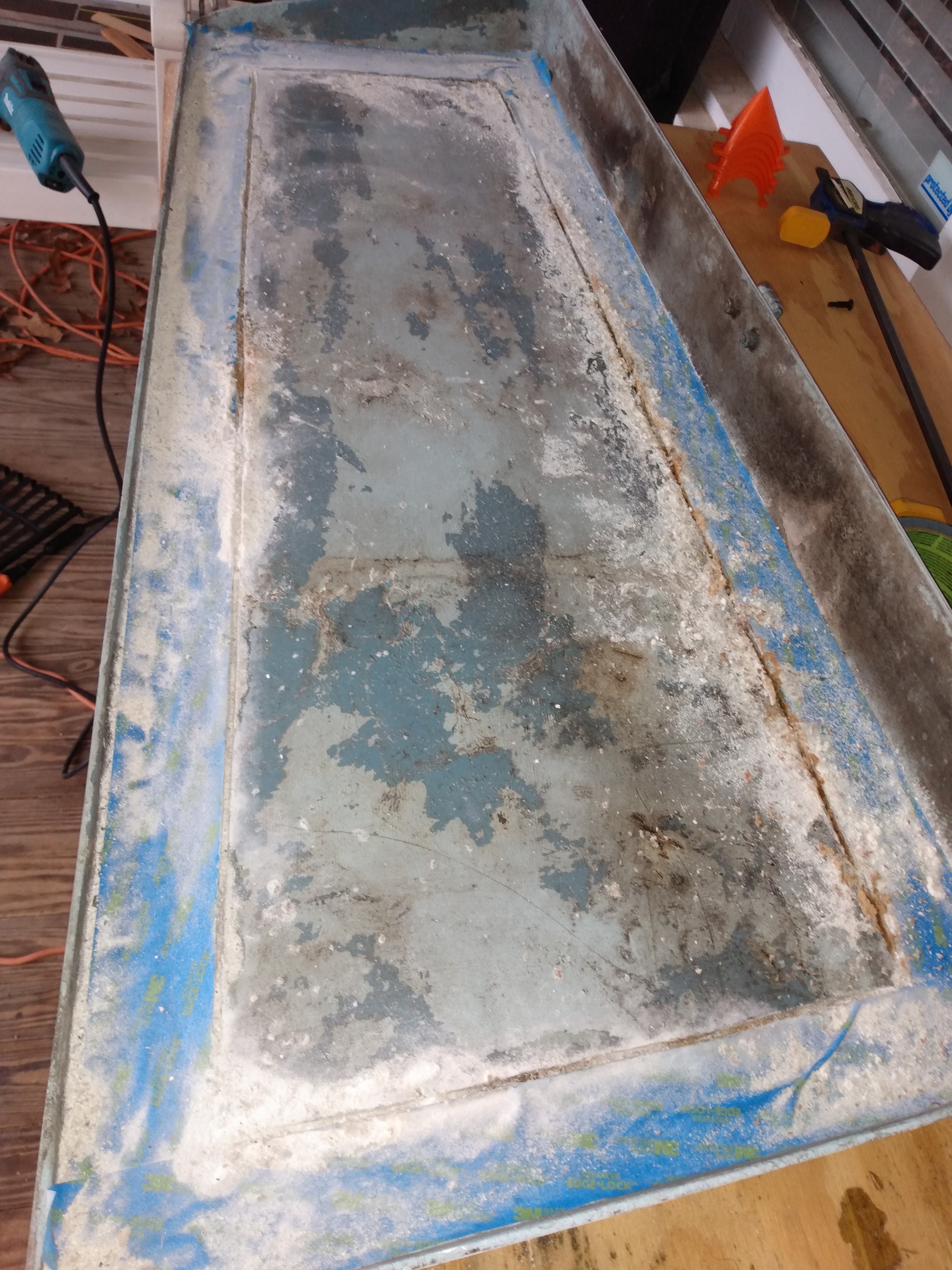

As mentioned in a previous post, I'm recoring one of the lazarette hatches as a way to learn some skills before tackling recoring the cockpit sole.
This should come as a shock to nobody, but get the old gummed up nuts and bolts off of the hinges is a real treat, especially if you don't have a second hand. With that fun behind me, I brought the thing home, taped off a 2 inch border, and attacked the fiberglass. I can not recommend an oscillating multi-tool with a carbide "grout removal" attachment highly enough. It took maybe 15 minutes to get the outline cut out, and the amount of dust generated was low(and didn't fly all over the work area).

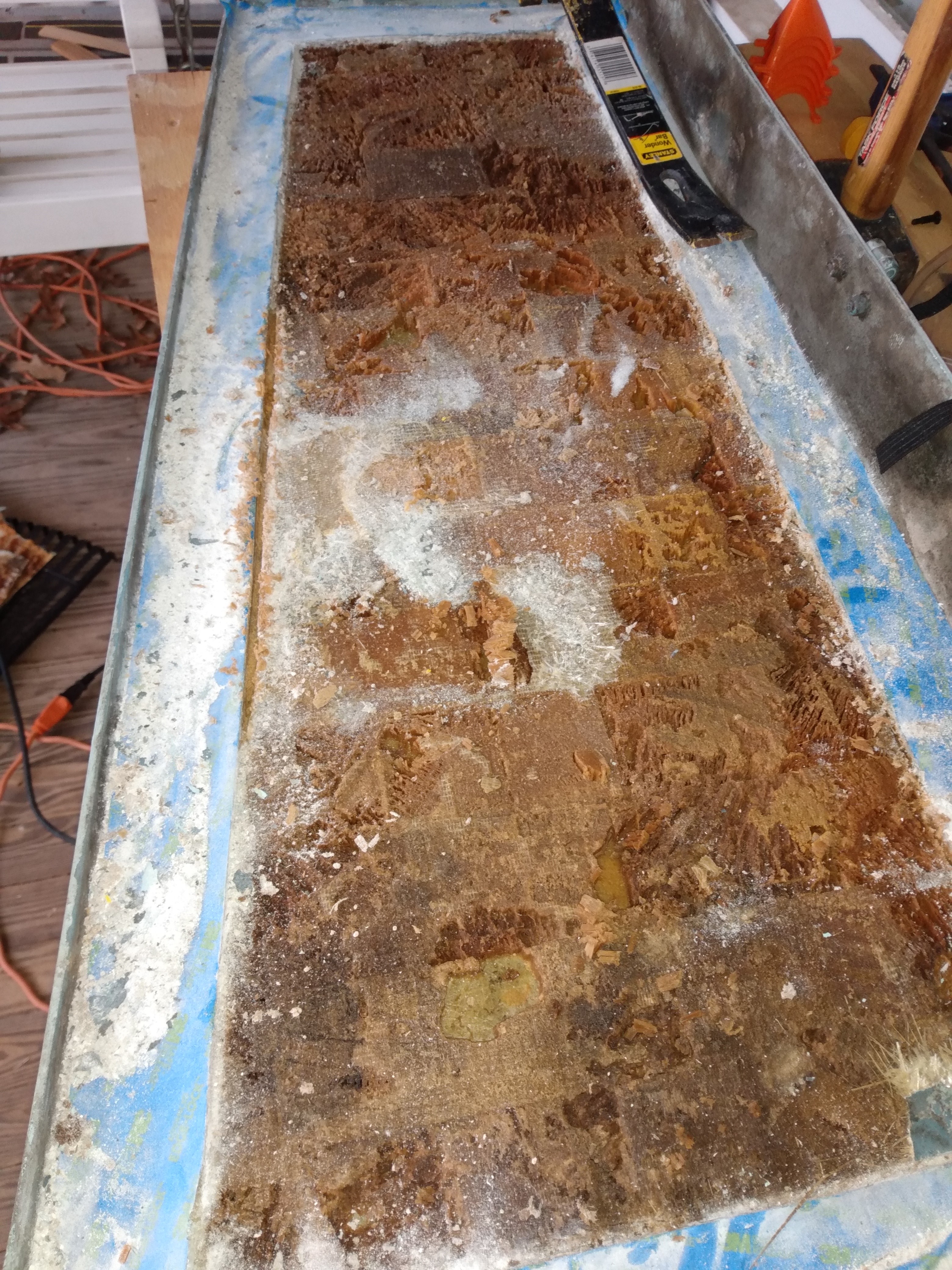

Even after seeing dozens of photos of wet core material, it was still amusing to pop this open and find and completely sodden mess. Another 15-20 minutes with the oscillating tool with a horizontal blade attachement, and I feel like I'm 90% of the way done removing the old core.
Question - For getting out material under the lip, what level of perfection are we aiming for? When is good enough good enough?

- Seriously, yuck
- wetcore2.jpg (5.11 MiB) Viewed 1826 times
- Yuck
- wetcore.jpg (3.17 MiB) Viewed 1826 times
- Outline of the fiberglass cut out
- original.jpg (2.61 MiB) Viewed 1826 times

When I did CC's cockpit sole I didn't get too fussy about getting out all the debris from under the lip. I used the oscillating tool offset saw blade on the outer and cut sides to separate most of the core material then a screwdriver. I followed up with a wheel wire brush attachment on a drill. I did hit it with the heat gun on the low setting to dry it out and then vacuumed a lot. If you're below freezing, don't skimp this step; I had a lot of ice crystals stuck in there.
When you go to fill it with core material, the more careful you are to shape that material to the curve under the lip, the less epoxy you'll use.

PS you may want to bevel the lip while the old material is still there as it keeps the lip stiff to get a good bevel. Any minor damage to the feather edge removing the core doesn't have much effect as you layer on new skin.

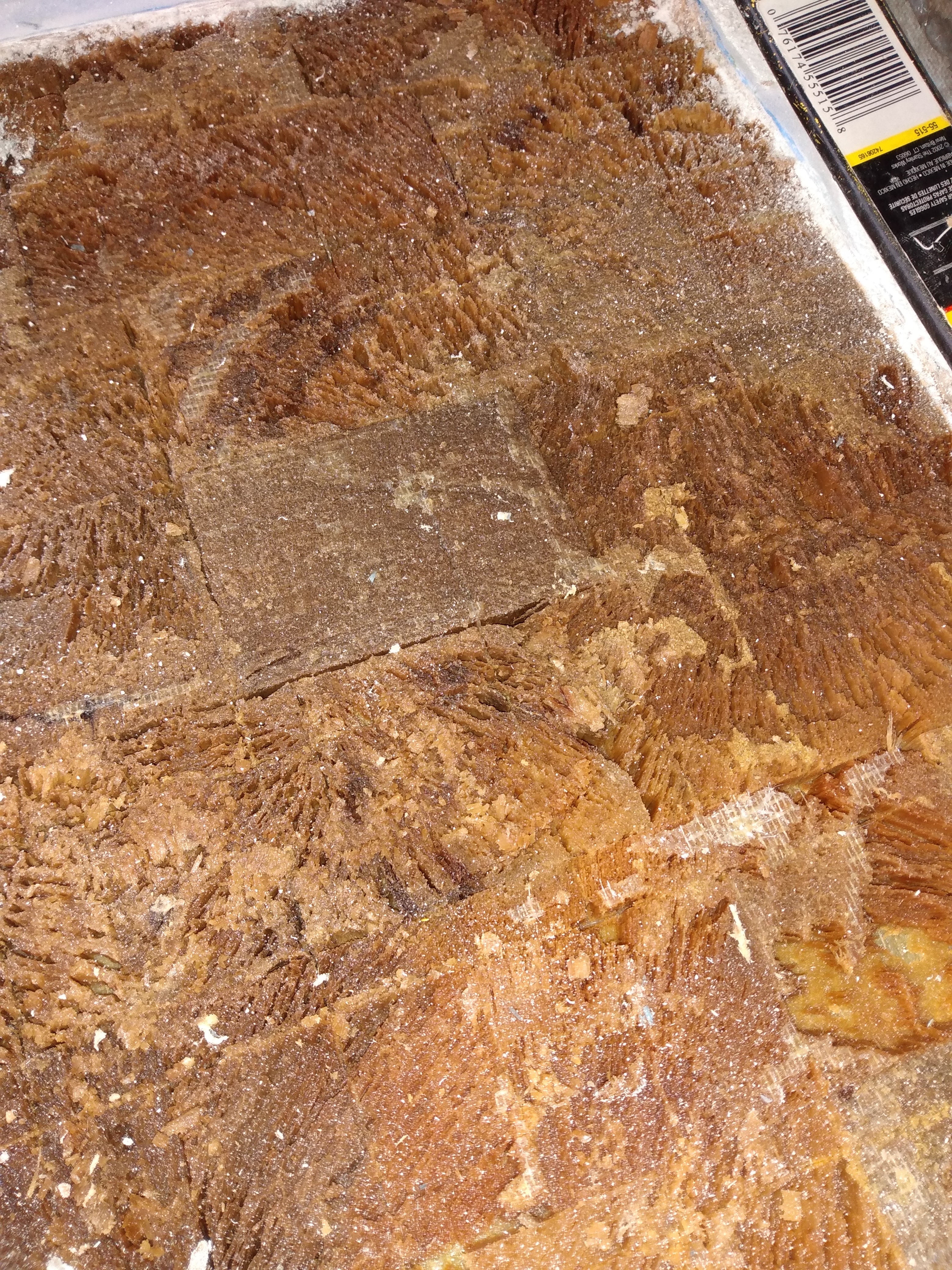

Update - Most of the old core came out without much struggle. Ran an angle grinder with 40 grit flap disc around the edge for my "bevel". As a first time angle grinder user, holy moly this thing can do some damage in a hurry. This took 5, maybe 10 minutes. Took longer to suit up than to do the work.
Just about done getting the old core out from under the lip. Some pieces are being more tenacious than others. They are no match for the oscillating tool.
Lastly, ran a RO sander with 40 grit over the main area. There's still a very thin layer of old core here. I'll hit it again before I'm done, but I assume this is another area where good enough is good enough.

- Halfway there
- hatch2.jpg (2.48 MiB) Viewed 1771 times

How finicky should I be on sanding down the bed of this? I can basically see the print of the fiberglass through what's left of the old balsa in almost the entire area. A few more passes would get it even better, but I'm not convinced another, say, hour of sanding is going to get me a measurably better end product. The idea is to just get a pretty good surface to slop thickened epoxy onto, yes?jbenagh wrote:Looking really good! The strength of the finished product will amaze you.
Jeff

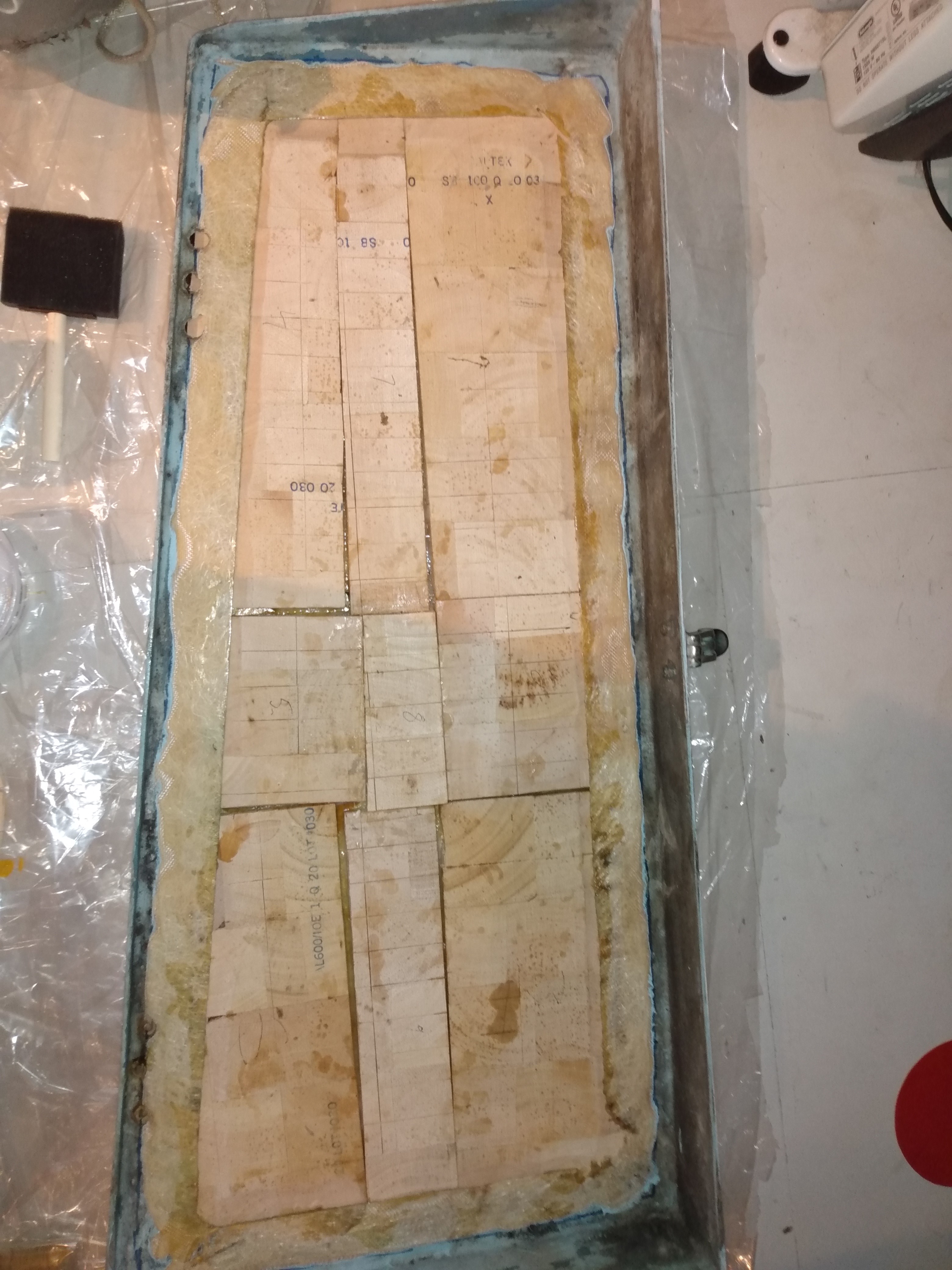

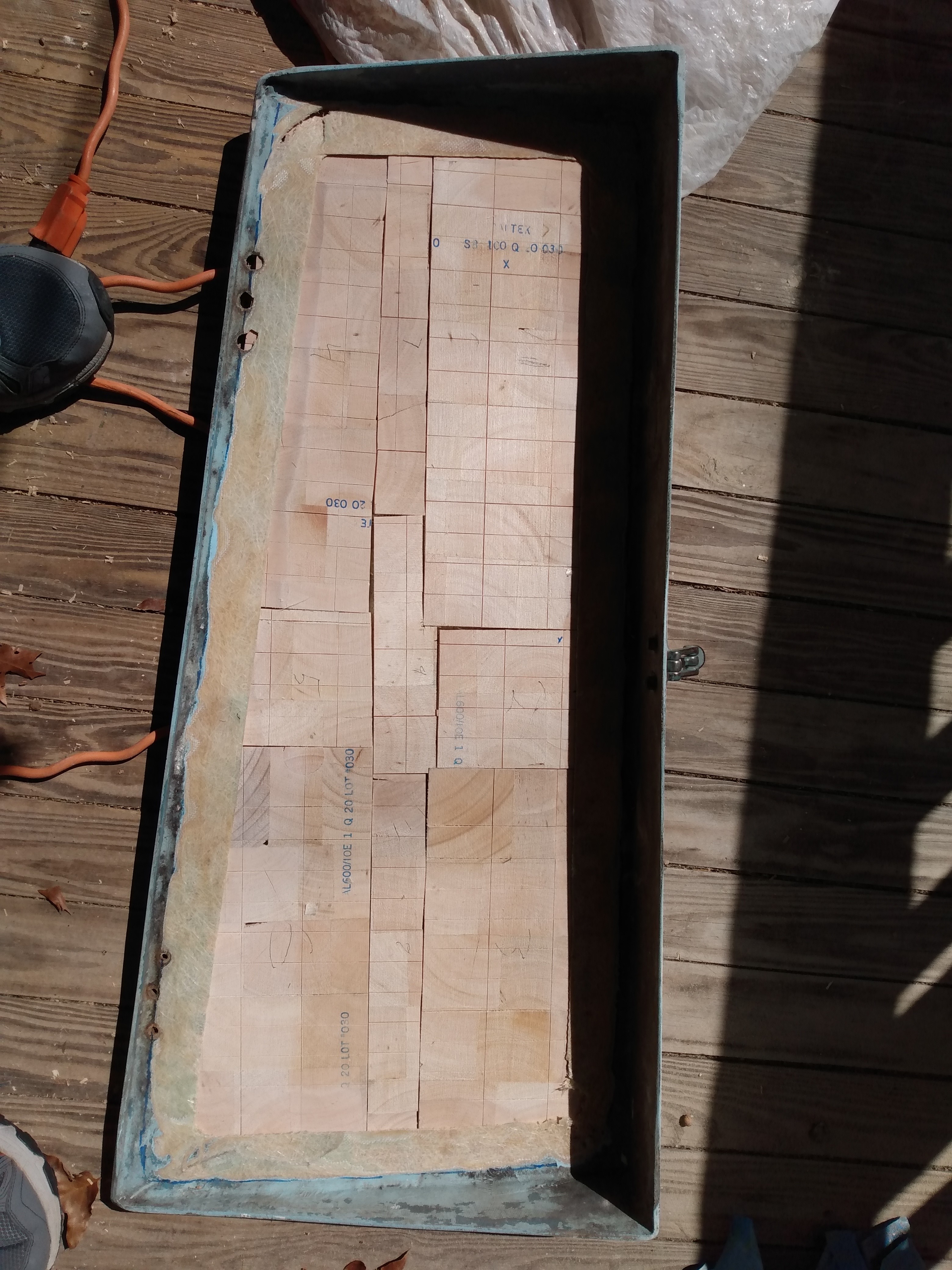

Dry fit the new core. Two questions for everyone. How critical is it for the core to get all the way under the lip? I feel like it spots I've got 1/8 to 1/4 an inch where it just won't go. Also, as you can see in the photo below, I've got one corner where the balsa just won't get in there. My thinking is to just run a bead of thickened epoxy around the entire thing at the start of assembly? The holes for the hinges are get drilled-filled-drilled anyway, so I'm less concerned there.
Lastly, there are a few thin gaps between a few pieces. Thin line of thickened epoxy to fill that, or is that over thinking things?
Tools for this stage were an RO sander with 80 grit to bevel the balsa enough to get it under the lip, and an exacto knife to trim the wood. Reminded me of building model rockets as a kid.
- Dry fitting the new core
- hatch3.jpg (2.44 MiB) Viewed 1724 times

Trim the balsa core back where it won’t fit. I would radius the edge so the cloth (biaxial?) will make the turn without creating an air void. Wet out the surfaces with neat epoxy. Then apply a bit more mixed with colloidal silica. Kind of soopy. Lay the balsa down. Don’t rush. You have lots of time. Once the balsa is positioned like you want brush in soupy epoxy/silica mix. Mix it a little thicker and fill all the voids use a yellow spread to make it smooth. I’d make some fillets around the edges. Then wet out the biaxial (which you precut and test fit with everything dry) and squeege out excess then lay the biaxial down. Bigger one first then smaller one. If you apply peel ply you get a smoother finish.
There are other ways to do this. Vacuum bagging is a good technique but it’s beyond my skill set and I am happy with the results of my approach.

Thanks John, I assume that everything needs to cure before laying the glass? Also, since this is the underside of the hatch, I hadn't planned on fairing after the glass is cured. Just a coat or two of bilge coat and get on with it.

Lay the cloth on while it's still wet if you can. That way you get a chemical bond. If it cures, depending on the type of epoxy you use you may have to was the amine blush off. Let it dry. Sand with 80 grit then apply the cloth. So if you can do it all before it cures hard much better. If you can make an indentation with your thumbnail you don't need to sand--you will get a chemical bond. Make sense?csoule13 wrote:Thanks John, I assume that everything needs to cure before laying the glass? Also, since this is the underside of the hatch, I hadn't planned on fairing after the glass is cured. Just a coat or two of bilge coat and get on with it.

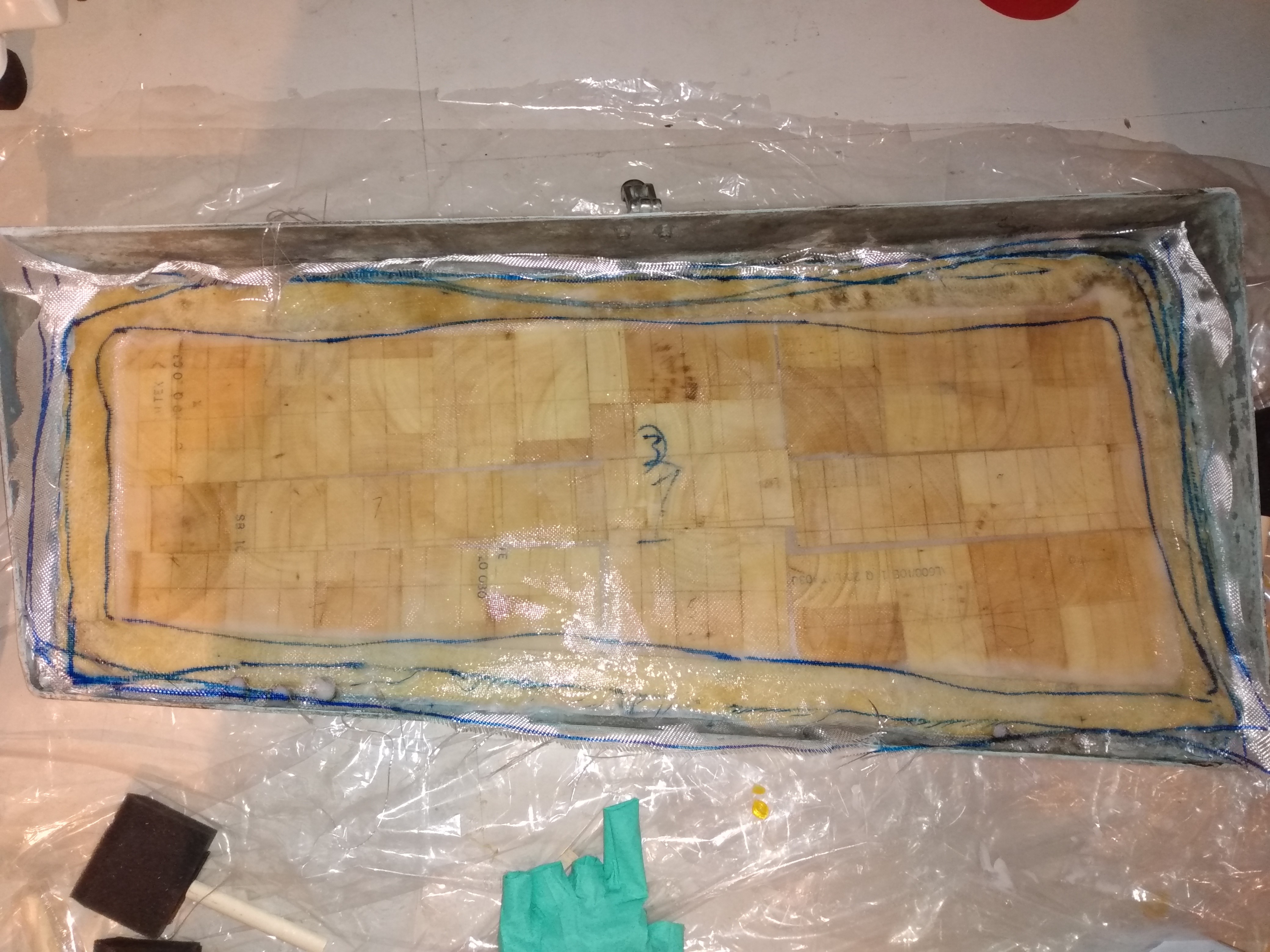

Update and lessons learned - New core is in and 3 layers of glass is on and curing as we speak. The new core pieces didn't quite go in as planned. The wetted out surfaces added some lubrication, which allowed some pieces to slide in better than planned. But crooked, and then jammed into place. Alas.
Used a bunch of sandbags to weigh things down. Scuffed all the shiny spots up with 80 grit, vacuum, acetone wipe, and on to the glassing. Filled the old bolt holes with thickened epox and will redrill when I install the hatch on the boat.
I know all the literature says this, but I still likely used a little too much epoxy on the glass. I made sure everything was flat and clear and any excess I at least tried to get up or spread thin and out of the way. I'll let this cure for an hour or two and trim off the excess glass.

- Fingers crossed
- fiberglass.jpg (1.8 MiB) Viewed 1687 times
- sandbags.jpg (1.48 MiB) Viewed 1687 times
- New core in place
- newcore.jpg (1.74 MiB) Viewed 1687 times
