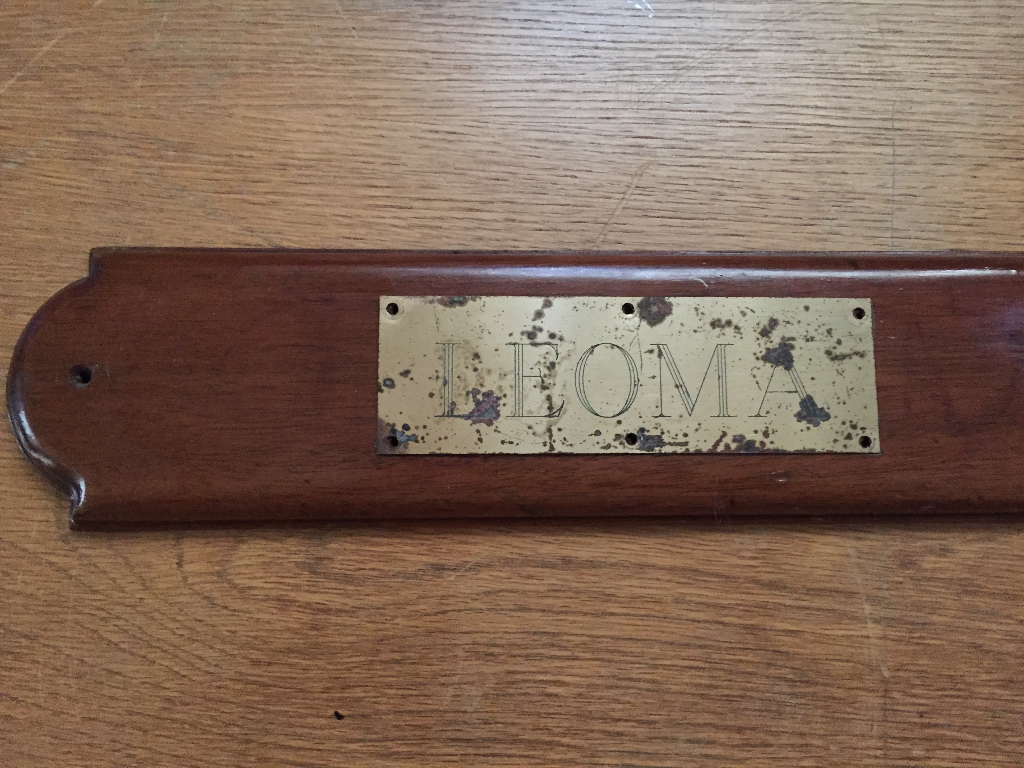

Installed reduction gear and v-drive and went across the channel. I motored across to test the gears.( 5 hours) Problem unsolved. (I know they opened up the v-drive and put new bearings, seals and gaskets). The v-drive was 8oz. above the top mark. I drained some oil and on the way back I sailed most of the way but ran the engine for 1 hour . The v-drive was 4 oz. above the top mark and the reduction gear box was low. It's still sucking oil out of my transmission. When I got home I found a message from the Volvo shop. They did not open up the reduction gear because it's ridiculously difficult to get parts. They serviced it the best they could and couldn't see any shavings or any problems, They recommended I continue using it. I just sent them my report. I think I will start to save for a new engine. 3-4 years down the line. Good news : The new Blue Seas Add-Battery charging set-up is working good and I painted the lazerette. It looks so good. I have the stbd side clear so I can easily get in there to access the steering motor or the windvane parts. It's so nice and clean I could sleep down there. I was going to get a new brass plaque with the boat name and I found underneath it a previous name "GiGi". I like "Leoma" better. GiGi sounds like something out of a Franky Avalon movie. Oh, One more thing. I am installing a track for my storm trys'l. I think I will have problems sheeting . My backstays might be in the way. I could always attach it to the boom and sheet it that way . I was hoping to be able to secure the boom. I'll find out this week. I hope I didn't screw up again.

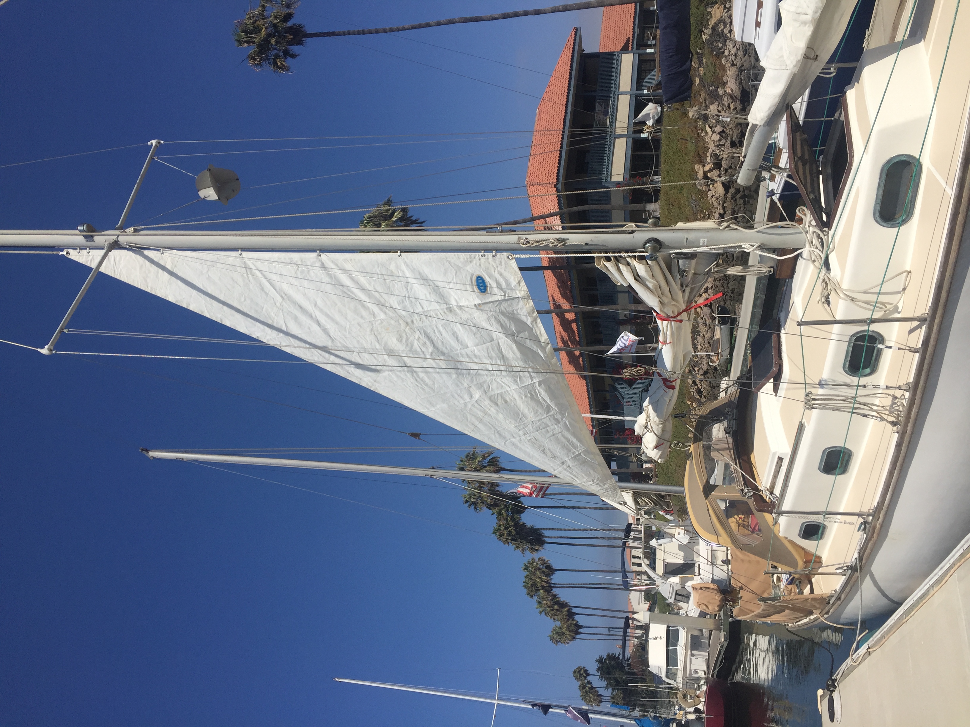

I think this trysail will be ok. I fixed the name plate. Going sailing now for a few hours. With my sister and her family

That’s trys’l looks about right John. Have a great sail. Oh to be sailing in SOCAL right now.

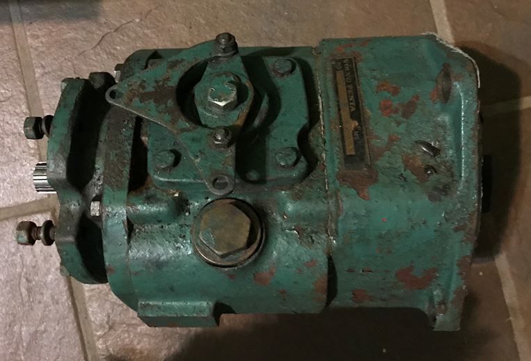

I can maybe hook you up on a reversing gear and v-drive. I believe I still have them. Pulled off of my Cape Dory 30C about two years ago. The MD7A went bad and I saved a few parts. The transmission ect was not leaking. I converted to electric which has worked very well for us. Let me know if you have an interest and I'll make sure it is still in my shop. If you pay shipping I'd be willing to let you check it out. Sort of a try before you buy. Dennis, not a full member of this site and don't know if I can message. Let me know. I have other parts also. One cylinder had a hole in it.

[quote="ghockaday"]I can maybe hook you up on a reversing gear and v-drive. OK Thanksim interested. Where are you located. I need a way to contact you. Ill need the serial numbers on both. I will probably want it shipped to Waltergear in NJ
Re: Leoma update 8/2020
I am in Virginia, so shipping may be more than you want to pay. My wife ships sheep wool all over the country so she has an idea at 40lbs will be about $100 to your side of the US. I wish I could guarantee you it was perfect but I can't. Dennis
