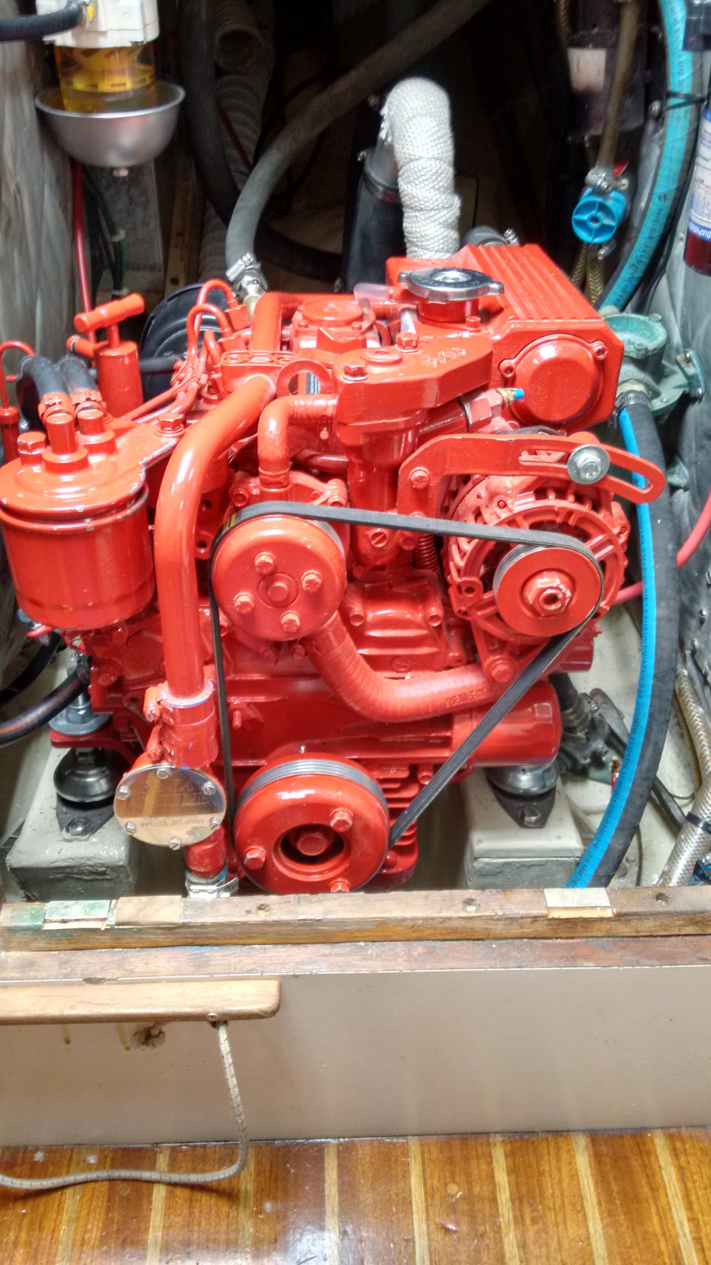

Hi all - thought I'd throw in a few pics of my new Beta 25. I just ran it for the first time today. Except for a leak at the
exhaust hose/wet muffler connection, it ran beautifully. This installation is a first for me and daunting at first.
The old steel bed took about five hours of patient cutting to finally break free. Initially, I used a disc grinder with a
five-inch diamond blade. That thing could eat fiberglass for breakfast, but made a a lot of dust. Later, I
used a dremel with a carbide ball end mill and a Fein multi-tool with a carbide blade. Much better.
Constructing the beds was the thorniest part. Eventually, I decided to make a simple jig that locates off the
prop shaft and keeps the inner walls of the G-10 beds from sliding down toward the centerline. The engine jig located the
tops of the beds and their angle down aft. Here's the pics:---Jean

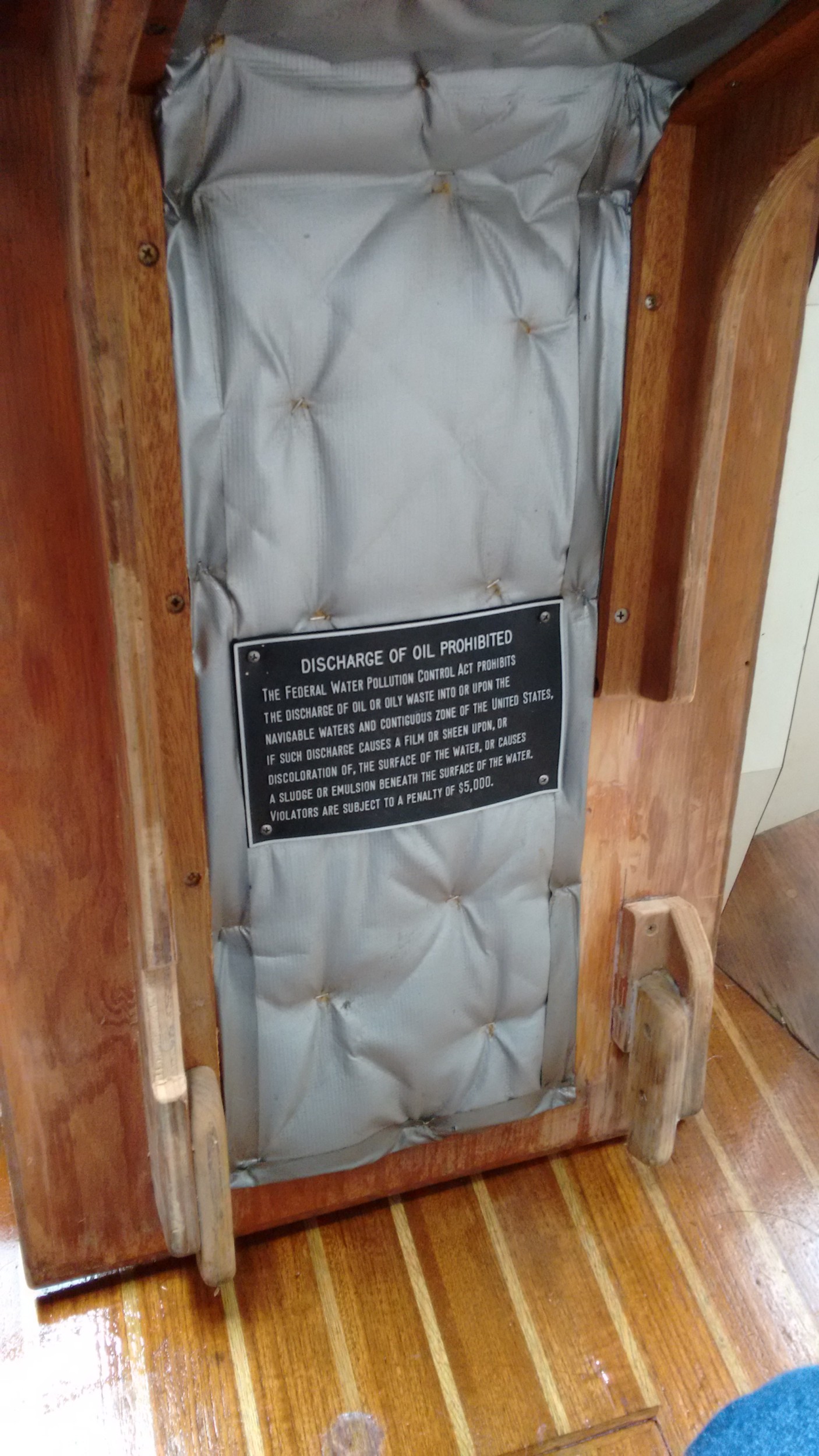

- The new Beta with 7 degree down angle transmission. The front sits lower allowing better access across the top.

- The cover had to be altered because the engine sits farther forward than the Universal did.

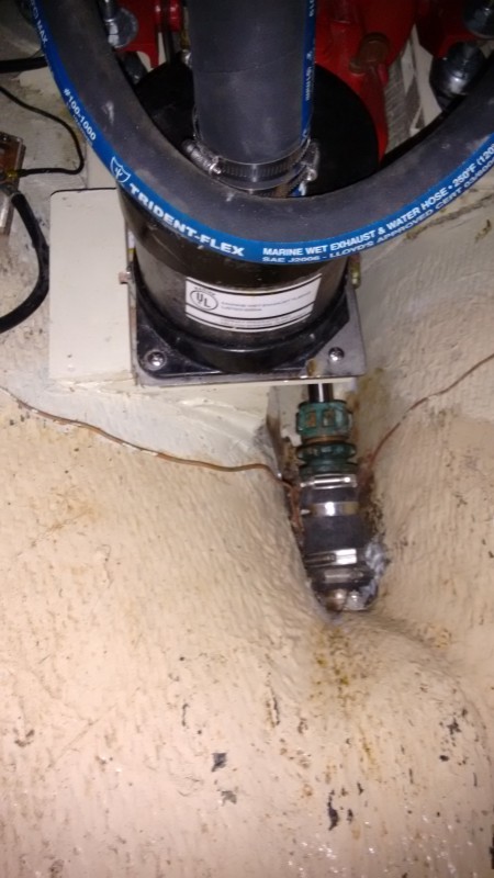

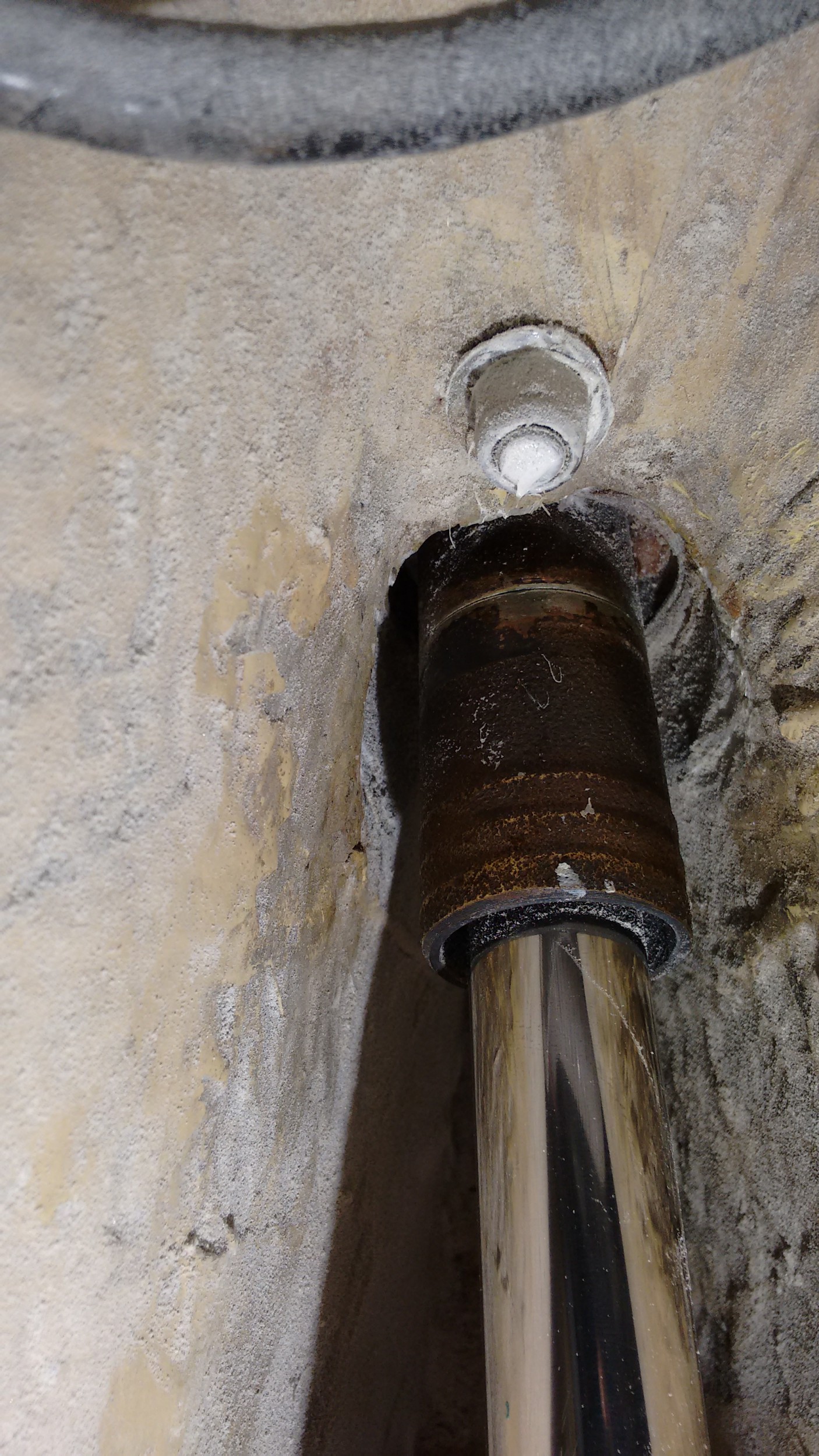

- A brazed extension was added to the original stern tube to allow for conventional hose clamps in the open
- IMG_20190826_141256600.jpg (785.51 KiB) Viewed 1263 times

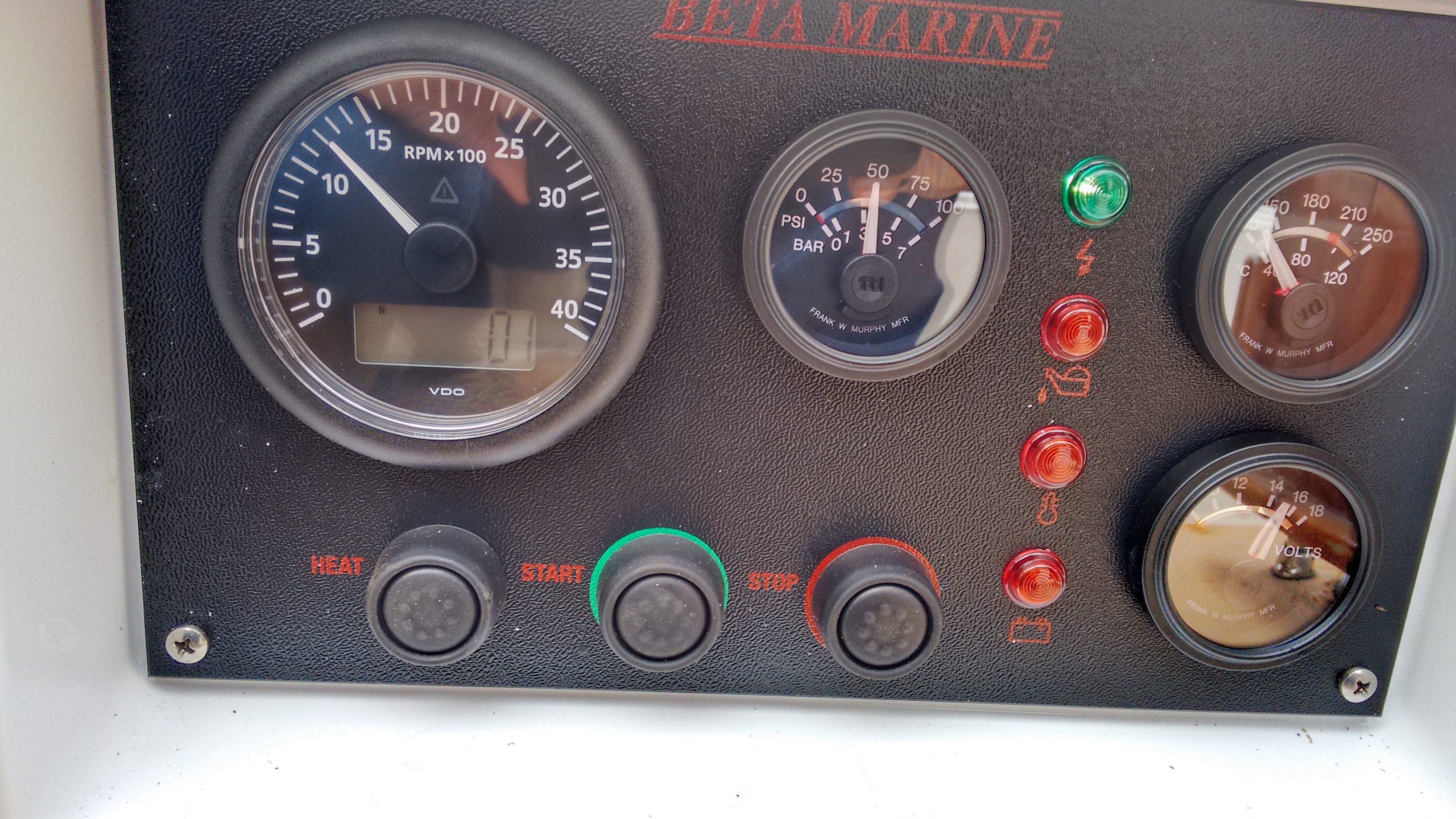

- The new control panel

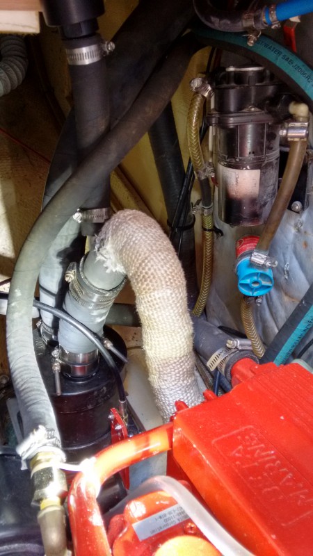

Re: New Beta 25
Jean
Do you have a picture of the water lift muffler set up in your boat? Beta Marine recommends the top of the muffler a min 12” below the bottom of exhaust elbow. Seems like that would be hard to achieve. Maybe I am understanding it incorrectly?
Re: New Beta 25

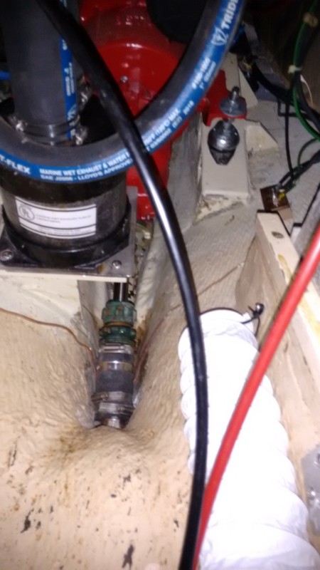

John, I don't really have good pictures of the elbow and muffler together. But here's what i do have.
I tried to keep the muffler as low as possible, mounting it on a removable platform for accessing the stuffing box
In the end, that wasn't necessary. I'm able to adjust the stuffing box without removing the platform. Anyway,
here's the pics, such as they are.
I didn't measure the vertical drop, but I think it's a bit less than 12 inches, using the tallest elbow Beta had. - Jean
- IMG_20200803_115435277_HDR.jpg (110.49 KiB) Viewed 979 times
- IMG_20191012_140108063.jpg (84.04 KiB) Viewed 1068 times
- IMG_20191012_140025094.jpg (88.15 KiB) Viewed 1068 times
Re: New Beta 25
Thanks Jean. I haven’t determined the solution yet. I’ll figure it out once the engine is in the boat. But this helps me with my thinking.
