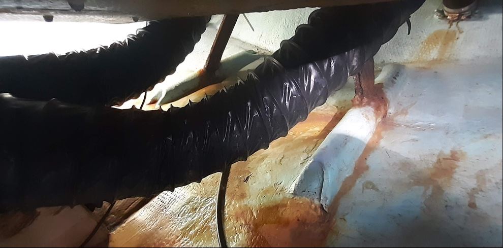

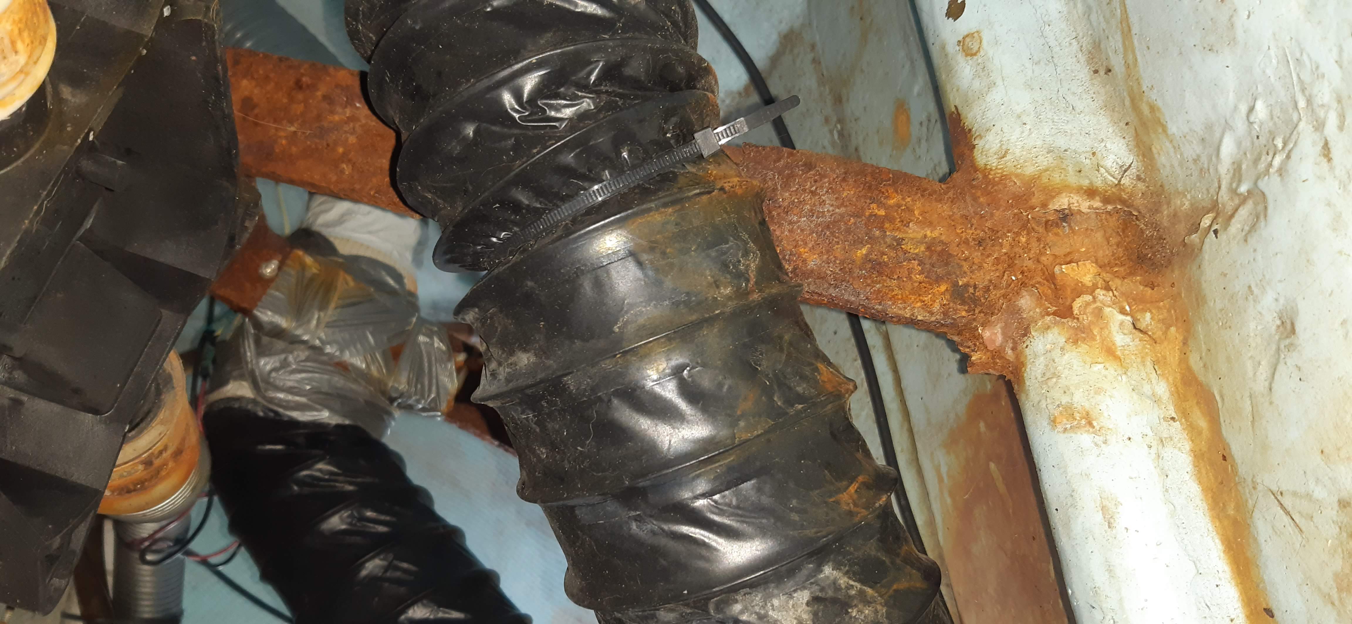

2) Rusted support steel plate under the cockpit. I am not too sure how to call it and not sure if this is specific to the 30C but I have a pretty big u shaped (upside down) mild steel bar near the transom accessible from the cockpit lockers. It looks like the bottom of it has been fiberglassed in the hull and I believe its function is to provide extra strength and support to the 2 sides of the hull.
This part, as you can see from the pic, is rusted pretty badly. I am not pretty sure what would be the best thing to do about it and if it might be a really structural part (or maybe not). As a novice, I guess the first step would be understanding its function. Wondering if anyone can shed some light on this and maybe have come across the same issue already and addressed it?

#1 Rusted chain plates - since there aren't any pictures of them I don't know how bad they are but what I can tell you is that when I replaced my bow sprit I also replaced the steel support (search bow sprit replacement) others have documented as well. Anyway My support was quite rusted maybe 50% material loss in some areas but was still incredibly strong. So depending on the condition of yours maybe just apply some rust inhibitor and paint for now.
#2 Rusted cockpit supports - I believe that these are aftermarket as mine does not have them so I would not worry about them. Again maybe just apply rust inhibitor and paint. What I would check is the aft chain plate condition.

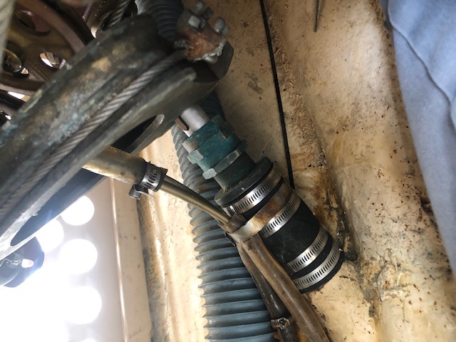

Here is the pic of the rudder shaft stuffing box. I just replaced the hose before launch this year.

Congratulation on your new to you CD 30. It’s a fine boat. I don’t have one but I do have a 36. And I have gutted her to a bare hull and brought her back to life so I can tell you they are well made and anything an be fixed by a thoughtful owner if you do your homework, you are patient, and you have a wise plan.
I don’t know what that rusted bracket is under your cockpit. Can you ask the guy you bought it from what he knows about it? Can you track down any of the previous owners?
Is your boat a tiller boat or a wheel steering boat?
If you can make some sketches and give us a better idea of its position then I bet we can figure it out.
My instincts tell me it’s a cockpit floor support of some kind. My immediate reaction is to cut the thing out as it doesn’t belong there. But maybe it was installed to address some issue—perhaps some other damage or some kind of worry or anxiety the PO had.
