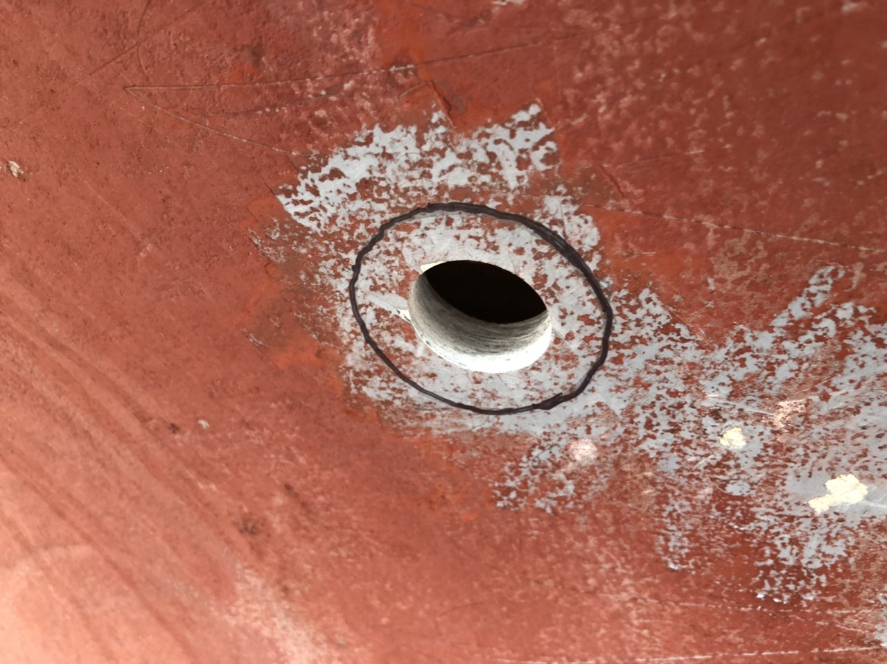

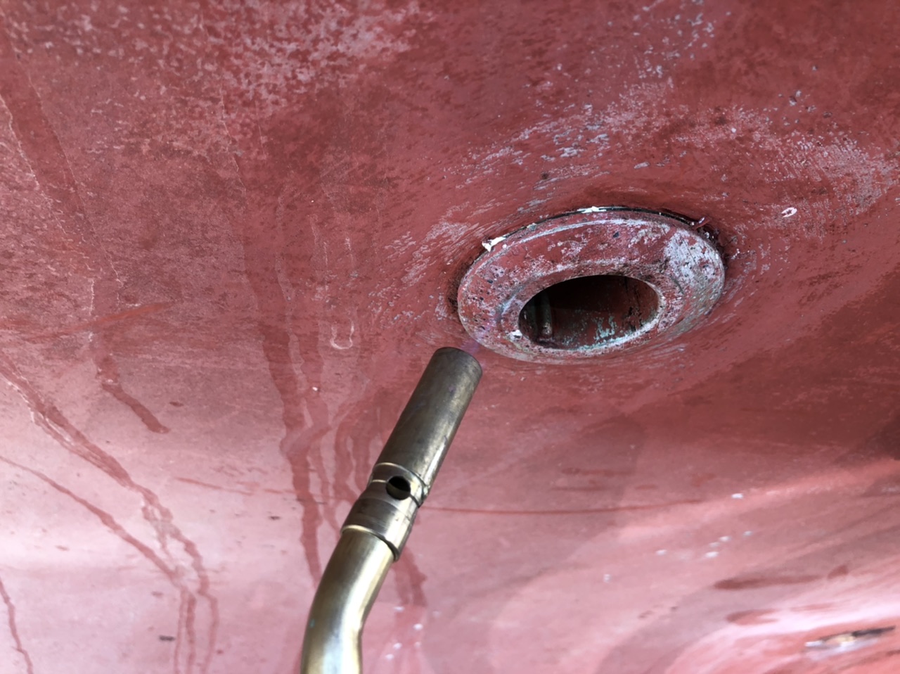

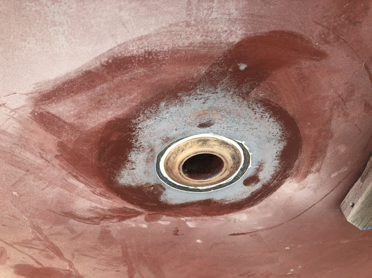

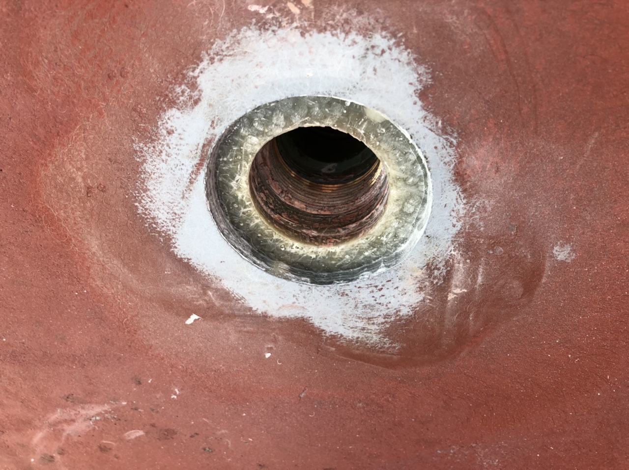

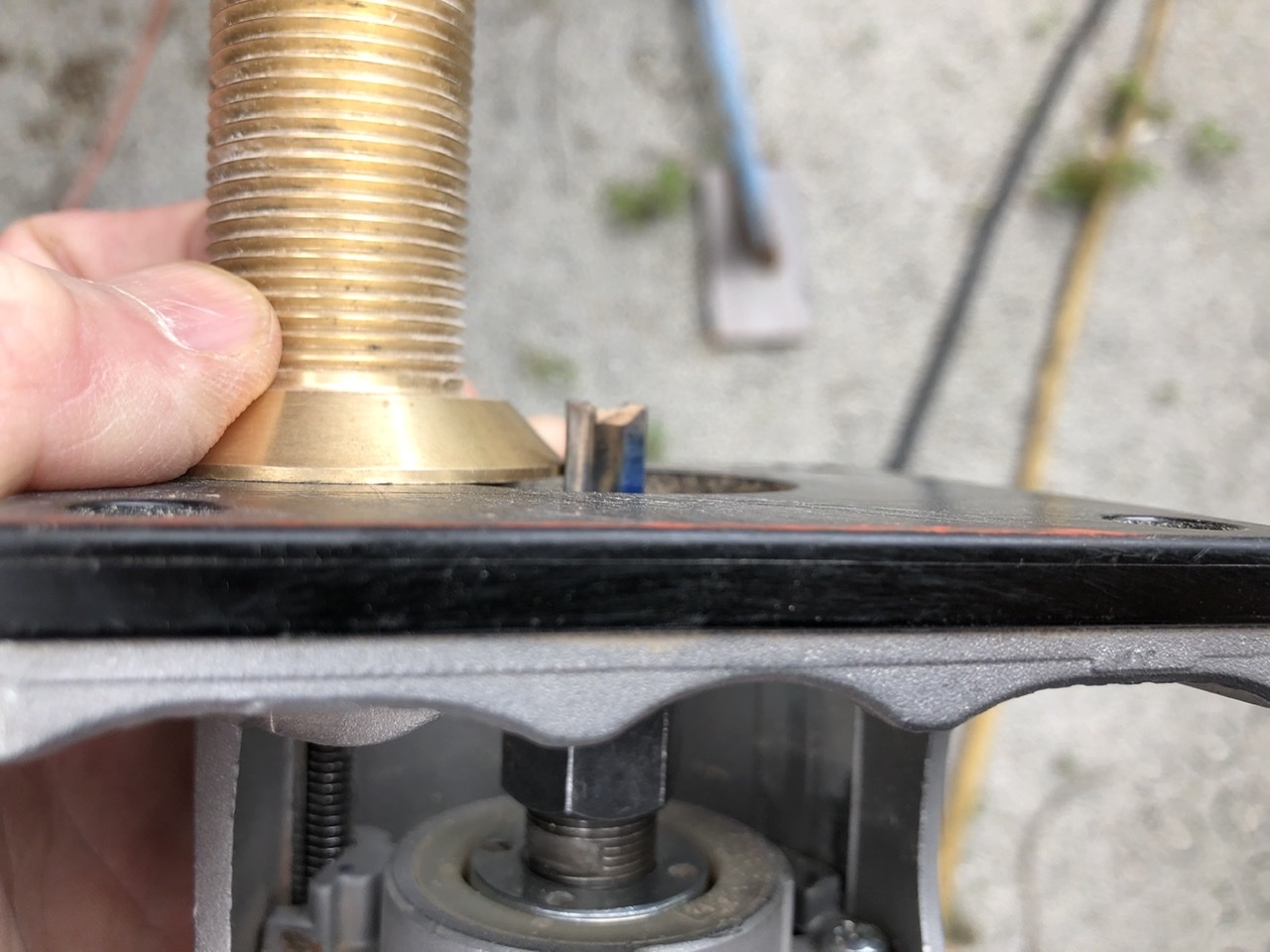

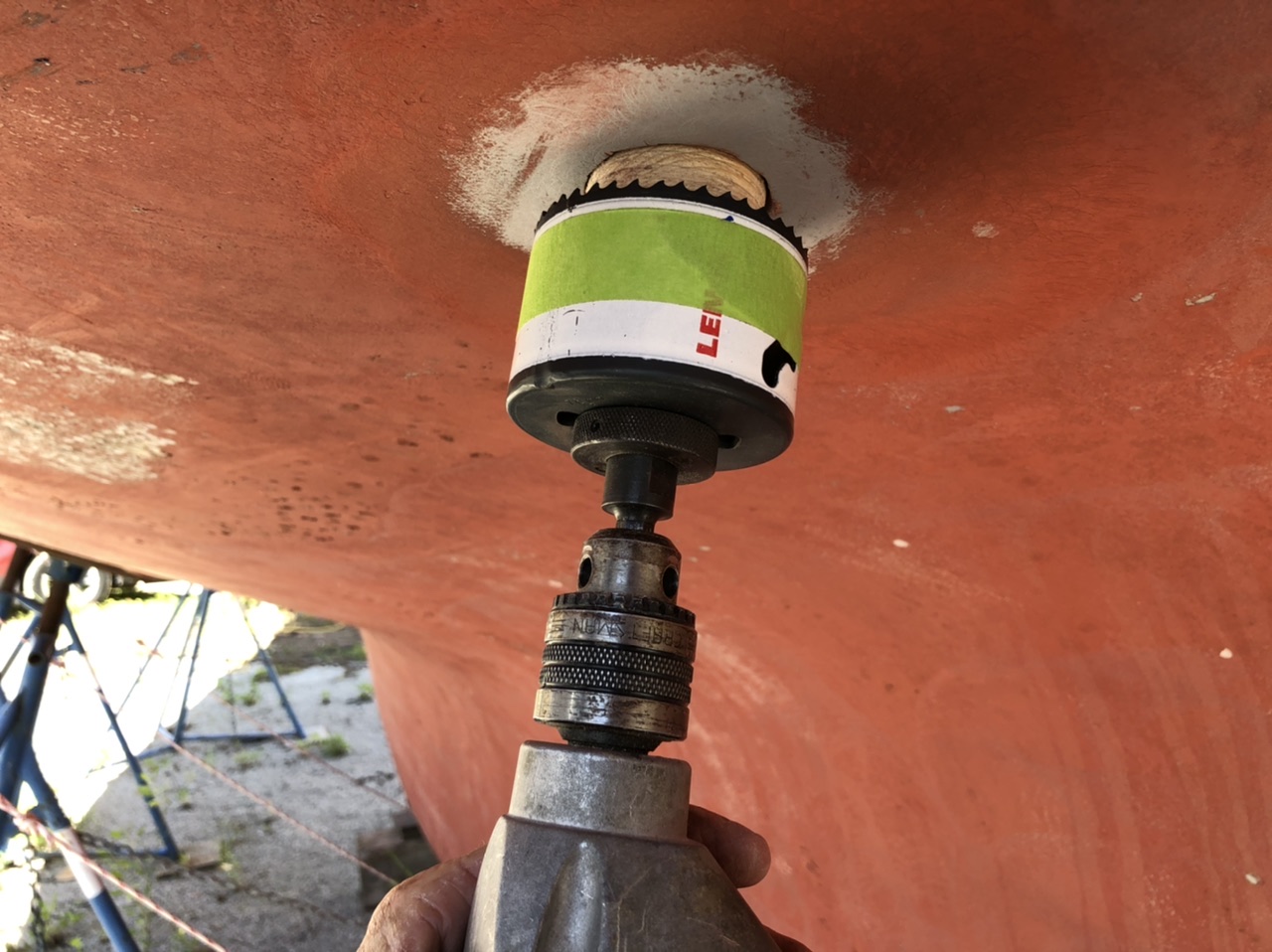

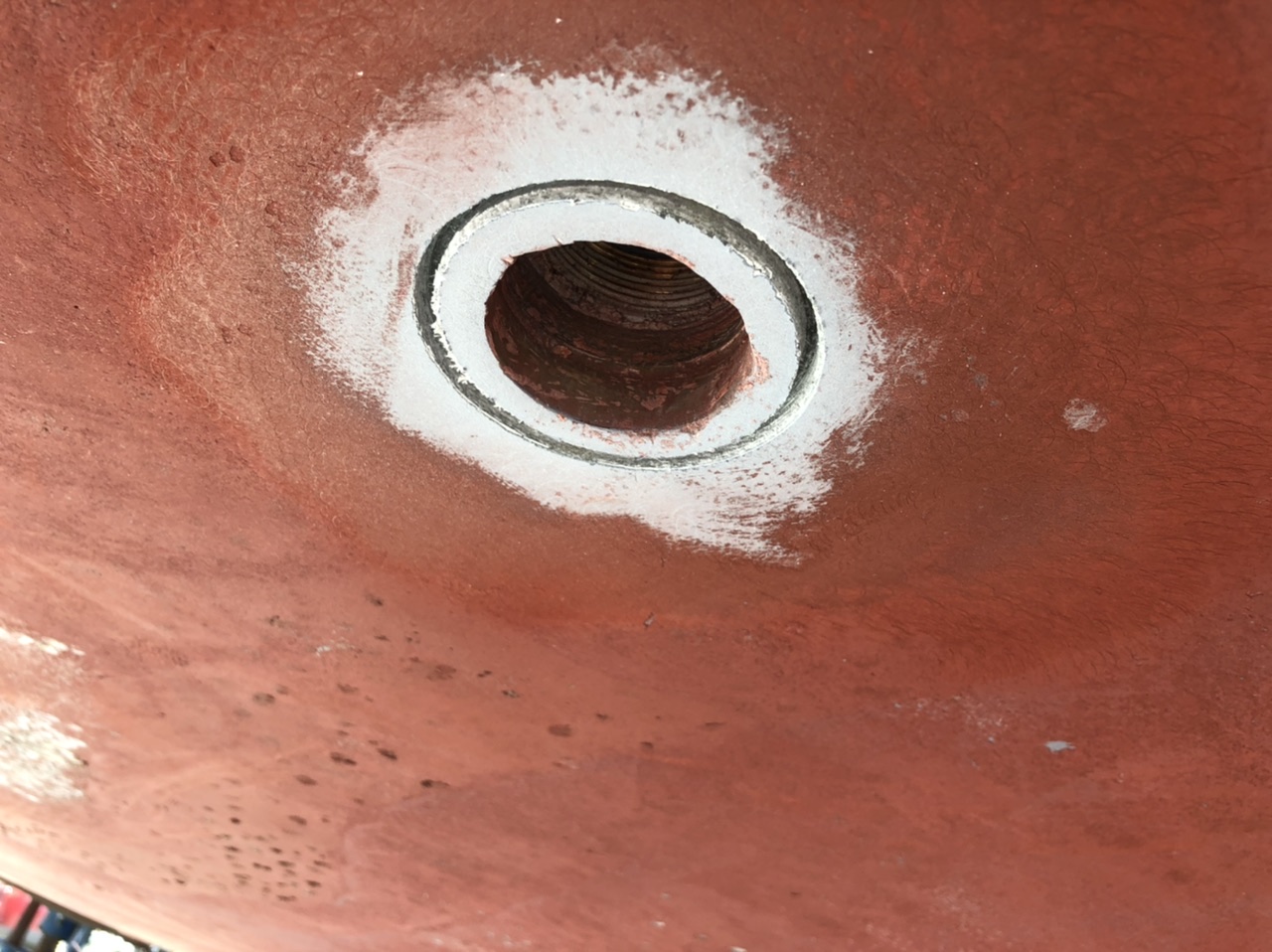

I am in the process of installing an inboard diesel in the Far Reach. You can find that thread here:
http://www.capedory.org/board/viewtopic.php?f=9&t=36770
During my six year rebuild, which I completed five years ago, I eliminated 7 of 10 through-hulls and sailed for the next five years with only three of them (two scuppers and the galley sink drain—all 1.5”). They are your standard bronze mushroom style through-hulls. I always wanted the them to be flush mounted but just couldn’t determine a good way to do it. But, I was determined to figure it out for the engine intake 3/4” through-hull. I have read about several techniques but didn’t really like any of them. I practiced in my shop on plywood with various jig over the past couple months but was never satisfied with the results. Then, yesterday I read an article in an old Practical Sailor magazine from 2011. It made sense to me.
https://www.practical-sailor.com/boat-m ... oth-bottom
I did not need to increase the thickness of the hull since the through-hull is 5/16” thick and the hull where in installed it is 5/8” thick. So, I set my small trim router about 1/32” deeper than the head of through-hull is thick to allow for bedding compound. I traced the outside circumference of the through hull on the hull and just routered it out. Took maybe two minutes. I test fit it. I sanded the mortised portion with forty grit abrasive. Then I wrapped the threaded part with rigger tape (duct tape) and waxed up up thoroughly. I wetted out the mortised hole with neat epoxy. I mixed up epoxy thickened with 404 high density filler and just a little 406. I slathered the thickened epoxy on the through-hull head and pushed it in. I installed the nut on the threaded barrel and snugged it down. I cleaned up the squeeze out. When it cures, but is still green, I will use a mallet to pop it out being careful to back the nut out to the the very end first so I am not hammering on the threads.
Later I will epoxy in the 1/2” thick G10 backing plate (which by the way effectively adds 1/2” to the hull thickness). Then, I’ll be ready to drill the three holes for the seacock mounting bolts and apply bedding, etc and install the seacock.
If this works as well as I think it will I’ll remove the three 1.5”’mushroom head through-hulls and replace with flush ones using the same technique.
Cored hulls and hulls that are thin require some additional steps to use this technique. The PS article covers those steps too. Fortunately for us our Cape Dorys have thick solid glass hulls.
- C7FA7F18-8DC6-42F0-BC3A-1A21D2411B77.jpeg (299.88 KiB) Viewed 1487 times
- B76B0A86-28ED-46F2-82E9-19DA53457B8A.jpeg (352.37 KiB) Viewed 1487 times
- 158DE8AD-B49E-4351-A324-78A904D2D9A0.jpeg (242.49 KiB) Viewed 1487 times

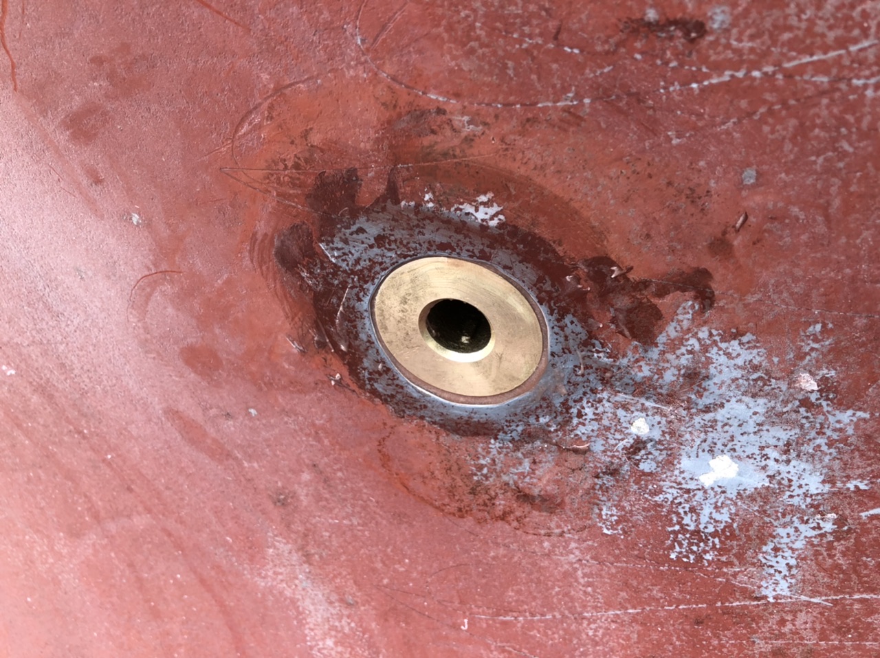

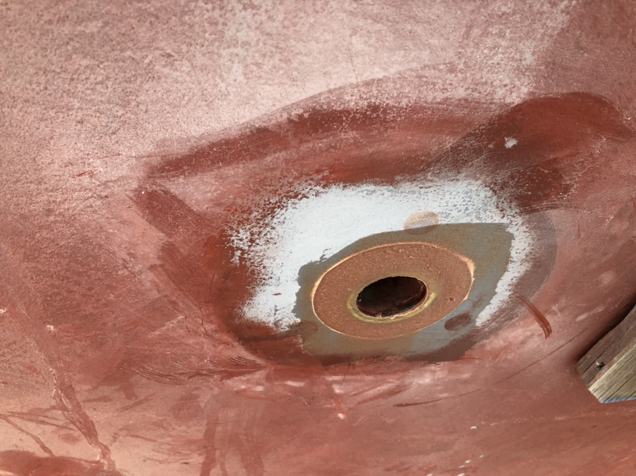

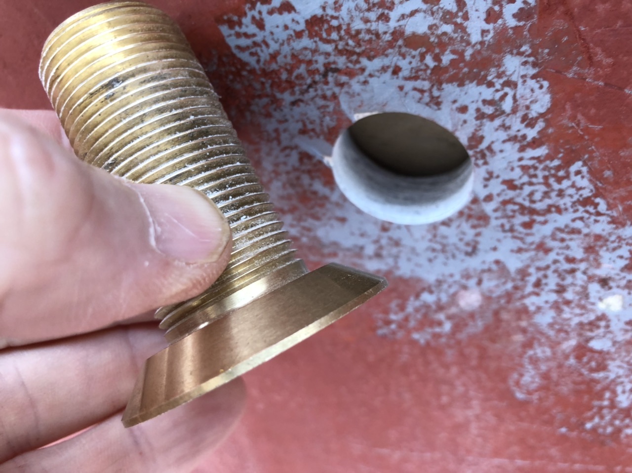

The additional pictures.
- AD349A5E-58C2-4B4D-A96E-C6D7A92031F7.jpeg (371.93 KiB) Viewed 1486 times
- 1FFB0DB6-B61A-4A0D-A825-80A1A7C6A53C.jpeg (362.06 KiB) Viewed 1486 times
- 22700348-C1BB-4824-8F18-DC6ADC4F90FA.jpeg (435.82 KiB) Viewed 1486 times

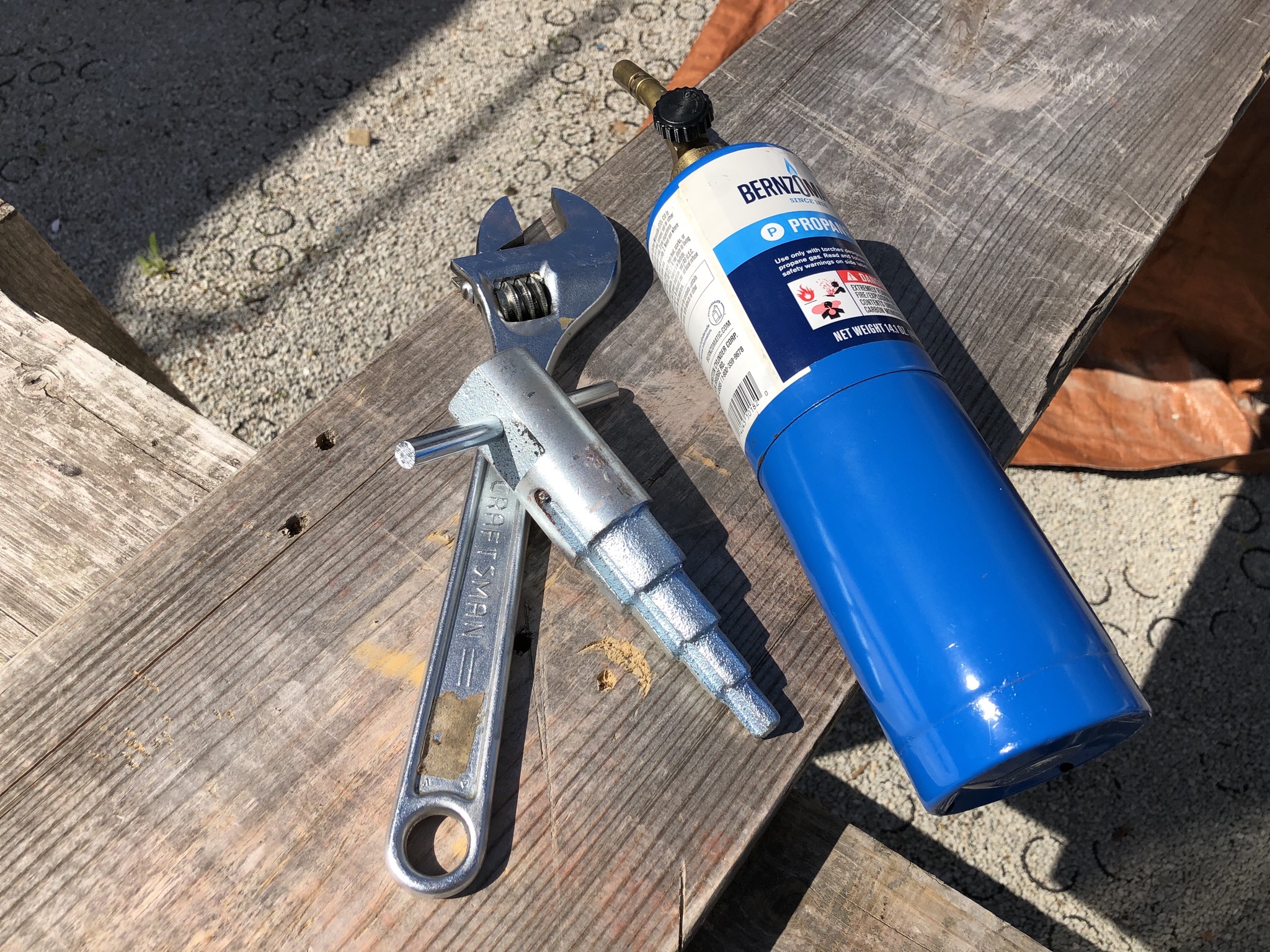

But, as I pondered options I recalled reading about using West Systems epoxy on metal. So I read did more research last night. If it sticks to bronze then there is another way.
Today, I removed the three through hulls easily with a through-hull wrench which I recently purchased for $38. A marvelous tool. Will I ever need it again? Who can say. I added a little heat with a propane torch and along with a 12” crescent wrench they came right out.
I cleaned up the old dried bedding compound in the holes and on the through-hulls. I made a 2” diameter arbor I cut from a 2 1/8” hole saw. I placed the arbor on the pilot bit for a 3” hole saw. The arbor allowed me to use the existing hole as a guide for the 3” hole saw. No chatter. A clean cut. I marked the 3” hole saw with tape for a 5/16” deep cut. Nothing to it. With that complete I used the laminate router with a straight shank bit, much as I did when installing the 3/4” flush through-hull at the top of this thread. But, this time I had only to cut to the circumscribed 3” diameter cut. It was simple and left me with a perfectly round, clean, flat, recess 5/16” deep and 3” in diameter. I cut 5/16” off each through-hull using a vise and a hack saw. I cleaned up the cuts with a mill file. I then screwed in the mushroom head through-hull to test fit it. The top was flush with the hull of the boat. In the next few days I’ll chamfer the edge of the 3” hole and burnish the through hull. After bedding it, I’ll fill the exterior bevel with thickened epoxy and Bob’s your uncle. If I ever have to remove the through hull it will be a simple matter to grind back to the edge. Same process as we do to remove the rudder gudgeon.
The through hull will need to be thoroughly cleaned and heavily burnished before applying epoxy. Additional reading informs me that West Systems GFlex may be well suited to this project. I’ll call the tech line tomorrow to confirm.
Bottom line—I believe this is a viable technique to flush mounting existing through-hulls for very little investment. A word of warning. Your hull needs to be thick enough to accommodate the recess. I also have 1/2” G10 seacock backing plates epoxied to the inside of the hull which essential acts as additional hull thickness.

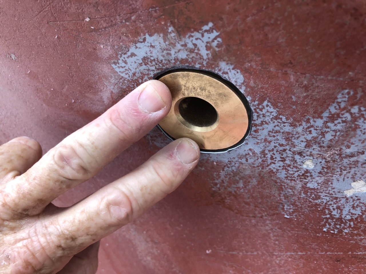

My wife is good with a dremel and grinding requiring detail work so she beveled the edges of the three recessed holes for flush mounting the standard through-hulls. Then we bedded the 3/4” flush through-hull and seacock for the engine intake and called it a day.
I’ll give the bedding compound a couple days to cure then sand and apply GFlex and fairing compound to fair in the through-hulls.
