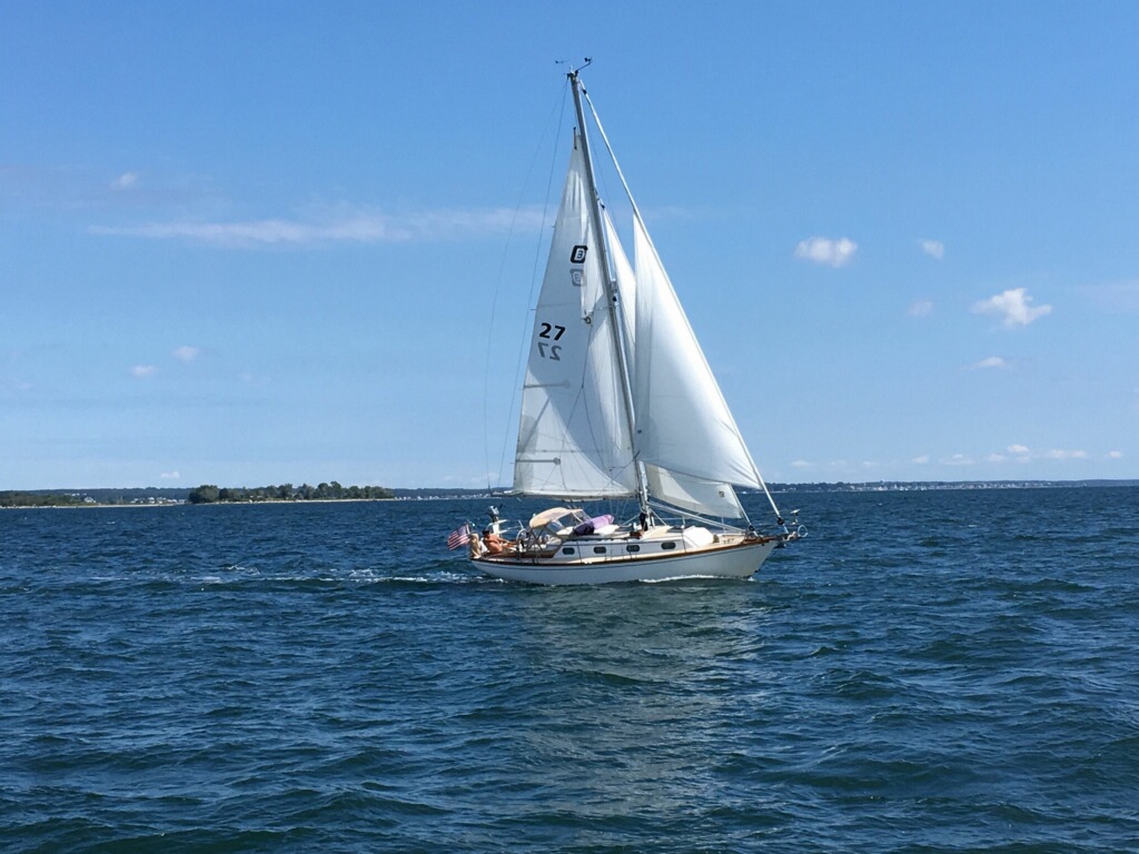

I never secure the bunt of the sail after it has been reefed....haven’t done so for many years. The wind itself tends to keep it in place and it never catches, and holds, rain or wind driven spray. The sea state and motion of the vessel see to that. It never balloons out so, although I had the sailmaker add three reef points, I have never actually added the lines.distand wrote:Yes my CD330 Dove Tale came with the lines leading to cockpit. I do raise the main from the cockpit but there is quite a lot of friction. I use a winch once the main is about 2/3 up. Last year was my first season with the boat so I have been experimenting with the lines. When I put her away for the winter I had sketched out the following leads to set up for the Spring:

This is a photo of Orion taken last September with one reef in the main, a full staysail, and a reefed yankee. The main looks nice and neat....if I must say so myself....

Jim, that’s a lovely photo.Jim Walsh wrote:I never secure the bunt of the sail after it has been reefed....haven’t done so for many years. The wind itself tends to keep it in place and it never catches, and holds, rain or wind driven spray. The sea state and motion of the vessel see to that. It never balloons out so, although I had the sailmaker add three reef points, I have never actually added the lines.distand wrote:Yes my CD330 Dove Tale came with the lines leading to cockpit. I do raise the main from the cockpit but there is quite a lot of friction. I use a winch once the main is about 2/3 up. Last year was my first season with the boat so I have been experimenting with the lines. When I put her away for the winter I had sketched out the following leads to set up for the Spring:

I don’t tie the bunt in either. I will some times put a single sail-tie on the bunt to hold it up out of the way but only if we have no plans to shake out a reef for a long time. Otherwise, we also let it be.
