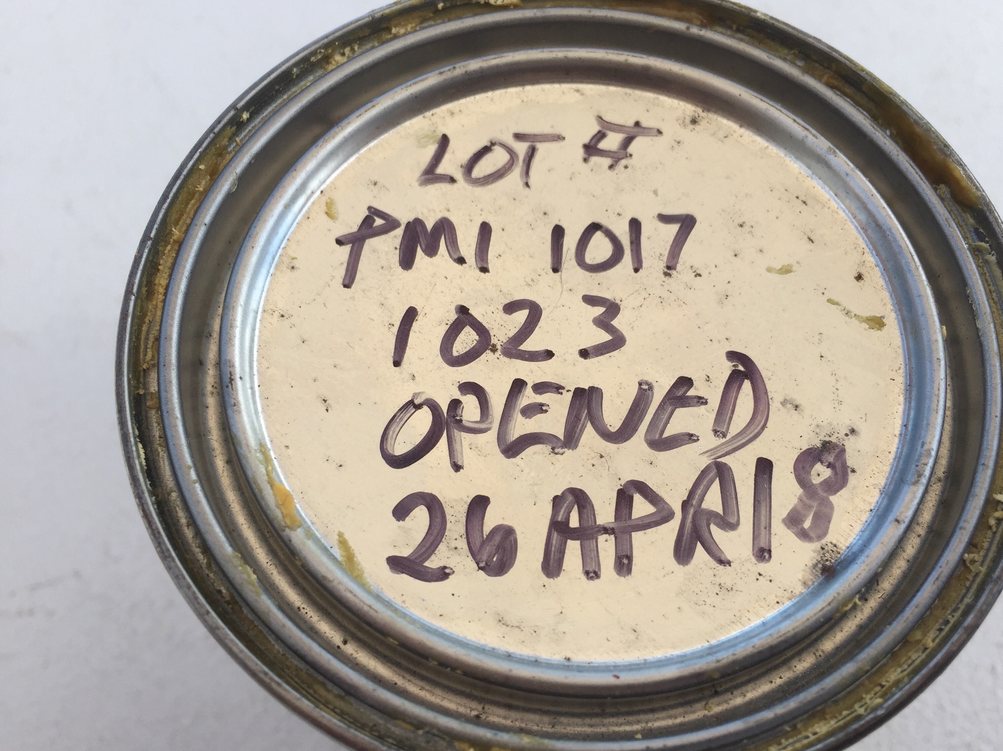

Dolphinite Bedding Compound is a regular part of my arsenal. Some people think because it’s old school it’s not as good as more modern bedding compounds. Or they think it’s only appropriate only on wood boats. Not so. It’s a tool, like any other.
Case in point. I remove the cleats from my coamings when I varnish. I bed them with dolphinite, which does not really harden. It’s perfect for bedding anything you need to be able to take apart.
I varnished the coamings this past week. They came right off. No prying or cussing or damage to the wood. Cleaned up the surfaces with mineral spirits. Today I reinstalled the cleats. I originally opened the can in Apr 2018. I have opened it several times since then. Today, I opened it and other then a light skim coat on the surface, which I peeled off and discarded, it was in perfect form. No tube of sikaflex, 3M, or boatlife caulk would still be useable. And while dolphinite is not the best choice for all your needs it is a good choice for certain projects. I use dolphinite on the dorado box lids, the craze iron, certain cleats, etc.
I purchase it in a quart then immediately dispense it into two pint size cans. I mark the lid with the lot number and date.
Right tool, right job.

- B5A3B253-2AC4-4E37-9302-835D62A0650C.jpeg (138.8 KiB) Viewed 405 times
- Still good a year later. No tube of 3M or sikaflex will last that long.
- B5AF7144-9CE3-438A-9C5F-0751EF3B9AE3.jpeg (651.65 KiB) Viewed 405 times
