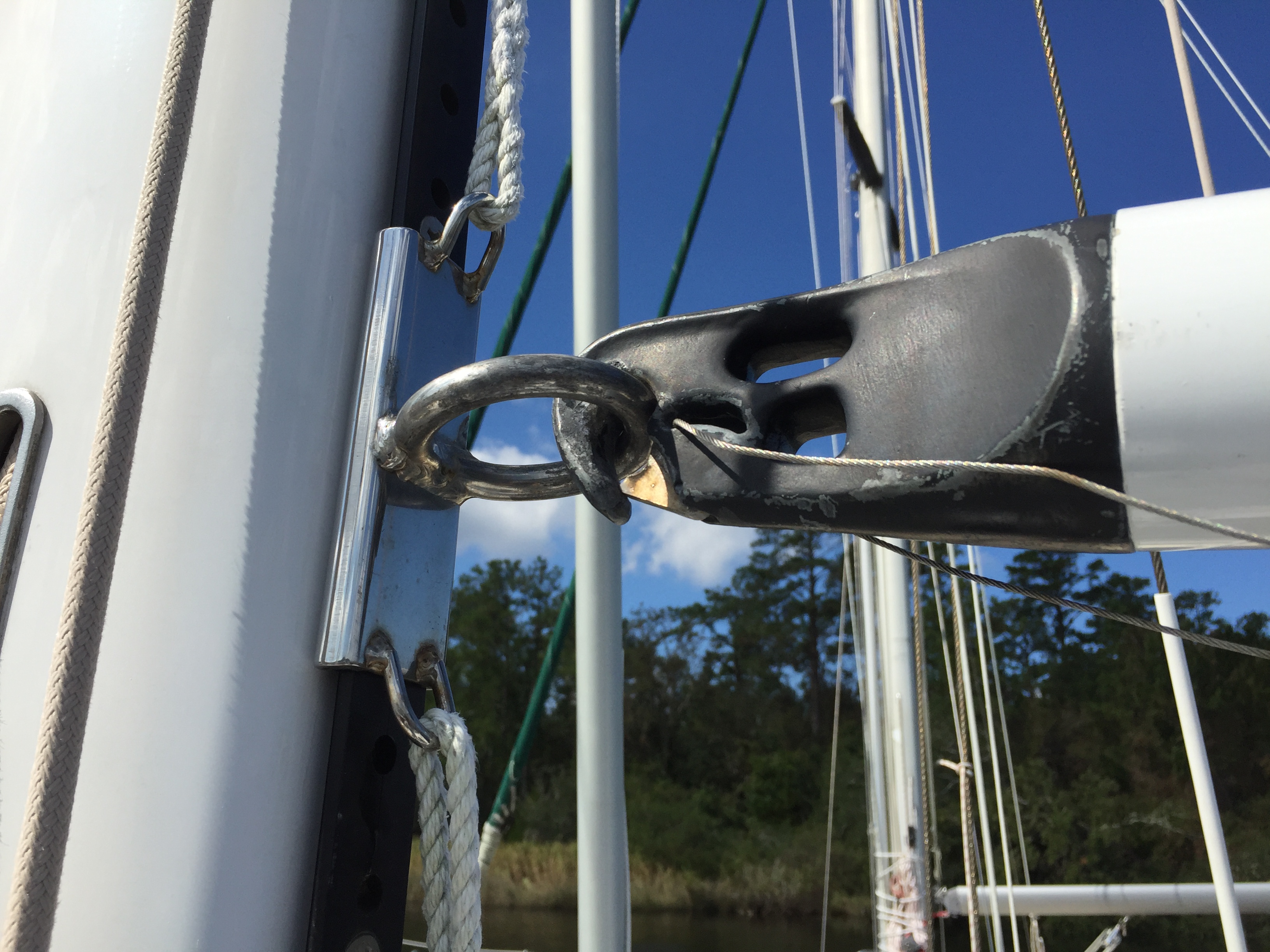

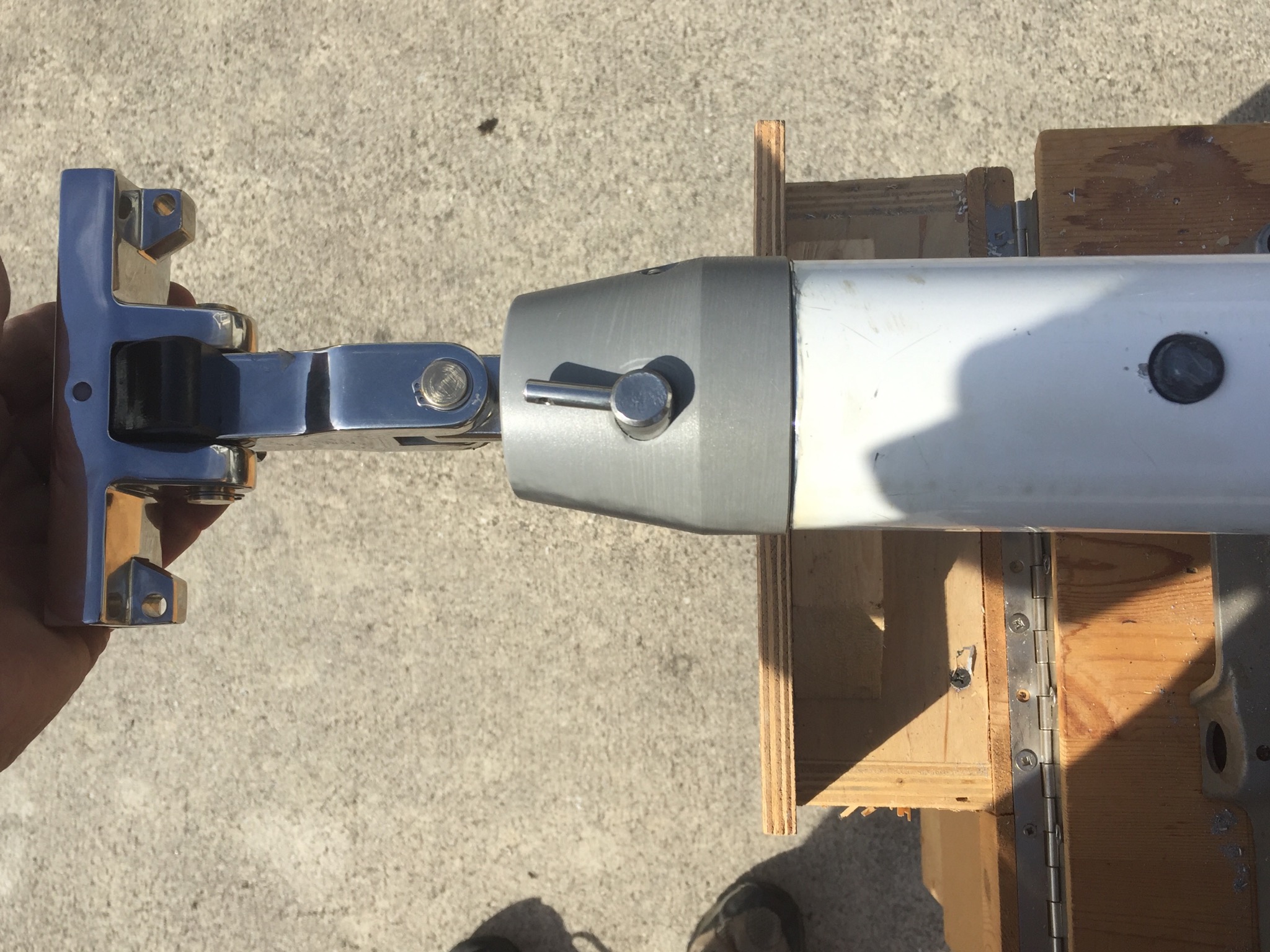

I don’t have a modern telescopic pole. Nice but ‘spensive. Instead I bought a new car for my 40 year old whisker pole just before I headed off-shore. So far it has worked well...an improvement over the old jaw and ring that had worn themselves out.
I called and discussed it with the Forespar tech rep and and he helped me fit the right parts to my old style pole.
- The new fitting. Smoother to operate. A little less likely to bind.
- 153E2B9D-8EC8-4AB9-95B8-90CC36386783.jpeg (630.55 KiB) Viewed 459 times
- Old style fitting. If you look close you can see a crack in the end casting.
- 1E6757ED-D5CB-4724-8803-EDF545F7DED0.jpeg (1.88 MiB) Viewed 459 times

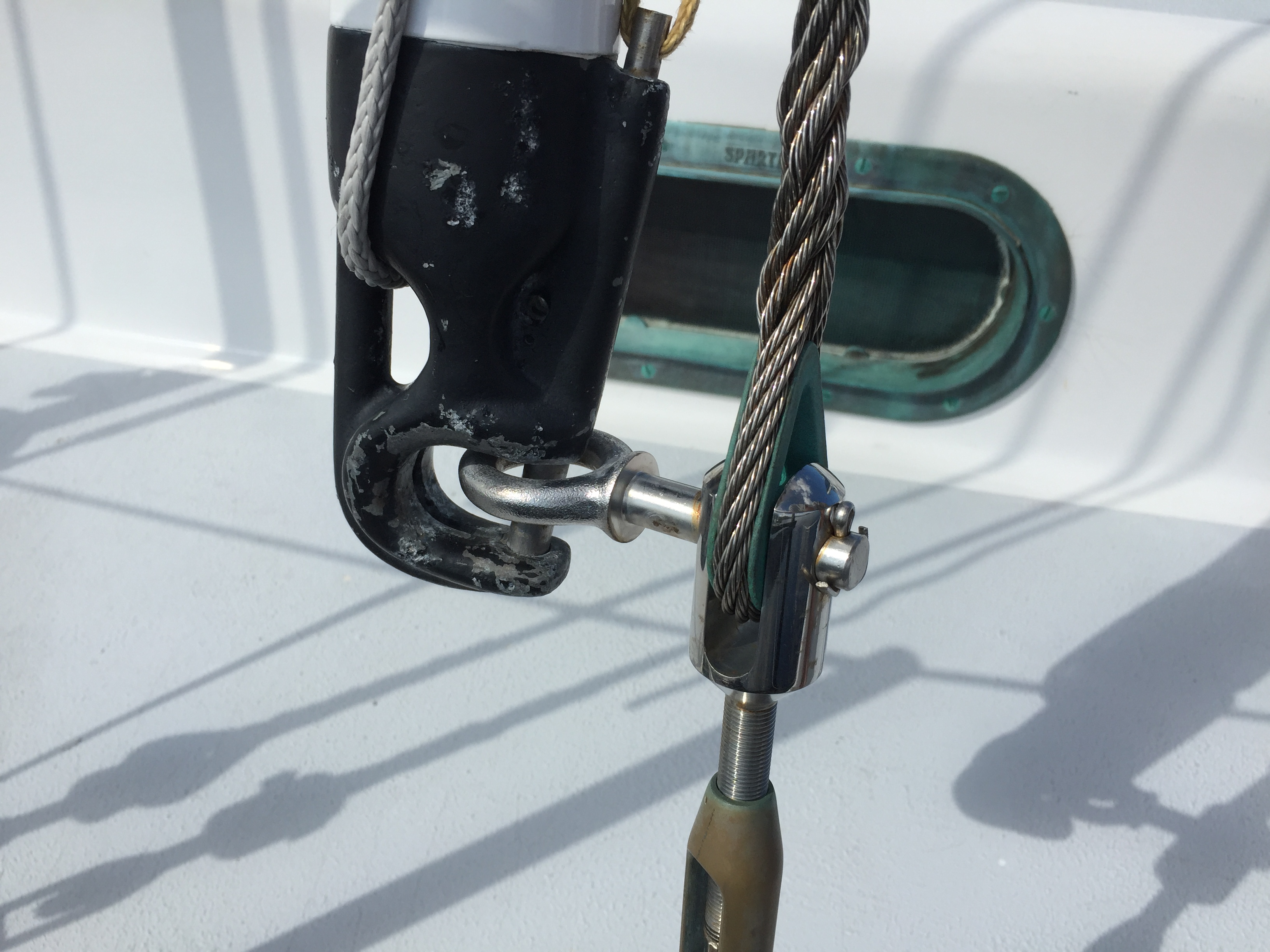

JD, Nothing is ever as good or bad as we think. My systems are working well and I am happy with them, but few things are perfect. I fall squarely into the view espoused by Sheryl Crow, “It’s not having what you want, but wanting what you have.” You are doing some great stuff. I admire your attitude, determination, and focus.
I don’t stow the whisker pole on the forward face of the mast (which is a good location). I stow vertically but have the outboard jaw snapped into a large eyebolt/clevis pin that’s part of the turnbuckle. Works good for me. Can secure it to either side of the boat. Pictures attached.
- BE6A8BC5-212C-49BD-820F-5B12280042C4.jpeg (1.44 MiB) Viewed 441 times
- B2CBC73E-97E6-4BCA-B7F5-E0370B6F6F49.jpeg (2.12 MiB) Viewed 441 times
