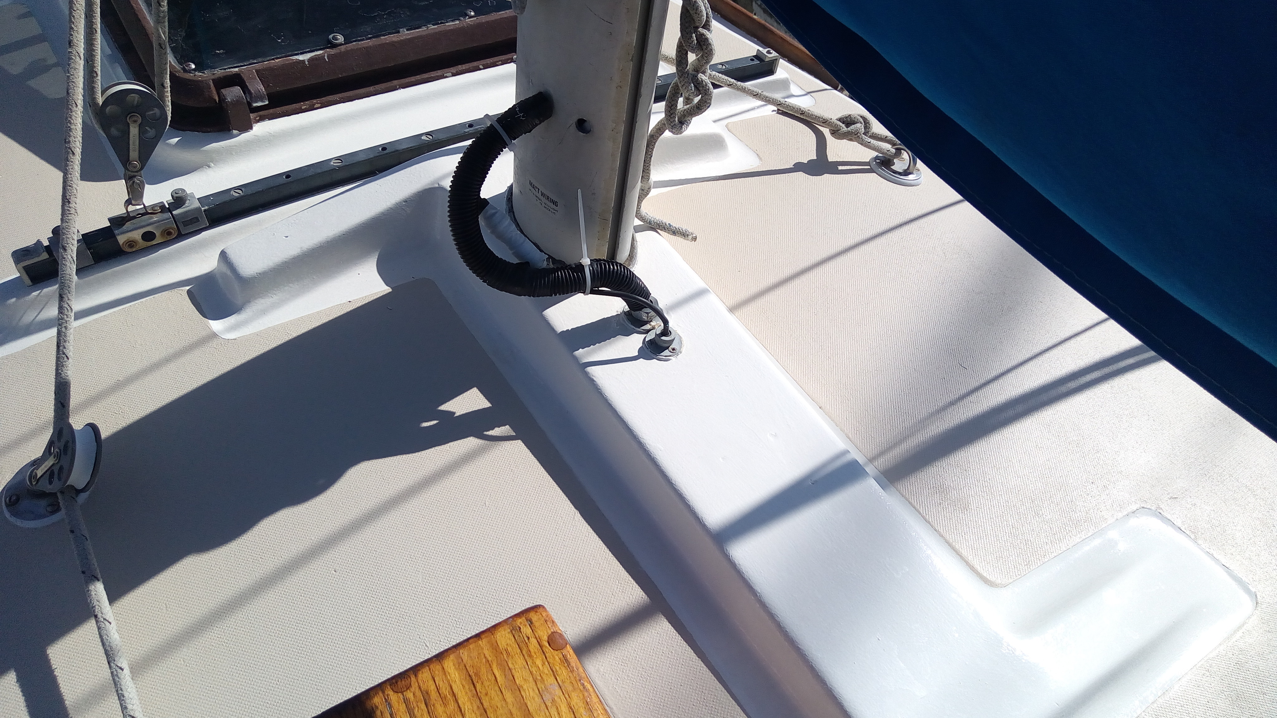

Does anyone have any ideas what to do with these wires? My inflated dinghy fits nicely there but the transom rubs and frays these wires. I'm trying to think of a way to protect them. Thanks

Hi John, Thanks for the input, I agree I don't like spreader lights. I don't have them just the stock steamer /deck lite combo.. I replaced the antennae and wires and put a tri color light atop the mast. I worry about the running lights so low at deck level. In nice weather they're ok but in big swells I feel better up high. But I don't know I've been tempted to try to contact a ship and ask them. how visible I am, on radar also. I don't have any reflector or any other aids just my eyes and ears. Anyway the wires are there to stay I probably need to have some kind of chock to hold my inflatable transom clear of the wires. Some times its nice to carry it inflated if I know I'm going ashore
Re: Mast wires
a VHF antenna on the mast will have a much longer range than one on the stern rail. Have you considered making a wooden box that would protect them? or a transom mount for your dinghy to keep it off the wires? id make a dinghy mount.
Re: Mast wires
That's what I meant by chocks for mounting. But then again I don't want any more holes .I was thinking of making some type of fiberglass cover to protect the wires.

I don't do a lot of talking on the radio but I depend on It for weather forecast.

A possible route to go might be drilling a hole through the mast step. The connections would be made say a foot
above deck level and the wires stuffed inside the mast as it is stepped. The through hole could have a standpipe
epoxied in that stands a few inches above deck level to shed water. Also, the wires could be caulked where they
exit the standpipe.
The practicality of this would depend on what's under the mast step in the interior and what kind of a lead
you can give the wires below. My old Cal 27 had a set up like this. - Jean

That would be ideal. There is another 30K here, his wires come out same as mine Maybe there is a reason they didn't do it like that. I'm gonna go back to Nigel's u tube ,replacing that big iron mast step support and maybe He did something better.Anyway I can't afford any of that now. Once I get the dodger the dinghy may not fit there but that's a year or two away.

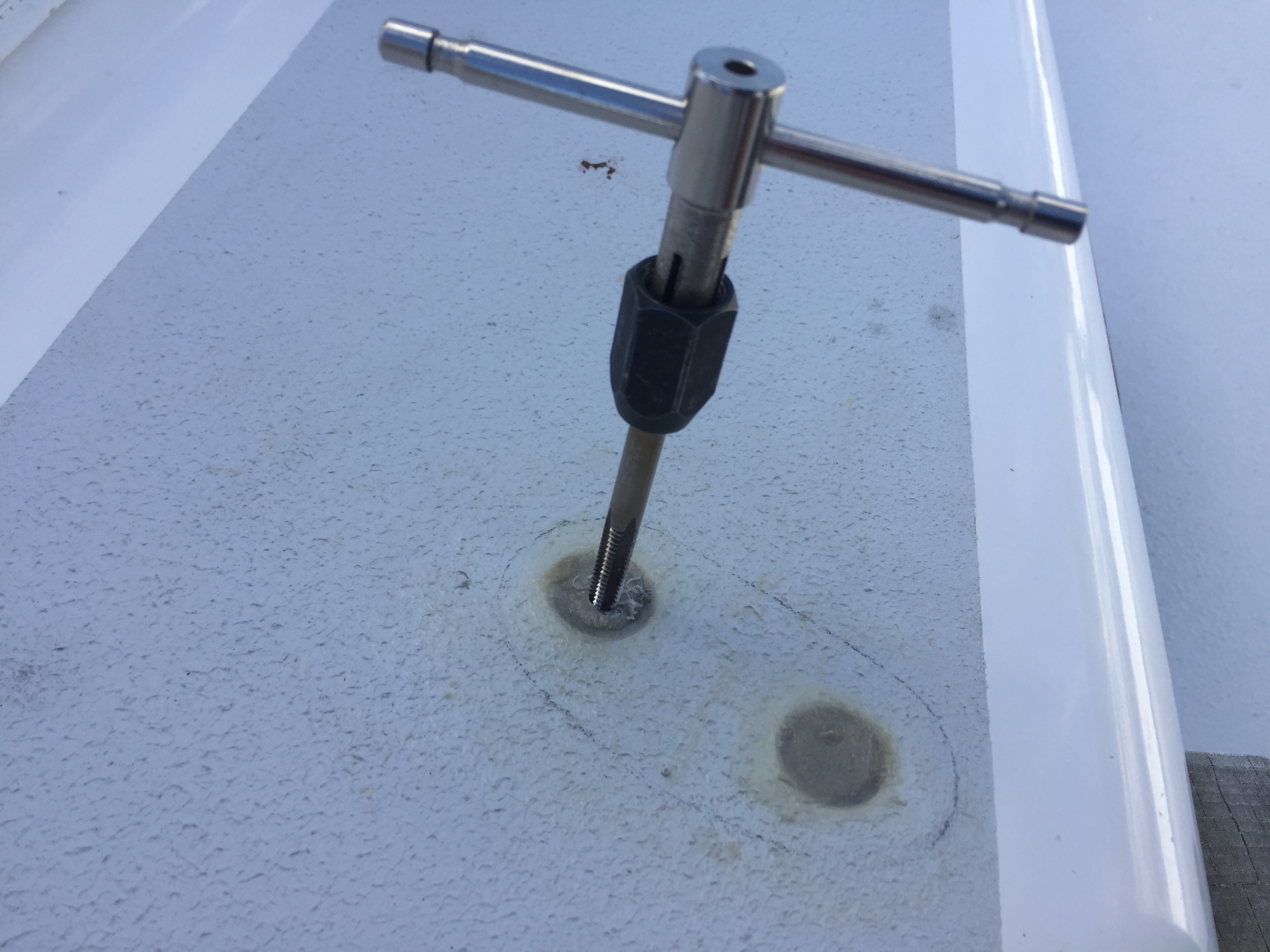

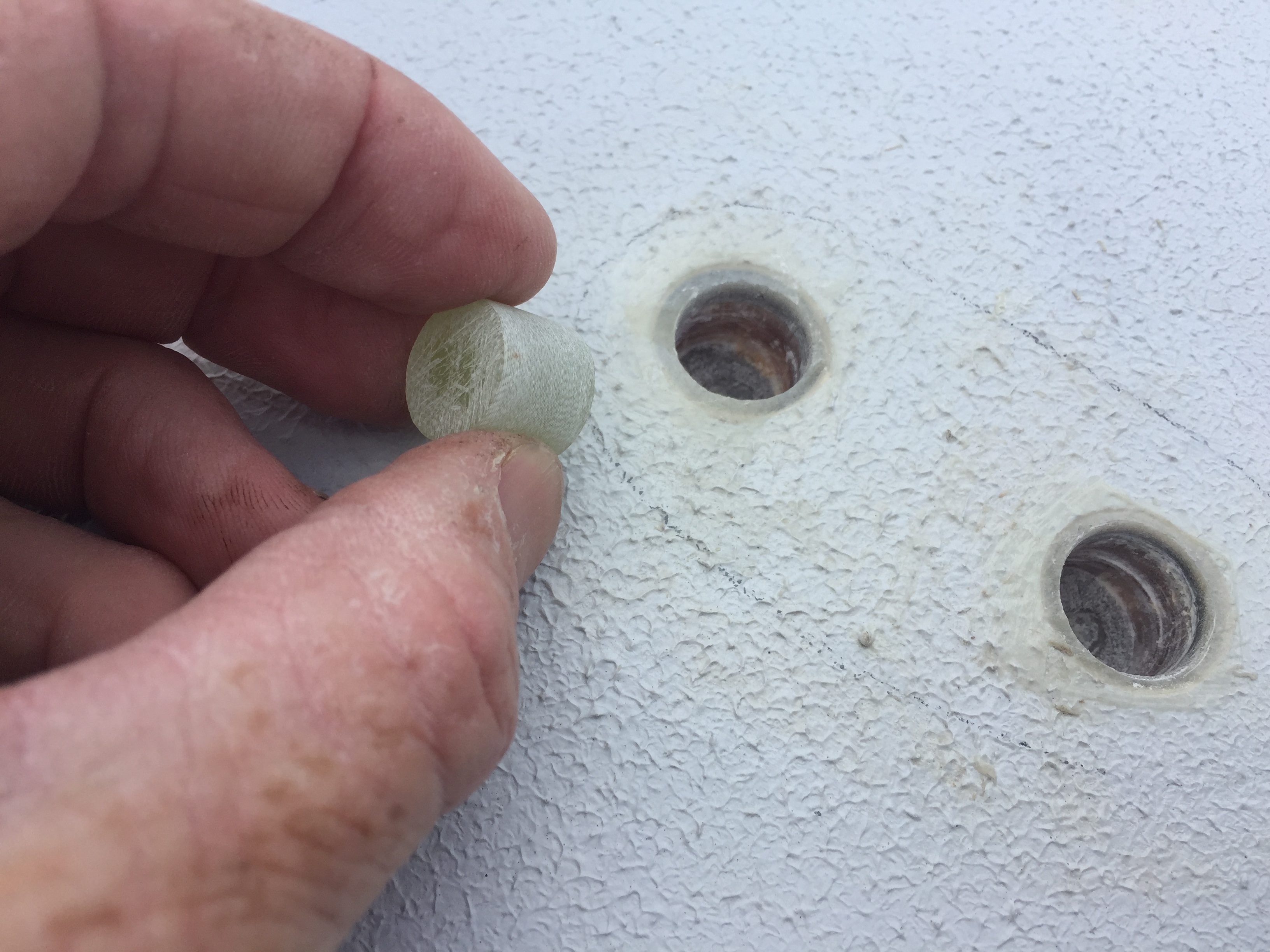

You can attach chocks without drill holes through the deck. Place the chock on the deck. Drill through holes into the deck with small diameter bit. Remove the chock. Use an oversized fostner bit and drill through the upper skin and into the core. Don’t penetrate the inside skin. Slightly dig out core from under the edge of the upper skin. Pour in unthicked epoxy and let it cure. Redrill with proper size bit and tap threads into the epoxy with a blind tap. I have also done this by installing a small piece of G10 or even a bronze nut. Now you can mount the hardware without worry about water leaking into the boat or the core.
This technique is not appropriate if backing plates are required. I would not recommend backing plates on chocks though.
Here is a link to installing and tapping G10 plugs into the deck of the Far Reach.
https://farreachvoyages.wordpress.com/2 ... /#more-821
