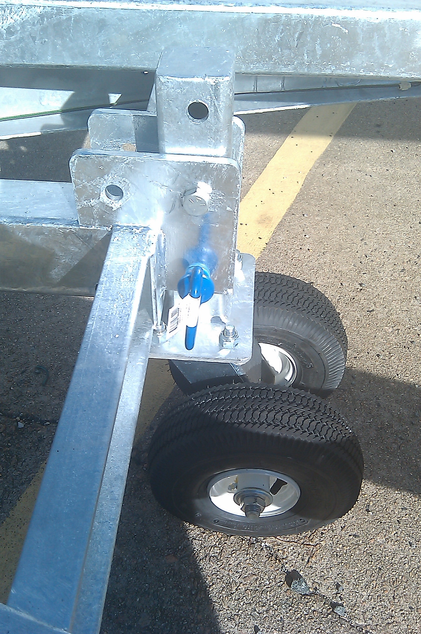

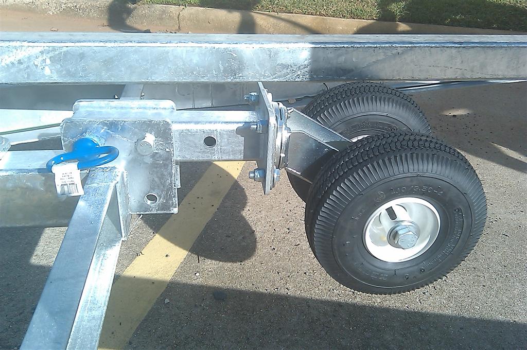

For those with a lot of money to throw at the problem, or if you are in the market for a trailer, Triad also makes a "Special Float-Off" model with a much longer (I think it is 20 feet) tongue. Since the tongue is so long it isn't strong enough to support the trailer's tongue weight, and the trailer has a set of wheels like the front wheels of a jet airplane that drop down to support the tongue.
Triad "Special Float Off" with wheels up
Airplane wheel up position (Large).jpg (170.72 KiB) Viewed 963 times
Triad "Special Float Off" with wheels down
Airplane wheels down.jpg (1.3 MiB) Viewed 963 times

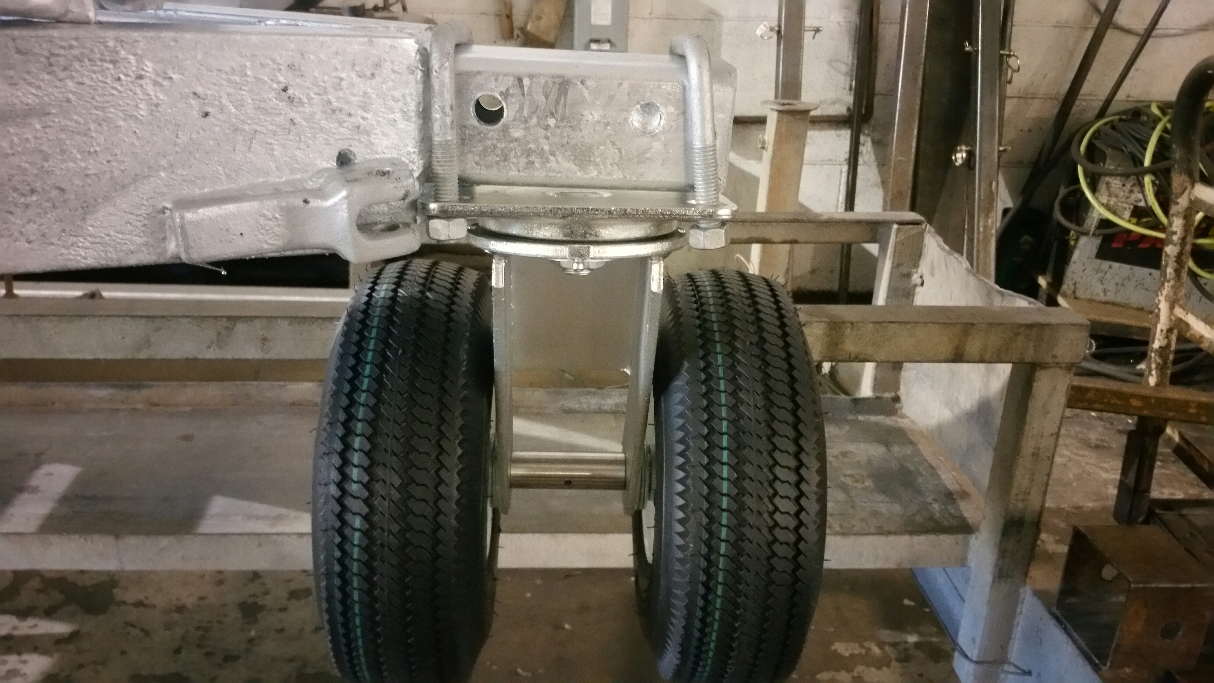

I looked around for a good set of wheels that could replace the tongue jack on my trailer. My thought is to use a 25-foot long towing strap to ease the trailer into the water and pull it back out, with a good set of wheels to hold the tongue weight. Unfortunately, the only wheels I could find were either too small, too flimsy, or had unsealed bearings that wouldn't stand up to salt water immersion. The other solutions I found were by do-it-yourselfers who know how to weld and could fabricate something themselves. That's not me, however.
I finally emailed Mike at Triad Trailers and asked about purchasing a set of the wheels he uses for my trailer. Unfortunately, because of the different locations of the tongue extensions on the Float-Off and Special Float-Off trailers, I couldn't use the exact setup they use, but he did provide me with a workaround solution:
Work-around wheel
Work-around wheel
Triad Trailer airplane wheel-2.jpg (2.07 MiB) Viewed 963 times
It looks super sturdy. It takes a bit more work to attach and detach because it involves bolting and unbolting the U-bolts, but it looks like it will get the job done. It's kind of pricey, but I think in this case it's a matter of "you get what you pay for."
