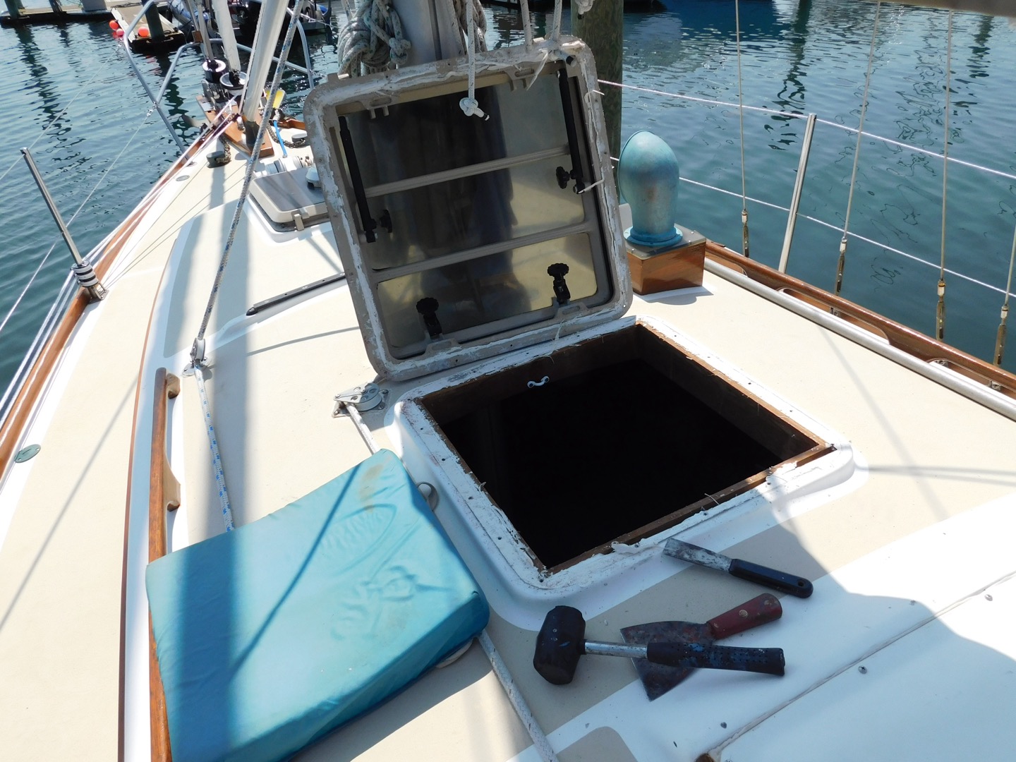

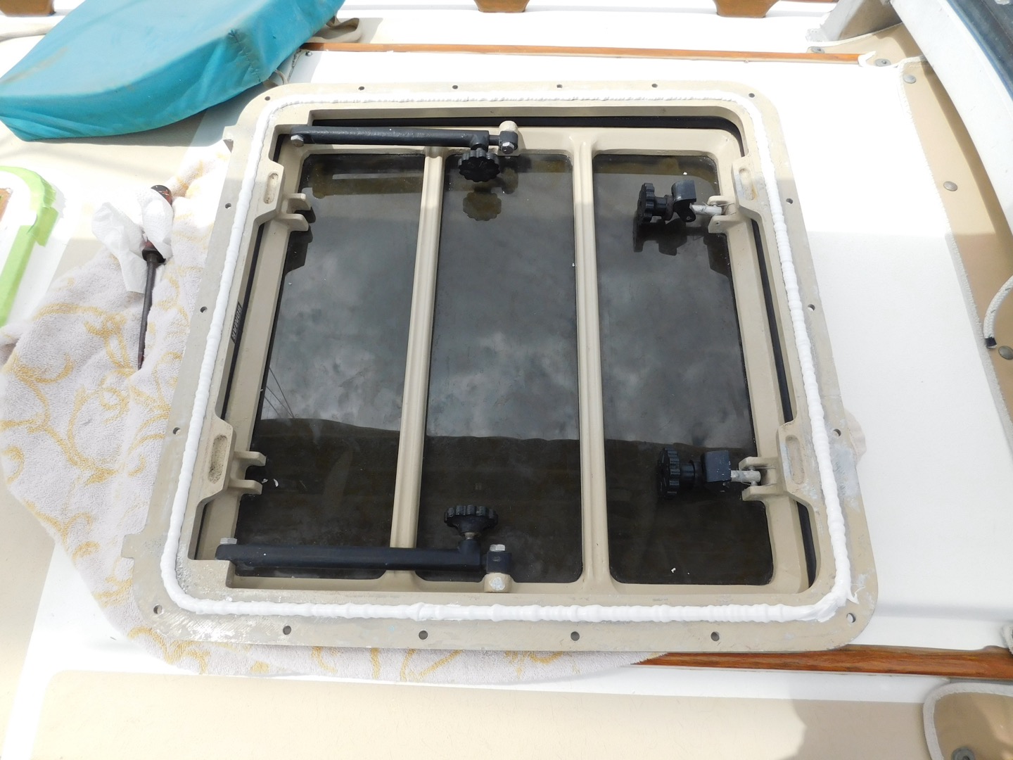

My midship hatch was weeping, just a few torturous drops, from one corner of the teak trim. It only occurred when lots of spray was flying. I figured I'd remove it, rebed it, and replace the gasket at the same time.

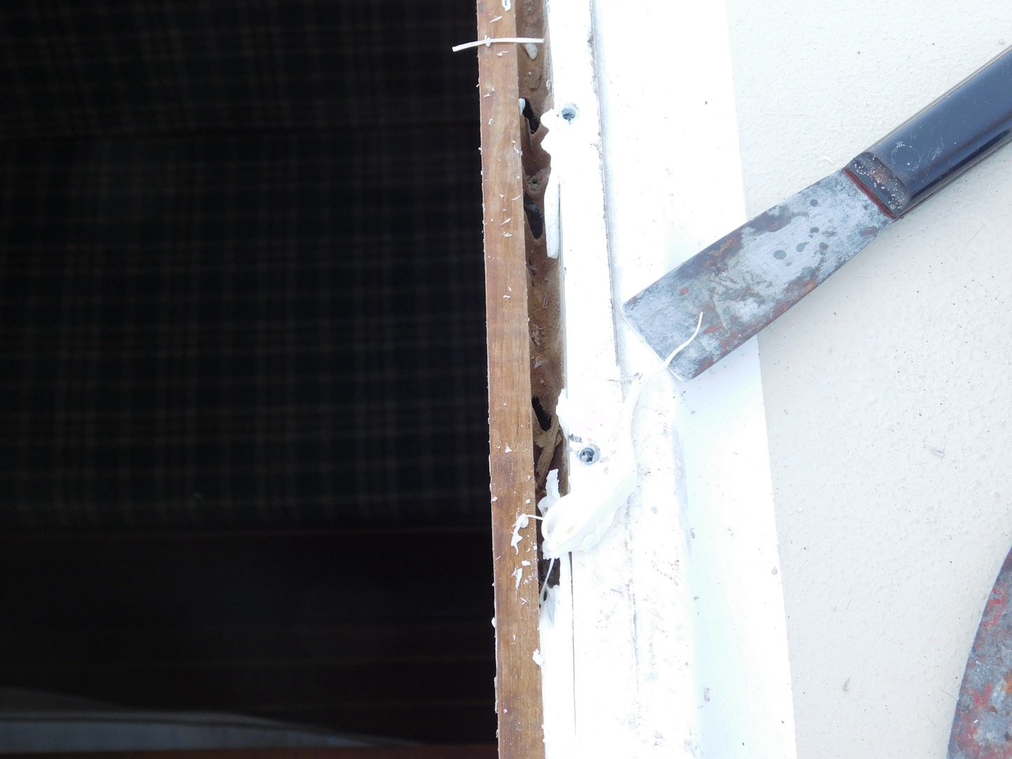

It was bedded in silicone (yuck) and I found gaps between the fiberglass and the teak trim. One quite large gap. I'm looking for advice on what to use to fill the gaps, and what to bed the frame with. I know butyl tape is popular but I'm wondering if 4200 might be best since the fastenings barely bite and the 4200 would supplement the mechanical fasteners.
Carefully breaking the seal

Hatch removed

See the gap

I think you're right. I've done some searching and it appears that 3M 4000UV might be best for this application. I still have to come up with something to fill the voids between the teak trim and the fiberglass.

If the screws attaching the hatch frame aren't getting a good purchase the option would be larger screws,(if possible) or drilling out the screw holes and making an epoxy plug, then drilling the plug for the proper screw size. Be sure to remove any remnants of silicon by cleaning first with solvent. I used Boatlife to caulk the frame to the fiberglass 10 years back and have noticed no leaks.

I had no idea. I just spent at least two hours removing all the silicone caulk from the hatch using a putty knife, a stainless wire brush, and lots of elbow grease. Oh yeah, I used a .30 caliber wire brush to clean the damn silicone out of the fastening holes in the hatches flange. It ruined a perfectly good cleaning brush but it fit the holes perfectly. I'll check out Home Depot tomorrow and use it on the fiberglass to insure I remove the silicone which I haven't managed to remove with my putty knife. Great tip, thanks.
I ended up filling the gap noted in my original post with 4000UV. It took an entire cartridge. It's real gooey, sticky, stuff. I'll be using it to bed the hatch also.

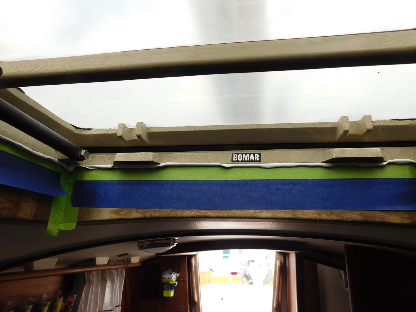

The hatch has been reinstalled. First I cleaned the mounting surfaces with a putty knife, a wire brush, and acetone soaked rags. I filled the gaping voids with the 4000UV and gave it a day to cure. Then I dry fit the hatch, which gave me the opportunity to mask the surrounding surfaces. After that it was time to lay a bead of 4000UV in the caulking groove. The tough part was placing the hatch into position on the first try so as not to smear my bead of caulk. I managed to get it damn near its final resting place....within a quarter inch or so. I ran all the fastenings in and went around only once to ensure they were just snug.
An hour later I removed the masking and it was "job done".
A nice bead of 4000UV in the caulking groove....ready to be lifted into position.
Hatch in position showing a nice bead of caulk and the masking.
All I have to do is remove the masking.
