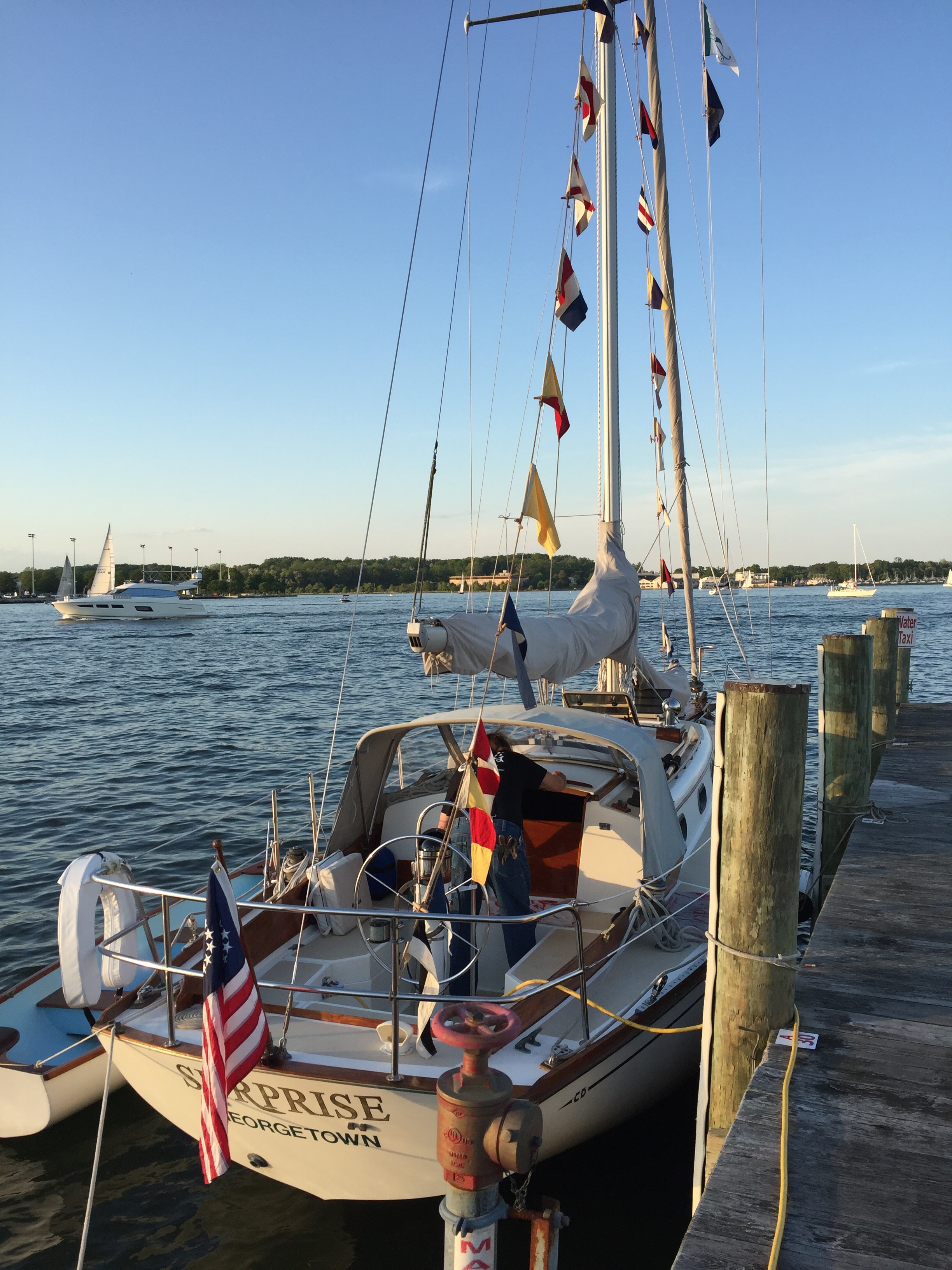

5 coats of Interlux schooner so far. Toe and rubrail are 3 coats Interlux teak oil followed by one coat of Amazon Golden teak oil. Photos taken during Elf Classic Yacht Race Annapolis. Go to

Well thanks Roberto, I appreciate the compliment a great deal. But of course, I know where the flaws are! I'm very happy to have had the opportunity and to have made the time to get all the necessary work done. I've had support from my wife and a couple of friends that has made all the difference. My friends have given me ready access to tools needed and much good advice on how to tackle the big jobs. I have had fun with a recommended chemistry concoction for the varnish for instance that I feel has resulted in the best "seal" I have ever gotten on the teak in the first few coats. Its Interlux Schooner as base of course, cut with 333 solvent to thin for absorption, a dash of Penetrol for its leveling properties, topped off with Japan dryer to get it to set up fast resulting in a couple of days where two coats were possible. Now its just additional layers for durability and filling the grain. I'll need to hard sand between at least one or two upcoming coats to start to get to that smooth mirror finish I want for the final coats.

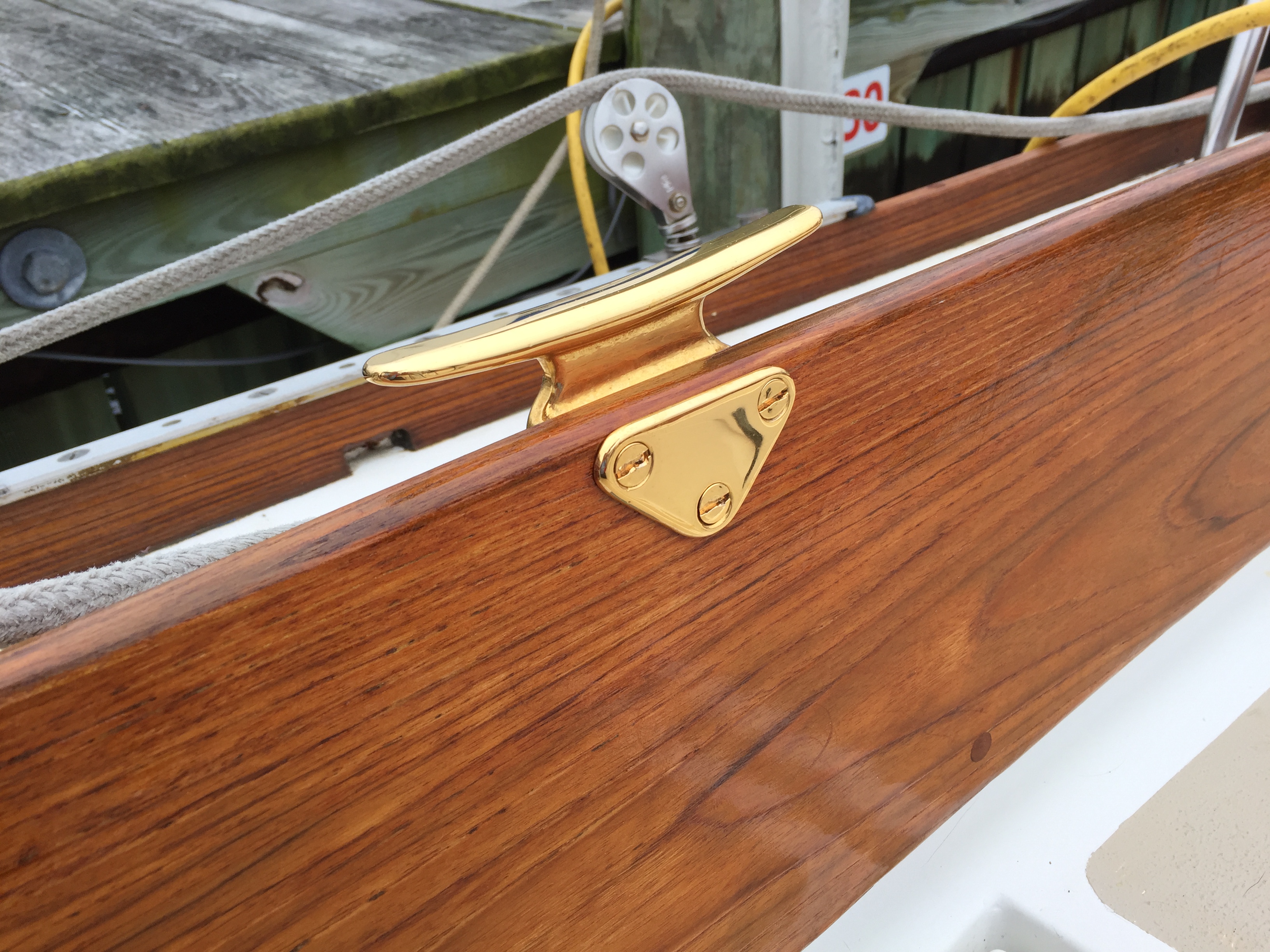

Wondering if the coaming cleats were removed and polished or are they new replacements?

The cleats are original Cape Dory/Spartan castings. They were electropolished, then the cleats, mounting hardware including screws have been plated with a copper strike, nickel, finished with 22 carat gold. FYI they are taken off the boat when not in use. Definitely a conversation piece and they never tarnish.

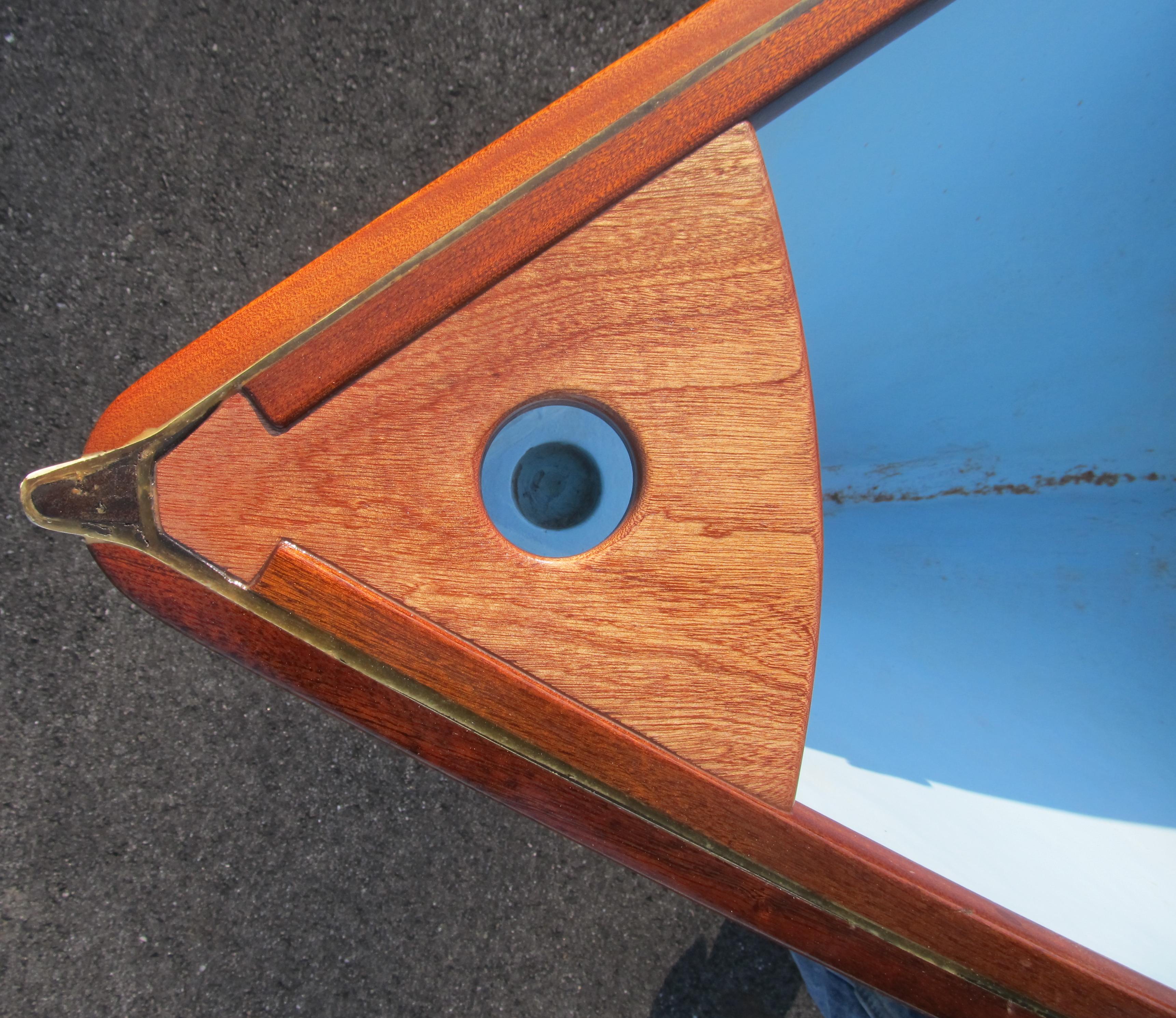

Looks like a nice CD10 on your port quarter. Would you happen to have any more pictures of that?

CD 10 Resto Pics
- 11-2014 Aft View.jpg (817.83 KiB) Viewed 1531 times
- 07-14-2013 Dinghy Restore 1.jpg (2.09 MiB) Viewed 1531 times
- 11-2014 mast step.jpg (1.02 MiB) Viewed 1531 times
