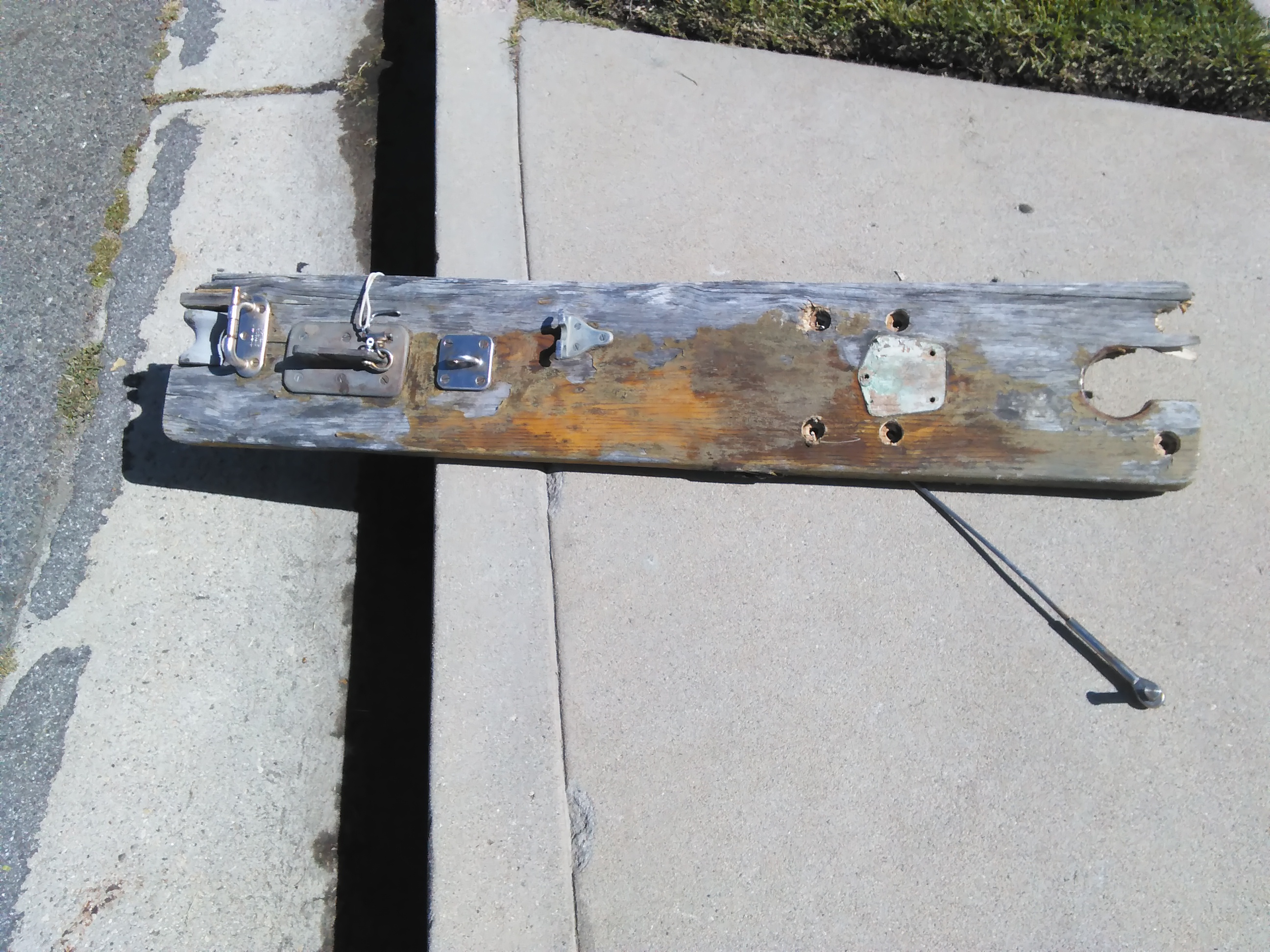

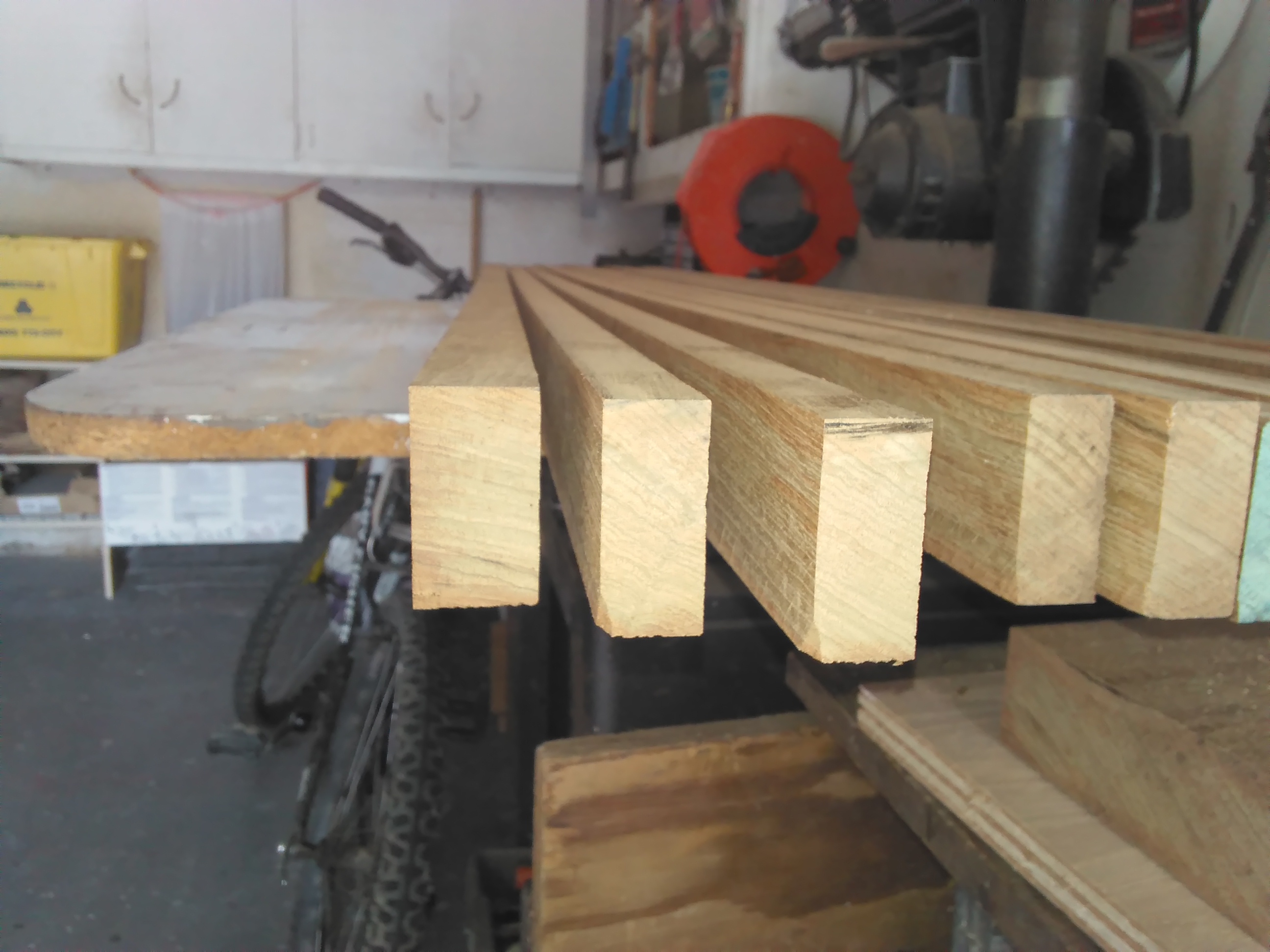

Here is a photo of my bowsprit, I'm hoping for comments and suggestions. From what I've gathered It seems that laminated strips of teak would be the best looking and durable enough.I'm thinking about 1-1/2" strips .I think the grain has to be vertically. and should I use west epoxy? My main question is how to put the bow roller so I can put a horizontal windlass later on. I was thinking of the Lewmar Profish 1000 freefalling windlass and one of their rollers suitable for my 30# CQR . I need to install the sprit now but won't be able to afford the windlass till next year

My CD30 bowsprit has bronze rods through the teak boards, perpendicular to the grain. They are plugged with teak bungs on either side. I'm not sure how many rods there are though.

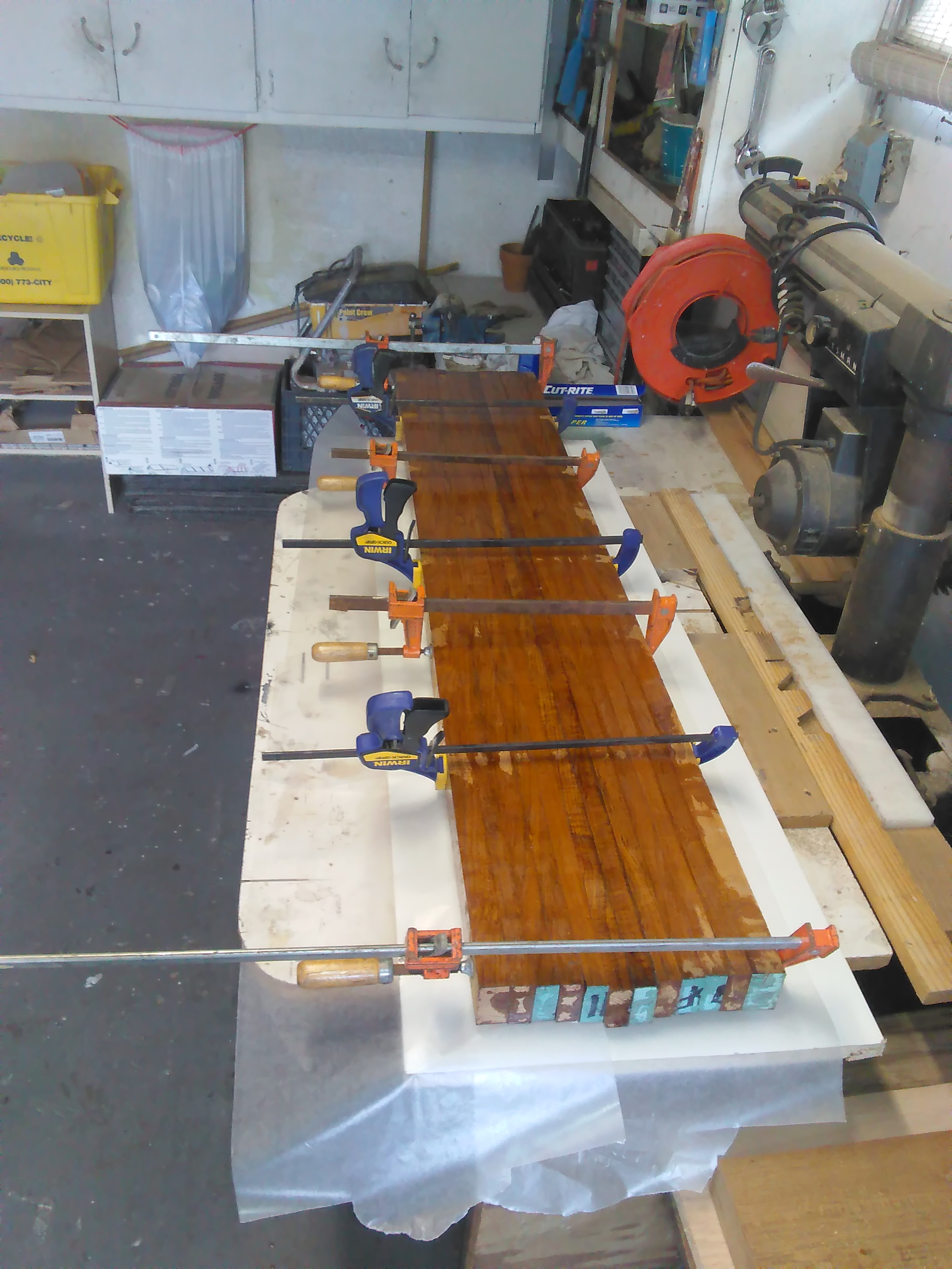

I got 10'- 8/4 teak $430 for two 2 x 6 boards. Oh Oh, Did I cut the grain the wrong way? I'm gonna use it anyway. I hope it OK..I'm starting to laminate them now... Here a later photo for your entertainment. I hope I'm doing it good. I wet it down and then spread a thickened goo. I hope I don't have to sand to much. The stock is 1-13/16 and the old piece is 1-11/16. I'm making it a little wider to make sure I can get the bow roller 3-1/8" to one side like what Hilbert has. I don't know what I'm gonna do for the windlass cuz that mount for the little boom might be in the way. Whats it called? club foot, or something.

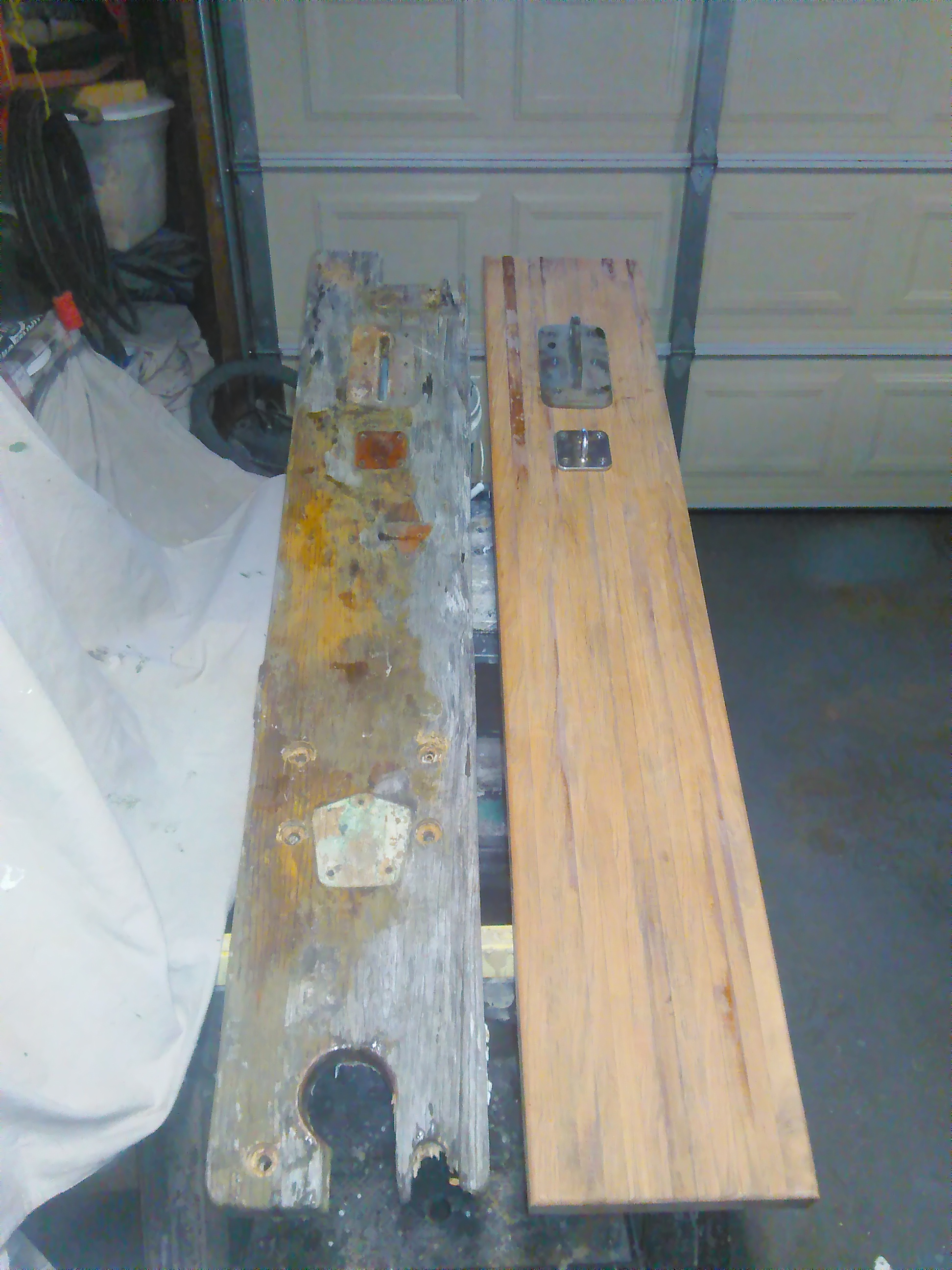

Here is the new sprit, I was wondering if I should wait and varnish when its in place ? would it be a better bond to the deck with bare wood? I plan to put 4- 3/8" bronze rods thru like Jeff mentioned. I'll deal with the roller later and the hole for the chain to drop thru.

The rods are probably a good idea since teak's natural oiliness repels most glues/epoxies. I believe that the primary function of the sealant is to keep water from running under the bowsprit and down the fasteners, but it is the function of the fasteners to attach/bond the bowsprit to the deck. In any case, it should be easier to varnish before installation.
