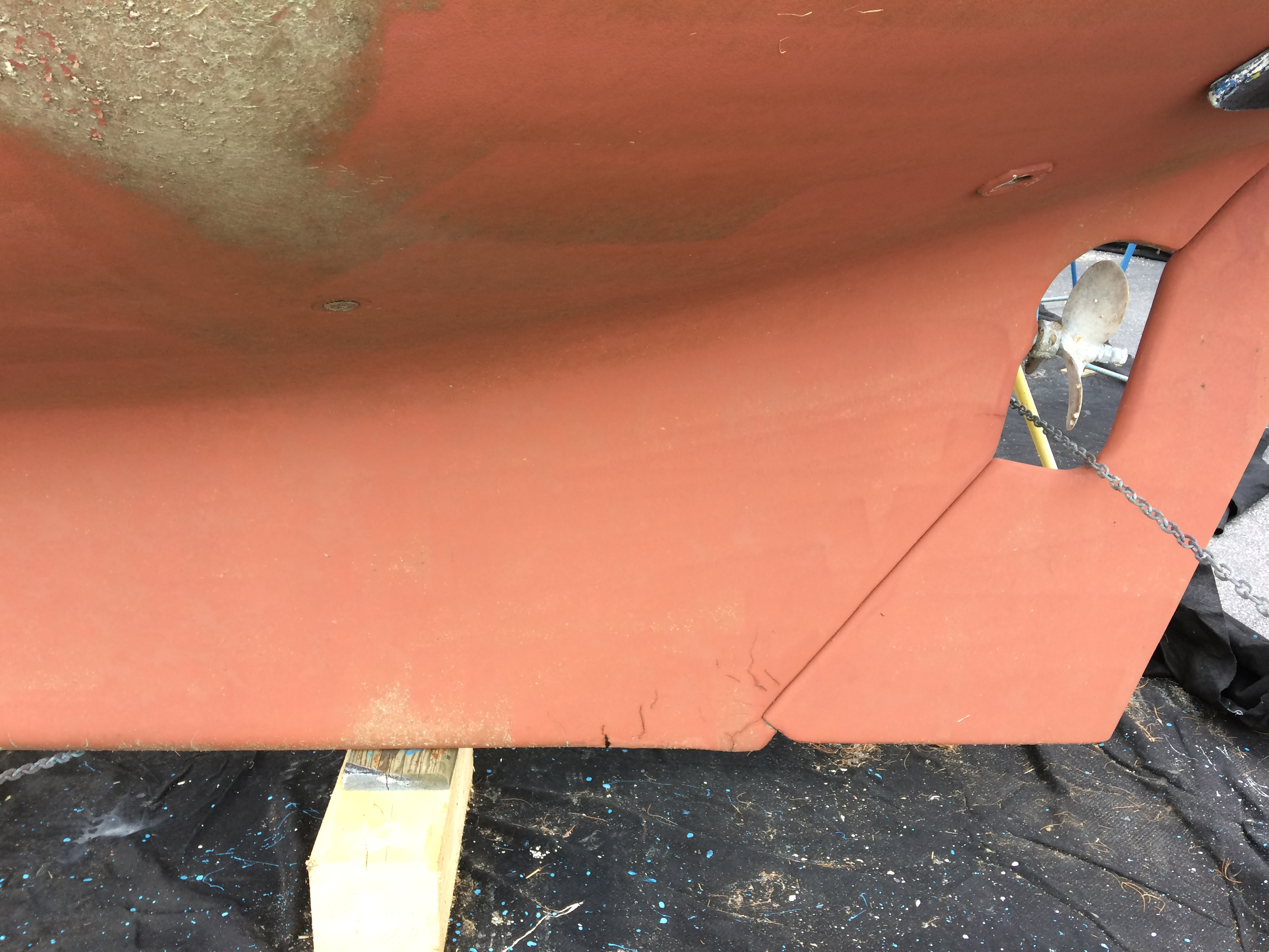

Here we go. My recently purchased CD25 is like an onion. Every peel of the shell is revealing more work. Here's number 1. (See if I have the image inserted correctly). The keel in this area appears to have been repaired already, perhaps the rudder was off. There is a small drill hole in the repair that seeped a little water. Where did it come from? Can I grind down and fix? Is it possible that water in the bilge leaked the length of the keel to this spot (it had some water in the bilge...or rudder shaft? Whats under this area, lead keel, wood, other? BTW - the chain is not taut from the boat stands...
Looks like I am in for some work! Thanks for any help

hard to see detail of the small drill hole in the image, but any water would have come from outside, not the bilge.

There is a small seep hole you that someone drilled (brown in the pic) and appears to be some cracking also.
What is located in that area of the keel (next to rudder step) that has been patched in my photo? is it lead or fiberglass or wood or combination?
I am wondering about the aft keel bilge I hear about on other posts. How far down does it run?
anyone? Thanks

The rudder's lower gudgeon is normally fully fiberglassed in and not visible. To see the bronze gudgeon (as seen in your photo), one must grind away the fiberglass. There should not be any additional "weep holes" in the area.

I owned a 1978 CD 25. I had water weeping in that area every year after haul out. I drilled a hole in the area to determine what was going on. Turns out there is a void space between the two sides of the keel ahead of the rudder. I had a quality boat yard open it up and fill the void with epoxy. That solved the problem. It seems to be a common issue on the 25 but not life threatening. :D

Jerry - thats the best news I have had all week. That sounds like exactly the same condition as mine has. I intent to start taking off the current repair (slowly, with boat savvy friends) and will drain and dry her well, before patching her up.

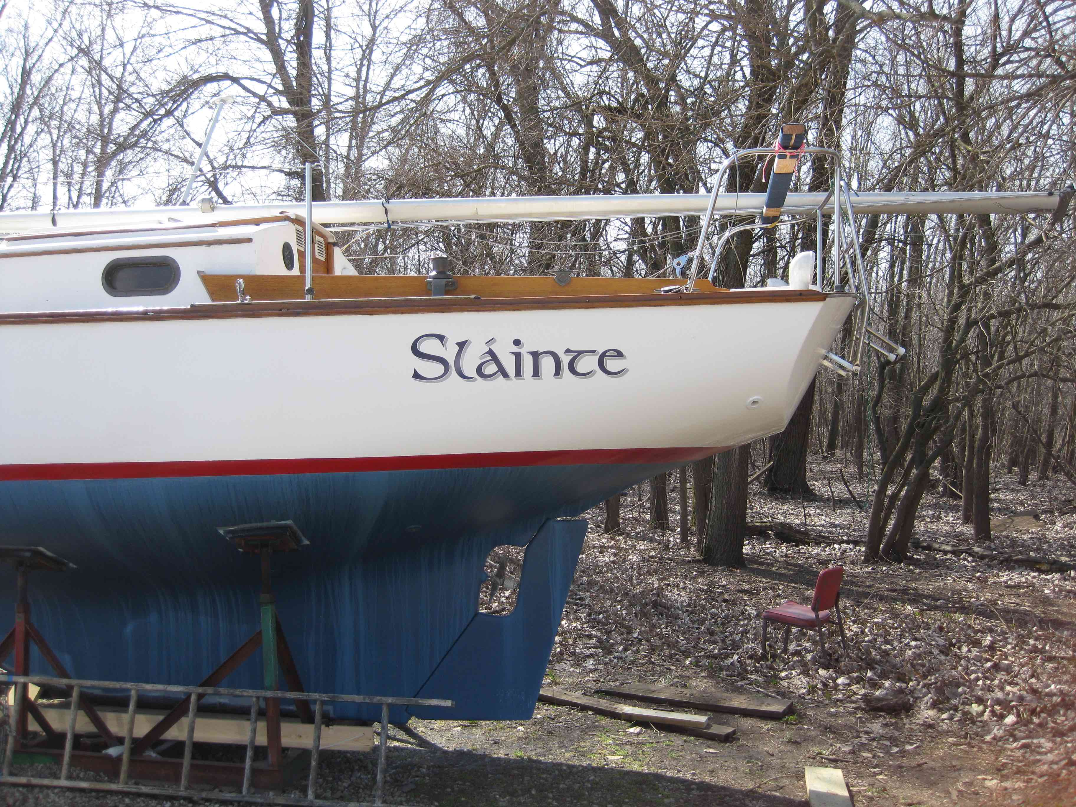

It is hard to tell from the photos, but how many layers of paint are on that area? Is the paint ablative? Are the "cracks" on both sides. I would start by scraping a small area down to the gelcoat and see what that shows. Here is what our 27 looked like at the last haul out, if that is any help.
