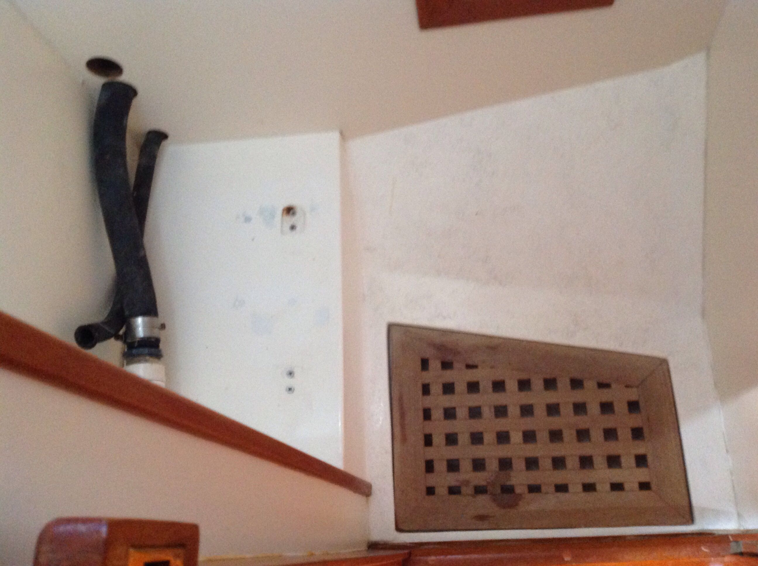

I recently purchased a 1984 CD 36 and intend to install a composting head (Nature's Head) this spring.
Two questions to resolve before starting the project are:
Cutting down the riser where the original head is mounted to lower the seat height of the composting head.
The base would then be reinforced, glassed and the new head installed.
Pending the successful outcome of the above project I would then remove the waste tank and associated plumbing to gain additional storage space.
Any info or suggestions from members having experience with such a project is greatly appreciated.

Thanks Tim,
I like the idea of ditching the liquids container and utilizing the existing tank or doing a modification to halve the tank capacity (currently 24 gals.)
Since my post I've read online that the waste tank on the CD 36 is glassed in, if this is true the tank mod project becomes more difficult (expensive and messy) and not a worthwhile consideration.
In either case ... Let the beverages flow!!!
Also like the step idea to address the head height issue, but haven't given up on a modification of the shower pan/riser.
Thanks, JR
Thanks, JR
