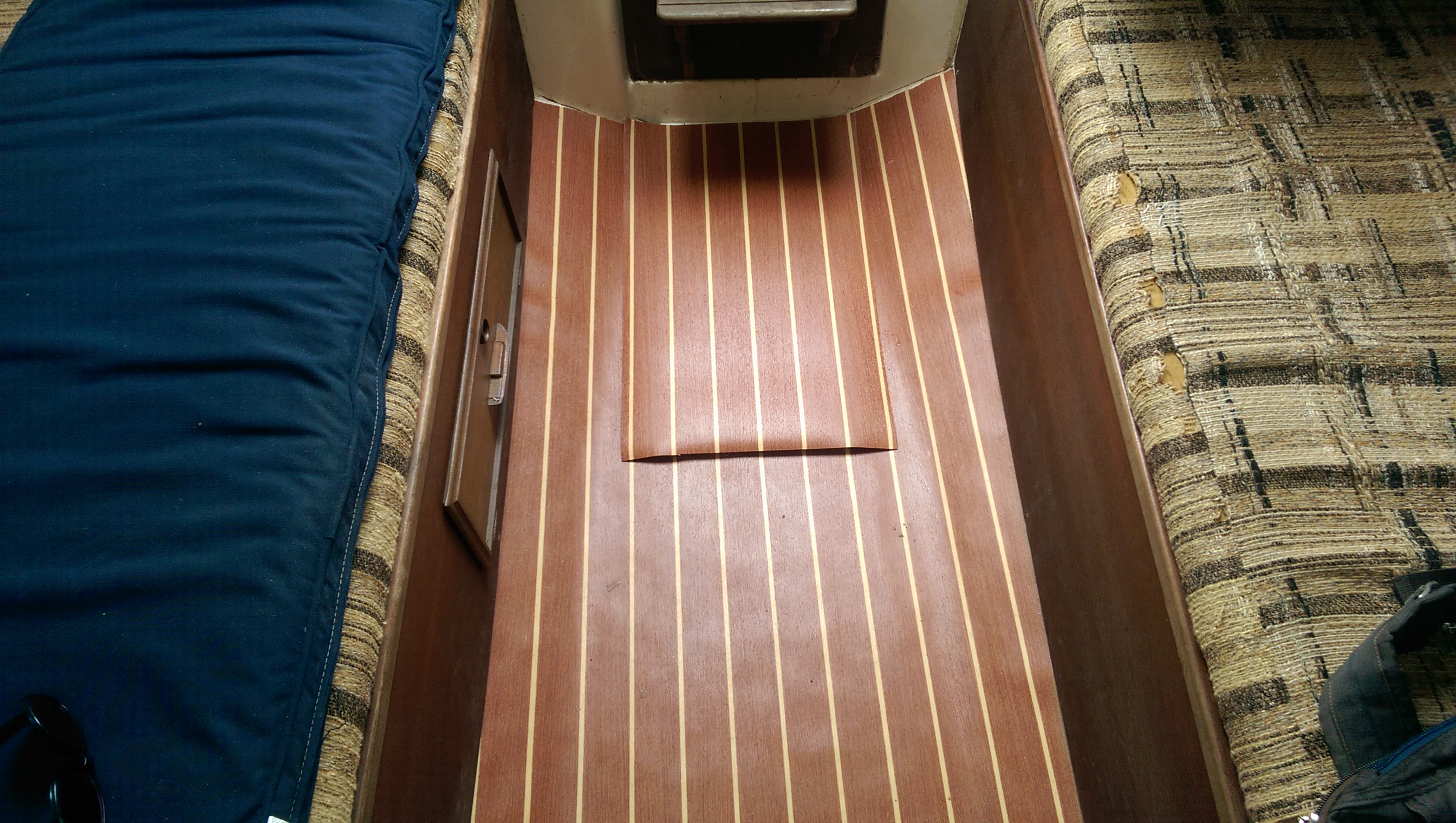

I purchased a Cape Dory 27! Hull number 220, and boy do I have plenty of stuff to work on and questions. The boat filled up with water and the cabin sole was destroyed, so I'm in the process of figuring out what to order to replace. the bilge cover is really falling apart, it won't support any weight at all and I'd like to get some guidance on what ought to be done. Can I lay new fiberglass around the edges to rebuild it? Or just use epoxy all around to build it up?

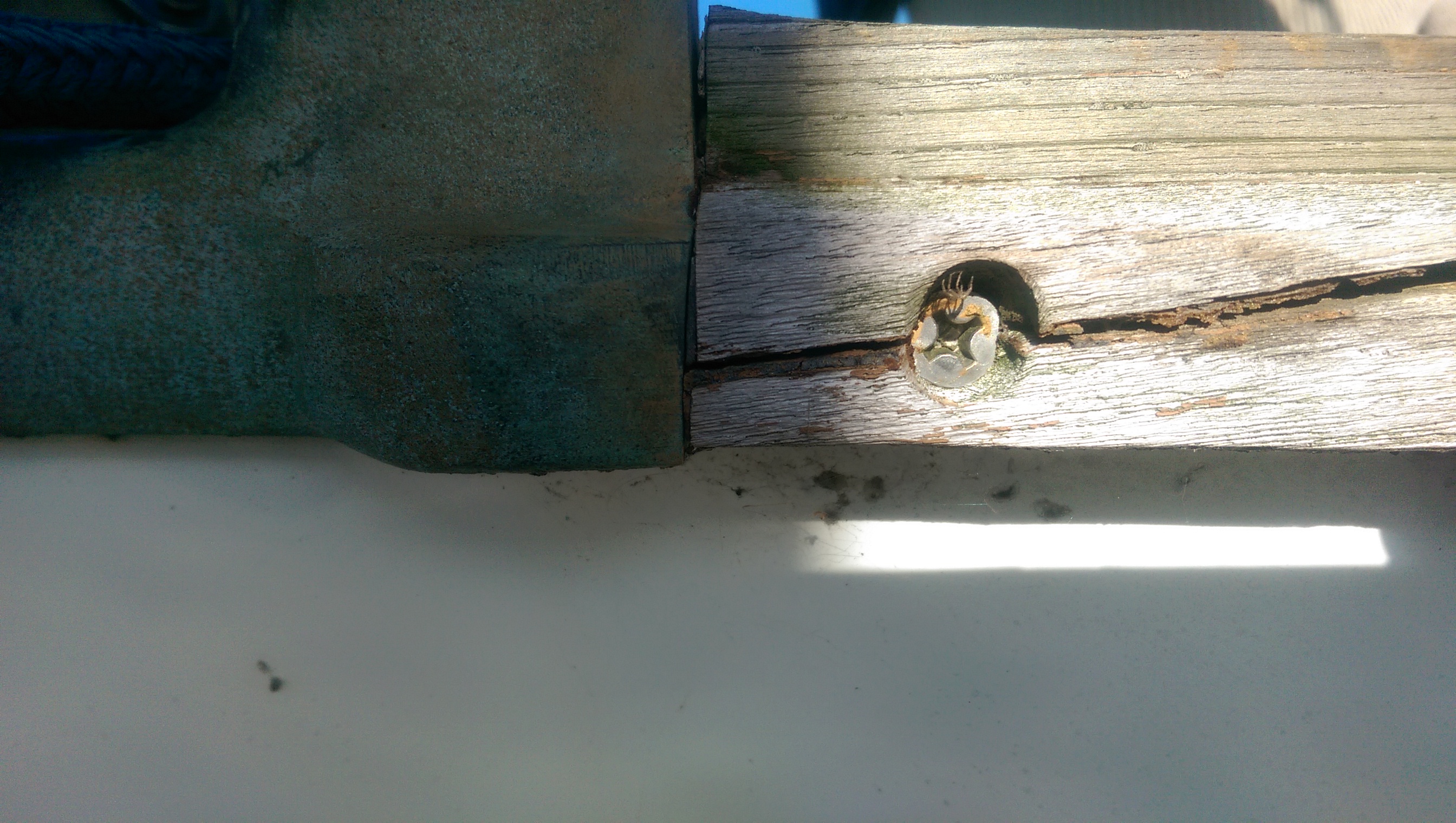

The teak toerail at the bow has come apart, and the toerail around the rest of the boat is damp underneath in places. I figure that it'll have to be removed and resealed, but unsure of what type of adhesive should be used to re-bed it. The boat is dry inside, no funny smells.

Most of your projects are beyond my skill set, particularly the woodworking. Others will chime in with sage advice. Teak, even teak plywood, is very expensive, so save and recondition as much as you can. I've re-bedded some deck teak with Butyl-rubber caulk. Some use BoatLife, some use silicone.

really interested in hearing thoughts on how to rebuild the area the bilge cover rests upon.

So instead of rebuilding the bilge cover area I did this. Cut a section of king starboard one inch longer and wider than the bilge space and covered the rest of the floor in LonSeal mahogany and teak marine flooring. I think it turned out pretty good. I didn't get the lines exactly straight so the floor looks a little funny, but it's a functional floor that will stand up to abuse.

If a "little funny" is clean and durable sole that is ready to go sailing, then you did a great job. You may have that boat for a long time and you could have spent most of the summer and a lot of money to do any better. It looks great, go sailing, Steve.
